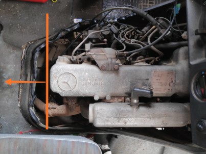

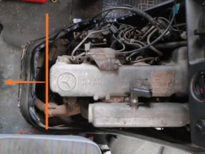

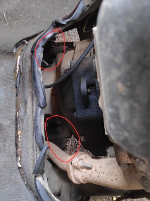

I'd check the Prius engine and also my van I don't think there is enough space for. The MB100 has the engine between the two seats and like you can see the half-shaft are underneath of the body.

RWD seems to have more options but find the right rear axle to replace mine would be not the easiest way. And it's certainly an other difficulty if I want the IVA...
And sorry but I don't understand this sentence : 'you would have to weld the PSD to get full RPM from the case '

I like this idea but I also thought about electric van because the actual engine is very noisy....
