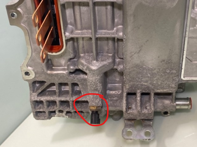

I tested unplugging this temp sensor plug and it resulted the IGBTDriverBoardTemperature to be FF so think the external sensor is reflected to this byte in message 55a.
So from where is this mysterious InverterComBoardTemp coming from?

I have done some testing my 110W inverter. As you have seen unplugging the coolant sensor changes byte 3, which which according to the DBC (I have) is IGBTDriverBoardTemperature, the DBC file is incorrect (at least for gen3).
The scaling for the coolant sensor is degC-40 (same as temperature scaling in 0x5c0 from BMS).
I tested this as follows:
Removed coolant temperature sensor placed in boiling water byte3 = 132 (132-40 = 92decC)
Changed the hot water for fresh boiling water byte3 = 137 (137-40 = 97decC)
Placed sensor in cold iced water byte3 = 45 (45-40 = 5 degC)
Added salt (too cool water down ) byte3 = 37 (37-40 = -3degC)
Established that motor temperature is byte1 by unplugging motor connector.
With the scaling degC-40 the other sensors show matching ambient temperature so I expect that scaling is degC-40.
My scaling:
int16_t temp_motor = bytes[1]-40;//MOTOR TEMP
int16_t temp_inv = bytes[2]-40;//INVERTER TEMP
int16_t temp_inv_coolant = bytes[3]-40; // gen 3 only?
int16_t temp_inv_other = bytes[4]-40; // maybe IGBT drive board only when running?
Your issue is with byte1 which is motor temperature, I expect you have a wiring issue between the motor resolver connector and the inverter.

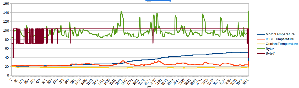

I have analysed log file 'Nissan leaf 62kwh driving , burst of acceleration v2.csv' from
https://github.com/dalathegreat/EV-CANl ... LEAF/62kWh
This is a 160kW inverter in a stock leaf. I assume 110kW is the same.
Outside ambient 11.5C (from 0x54c)
message 55a
byte 0 always 0
byte 1 motor temp 61 to 92 raw, (C-40) 21C to 52C
byte 2 inv temp 61 to 73 raw, (C-40) 21C to 33C, somewhat tracks abs(torque) with lag so probably igbt temperature
byte 3 coolant temp 57 to 60 raw, (C-40) 17C to 20C.
byte 4 85 to 143 too big and fast to be a temperature, 85 at 0 torque, tracks abs(torque), 12V supply current signal or some debug signal left in from development?
byte 5 always 0
byte 6 always 91
byte 7 0x48 or 0x68 0x28, a couple of times (others appear during charging).
So I was wrong about byte 4 being a temperature.
Another reason that I doubt the scaling is Fahrenheit, range 0F to 255F is -17.8C to 124C. Whereas C-40 gives a much more suitable range of -40C to 215C. The Leaf BMS uses the same scaling for battery temperature but is 7 bit, range is -40C to 87C.
Temperatures scaled as C-40, bytes 4 and 7 are unscaled.
