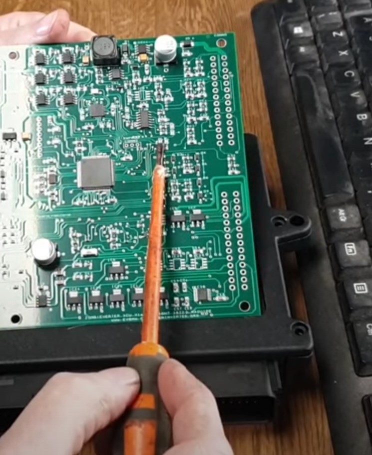

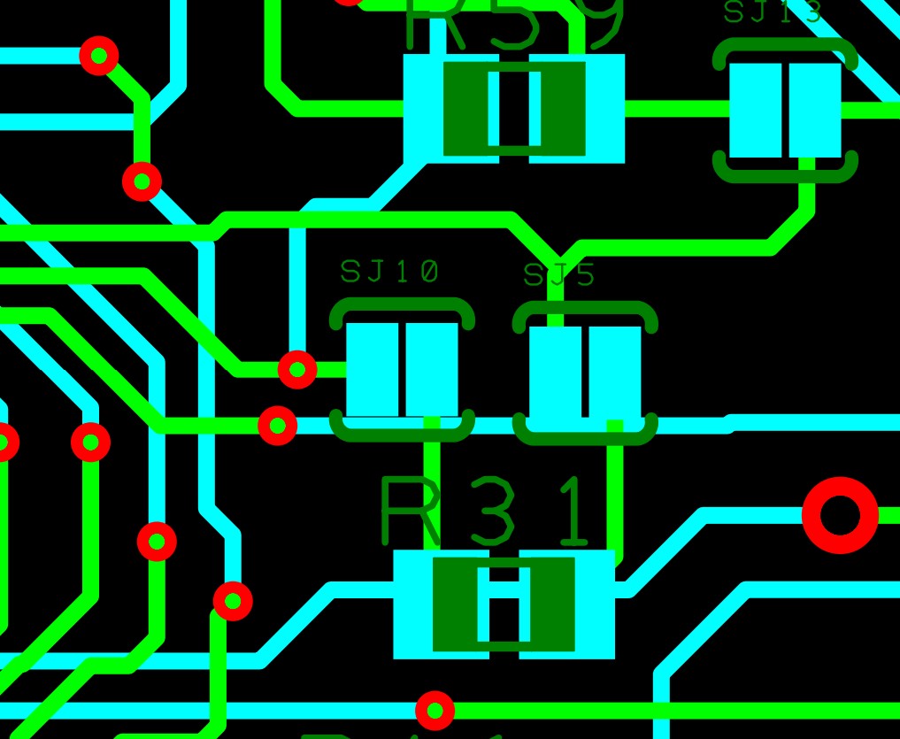

set up chademo in my brat with a zombieverter.
some discrepancy around can 3 termination on the zombie, on the back of the zombie it says "solder jumper sj15 and sj10 for can3 termination" but in damiens chademo video he references sj10 and sj5 to solder for termination
which one is it? sj10 and sj5 or sj10 and sj15?

As i thought
So the text on the back of zombie is wrong
