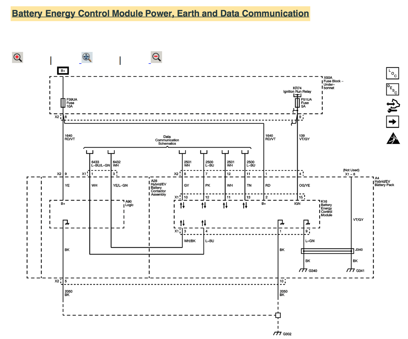

In front of the battery there is a unit which houses two contactors, a liquid heater, fuses and BMS brain unit.
This black box controlls charging relays and contactors. We call it BECM.
Complete BMS system is made of a BECM unit, 4x Slave modules BICM, current sensor and harness to connect them.
I am actually surprised. You can get the cell voltages out of a standalone Volt battery. You have to hook up to the bottom connector of the BECM module inside - connector X1, with the following pins. If you're looking at the factory connector, numbering starts in the top right and moves left, they are the these colours:
1 - Black - Ground
2 - Red - 12V
3 - White/Black - CAN_Low
4 - Light Blue - CAN_High
9 - Black - Ground
14 - Brown/Red - 12V
15 - Orange/Yellow - 12V
16 - Light Green/Light Blue - 12V
BECM will power the slave modules and get voltages from them. Then it will report on its own CAN wires.
BECM CAN bus works on 500kbaud but slave CAN bus works a 125kBaud.
The slave modules on the batteries are wired in a daisy chain so you can put the voltage and CAN on at any point in the chain (though termination should be on the ends)

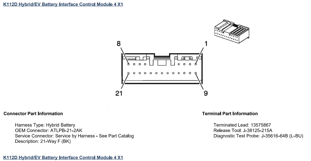

Volt BMS connector - battery side:
ATLPB-21-2AK
Panel Connector - header
S21BA-ATL-2AK
crimp Pin
SAIT-A02T-M064
https://eu.mouser.com/datasheet/2/564/eATL-335076.pdf

arber333 wrote: Fri Jan 17, 2020 7:38 pm Volt BMS connector - battery side:
ATLPB-21-2AK
S21BA-ATL-2AK
crimp Pin
SAIT-A02T-M064
Just what I was looking for.
I have a gen2 volt pack(18kwh). they’ve consolidated the slaves and master into one box and added a few more HV connectors.
Have a gen1 bms and slave/master wiring loom coming in and plan to rewire it to the gen2 and run simpBms.
Now can make a new harness with these connectors, with out stripping the oem harness!
definitely plan on seeing how much similarities /can data is with the gen2 bms
