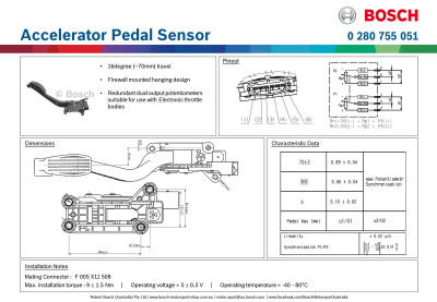

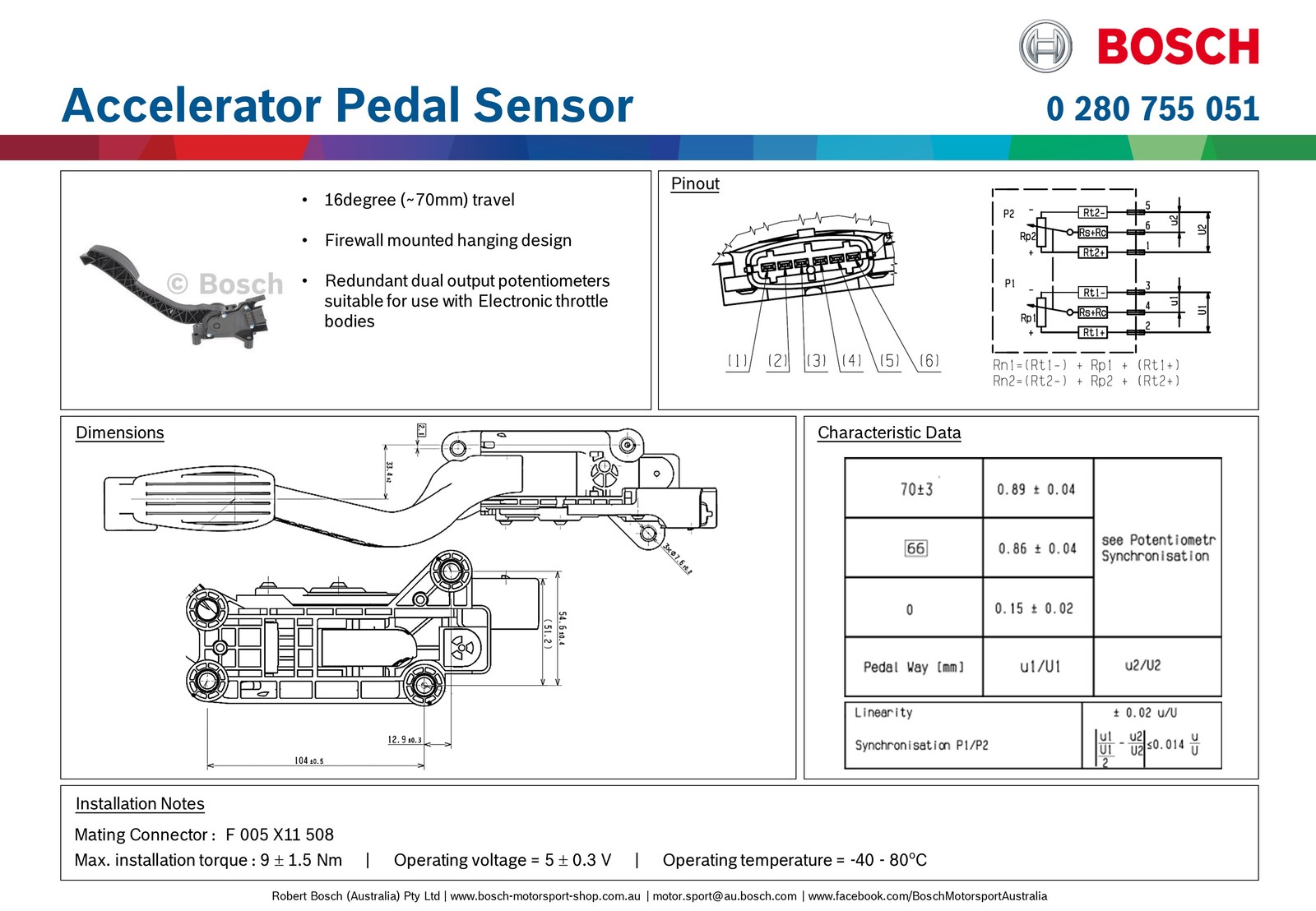

Not exactly the same but potentially the same family of pedals, should be easy to compare.
I've used older bosch pedals that also use the same arrangement, its just a pair of variable resistors. The pins are jumbled about for whatever reason.

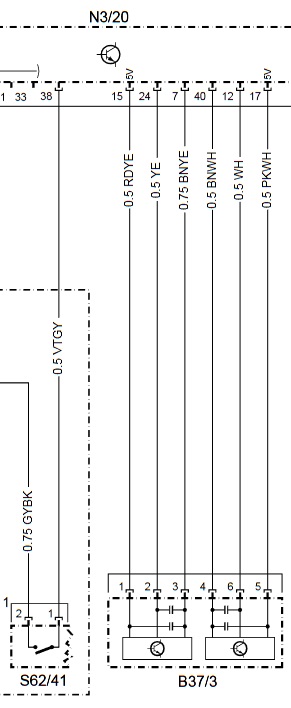

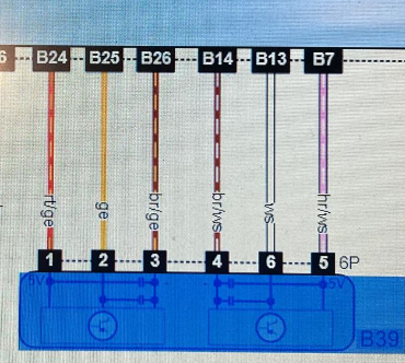

Re: Bosch Accelerator Pedal pinout?
Post by Swing »
To answer my own question, here is the wiring below (note that 5 and 6 are swapped in the picture), all the coloring matched.
Schermafbeelding 2024-03-20 201754.png (248.86 KiB) Viewed 6588 times
So I didn't get anything by measuring resistance.
Knowing the right pins to apply 5v, and I could see the voltage change with pressing it.

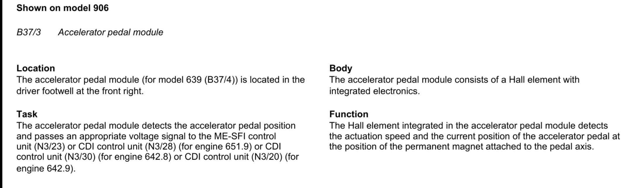

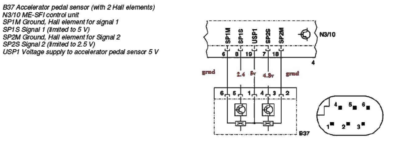

Post by Age »
You were slightly faster than I was... ;)
Here is what I found on my Computer.
B37-3_Pinout_Sprinter
B37_Pinout_B-Klasse
B37_Pinout_B-Klasse
