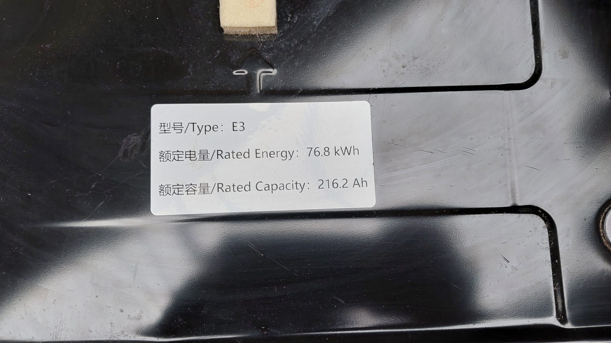

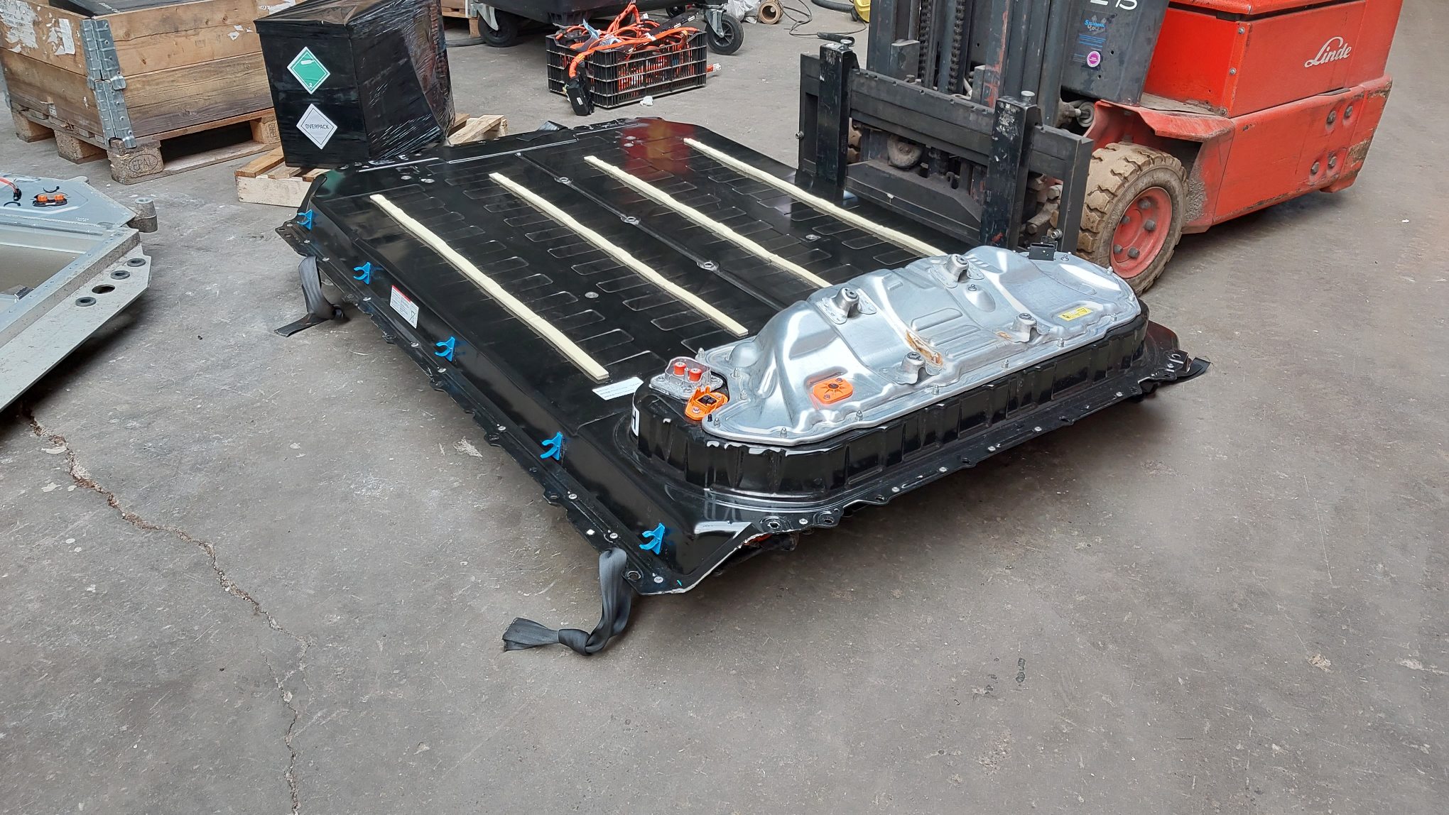

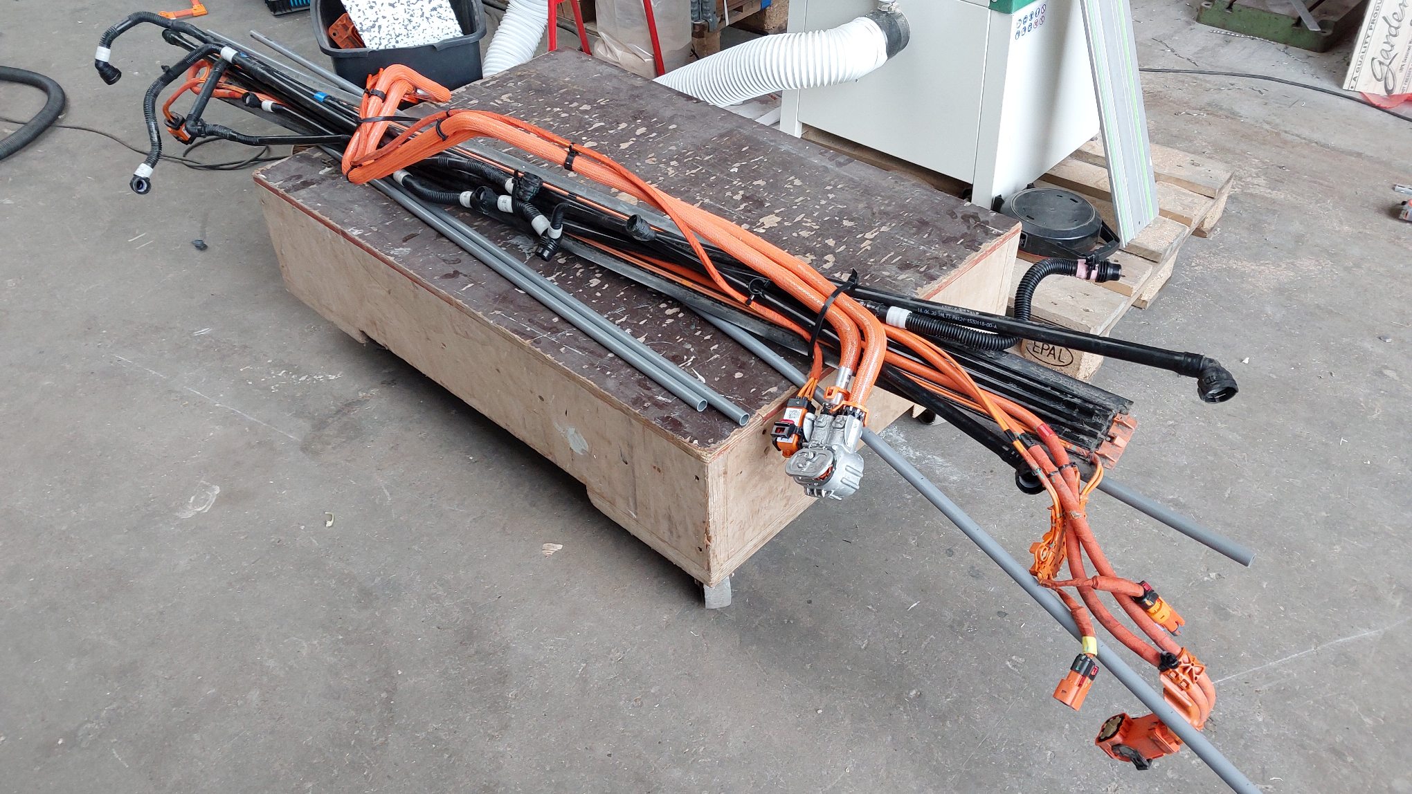

I'm getting more and more Model3/Y packs offered.
I can get them with charge socket and complete with motor also.
VIN number of donor vehicle included
prices fluctuate a bit, but as a guide:
75(?) kWh long range
pack plus charge port incl charge module €5000
above, plus rear motor €8000
above, plus both motors €10500
prices ex. VAT, and pickup in Netherlands (Zaandam)

If you want the charge port to work you would also need the small white module that sits behind the port near the rear light.

Be careful with the forklift as those packs with short modules are light on one side (just air in that part), and heavy on the other side.
They might fall off.

Swing wrote: Thu Mar 21, 2024 8:09 am Be careful with the forklift as those packs with short modules are light on one side (just air in that part), and heavy on the other side.
Ha yes, a friend of mine found out some time ago ;)
