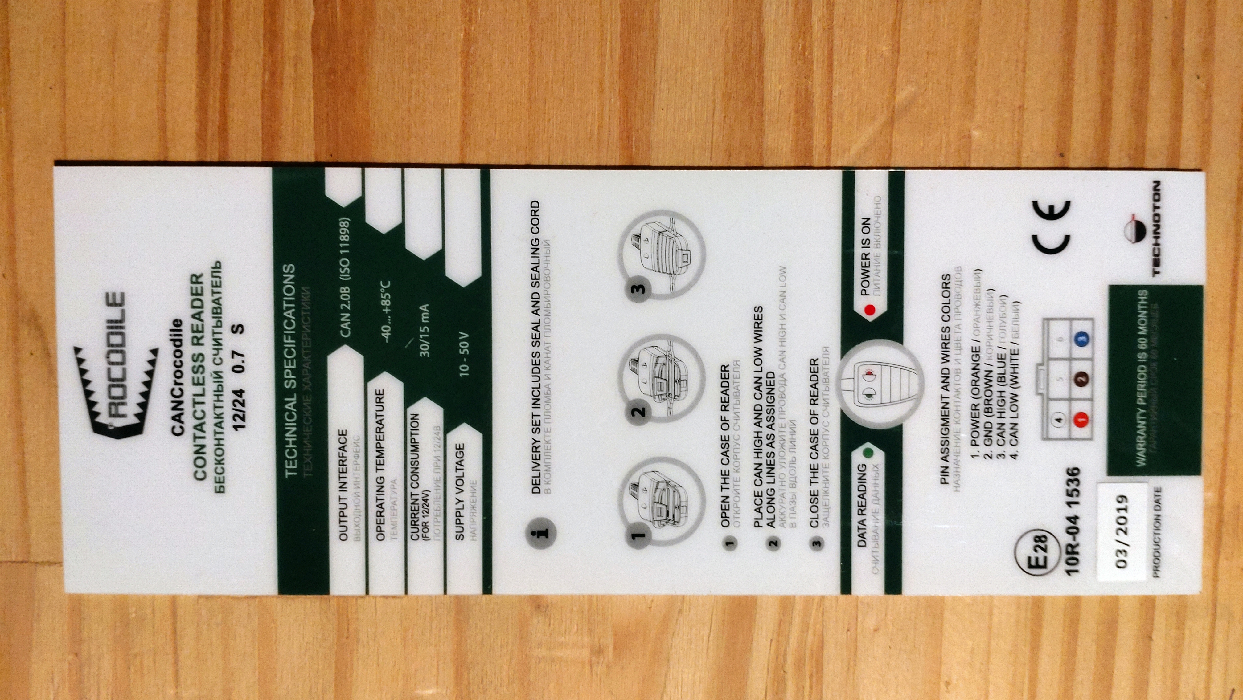

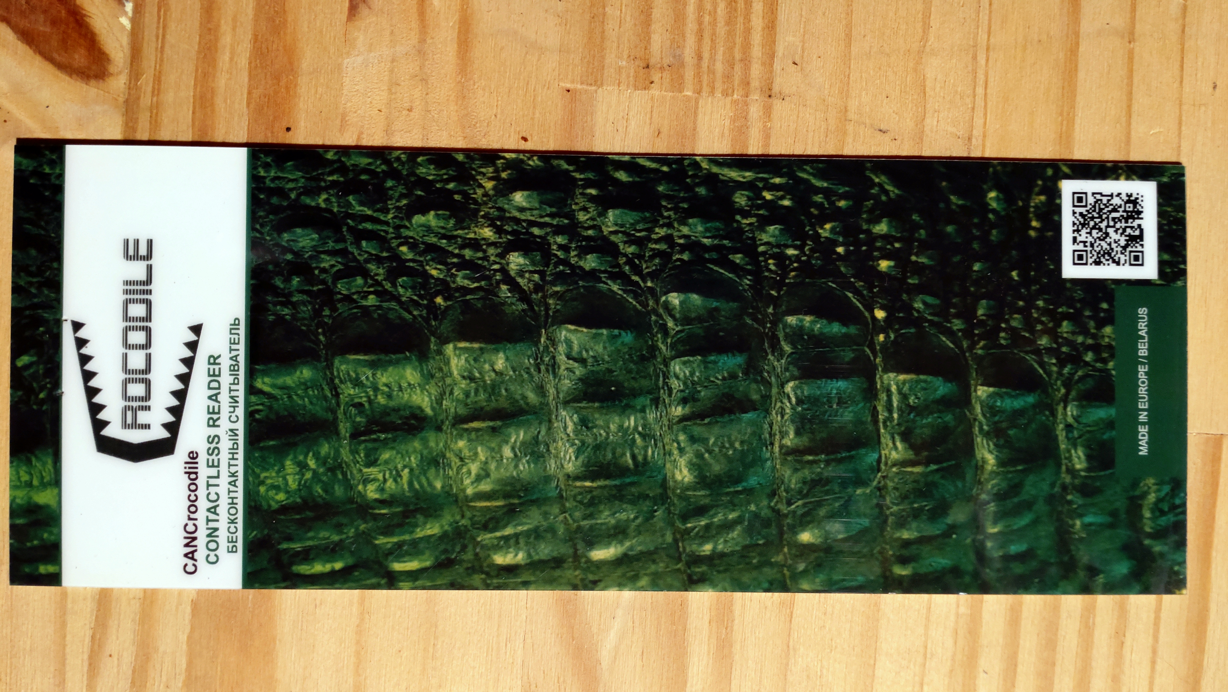

So, I got my CANcrocodile, along with an ESP32-S3-Pico board. My wonderful friend CHATgpt just doesn't seem to be able to dumb things down enough for me to create an interface to use the CANcrocodile to sniff the CAN Bus. Looking for a real person to come to the party...please and thankyou.

Did not get the point where you are stuck. Do you have the CAN hardware running and searching for a software? Or do you have savvyCAN already running and looking for the way to connect the hardware? Could you explain/link/foto what is a CANcrocodile and how you intend to use it?
My setup for CAN is: SavvyCAN on windows laptop. As interface I use my wifican https://github.com/uhi22/wifican which is not much more than a ESP32-S3 and a CAN transceiver. This has two lines on the CAN side: CAN-High and CAN-Low, which I connect to the CAN bus. No crocodile here.

Thanks @uhi22. I'm running your wifican setup. Its working great and I'm mucking about with it to understand things better. I purchased a CANcrododile to read data from working EV's without a physical connection to the can bus. The pickup sensor (crocodile clip) doesn't have an interface, so need to build something.
If I simply connect the crocodile clip to the current wifican setup, I can see that it's reading data, but it's not the same. The attached photo shows a J1708 pickup sensor and the CAN one as well.
Basically, I have savvycan running and would like to connect the new hardware.
Edit. Its now attached

So got,to play around with CanCrocodile today.
From what I understand, in order for the CAN Bus on my instrument cluster setup to function, it requires the ESP32-S3 with wifican and CAN transeiver to be connected - a closed loop. The cluster then sends out CAN data. I see the chassis number passing by on ID 0x65F for example.
I then connected the CanCrocodile CAN-H and CAN-L to the same Can BUS. Added an external 12v and GND.
As soon as it is connected, the Can BUS stops sending data. Chassis number stays on last displayed info.
I then connected the CanCrocodile in parralel (with another CAN transceiver) to the TX and RX lines, as well as the CAH-H and CAN-L. Identicle shutdown of data sending.
Should i be setting up and independant interface to use with the CanCrocodile?
