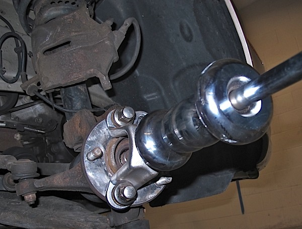

yeah you'll want to make a piece of steel with three holes, so your slide hammer is centred on the flange. Bolt your steel on where the CV attaches.
This is a wheel hub, but you'll want to end up with the same alignment:

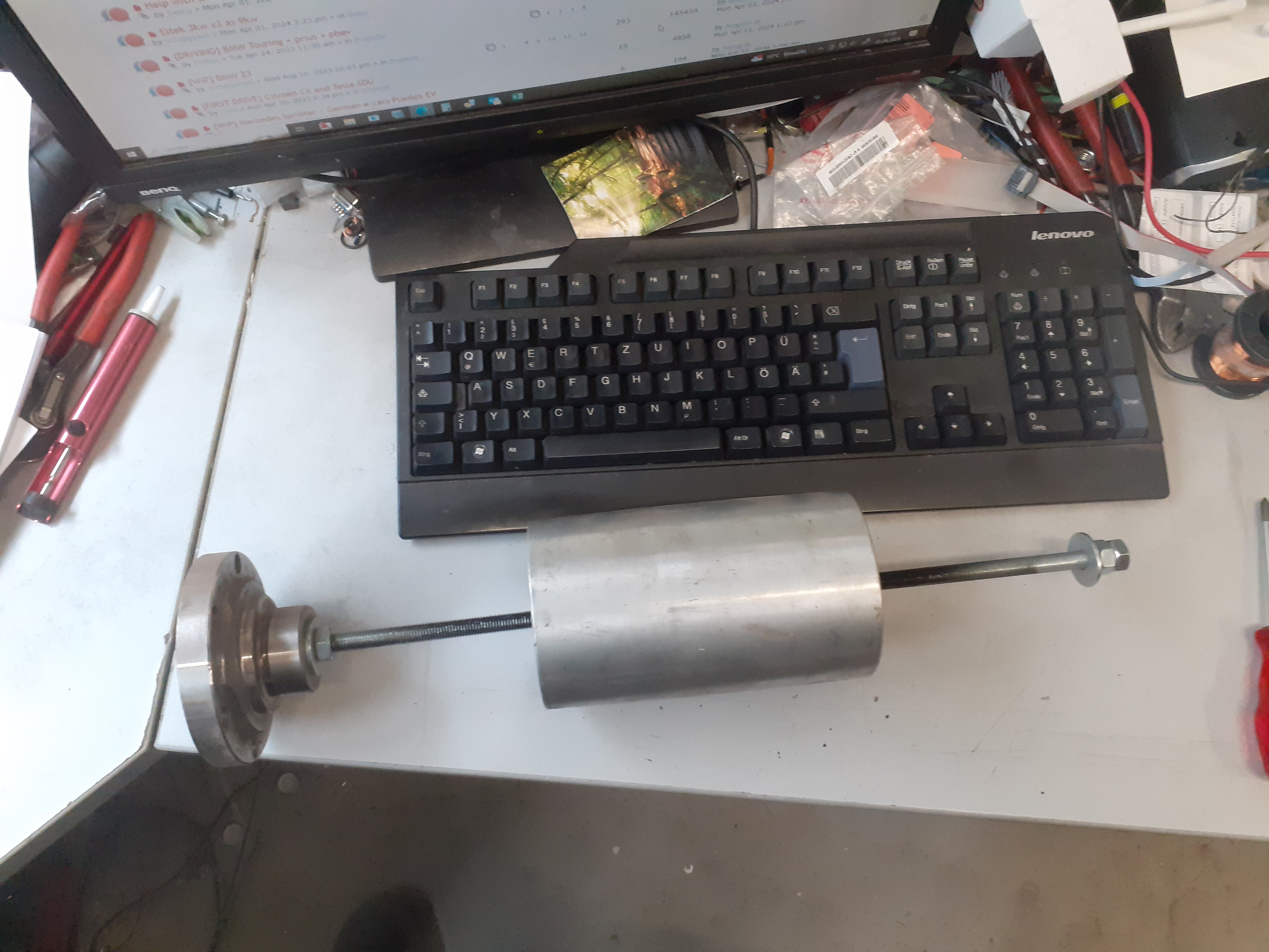

What did you use for the attachment piece? Is that a machined piece or something reused?

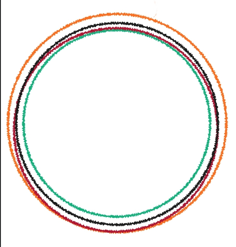

I haven't found a source for the retaining rings yet. If you have an axle rebuilder nearby they can likely get them or might have them in stock.
As for getting this style axles out, some have too sloppy of a bore for the retainer spring and the spring can get out of place to where it binds between the ID (Green) and OD (orange). The retaining clip (red) needs to be aligned concentrically with the black circle but it can fall down to the OD or even past if the groove isn't designed properly or it's the almost right retainer clip that floats too much. The clip blocks the splines from pulling out on the sides where it overlaps the ID & OD.
So what has to happen is you rotate the stub axle as you gently pull out or do a quick twist and a quick pull mid twist and keep trying for the clip to fall into the right place. When it is in the right place the stub axle will pull out a little bit more than it was / you can feel the spring being squeezed while pulling vs. feeling like it's just hitting a wall. You have to keep slight outward pressure to keep it in the right spot once you get it until you can pop it out.
If you pull hard enough to distort the retaining ring it can get very tough to get the stub able out.

Do you have a limited slip differential from Quaife? In my case, the shafts slipped too deep into the differential so that the spring was not in the right position and the shafts could no longer be removed without destroying the spring. I then made spacer rings to limit the travel.
