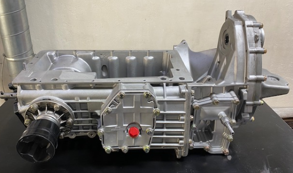

The Saab 900 is a FWD with longitudinal engine and transaxle bolted underneath the engine.
I think it would be challenging if not impossible (due to available height and diameter of motor) to mount an electric motor to this arrangement.
Probably easier to make new motor mounts and mount the whole motor/reduction box assembly as one with new custom drive shafts.
Outlander won't reach your power target - so Leaf or Tesla small drive unit would be better, Tesla quite a bit more powerful/expensive. Leaf with the right inverter will be capable of your power target.

Re: SAAB 900 Conversion (UK)
How available are the 900 transaxles? You could likely adapt a motor to fit in the oil pan area but you might put too much power through it to last.
I’m sure they’re available I can see a few that in breakers yards but probably better to get something fabricated if they potentially won’t handle the projected power?
