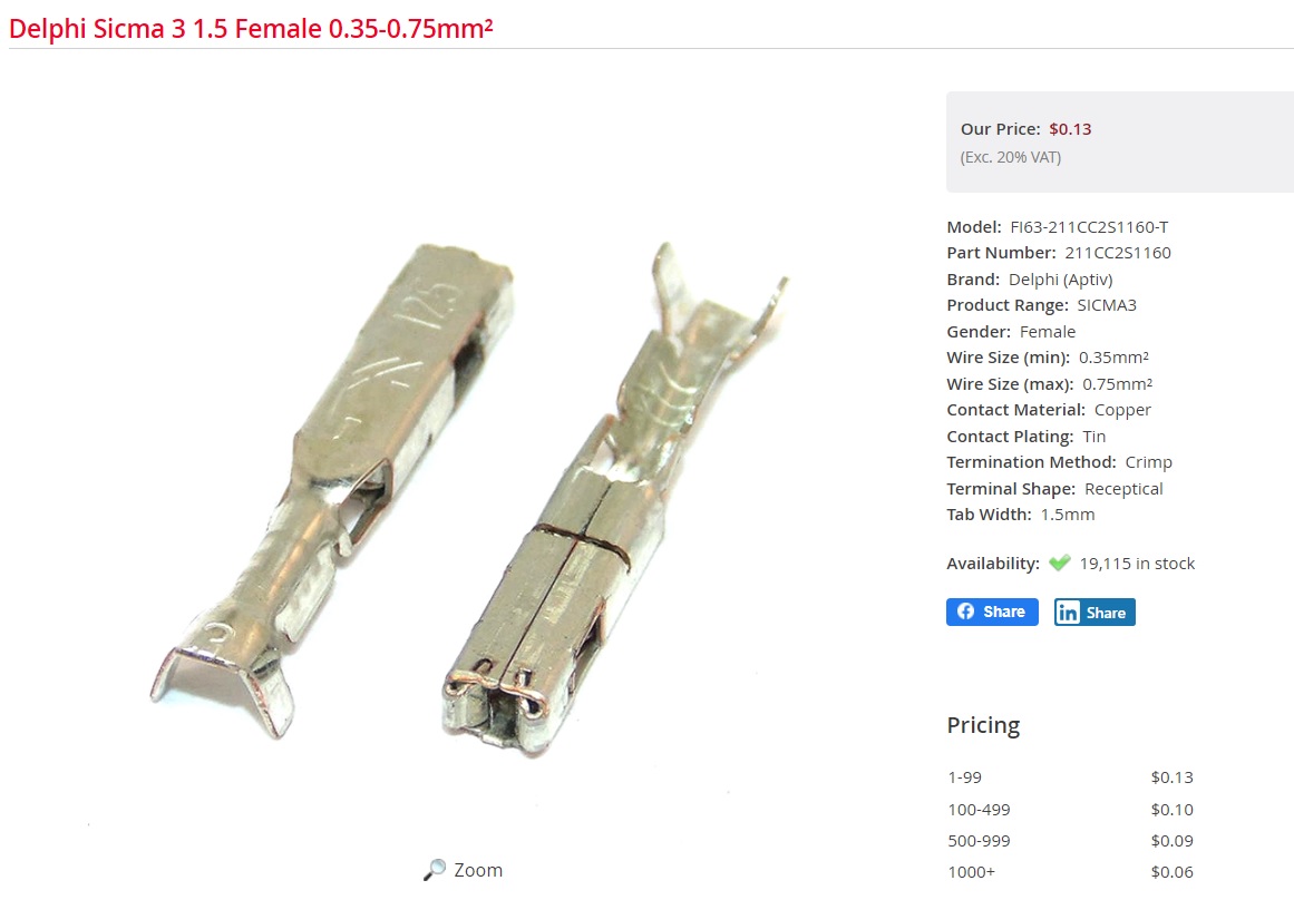

here is a nice close up from Delphi but they do not mount in this position, what I would call natural horizontal here in the pic, instead they flip on their side and mount vertically, a bit unusual. None of this may make any sense to you until you go to pin one on and then you will have the typical WTH moment.
FI63-211CC2S1160-T.pdf
(210.18 KiB) Downloaded 186 times

Manufacturer part numbers of the pins seem to be 211CC2S2160P for the bigger one and 211CC2S1160P for the smaller one. Reasonably priced on RS.
