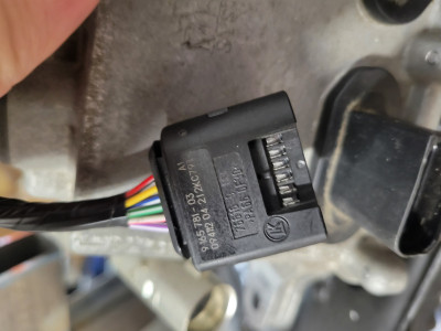

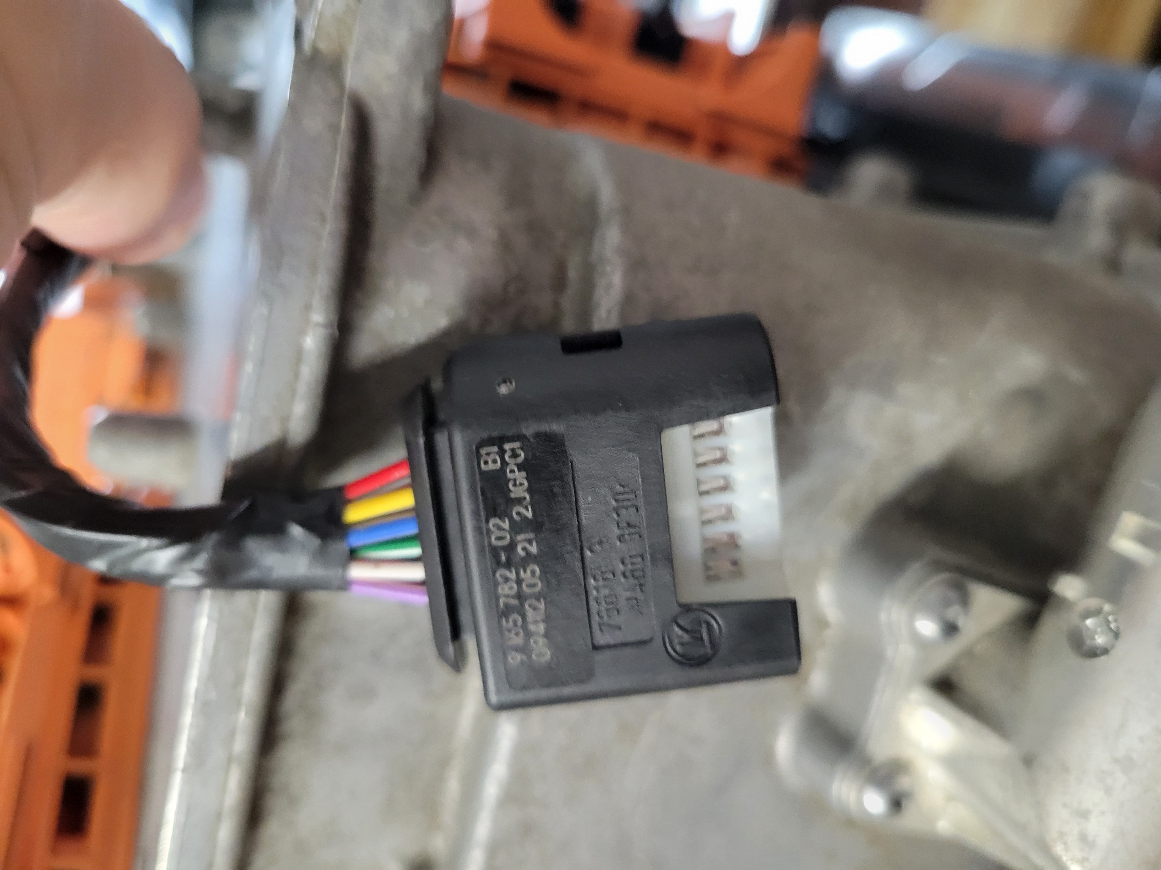

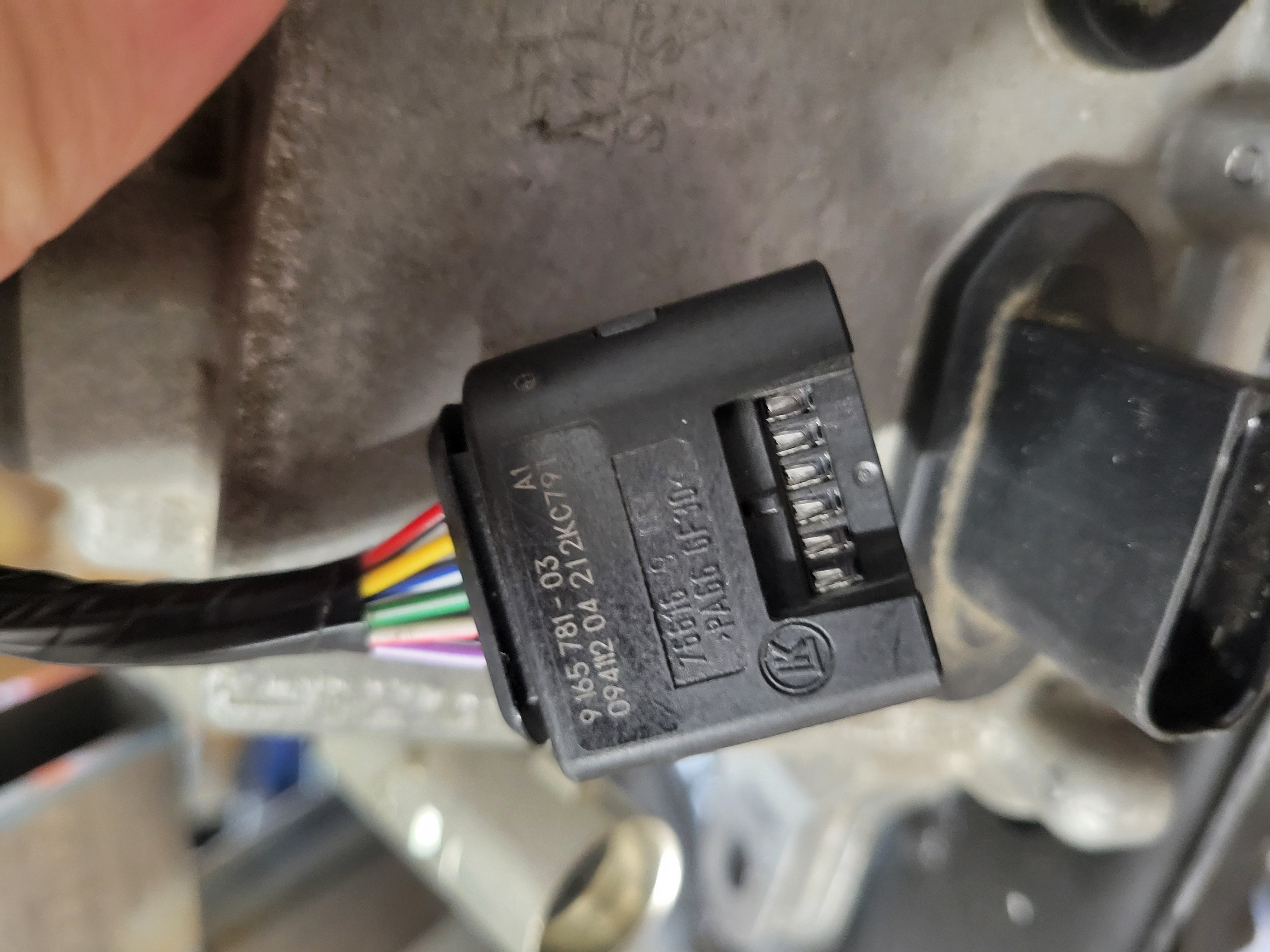

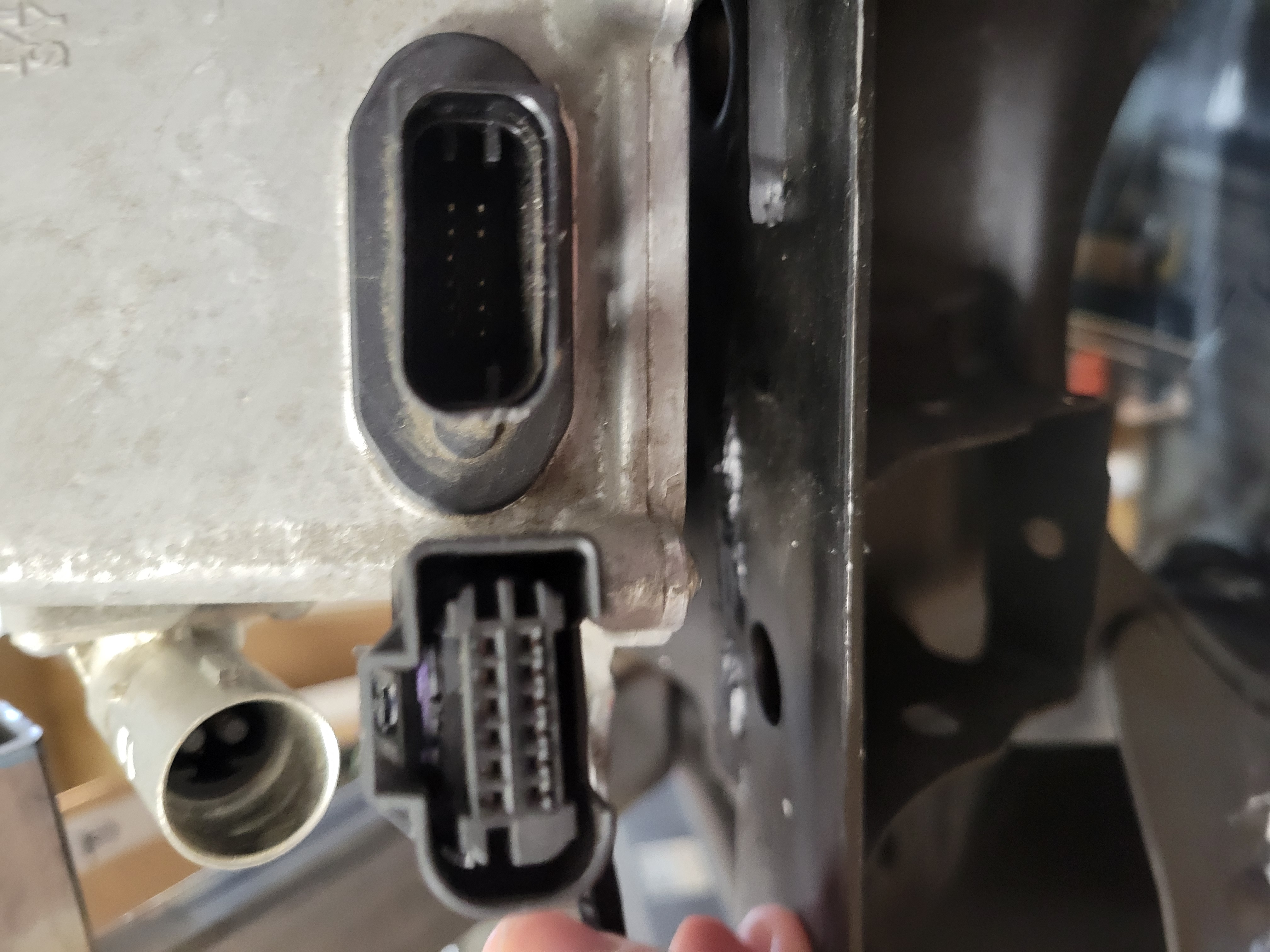

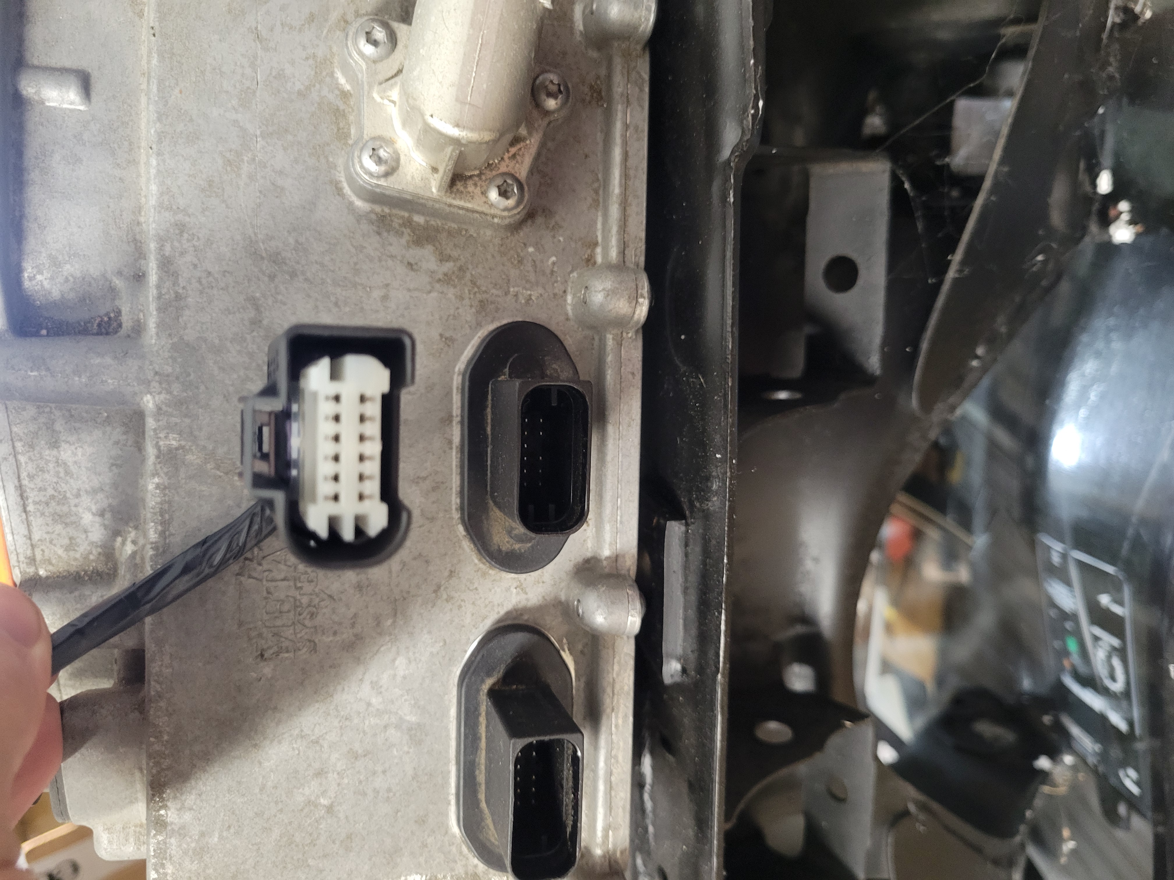

after some substantial effort I was able to locate the 12v connectors for the i3 KLE with fast charging. I plan on utilizing this as a HV junction box for my build, so I will be documenting as much as I am able to this and then to the wiki once everything is complete.
for now, a link to the parts i found and the part#s written on the connectors themselves
connector A (shared with both fast CCS and non-CCS KLE): 9 165 781 - 03
connector B (unique to CCS equiped KLE): 9 165 782 - 02
link to part found on aliexpress: https://www.aliexpress.us/item/32568062 ... ry_from%3A
