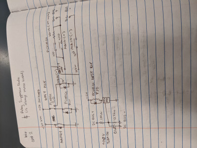

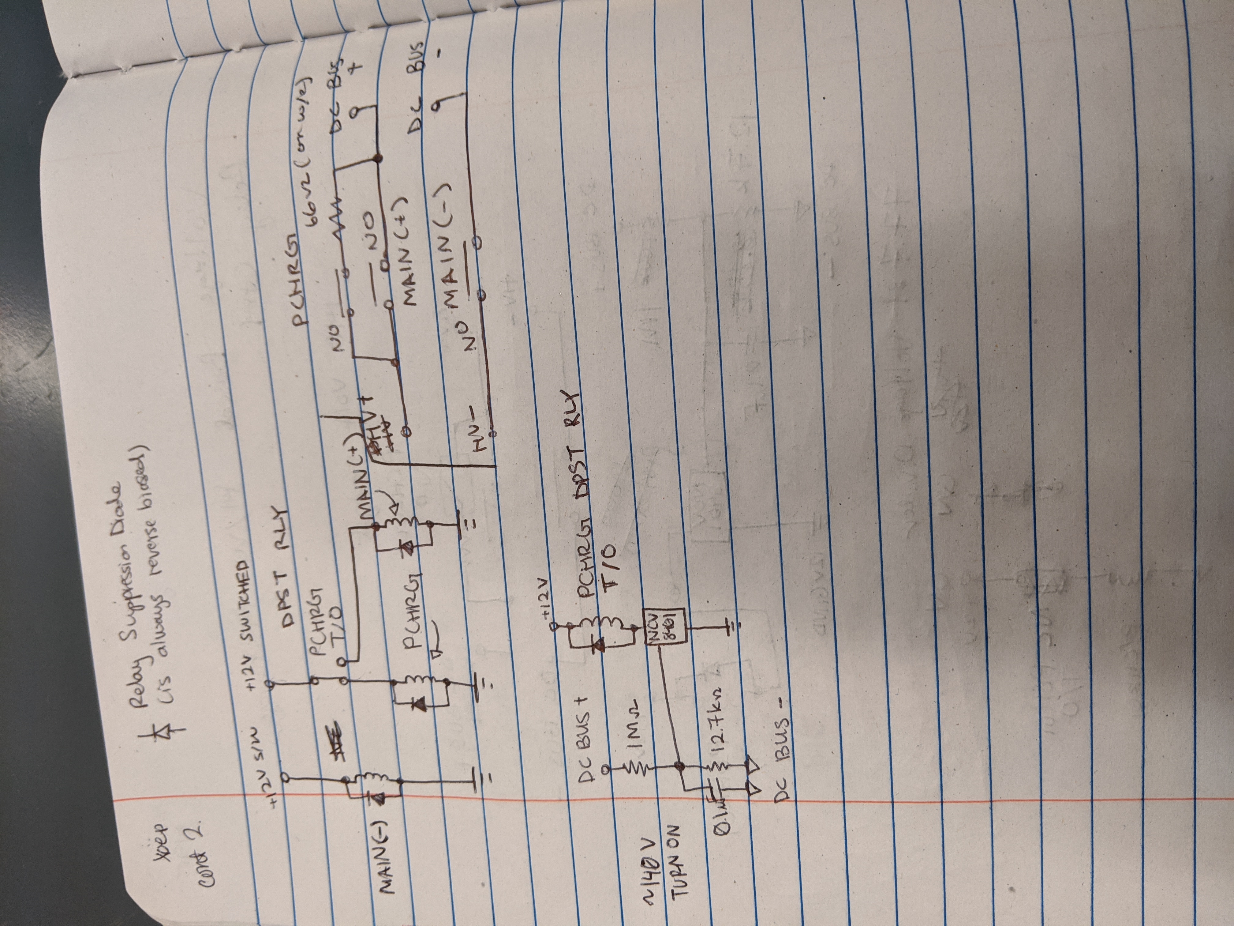

I was thinking about this the other day, and Drew up a simple (read: crude) hardware Precharge circuit. Any reason why this wouldn't work?

Looks like it would work. As long as you're happy with the resistor divider values (switch on voltage). Could there be a chance of the Precharge T/O relay chattering?
Maybe benefit with some hysteresis?
