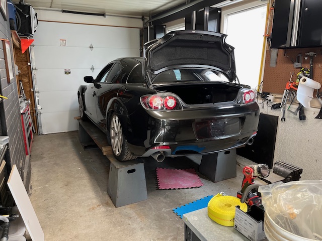

Hi everyone,
I always wanted to build an electric car, and finally took the plunge last year and bought an RX-8 off a friend with a blown motor.
I then lucked out and found a Tesla sport LDU on facebook marketplace for a good price.
I managed to get the LDU up and running on open inverter..
https://www.youtube.com/watch?v=YUMFOA6nCZY
I recognize that while RX-8's are cheap and plentiful,. this is going to be a very hard road,.. because:
  • Its CANBUS
  • Its has a short track width
... I am now strategizing (and stressing to be honest) over how to mount it....
I realize that no EV swap is going to be cheap,. but I am still aiming to be cost conscious as much as I can here..
Considerations:
  • RX8 Rear Track Width - 59.3"
  • RX8 Tire diameter (18" rims) - 26"
  • RX8 1st Gear Ratio - 3.815
  • RX8 2nd Gear Ratio - 2.260
  • RX8 3rd Gear Ratio - 1.536
  • RX8 4th Gear Ratio - 1.177
  • RX8 5th Gear Ratio - 1.000
  • RX8 6th Gear Ratio - 0.787
  • RX8 Rear Diff Ratio - 4.7
  • RX8 Space with between rear body frame in trunk is 29"
  • 2012 Tesla Sport LDU Ratio - 9.73:1 (18,000 RPM Max)
  • 2012 Tesla Sport LDU Width - 32"
  • 2012 Tesla Model S Rear Track Width - 67"
TLDR
I am currently planning to go with the last option (G) which involves customizing the rear crossmember, separating / relocating the inverter, and mounting the LDU offset towards the passenger side by 2" (resulting in one shorter and one longer axle).
Candidate Architecture A: LDU to RX8 Transmission

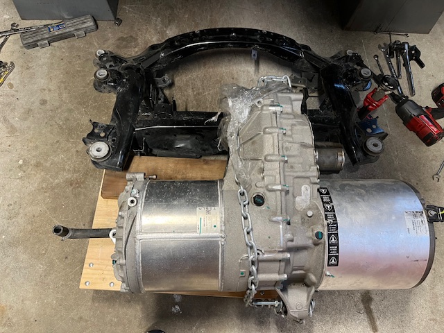

Candidate Architecture E: LDU to RX8 Axles (RX8 subframe)
Strategy:
Modify the factory subframe to accommodate the LDU. Cut the rear trunk / spare tire area.
Reference Examples: Pros:
  • Room for batteries under hood and in transmission tunnel
  • Higher margin of error as axle axle can vary a little.
Cons:
  • Need to have custom axles created
  • LDU needs at least 32", but clearance between rear upper control arms is 31.5", and RX8 frame is 29". :?
Conclusion:
TBD - would be very tight..... :?

Candidate Architecture G : LDU to RX8 Axles (RX8 subframe + inverter relocation)
Strategy:
Relocate the inverter using this kit for $1650 Euro (https://evshop.fr/en/home/357-tesla-lar ... asing.html). This means the LDU motor will fit within the subframe, but it will have to be offset towards the passenger side by about 2" (instead of having the differential in the exact center). One axle would be slightly longer and one slightly shorter (like many FWD cars).
Reference Examples:
  • None
Pros:
  • Less customization needed for subframe. Body Frame doesn't need to be cut, just trunk / spare tire area.
Cons:
  • Need to purchase inverter relocation kit
  • Differential center point offset by 2", could have some amount of torque steer.
Conclusion:
Viable
My current plan is to pursue option G (custom subframe and relocated inverter)...
Will post progress if I manage to progress further..

Re: 2009 Mazda RX-8 + Tesla Sport LDU
I would not separate LDU inverter from motor. It was not designed for that. You may create undesirable effects EMI or even kill inverter in the long run.
RX8 was made for very low engine - Wankel is low hanging, and you cant fit anything other than electric motor on its transmission. Here we have done several conversions of RX8 with various electric motors on transmission.
- Leaf gen 1 and 2 motors with chevy Volt inverter
- Emrax 228LV motor with 900A inverter (sorry i was mistaken about motor dimensions from 268...)
- indigenous ACIM motor with custom inverter
Mostly we fit batteries in front and under the location of the fuel tank. I have seen one guy cut into the rear trunk and fit one battery row there. This would mean you must use the motor in front then.
I have yet to see RX8 with GS450h or GS300h inplace of OEM transmission. Maybe you could try with that since it would be a better fit and still good power.

What about the option you didnt consider yet...:
1. Mount the LDU in the front lengthwise as far inside the tunnel as possible
2. Connect the rear facing halfhshaft to Mazda driveshaft so that you can get the full Tesla speed from the motor that way
3. You fix the front facing halfshaft by some transverse shock mounts and construction to fix the torque from one side.
You could do that without hugely expšensive kit you just need to think on how to transfer that torque from the front...maybe making a bracket and weld the front shaft directly to it...
See if your project will allow such a setup

I have to admit that's pretty creative and I hadn't thought of that.
So the engine speed would effectively double,. but I could just drive around in 5th gear instead of second.
Its similar to option B though in that the engine bay is too small to fit the LDU when its offset to one side (since it has to sit on one side so the axle points down the middle towards the drive shaft.
Also, it means I still have the drive shaft, transmission, and motor taking up space in the engine bay, leaving less room for batteries.
It also means Im adding to the car weight without removing anything (the Mazda diff and transmission are still there).

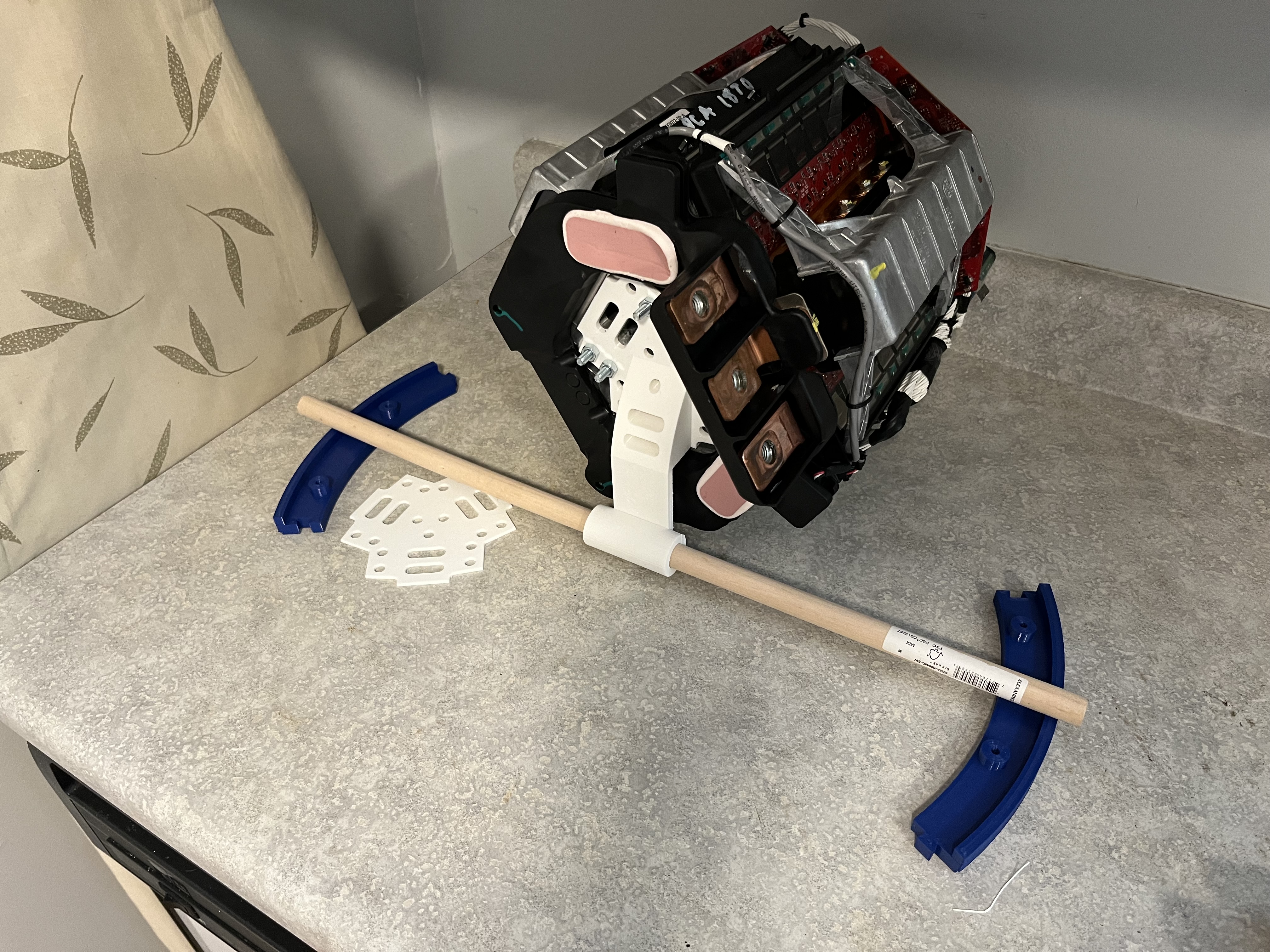

Ultimately I have convinced myself that separating the inverter is the easiest path here.. I only need to extend the 3 phase wires by about 6 to 12 inches so it can sit just above the motor pointing upwards rather than sideways pointing to the passenger side.
I have a milling machine and a welder so I think it should be pretty easy to make some coolant passage adapters that adapt to the hoses.
My thinking is that extending 3 wires and 6 coolant hoses by less than a foot should be easier than trying to change the suspension geometry.
The inverter came off pretty easily tonight. I have added a bit more info on the inverter removal process here:

Well I have made some progress recently,..

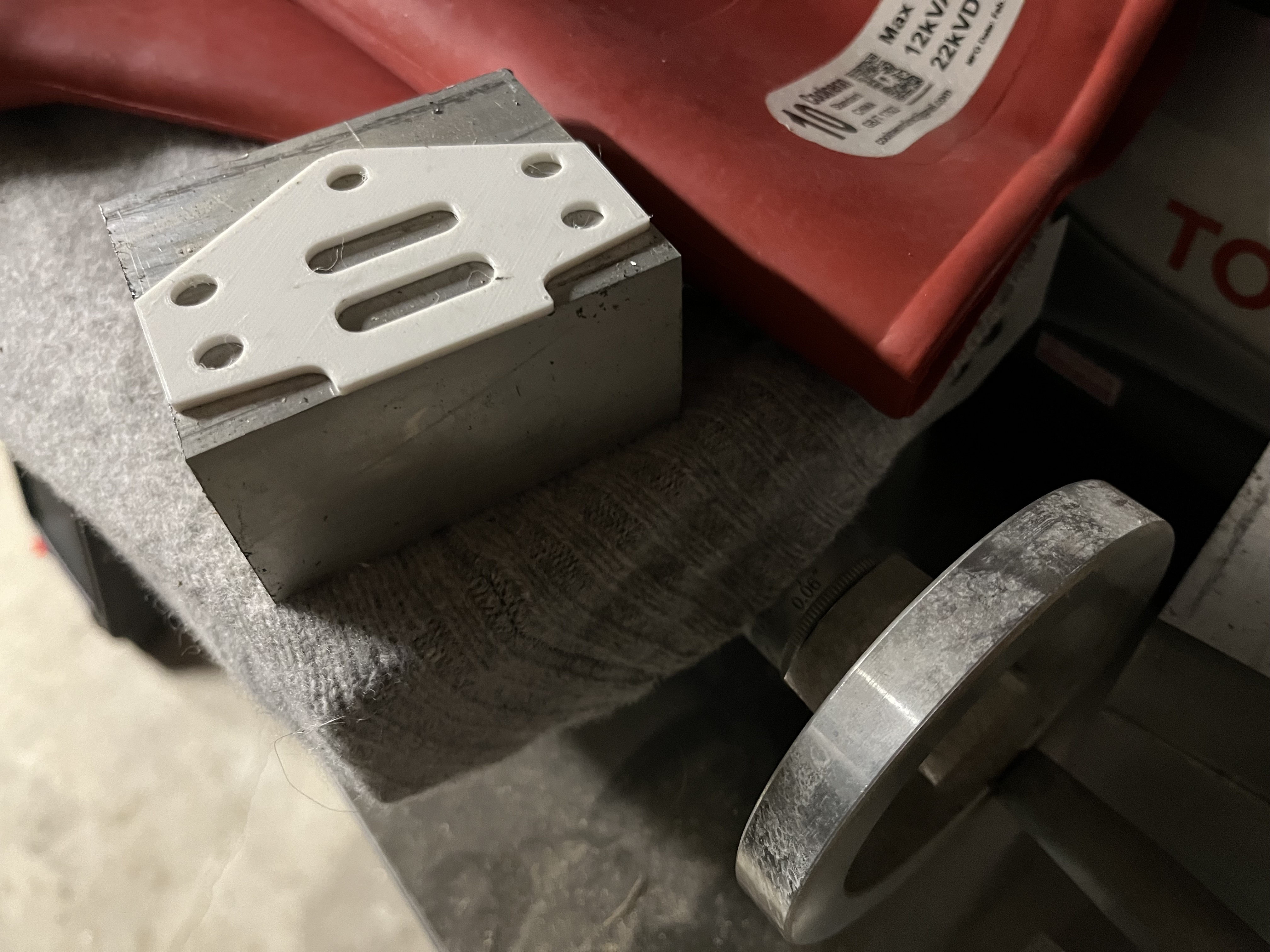

I designed and 3D printed a goofy stand for the LDU inverter so it wont tip over while its waiting for its new home:
and bought some aluminum blocks to machine some coolant adapters with:

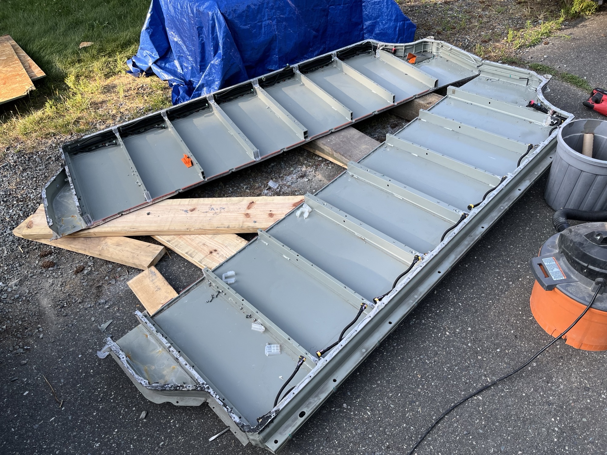

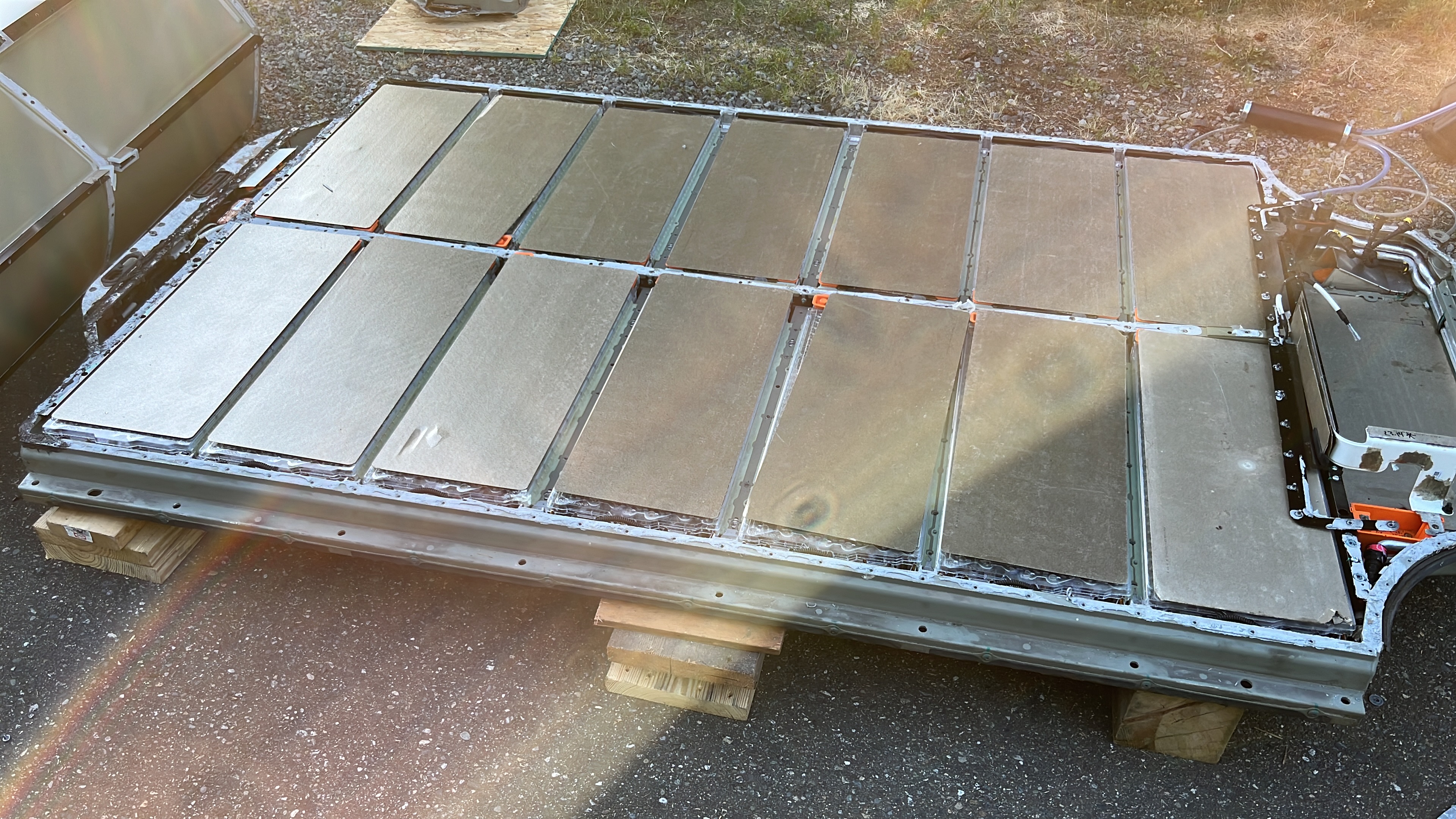

but then,... I spotted an 85kwh Tesla pack of facebook marketplace this week for what seemed like a good price.
Stupid me I rolled the dice and jumped on it.. In hindsight though,. I think it is probably a pretty bad pack... :?
More on that story here:
viewtopic.php?t=5181

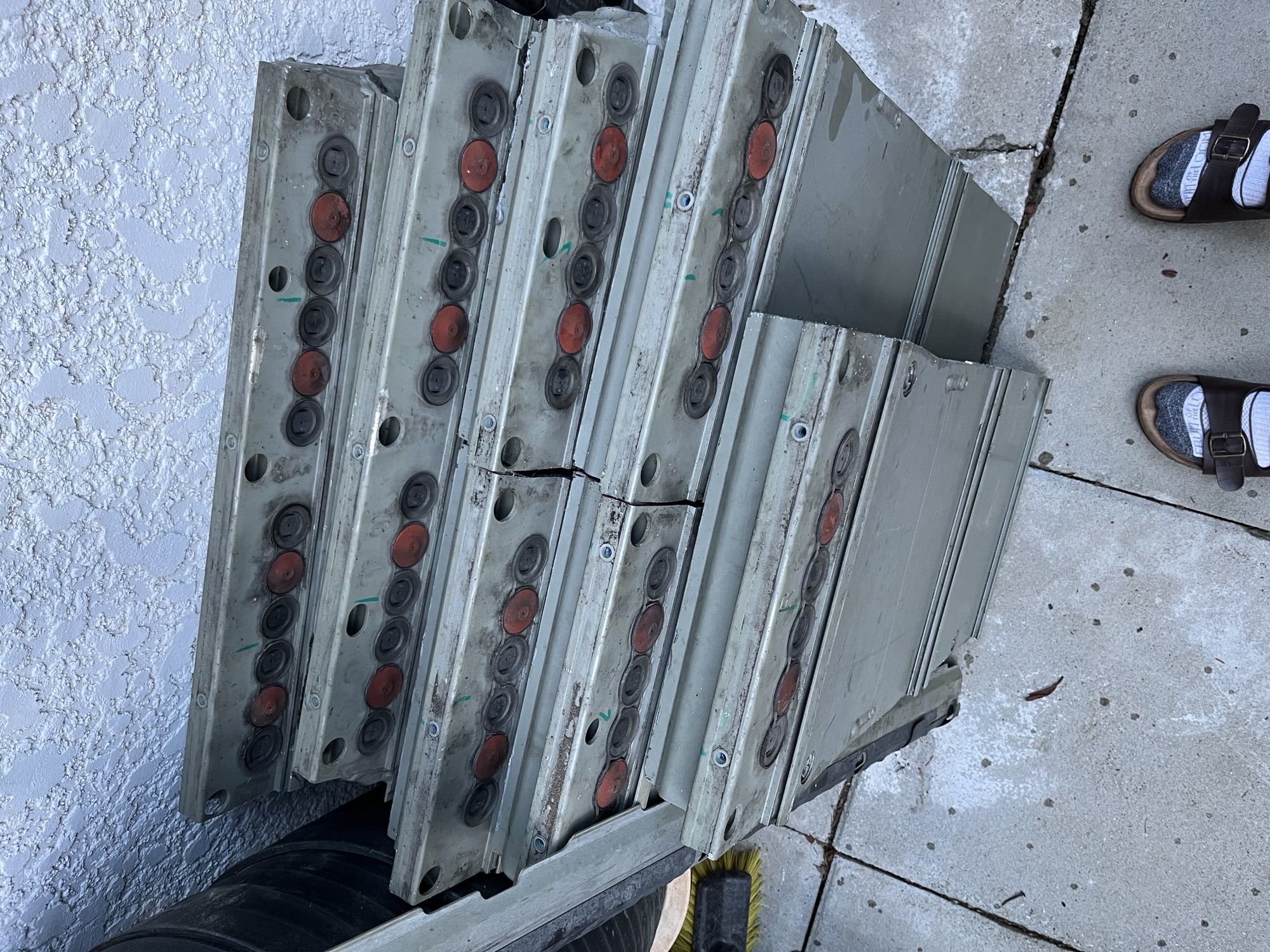

Dismantled the pack tonight on the driveway in about 4 hours with some high voltage gloves from amazon and some serious butt clenching.. :twisted:
Hopefully I will get lucky and there will be at least 6 that are viable. Fingers crossed...
If anyone has any good articles or videos to watch on testing these modules please do let me know. :)

10 of the modules had some small amounts of rust/corrosion on them and I had a big freak out worrying that the modules might spontaneously catch fire in the garage and take my house with them...
Between selling some and giving a few away, I ended up with 6 seemingly viable modules for a total cost of $1800. Not enough for 400V obviously,. but enough for test fitting and learning how to make the BMS work.
I also decided I may as well chop up the aluminum battery tray into little battery boxes that I can mount in the engine bay and where the gas tanks were etc.
Will have to weld up a top but at least it gives me some boxes that are already about 60% done.
Two doubles, and 5 singles.
