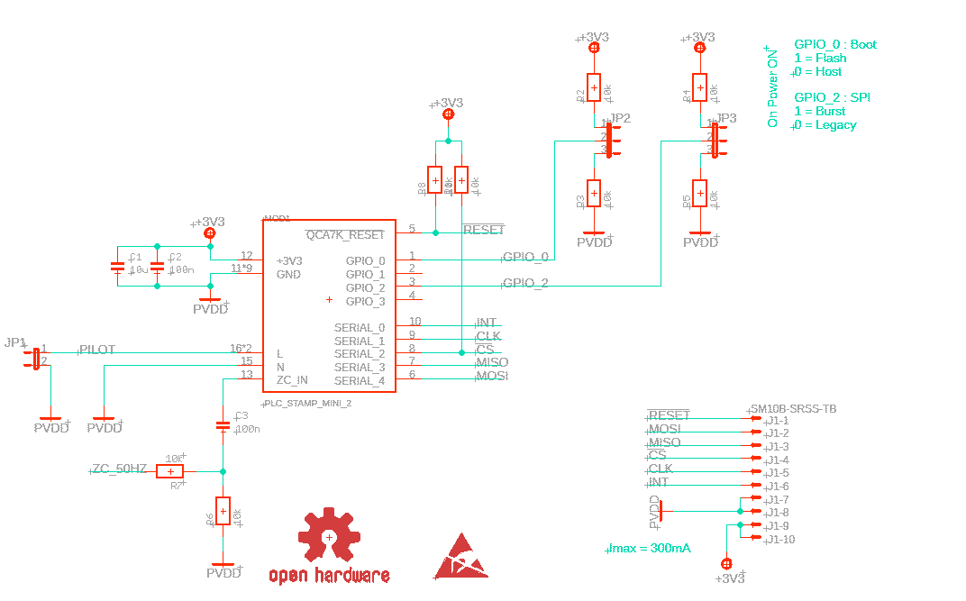

From the datasheet of Chargebyte product, I'm starting my board with some questions.
Is the Zero crossing function necessary as the communication is done on the CP line?
I will use a NanoPi Neo as SBC, so do you advise to better rout my board as a SBC's HAT or can I used wires?
Nicolas

Hi and welcome.
I'm not sure whether I got what you are planning to do, but just continue
The zero-crossing is not required.
For the beginning I would start with dupont-wires to connect your board to the host, this gives flexibility to change as you like to a raspberry, beaglebone or esp32. This could help for trouble-shooting.
Edit: If you plan to develop a board for the car side, you could also use a Foccci, de-solder the STM32, and plug the SPI (and some digital signals for state C, LEDs, etc) to your linux machine.
