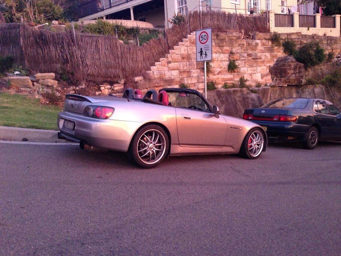

I'm converting a Honda S2000 to EV.
Http://youtube.com/@evs2k
I started this project by buying a Tesla SDU and fitting it to the S2000 subframe.
I then went on a search for batteries and electronics to fill the rest of the gaps. I needed a modular battery so I could custom package it in place of the engine and gearbox. Tesla modules just won't fit.
I purchased two crashed MG ZS EVs, built one good one, and was left with all the parts I needed (or so I thought).
The issue I have is voltage. The MG pack is 108s. That's a max voltage of 453v. The SDU is rated at 420v.
I've heard everything from 'within margins' to 'it'll blow a cap/IGBTS'.
I've also heard suggestions of just use 16 of the 18 modules. Easy. Just means none of the other electronics (BMS, charger etc) are any use.
Would love to get some opinions on options. Run it and cross fingers? Settings in OI? Update caps in SDU? Reduce pack and spend up on Orion BMS, aftermarket charger, etc.
