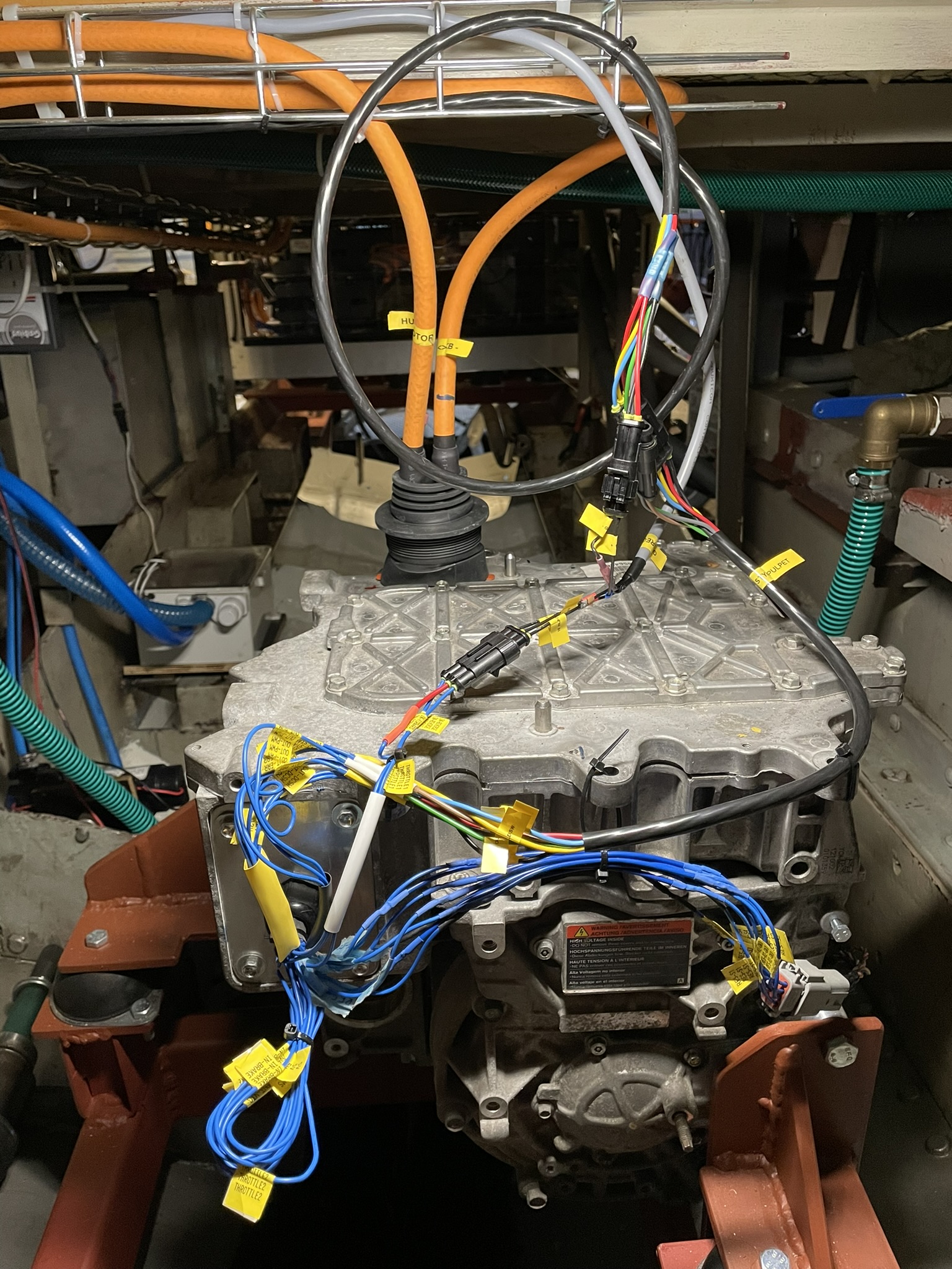

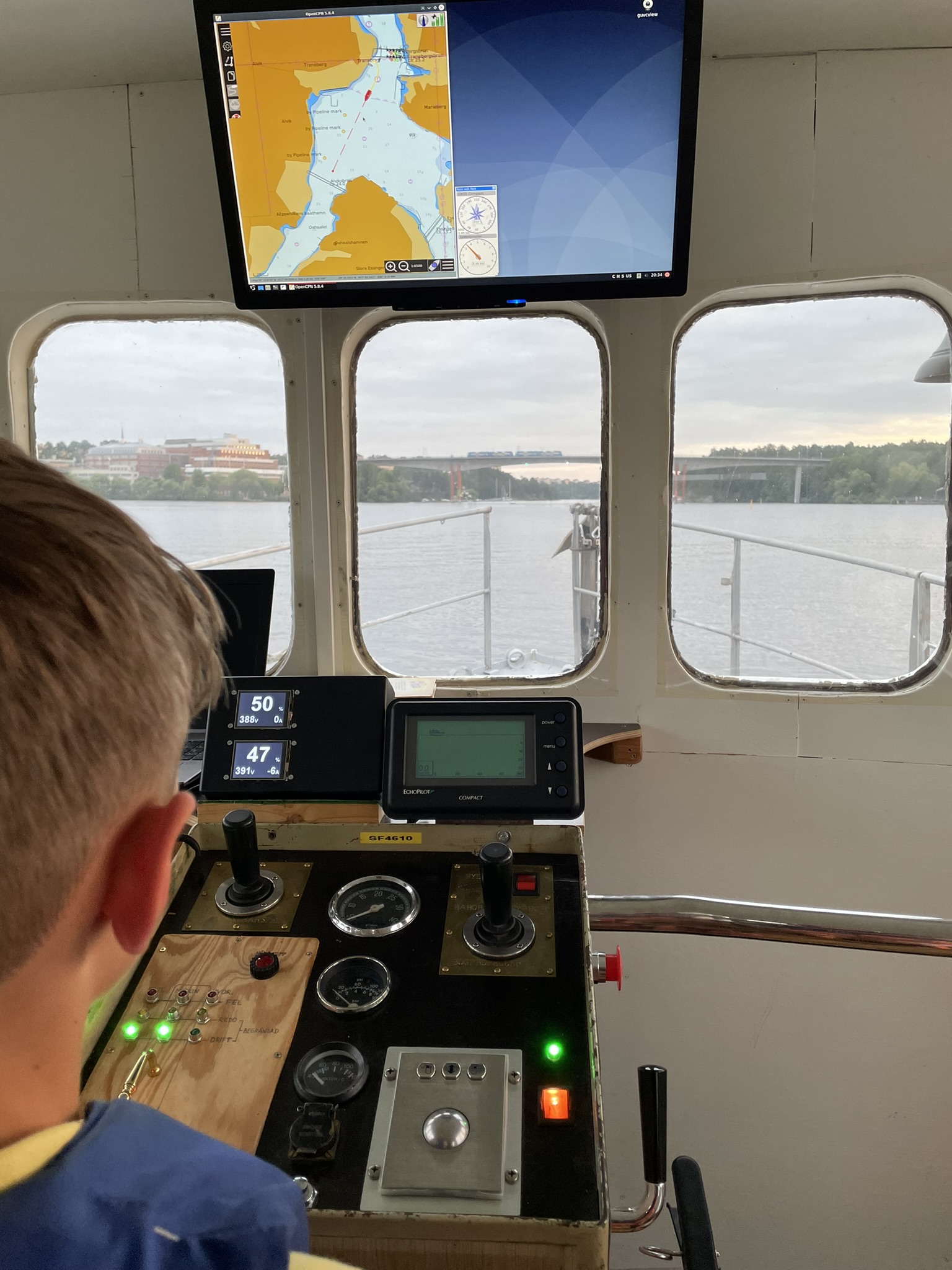

I have put a Leaf motor in my boat. It's an EM-57 with a gen 3 OI board.
The other day when we were out on a test run the motor suddenly stalled and I believe came to a complete stop. Boat still making some speed. After a little while it came on again. This repeated a few times until I made it back to berth. To make sure to have controlled starts I shut of the motor and restarted the rest of the times it happened.
Today we ran a few tests still tied to land. I suspected a few things about noise from pumps to bad throttle. But everything worked as good as one could expect. That led me to believe that it is happening when I am reaching the speed where I am not accelerating any more at a certain throttle position.Tied to dock we are constantly "accelerating" from a motor perspective. Does that make any sense?
What can I do to confirm this or what other tests can I run?
A couple of photos for attention:

Nice project :-) Just a few ideas with my limited knowledge:
- Is there already a "boat mode" implemented? For car usage, the throttle is just giving a torque request, which leads to increasing rpm on an dry boat. As far as I know for boat a speed regulator would be normally used, to have a certain thottle position leading to a certain, regulated RPM.
- You could observe the spot values of the pot and the error information (lasterr), maybe this gives a hint what is going wrong.
- Maybe also a temperature issue or low voltage, should be visible in the spot values.
