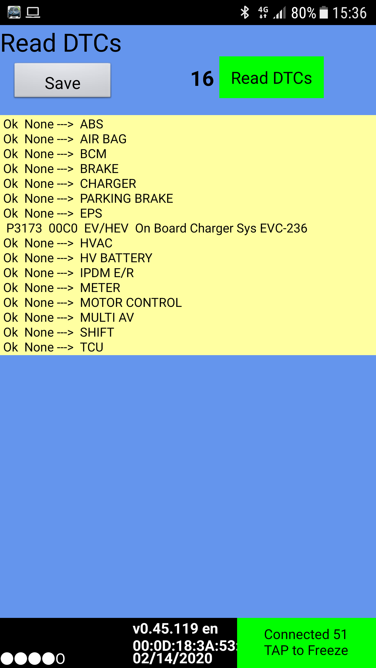

The main problem is the car is in limp mode (limited to 30mph) with the dtc as in the picture. My mains need now is to get it out of limp.

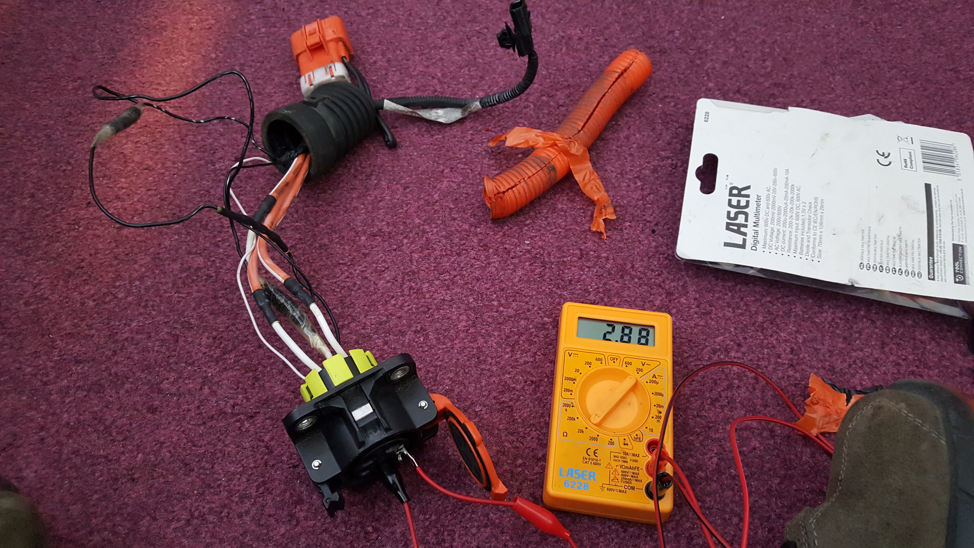

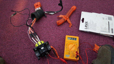

So turns out a gen 1 leaf charging port is smarter then me. Who knew. Our Nissan friends decided to add a 2k7 resistor between ground and proximity and measure that to ensure someone like me hasnt been messing with the wiring. Oh and of course wrap it in tape to keep the wet in. Oh no! the resistance of the wet has pulled the proximity line out of spec! SHUTDOWN! SHE'S GONNA BLOW!!!

So did you dry it and get it working now?
Thats good to know.. no more pressure washing engine bay...
- Posts: 3663
- Has thanked: 11 times
- Been thanked: 346 times
Re: Leaf Gen1 Charger Upgrade
Yes. Up and running. So in order to work out the messages required to replace the charger I'll need a CAN "man in the middle" board. Looking around the web there seem to be quite a few but of course none actually available for sale and naturally none opensource. Oh well. Guess I'll just give up....

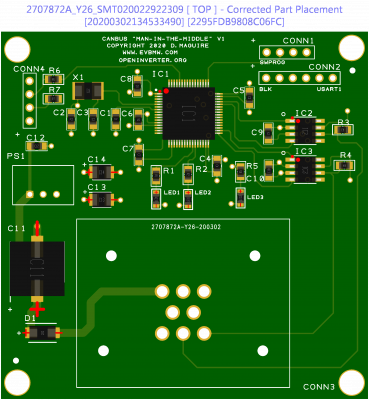

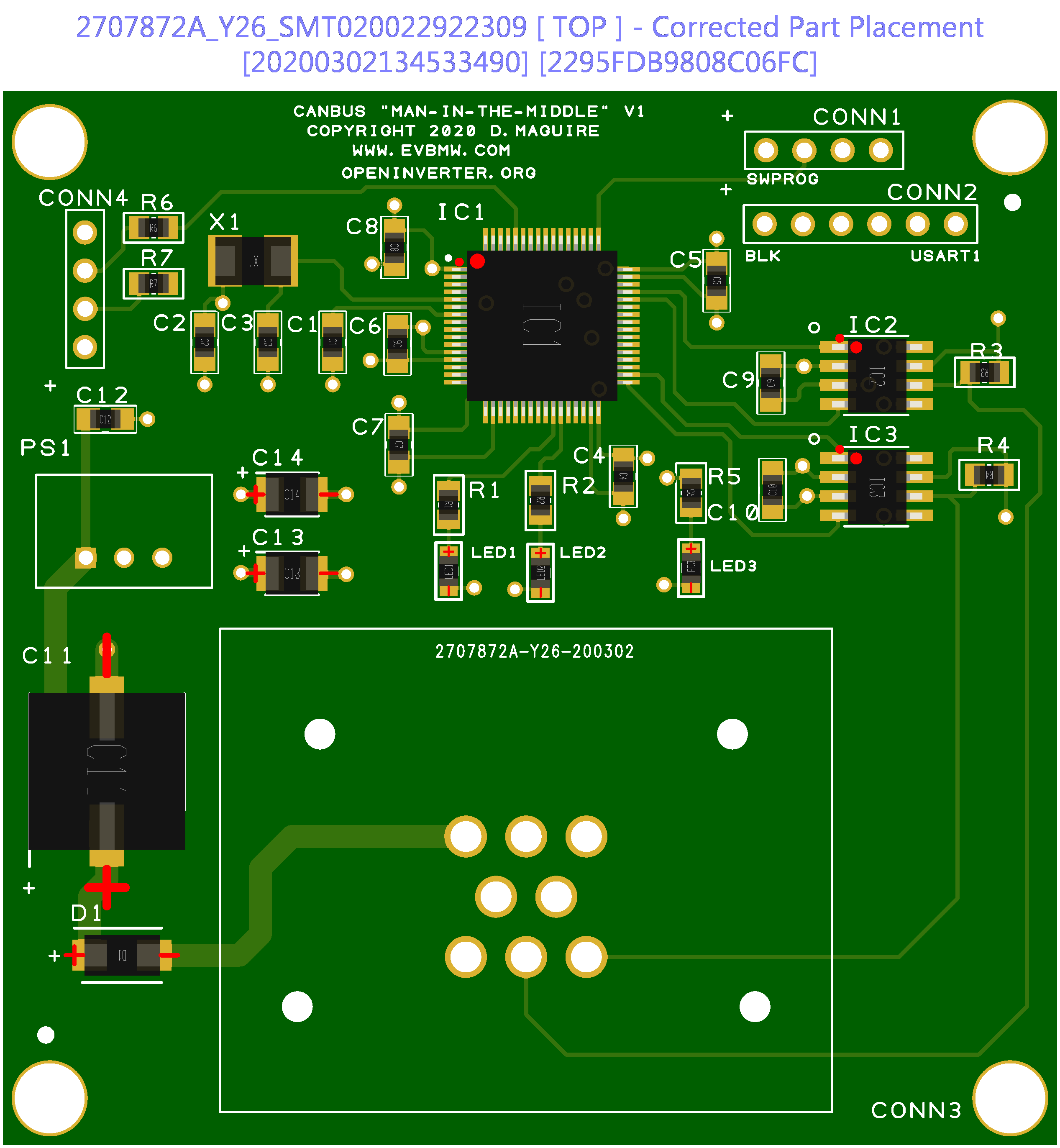

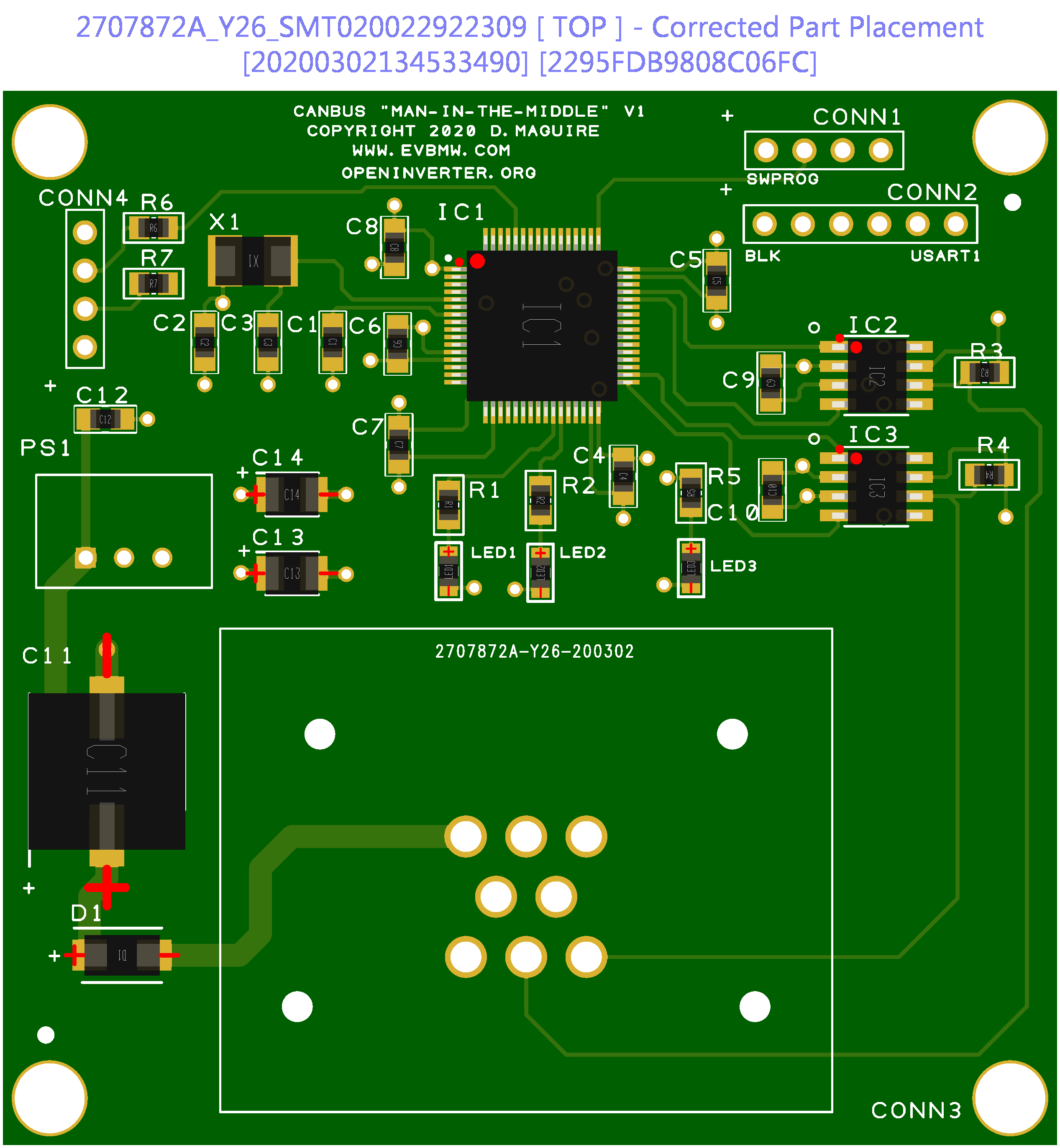

So after a week of unsuccessfully trying to contact several people who claim to sell a can "man in the middle" board, I have thrown together a quick design based on an STM32F105. Uses an Ampseal 8 pin connector. One problem I have is I can't seem to identify the BOOT1 pin on the '105. Any ideas?
https://github.com/damienmaguire/CAN-BU ... The-Middle
Now just need to get some software up and running. This could also be used for Leaf battery swaps:)

Maybe section 14.3.2 of AN2606 is your problem:Jack Bauer wrote: ↑Sun Feb 23, 2020 4:00 pm One problem I have is I can't seem to identify the BOOT1 pin on the '105. Any ideas?
"14.3.2 Bootloader unavailability on STM32F105xx/STM32F107xx devices
with a date code below 937
Description
The bootloader cannot be used if the USART1_RX (PA10), USART2_RX (PD6, remapped),
CAN2_Rx (PB5, remapped), OTG_FS_DM (PA11), and/or OTG_FS_DP (PA12) pin(s) are
held low or left floating during the bootloader activation phase.
The bootloader cannot be connected through CAN2 (remapped), DFU (OTG FS in Device
mode), USART1 or USART2 (remapped).
On 64-pin packages, the USART2_RX signal remapped PD6 pin is not available and it is
internally grounded. In this case, the bootloader cannot be used at all.
Workaround
For 64-pin packages
None. The bootloader cannot be used. "
It would seem from the datasheet neither 64 or 100 pin variants have boot1.

Great thanks. Wasn't sure if I was missing something.

Mitm board based on stm32f105 is in production.

Damn it. This gives me an idea for another project, now I'm thinking my car doesn't have automatic headlights. Are any of the stm32 io pins on the breakout pins?

There are 2 leds and usart one is on a header. Take a look at the schematic on github.

I'm copying the schematic into Kicad so I can learn a little and try and add some more io pins to the PCB design. I don't have a Windows machine for DesignSpark and Kicad seems to be a well used alternative.
Anyway, it's probably me and not you doing it wrong, but R7 on the schematic and pbc doesn't seem to be connected to Boot 1 pin. I've very little experience with stm32 but I thought to write to it BOOT1 needs to be pulled to gnd and BOOT0 to 3.3v
- Posts: 3663
Yeah I'd love to learn Kicad. Would you mind sharing when done? The STM32F105 doesnt have a boot1 pin hence the non connection. I forgot to delete it!

Don't mind at all, I was hoping to post it for feedback as the few simple boards I've designed I've used EasyEDA online
I'm miss reading BOOT1 is PB2, will delete.
Would you be able to export PDFs of the other board layers? I want to try and get exactly the same layout to begin with. EDIT NM, opened the gerber files from your repo.

I've got the schematic into Kicad now, I've not got round to the PCB yet but I've pushed to my repo if it's any use https://github.com/jamiejones85/CAN-BUS ... The-Middle

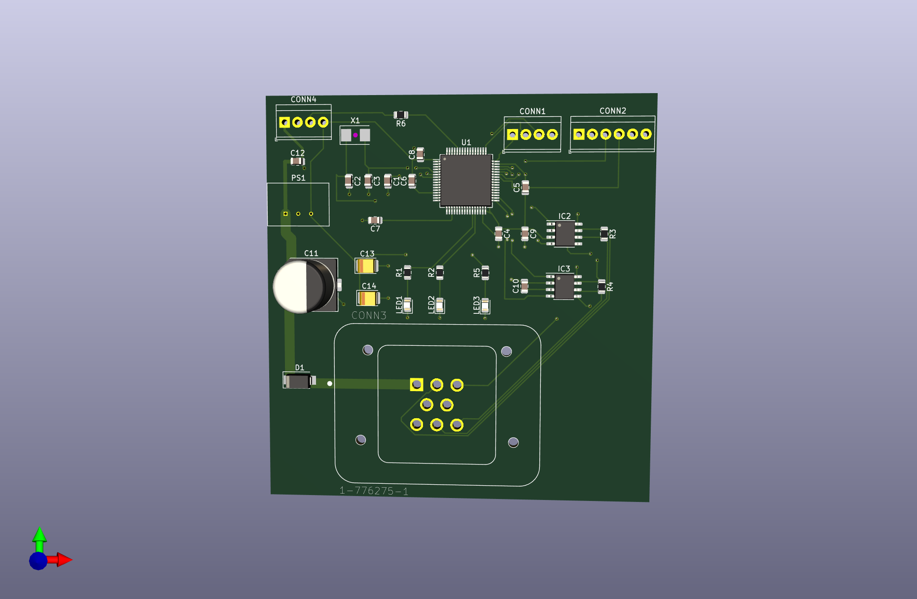

Would anyone mind having a look over my Kicad port of JB's MITM board? Any feedback or improvements would be great. New to this
- Posts: 3663
I would move X1 down closer to the load caps c2 and C3. Also try not to have right angles on tracks. Lovely work:)
I'll make the changes, I might also change the ampseal so I can breakout more of the IO pints.
