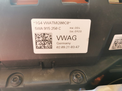

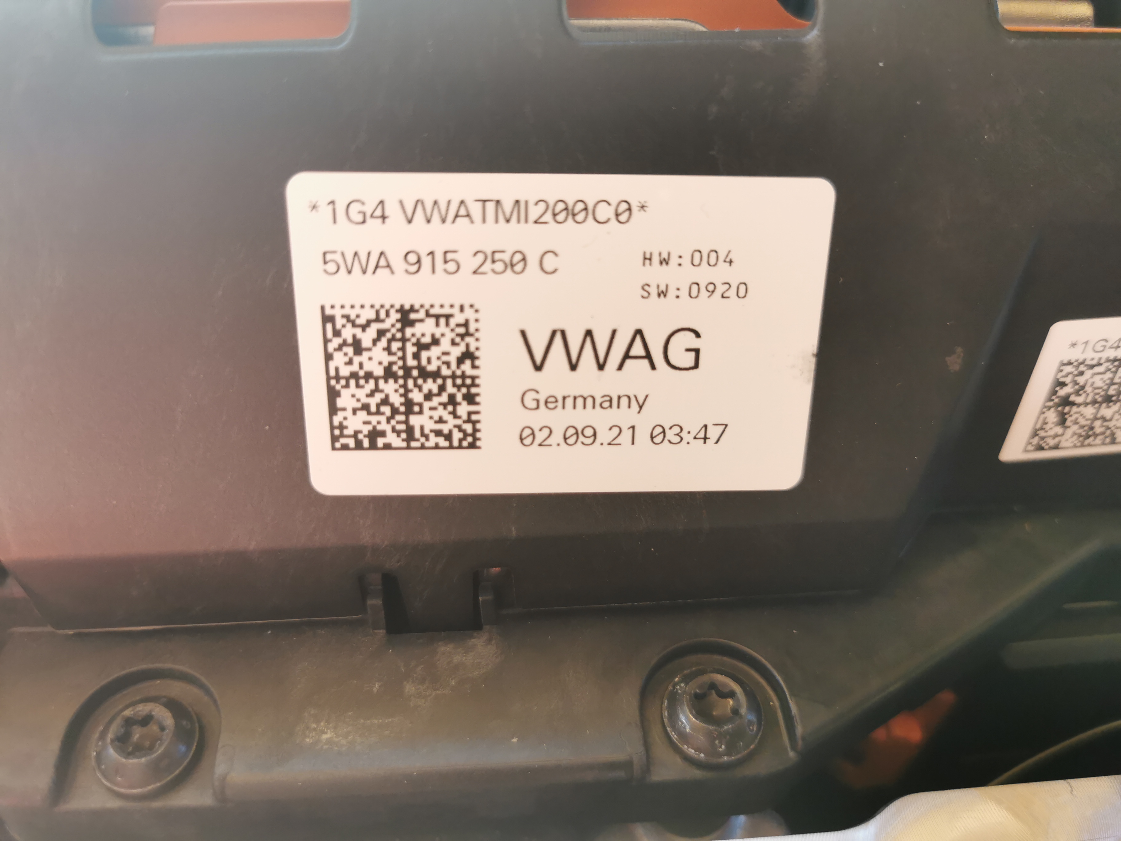

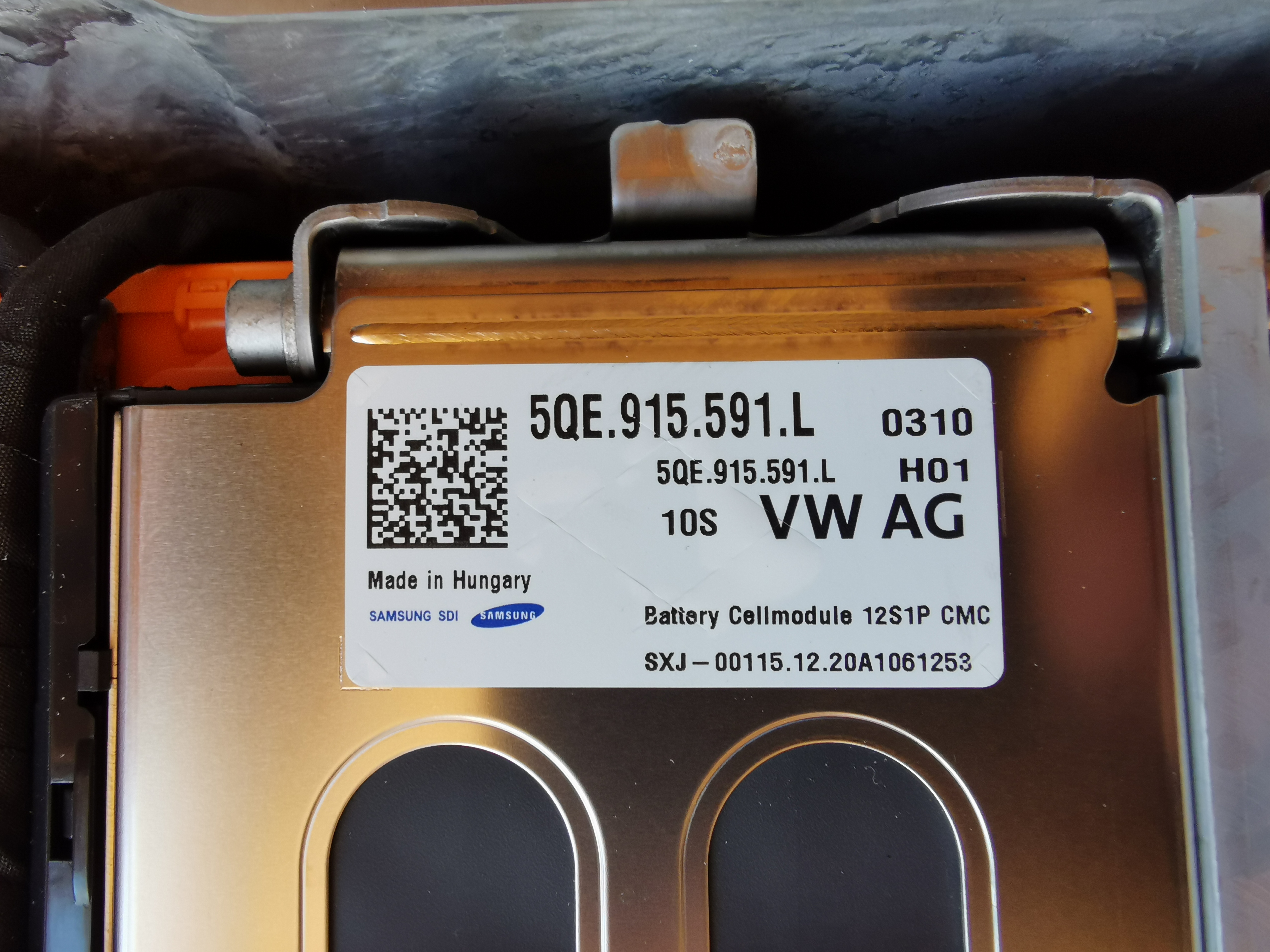

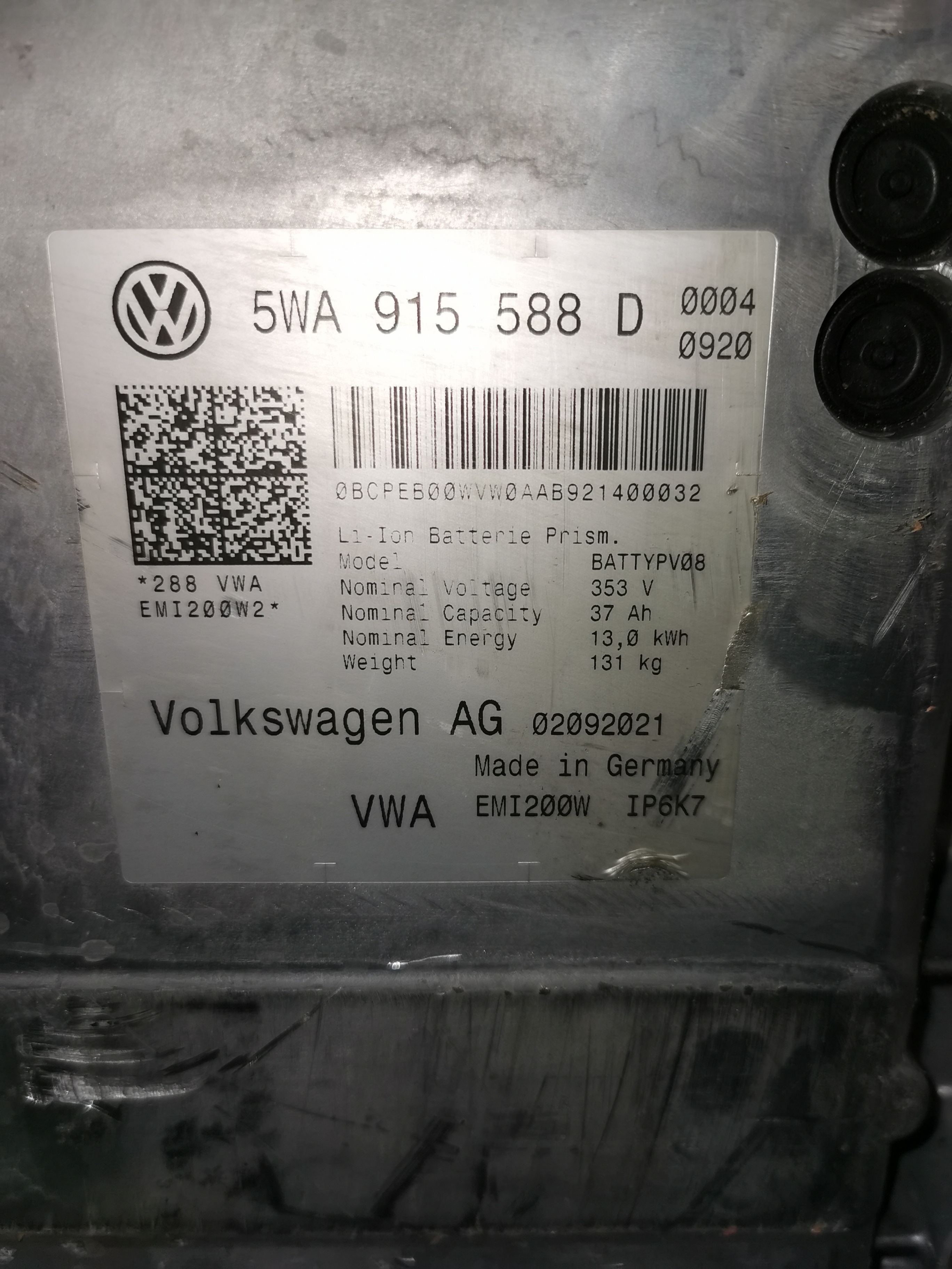

Hi I am try to find a BMS that will support cell balancing on VW Passat GTE pack?

SimpBMS should. I used it on my Beetle with success

Yea simpBMS manual has not been updated in a long time. I stopped properly supporting it and updating due to it no longer being made now for over 2 years.
VW balancing is working for the GTE packs.
