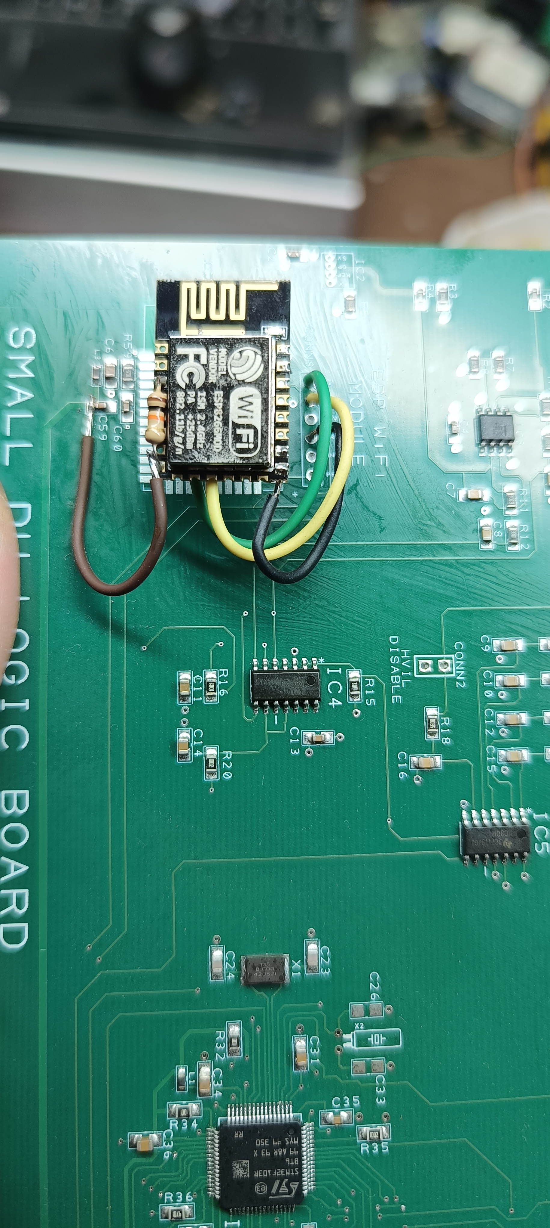

This is sort of tangentially related - I have a V8 SDU board. I see that the WiFi was flaky once the drive unit is closed up and is therefore no included on the current release of control boards. In its stead, what is the best procedure for viewing and manipulating the inverter parameters? I'm nearly ready to close everything up and put it into the chassis, but I want to do my due diligence to ensure things look correct before I jump 3 steps ahead.

I use esp12e wi-fi modules with v8 boards, soldering them with wires. they work perfectly through the inverter housing and the car. very good communication quality.
just don't forget to put the communication module in insulation and attach it to the board with hot glue so that it doesn't hang out!

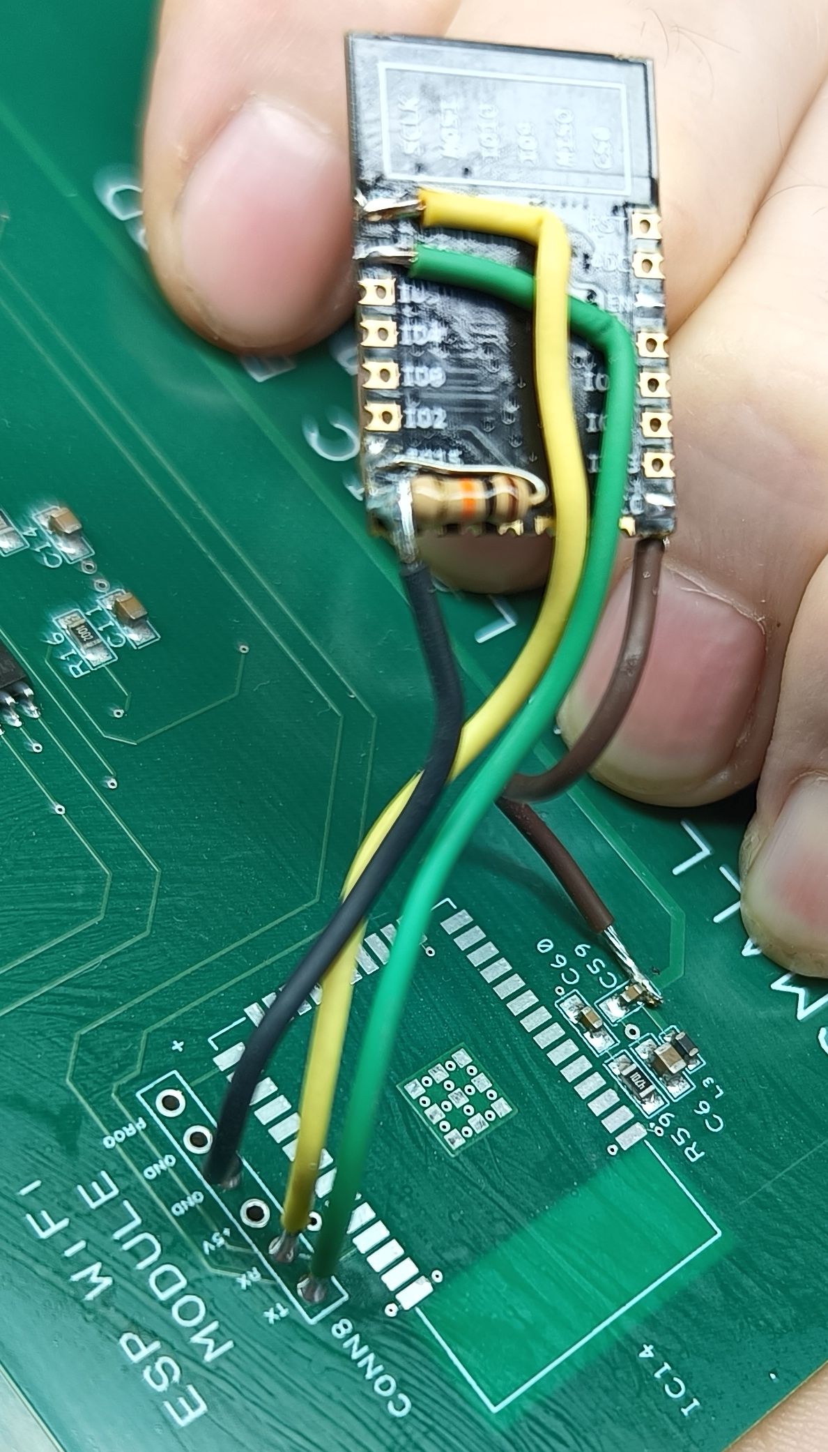

What is that resistor doing on the Wifi board? I can't quite make out which terminals you've jumped there.

Rx, Tx, Gnd, +3.3v
This 10K resistor is needed to power the module startup. the same resistor is on the reverse side of the other two pins.

it's probably worth noting that I solder already stitched Wi-Fi modules using a separate programmer for this.
