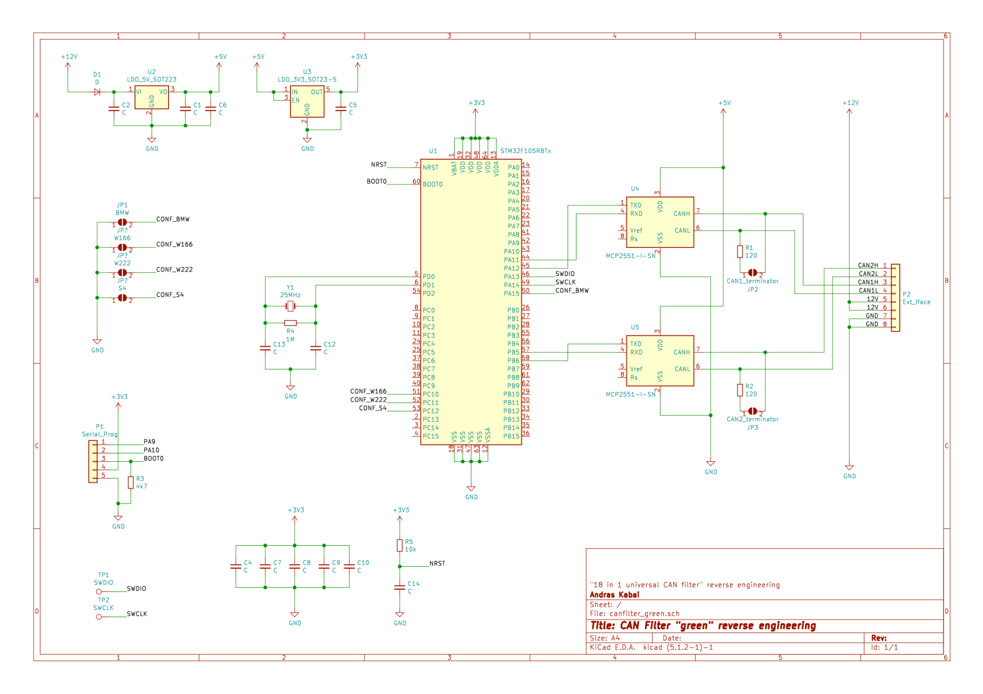

It would then work pretty well for a fake... In the schematic it seems like nothing is connected to the Rs pin of the transceivers so it would essentially be disabled. Which it isn't but maybe it doesn't work well like that? Try grounding Rs (Pin 8)
- Posts: 261
- Location: N. Wiltshire. UK
- Has thanked: 22 times
- Been thanked: 132 times
Re: Writing application for Stm32F105 @ 25 MHz
The schematic above is for the "green board" and it looks like pin 8 is actually connected to 0V. The blue board uses TJA1042, pin 8 is standby and also appears to be connected to 0V on the board.

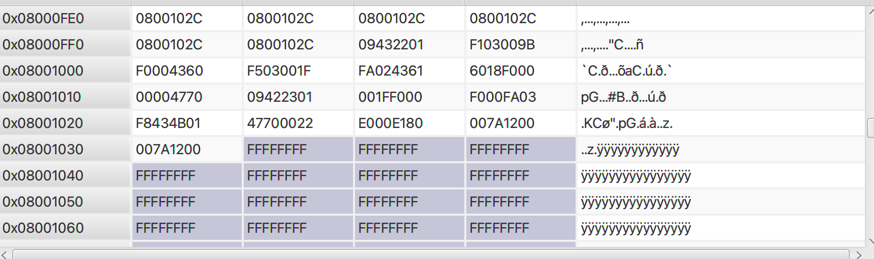

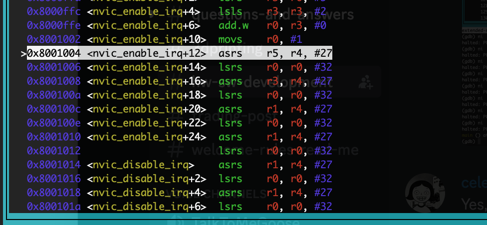

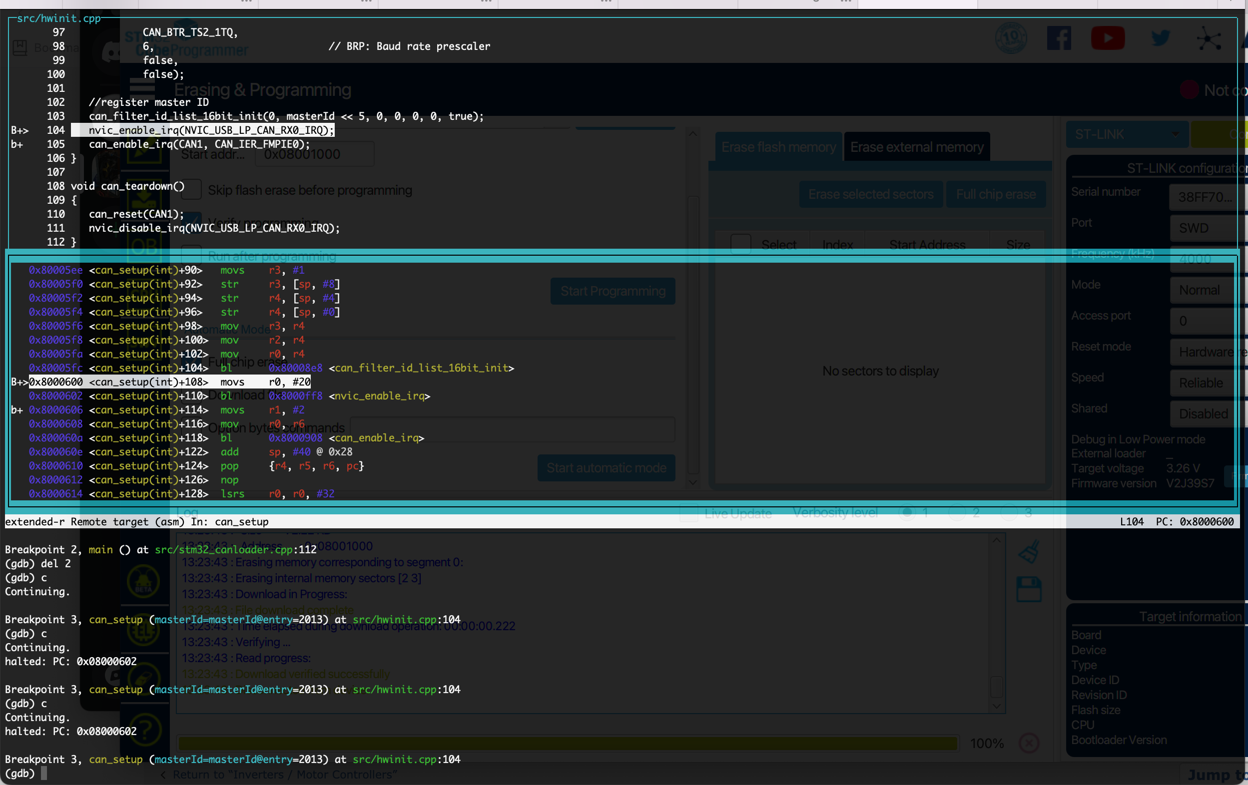

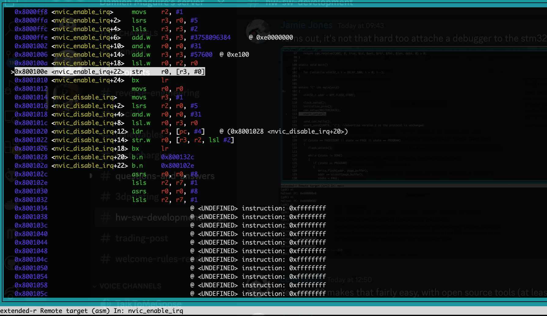

So if I've got just the bootloader on using openocd/gdb to step though, everything executes as expected.
If theres any firmware, then in the bootloader hwinit.cpp in can_setup() on the line nvic_enable_irq(NVIC_USB_LP_CAN_RX0_IRQ); it seems reboots.
And this is without firmware
- Posts: 1774
- Has thanked: 82 times
- Been thanked: 424 times
Ok so the bootloader is too large.

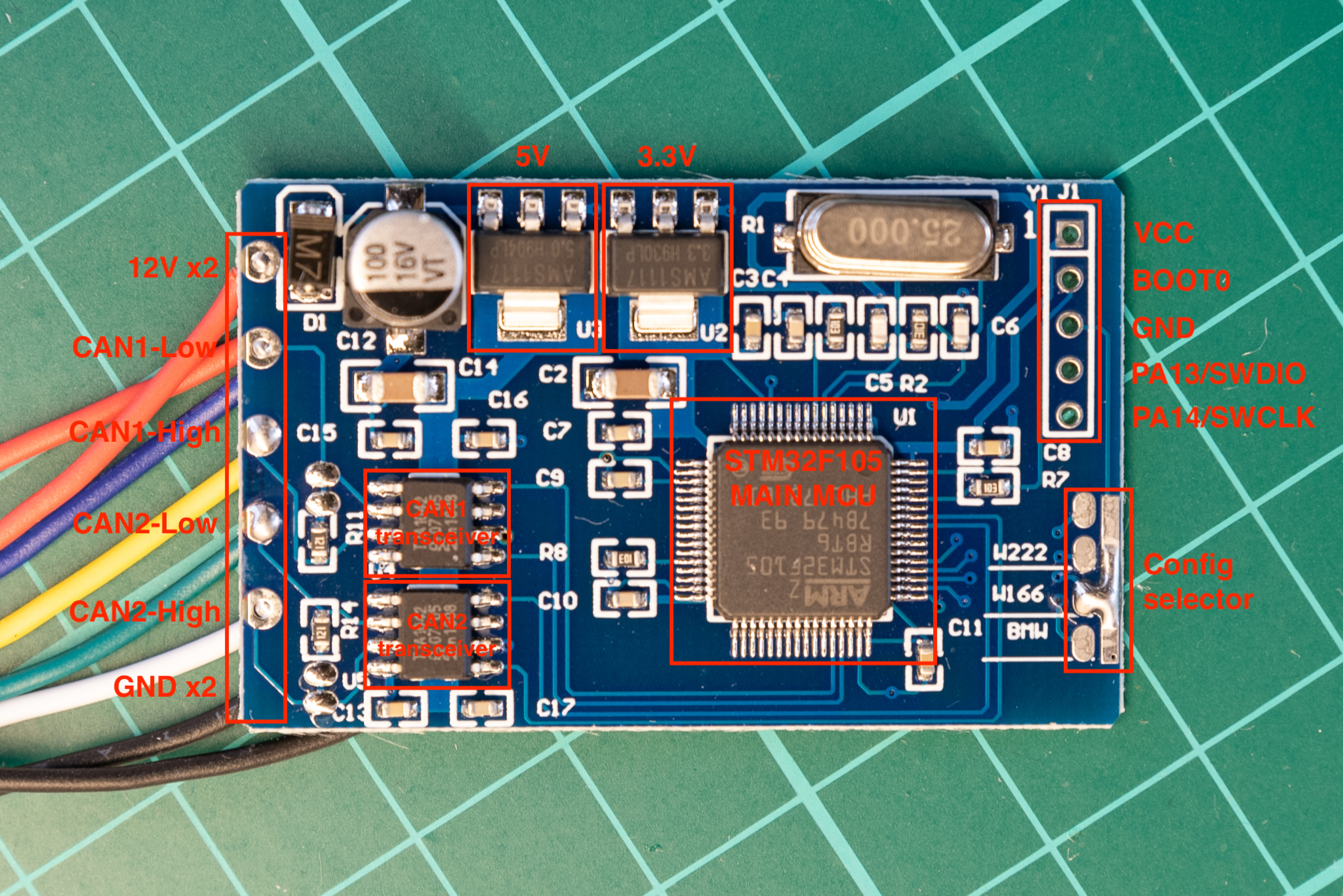

I've been playing with the blue board too, managed to follow Jamie's work successfully
- Built the bootloader from https://github.com/jamiejones85/stm32-C ... /BlueBoard
- uploaded to blue board using an stlink v2 (a bit of faffing there, but with combination of stm32cube & blackmagic debug app got it flashed using the SWD connection)
- bootloader as built was sub 4k (3988 bytes) so didn't experience the issues above.
- built Jamies CANBridge demo app at https://github.com/jamiejones85/stm32-CANBridge (just need a couple of missing git submodules to build)
