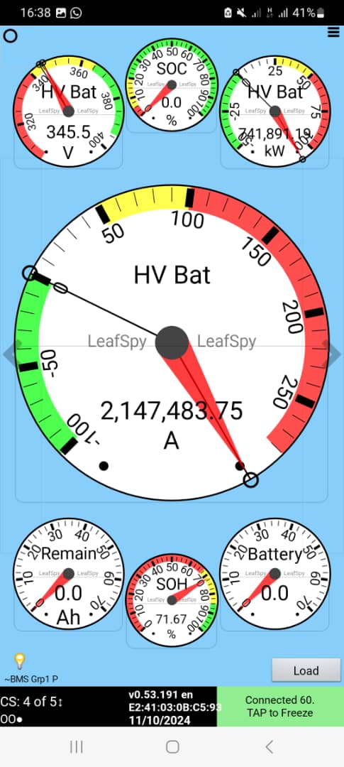

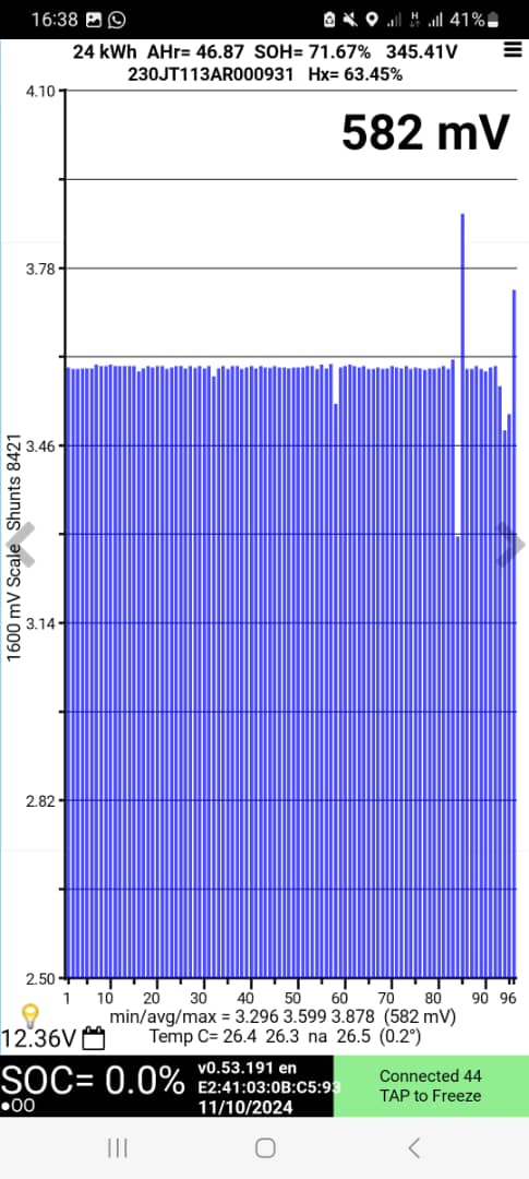

I've successfully connected the BMS, and it shows all 96 cells, with the three temperature sensors working. However, I noticed that in all the YouTube videos I've watched, Leaf Spy displays red and blue lines for the cells, but mine only shows blue. Is the BMS functioning correctly, or am I missing something?
Also, for the BMS gray connector, I used the ground, ignition, charge, and sensor wires, but I didn’t connect the two interlock wires. What exactly do the interlock wires do, and will their absence affect the BMS operation?

My understanding is the red lines in leafspy are cells that are balancing. These typically flash / jump from screen refresh to screen refresh. I usually see it when charging.
If you're never seeing it, I wonder if your battery is in a storage mode..

yes these blue lines also flash / jump from screen refresh to screen refresh and even the mV keeps on changing
