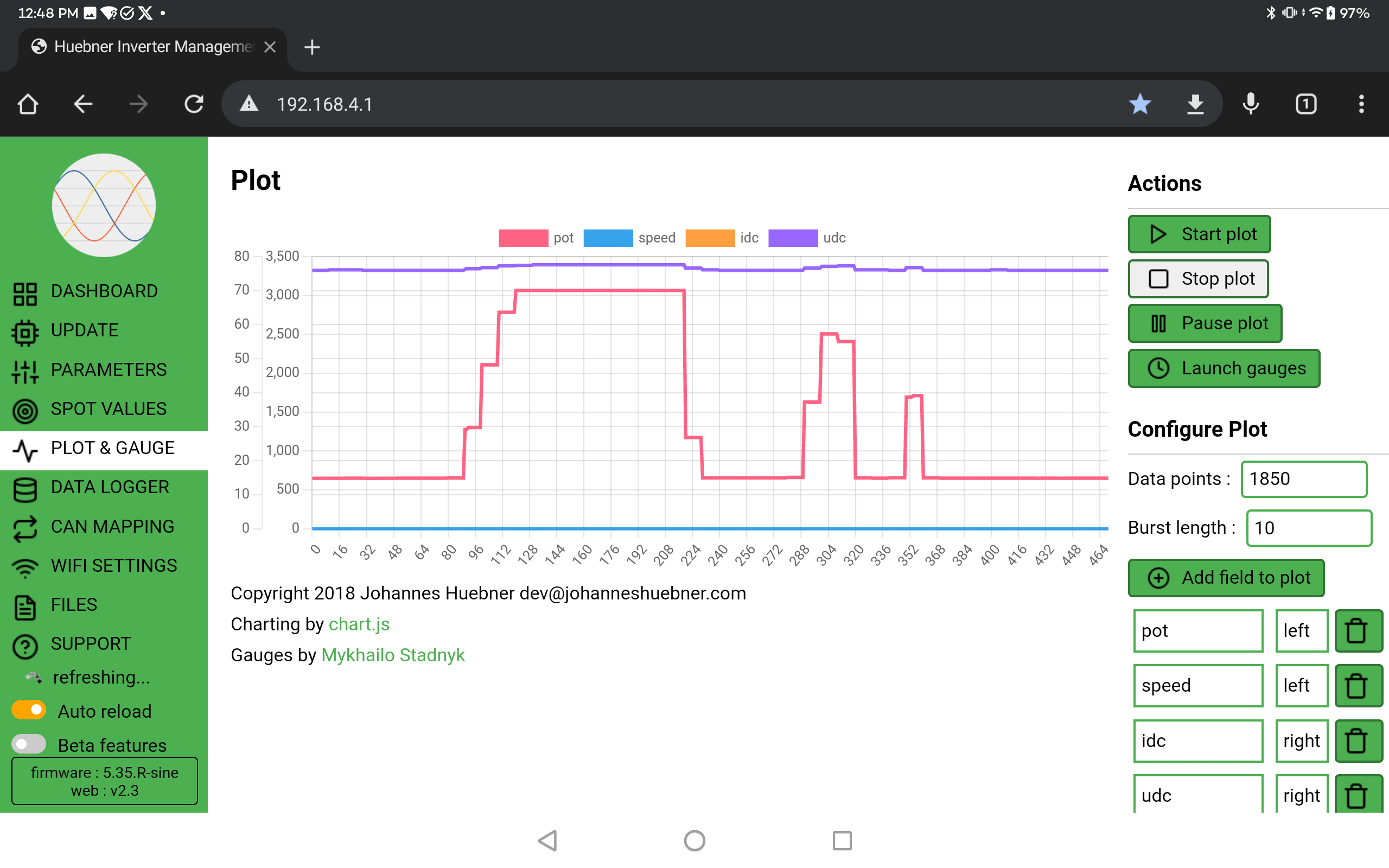

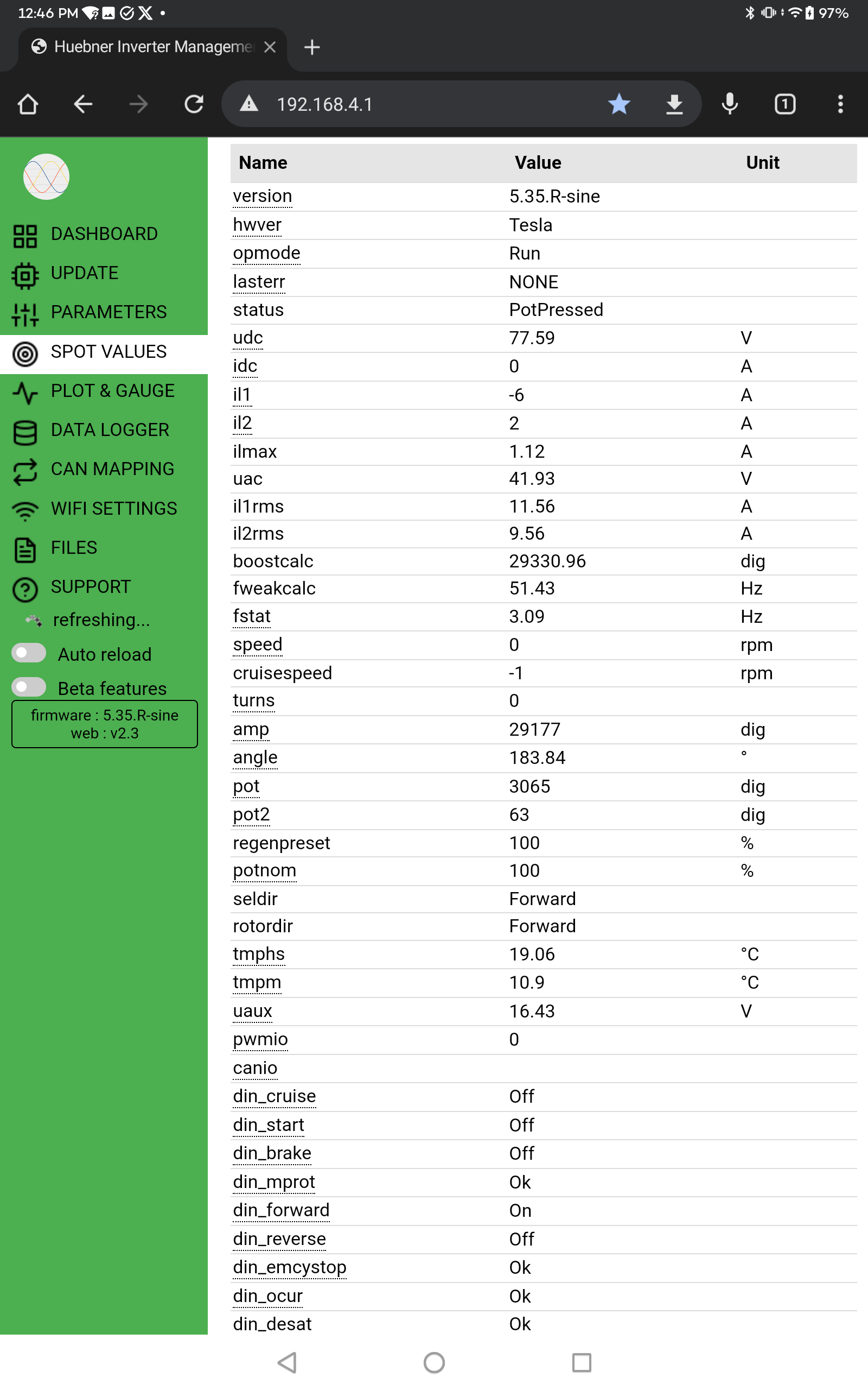

I'm having trouble getting an LDU to spin.
It's in Run mode and set to Forward direction, but when I apply throttle, nothing happens. I’ve calibrated the throttle, and when I plot it, it maps smoothly to the throttle angle. However, the current remains at 0, and the voltage remains relatively constant. There's no movement or noise from the DU when I apply throttle.
I've tried both LDU parameter sets from the parameter database, but I got the same result. I only changed potmin, udcmin, and udcsw. I measure 60.84V at the DC bus bars, but the web interface is reporting udc of 77.34V. I've tried three boards, and they all exhibit the same behavior. However, while two show no errors, one shows HICUROFS2 (not sure what that's about). They all work fine in another LDU I have.
I also ran some diagnostic tests:
- Diode test on DC terminals (and each phase): Read 0.643V, suggesting the IGBTs are in good shape.
- HV isolation test using a Megohmmeter: Measured 4.98MΩ on all phases and DC terminals, which is within Tesla’s specifications.
At this stage, I'm unsure what to try next. I’d appreciate any advice on further diagnostics or steps to identify the issue.

It seems between the parameters and the spot values you have changed boost or udcnom? Because boostcalc is 29330 and expected is around 8000. But probably it is not the issue.
I see amp=29177 so it is generating a high amplitude sine modulation. No deraters in the way or anything. But that PWM seems to be lost on the way. You can try to follow it with a scope. PCB -> connector -> gate driver primary -> gate driver secondary -> phase output

johu wrote: Tue Nov 12, 2024 11:17 am It seems between the parameters and the spot values you have changed boost or udcnom? Because boostcalc is 29330 and expected is around 8000. But probably it is not the issue.
Yeah, I tinkered with the boost a little, but it didn't help. I have since gone back to the base 1800 value.
johu wrote: Tue Nov 12, 2024 11:17 am I see amp=29177 so it is generating a high amplitude sine modulation. No deraters in the way or anything. But that PWM seems to be lost on the way. You can try to follow it with a scope. PCB -> connector -> gate driver primary -> gate driver secondary -> phase output
