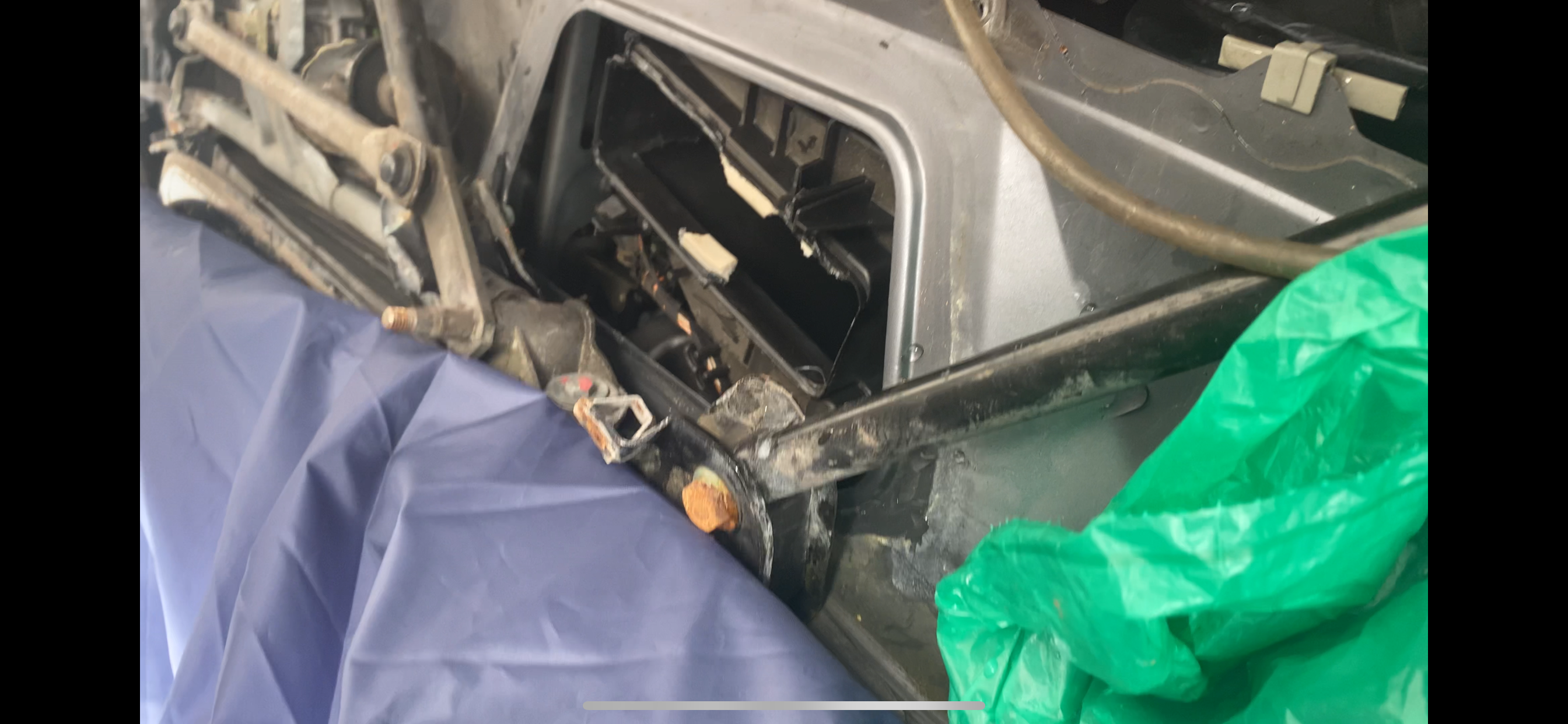

For my Porsche Boxster 986 project I am looking for a PTC cabin heater fitting the 155x50x230 space. Another Boxster conversion here in the forum is using this one https://evwest.com/used-1500w-electric- ... -smart-car . I don't find it in Europe and I want it to be LIN / CAN controllable. VW ID.4 / Hundai Ionic are to big.
I am thankful for any idea, even if you don't have one to sell. Thanks.

I used to use that EV West PTC. It does not produce a lot of heat.
LIN or CAN controllable more or less equals OEM re-use but those units tend to be much bigger.
The Hyundai PTC I had was one of the smallest I could find and was 23x19
So then I think there are a couple of options:
- Create more room and go WV ID PTC
- Use a CAN controlled water heater and a heat exchanger
Or if you change LIN/CAN to PWM then a 12V PTC maybe.

Thank you for your ideas. Unfortunately there is not much potential for creating room . It would directly mean slaughter around in metal .
