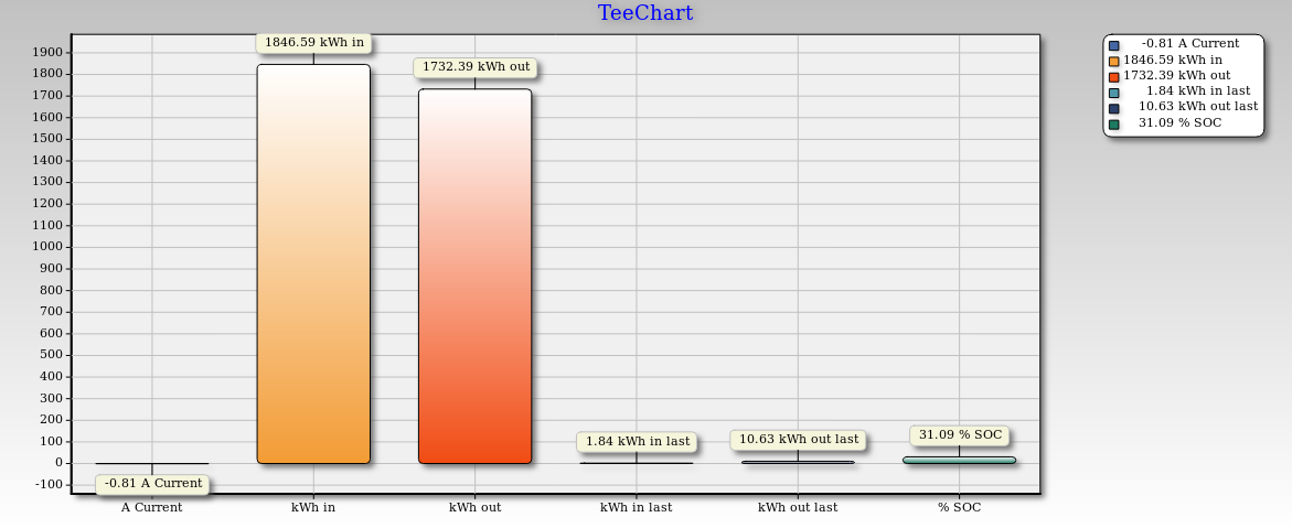

Just wanted to share with you my amazement about the effectiveness of regen. We did a 65km trip yesterday in Kassels hilly terrain. You can see 10.6 kWh were uses in total but also 1.8kWh were put back into the battery by regen (the counter resets after a complete charge). Thats 17% of energy saved over a non-regenning vehicle. In city traffic this can reach up to 25%.
