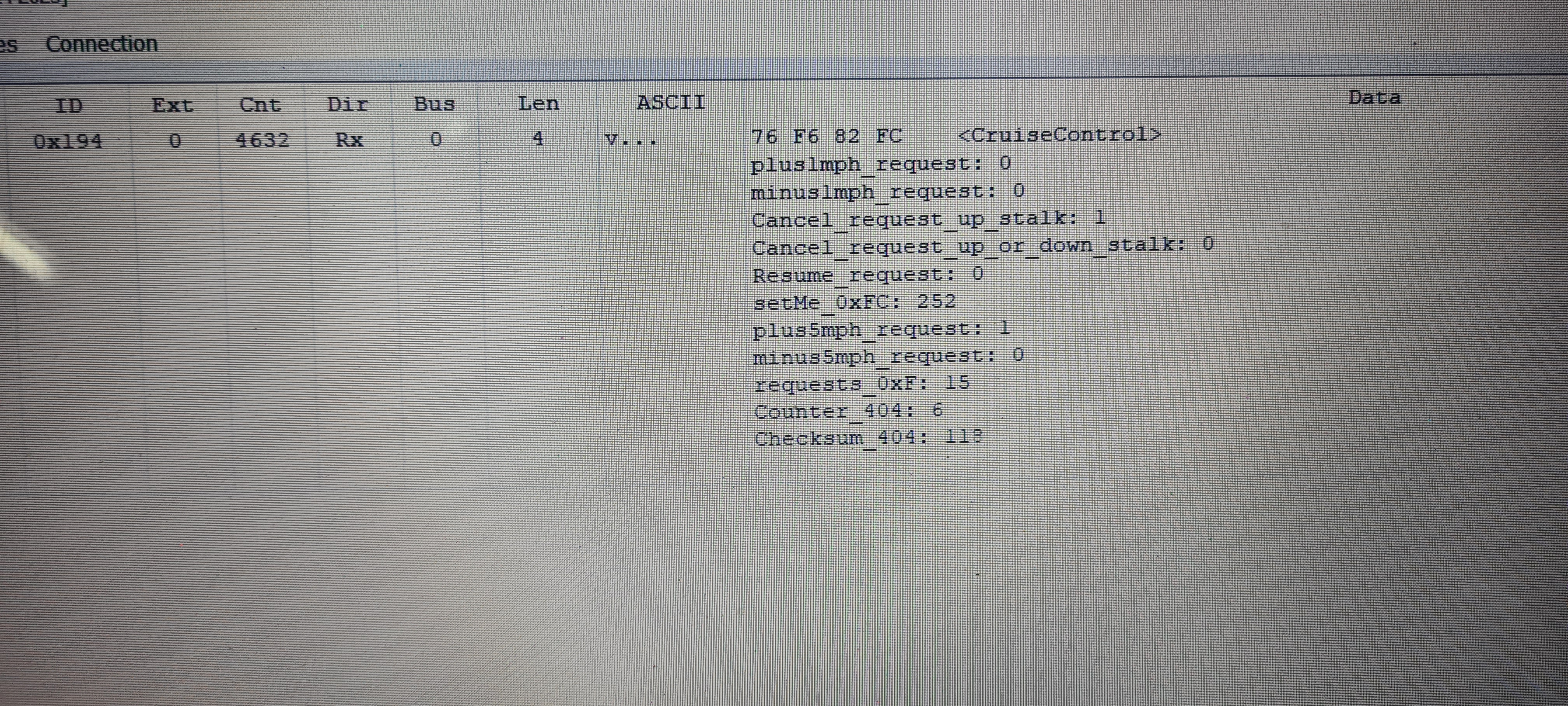

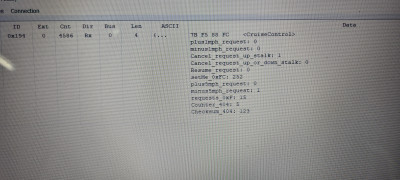

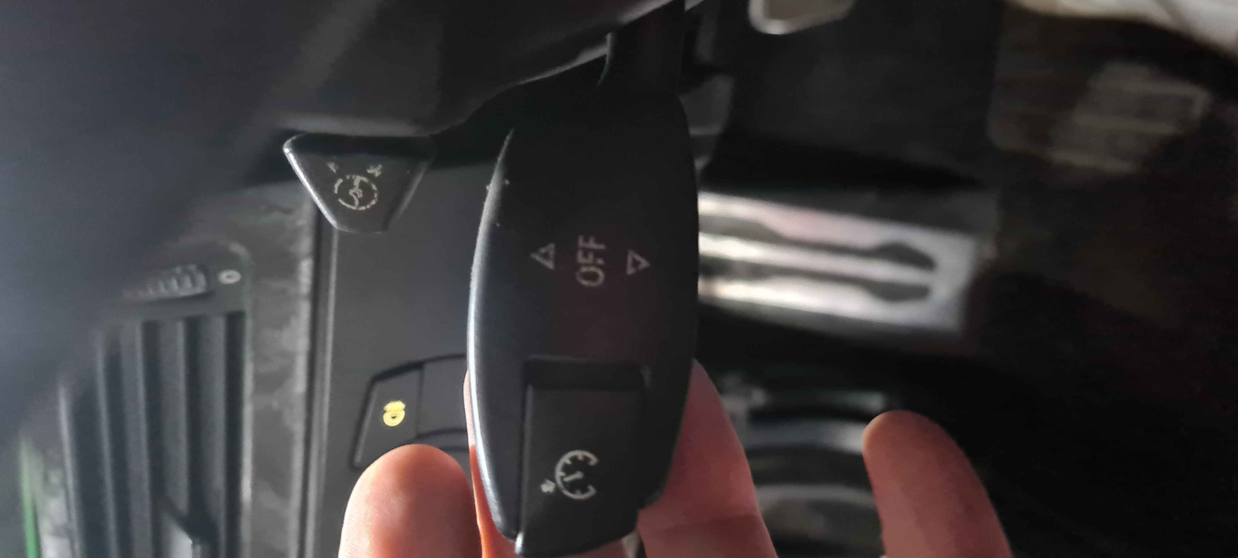

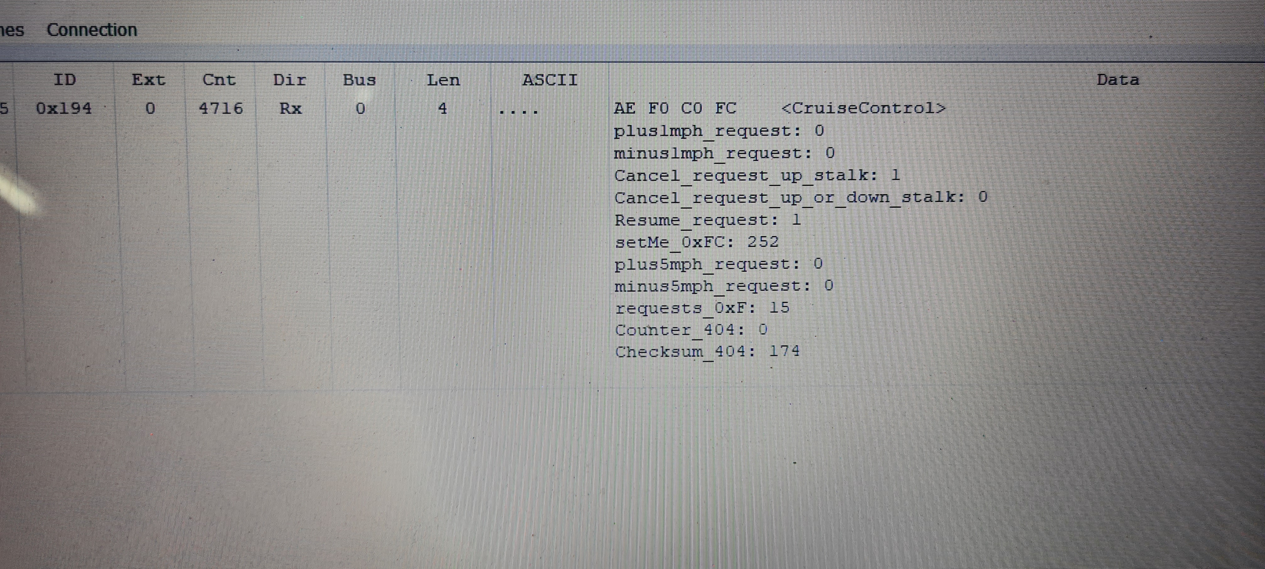

Hello everyone, I drive the E60 and since the electrical conversion the cruise control is no longer working, but now I would like to use it to control the drive direction, can someone help me to reprogram the e65_shifter class, it seems to be a 4 byte message with counters, I have created a log

Yes, it is displayed normally in the speedometer, in terms of function, it is basically like a BMW gearshift, just different canbus messages, e.g. push backwards = reverse, pull forwards = forwards, up or down = neutral, and push in = park position.

you need to identify the can messages from the cruise control stalk. then link them to gear select like the f30 shifter does.
then need to send the correct message showing the gear and direction the car is in. so you can see if you are in park or drive or reverse on the dash.
