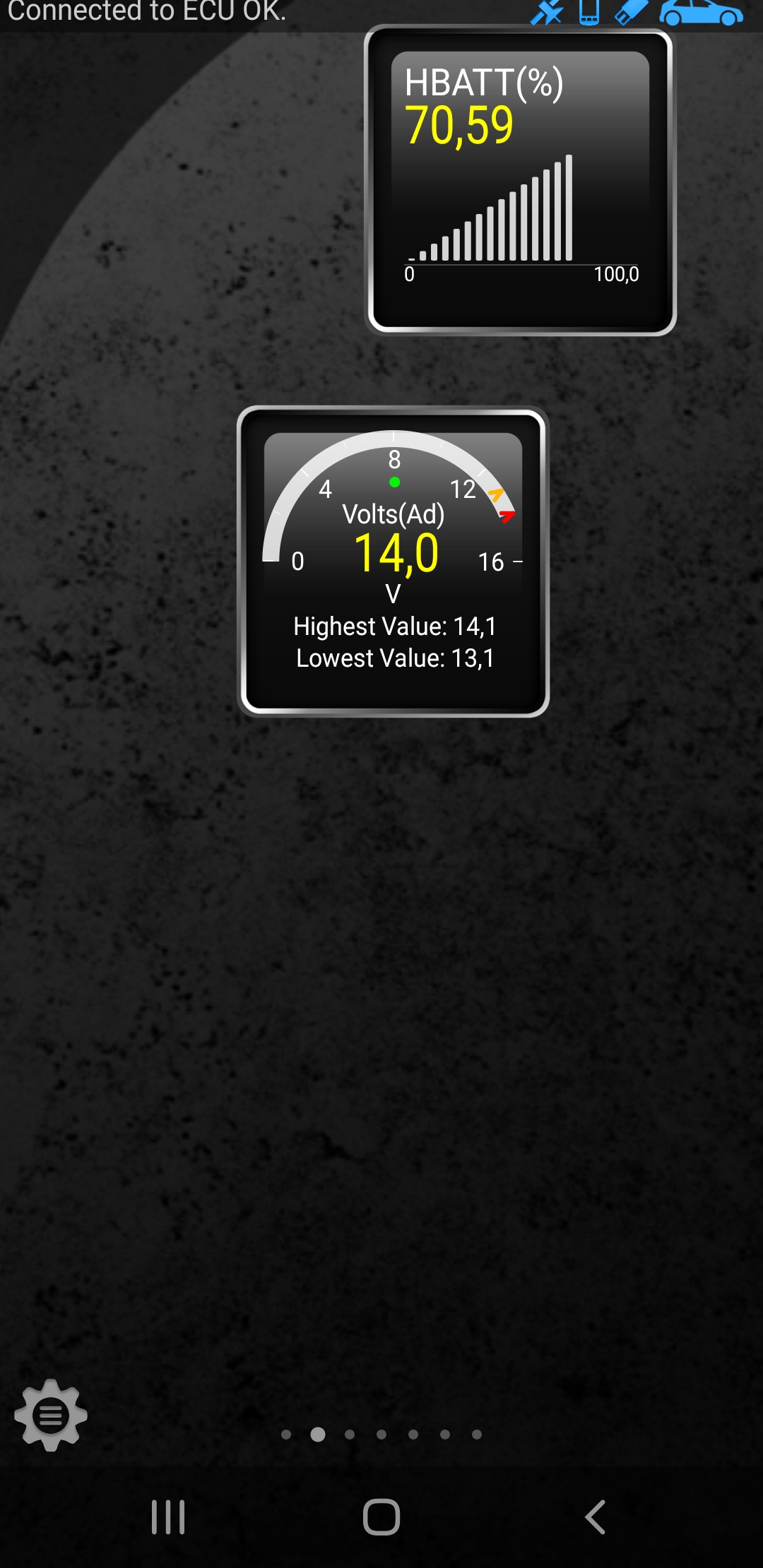

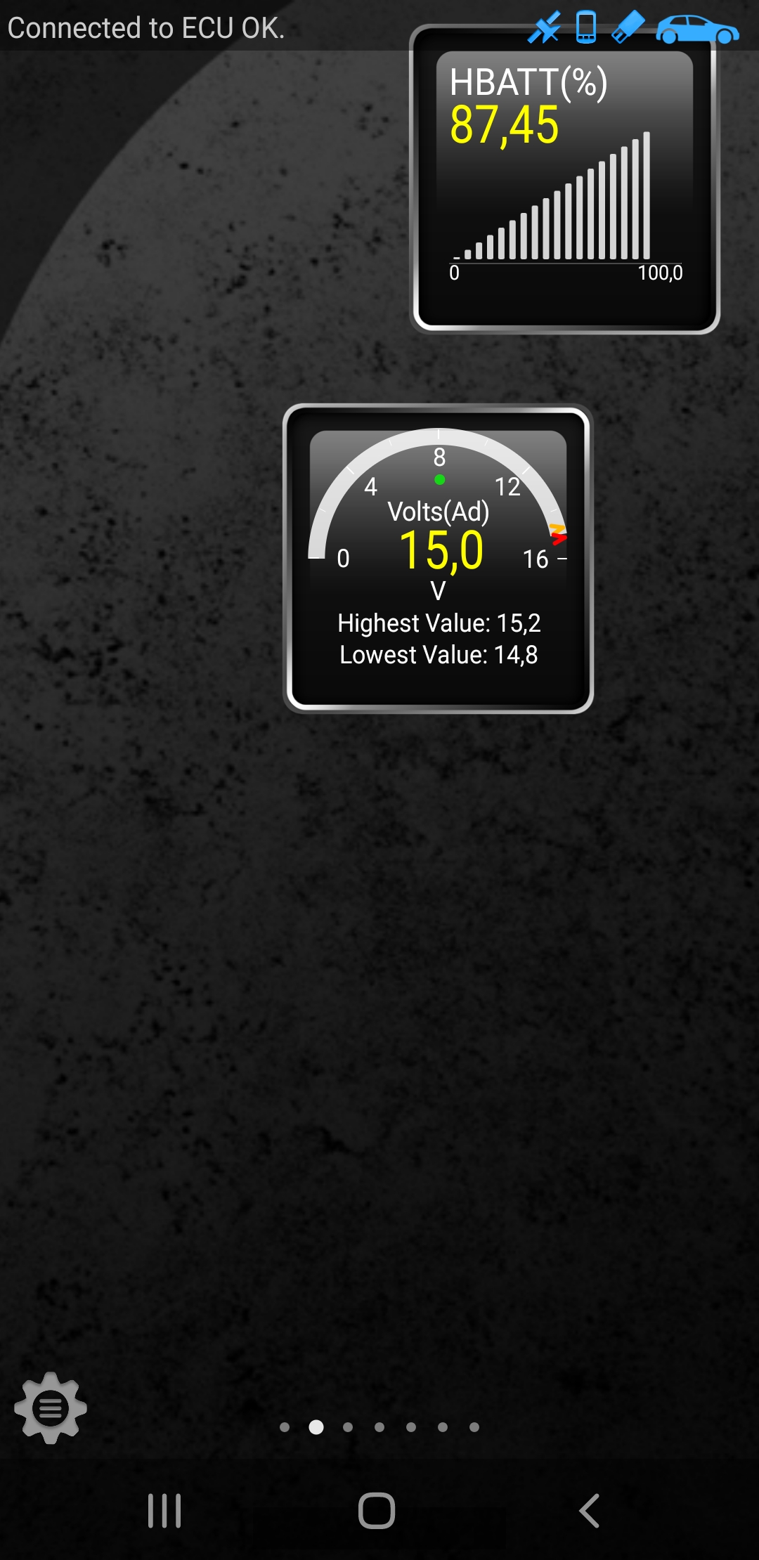

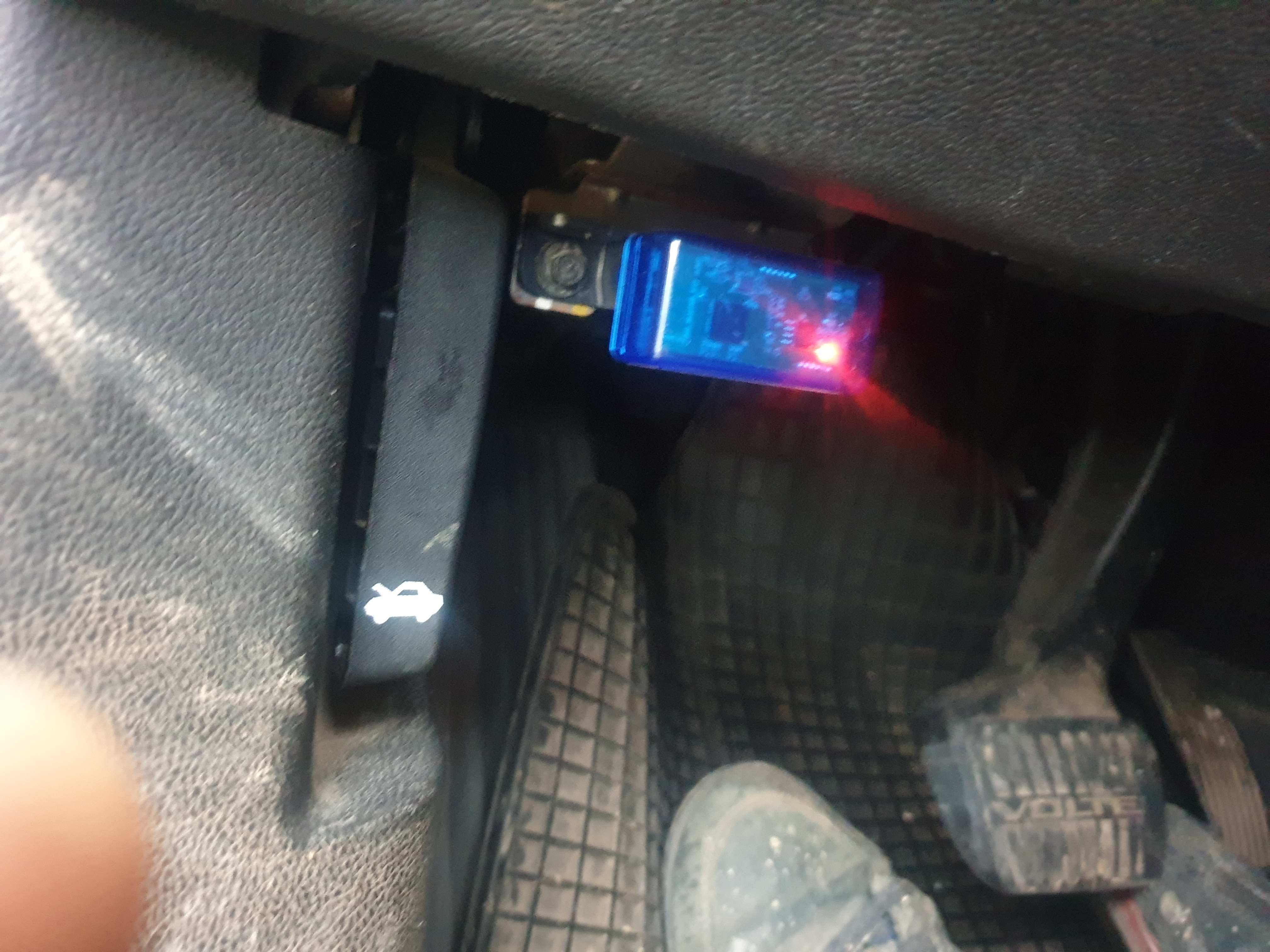

When i bought new AGM i went to observe what is happening and connected Torque pro and observed,
Characteristic was real killer. DCDC directly at start would push 15V and about 135A into NEW battery! I could agree that is a shocker. :twisted:
That torture lasted about 10min and then DCDC subsided to 14.4V to 13.8V during some 30min. That would be ok, but later this charging just ended and DCDC failed to charge with battery dropping down to 12.7V during normal highway operation!!! Which is eqally shocking. Therefore i can conclude that Ampera forces the aux battery to go through one full cycle during EACH drive!

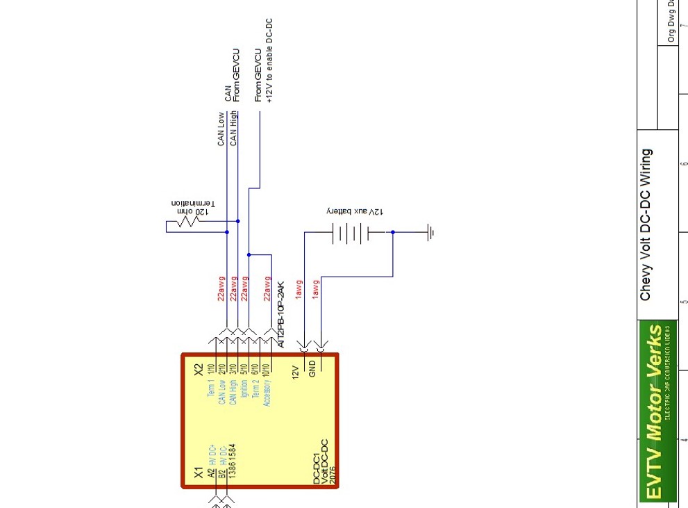

You may remember i published how i made DCDC to work outside Ampera car.
https://leafdriveblog.wordpress.com/201 ... dc-or-apu/
I can see i have two options here:
1. I can add VCU with CAN bus which would simply request 14V from DCDC whenever its Enable line will be ON.
This does not include of listening DCDC report. I would simply request 14V and leave it at that. Lets see what happens...

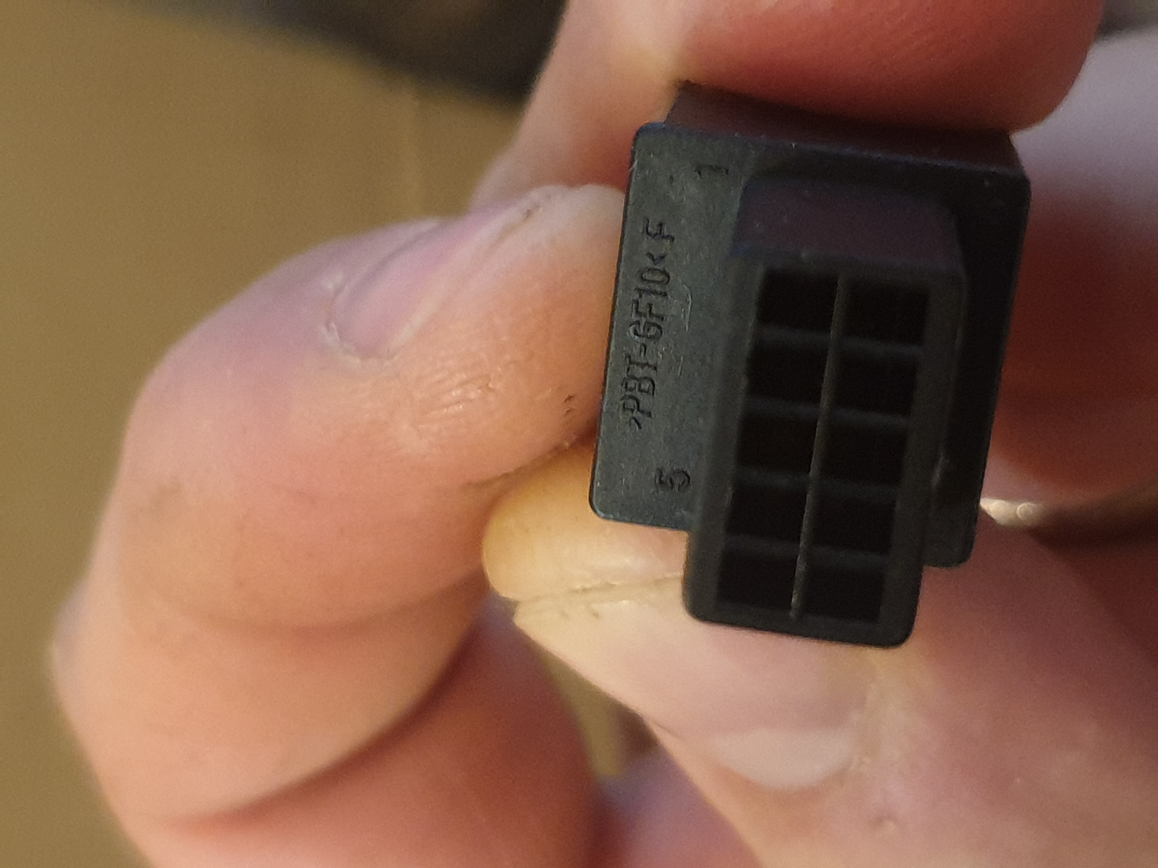

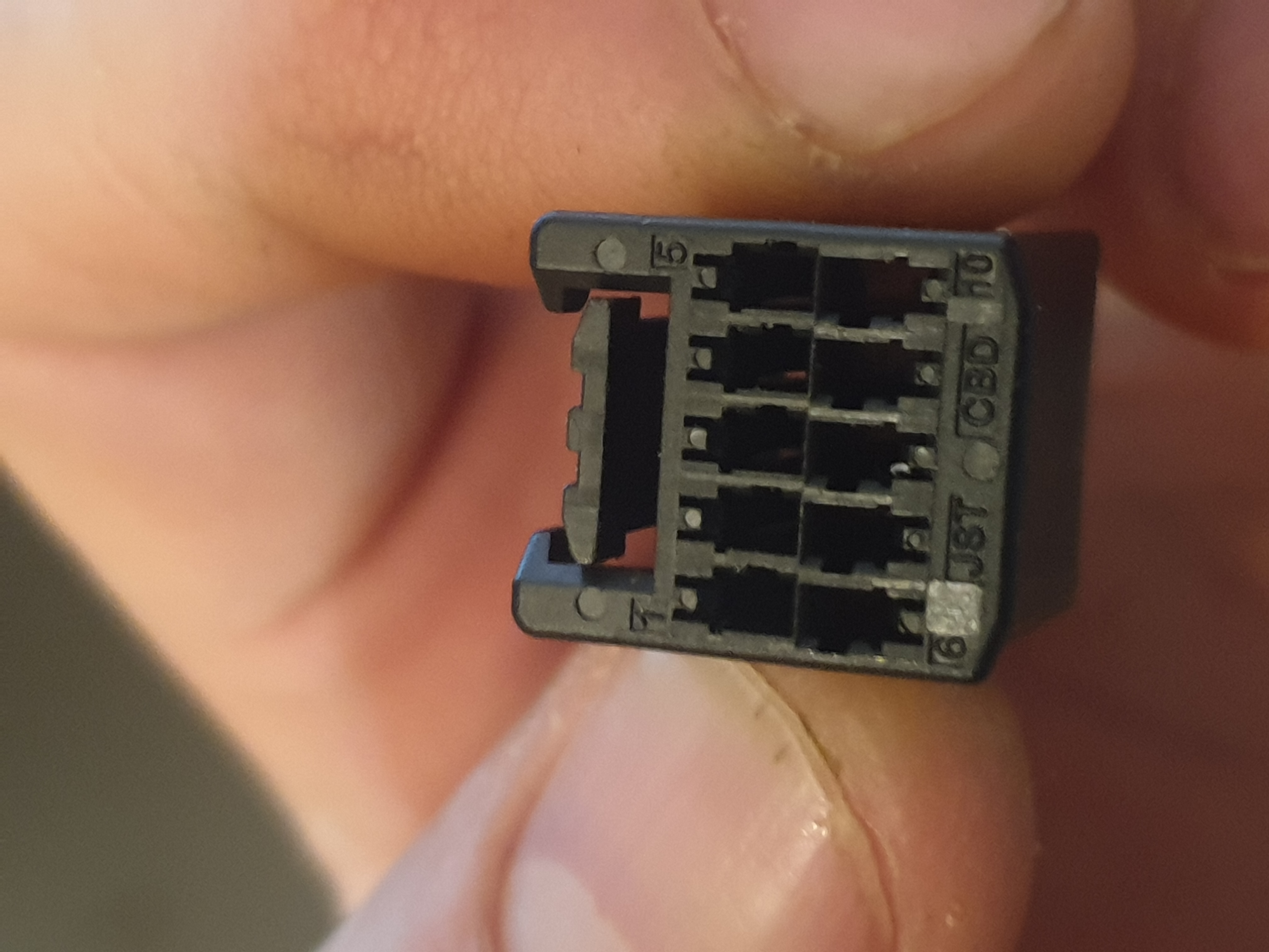

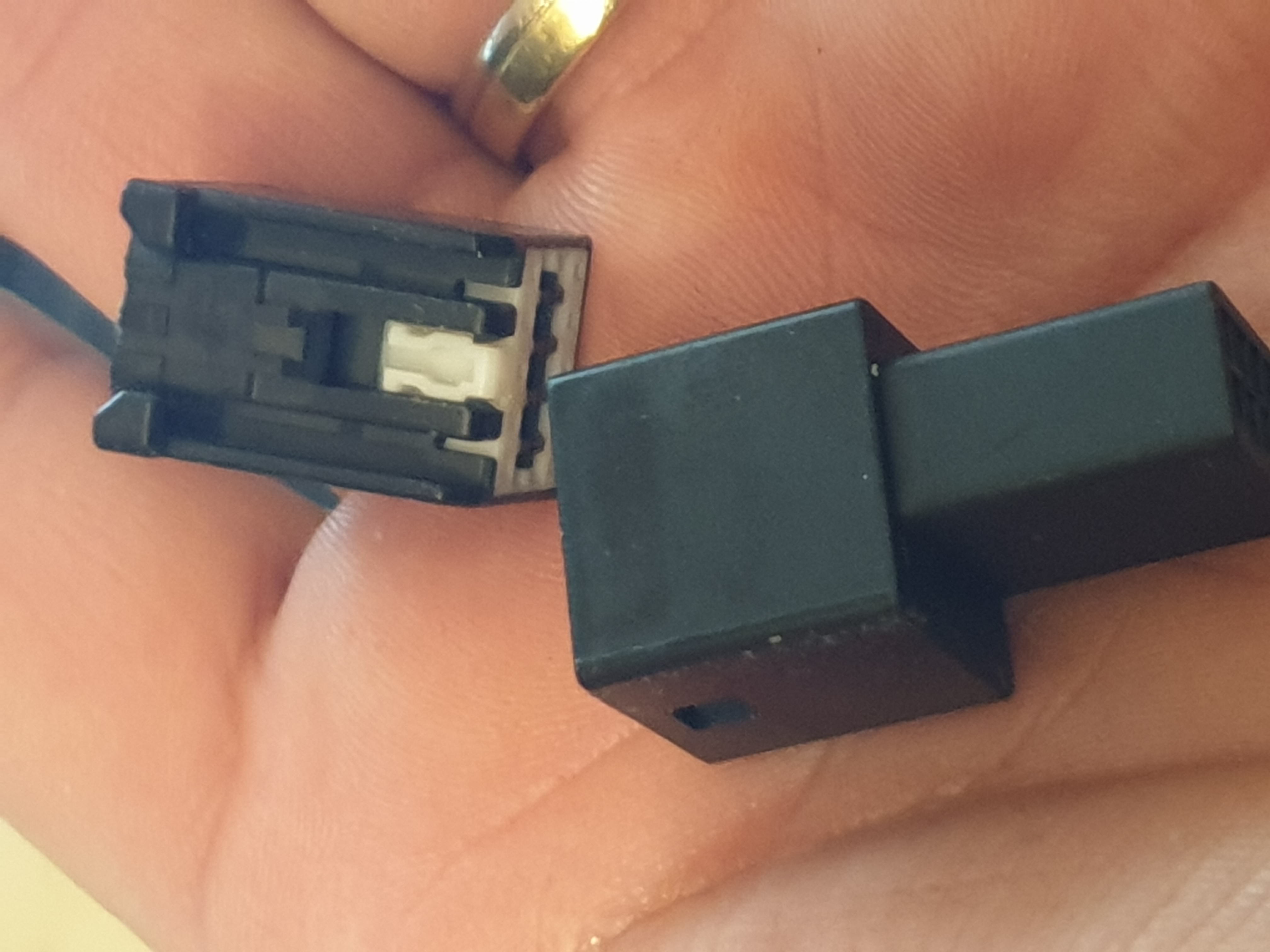

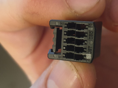

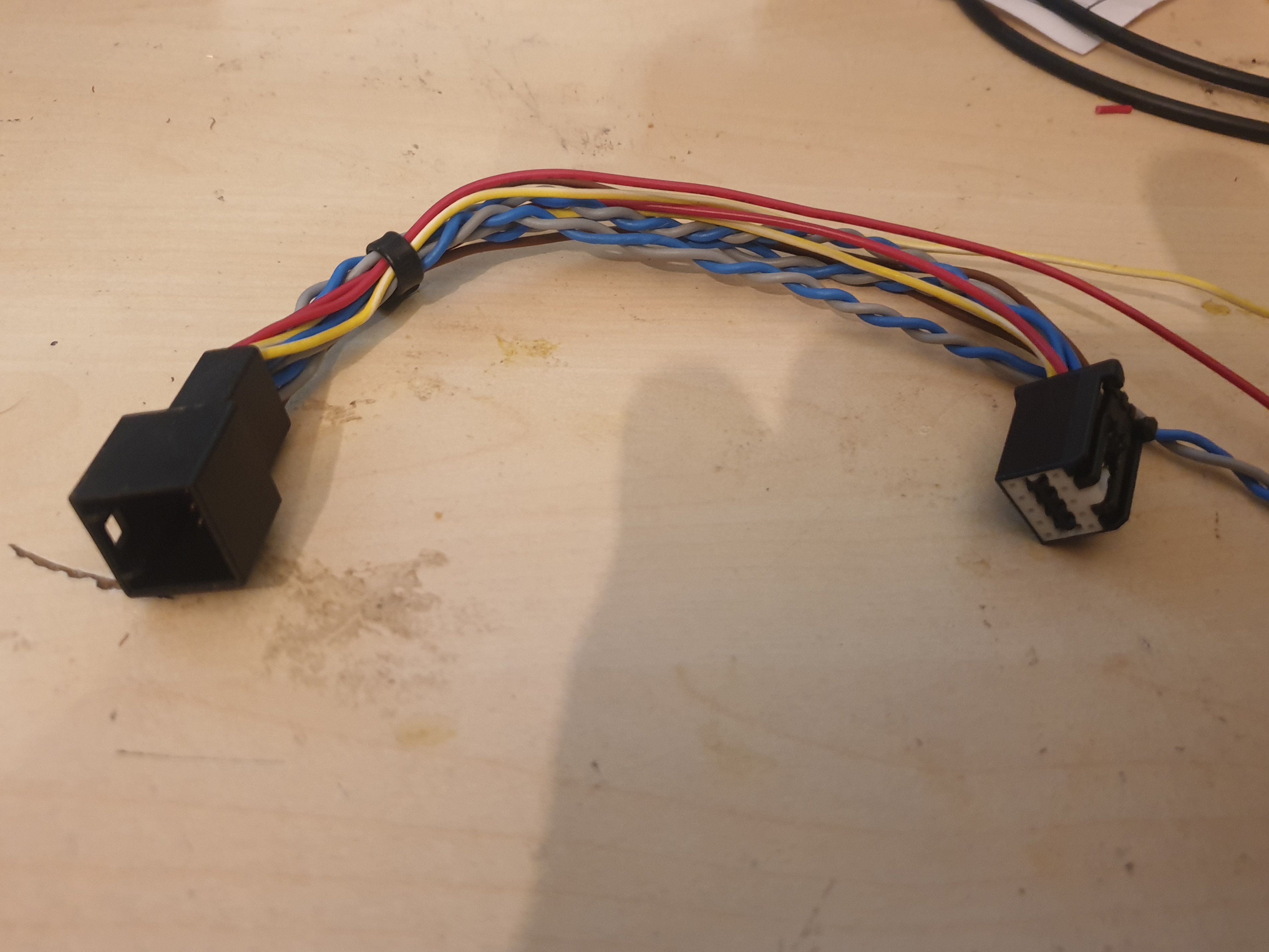

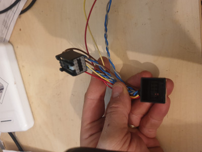

I ordered connector pair from aliexpress. Its P/N is AIT2PB-10P-2AK and i received several male and female connectors with crimp pins.
https://www.aliexpress.com/item/1005005 ... 1802TBH3Vb
This will let me test this without hurting OEM connector or its wires. I made a test harness and used screw terminals to connect to my VCU.
The way it is connected is from VCU to sense Enable pin which car uses to start DCDC operation. This is connector pin no. 5.
There are two sets of CAN bus pins, but both connect to the same point.

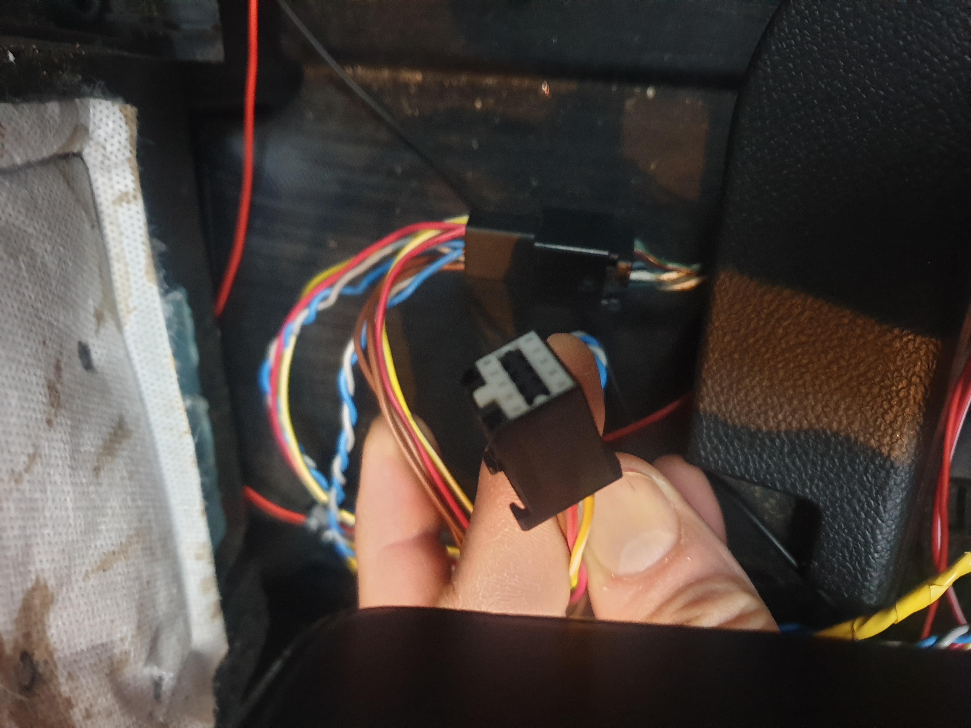

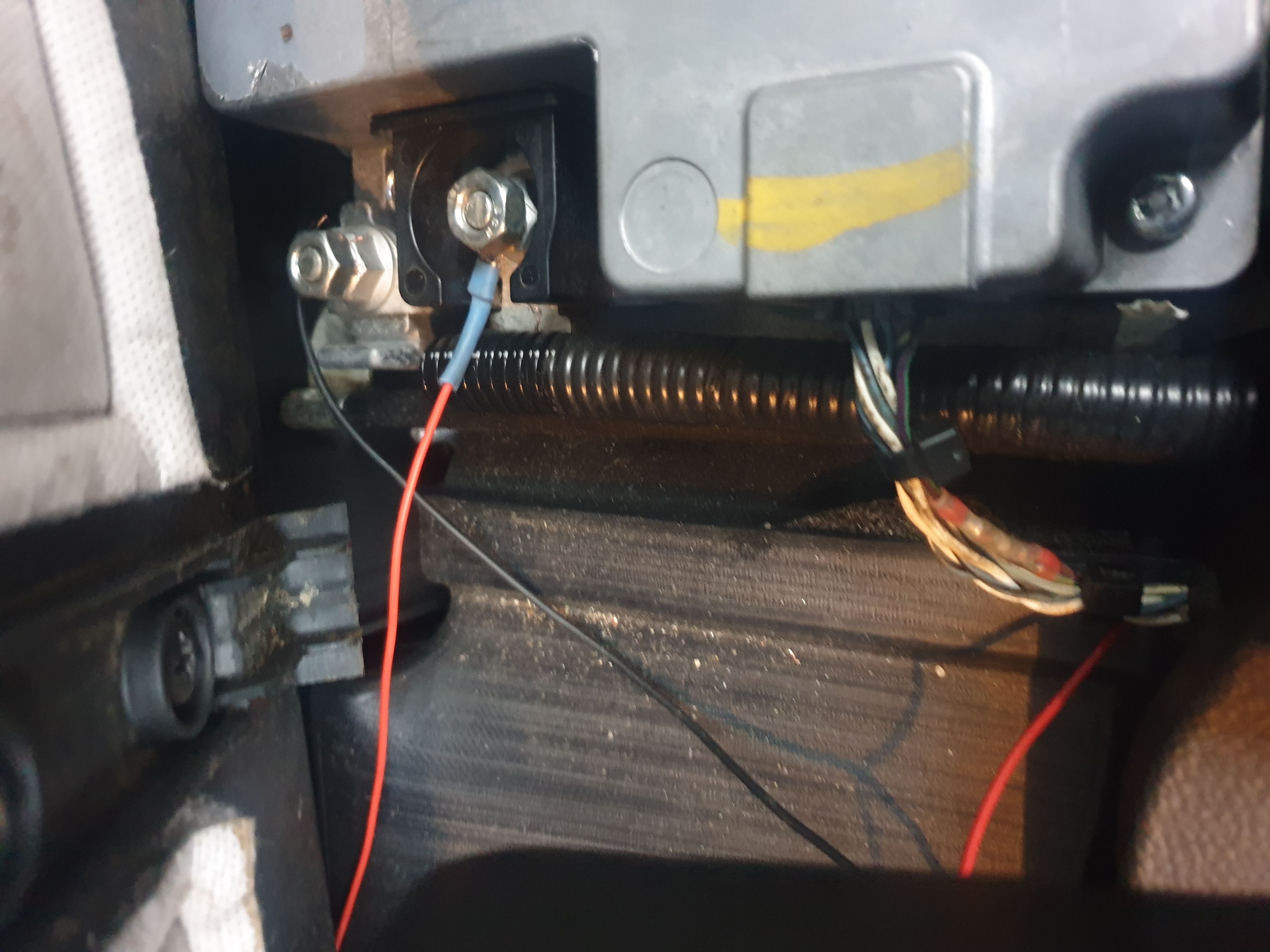

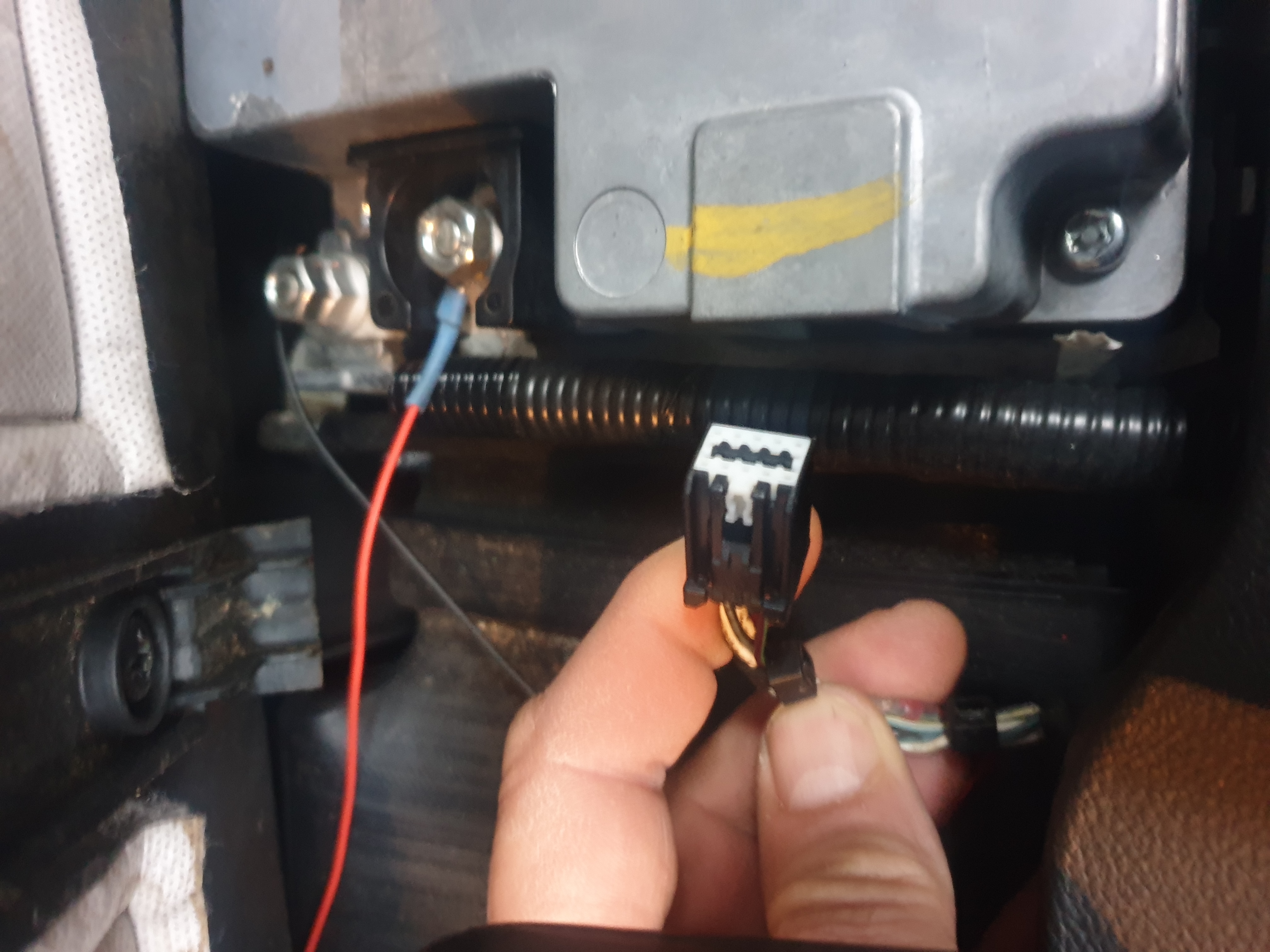

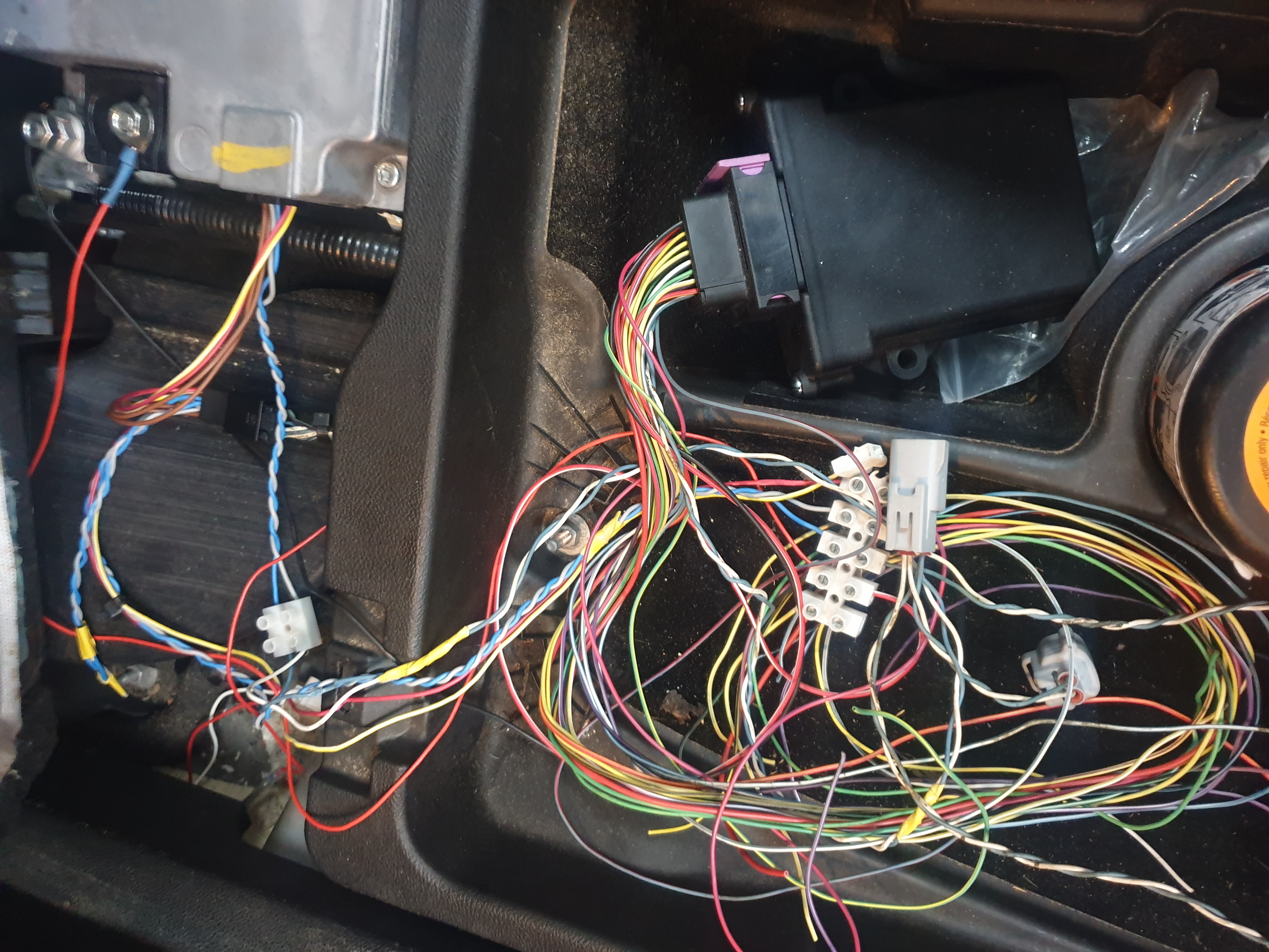

In the car i removed the carpet in the back which let me to access the AUX battery terminals and DCDC connector.

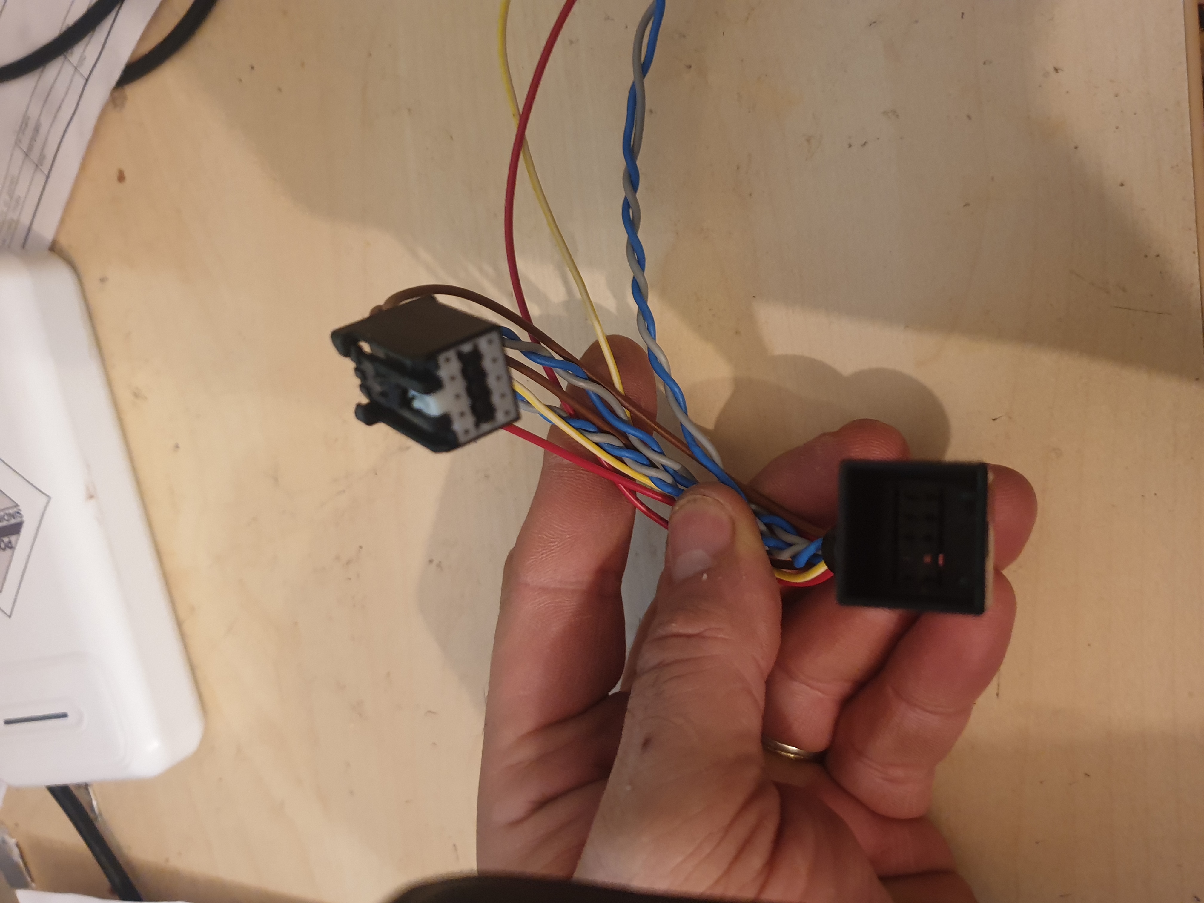

I then rewired my connector and connected it to VCU. Of course i verified CAN transmission befrorehand with my CAN tool.
Inside VCU firmware i prepared a logic input that i called Cp (before i used it to sense EVSE Cp signal) to sense when Enable pin will signal DCDC to go ON (i pressed start button).
Then VCU starts to send CAN telegram at the rate of 25ms so it is faster than regaular DCDC signal at 100ms.
At first i tried to simply inject my faster CAN telegram over the OEM telegram and force DCDC to go to lower value of 14V. It wouldnt work. I literally had to remove the CAN wires so DCDC would only observe my CAN telegram.

As i tried the first option result was encouraging.
Ampera would start from cold morning with 14V battery charging. It wouldnt matter if aux battery would be 13V or 11.8V, car would start. Previously i would get serious DTCs if aux voltage would go below 12.4V.
I am more hopefull for aux battery longevity now. Also thare is less chance of car breakdown because of firmware glitch...
Of course there are downsides to this simple method too. Since i only issue CAN command to DCDC from my VCU and dont want to let the car command it i had to totally cut CAN lines to DCDC. This means its voltage and current report does not arrive to HPCM2 module. Car then signals "aux voltage system error" light, but no DTCs.
I didnt notice any other side effects as of yet.
