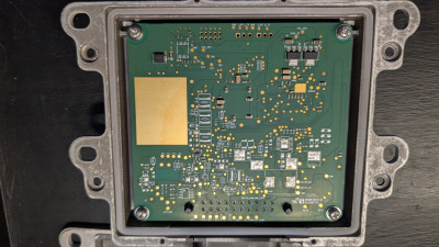

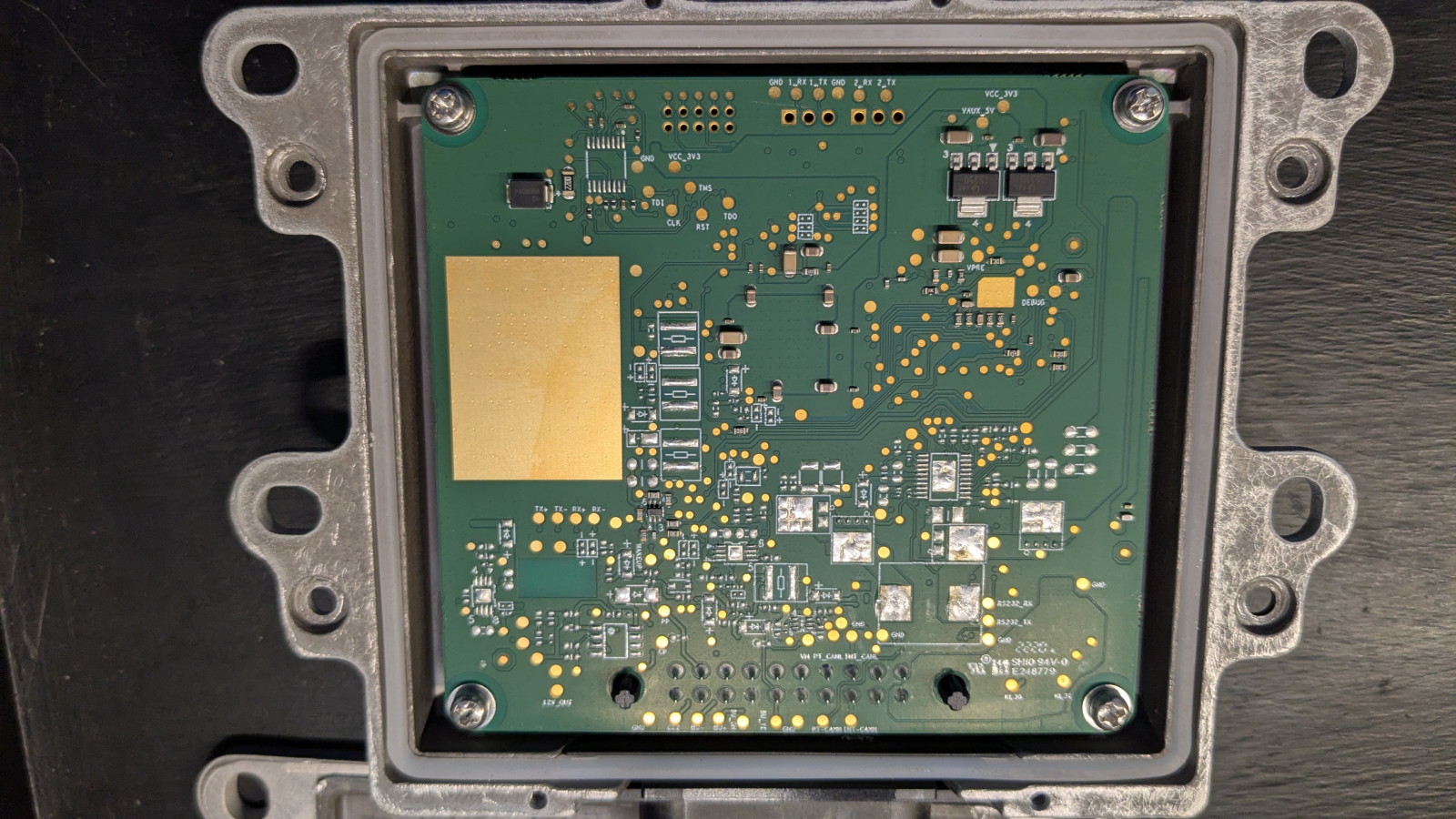

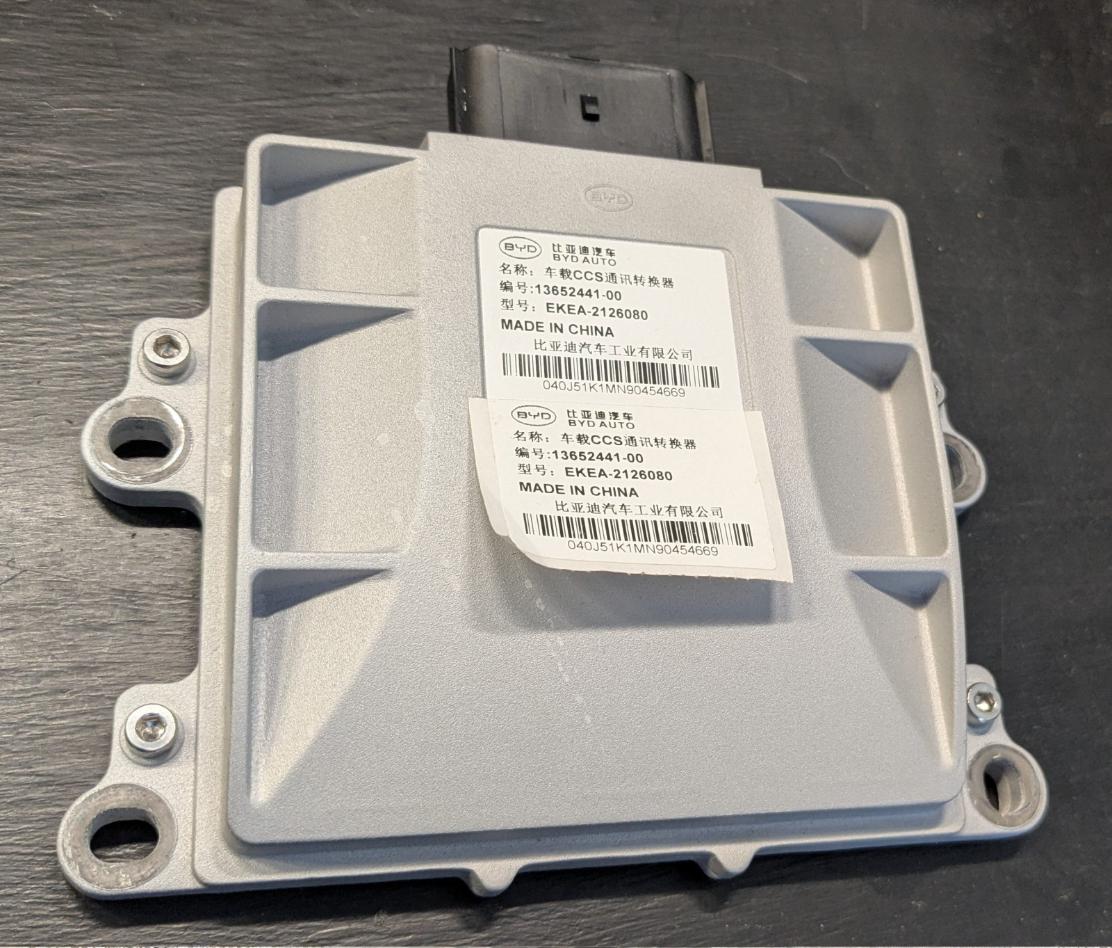

I had the chance to examine the CCS DC fast charging controller module from a BYD Atto 3 today, and thought I'd share some findings. This module is similar to the Hyundai one, as in it talks CAN messages on one side and negotiates the CCS2 PLC data link on the other side.
This module only has six pins connected in the Atto 3: 12V power, two grounds, CAN H/L and the charge port CP connection. It's on a dedicated "Charging sub-network" CAN bus with only two CAN nodes: this CCS module, and a port on the Integrated Intelligent Controller (basically VCU+OBC super-unit, inside the motor stack).
External label is mostly in Chinese (“车载CCS通讯转换器” is "Vehicle mounted CCS communication converter device"). There's also a serial number and a model number EKEA-2126080.

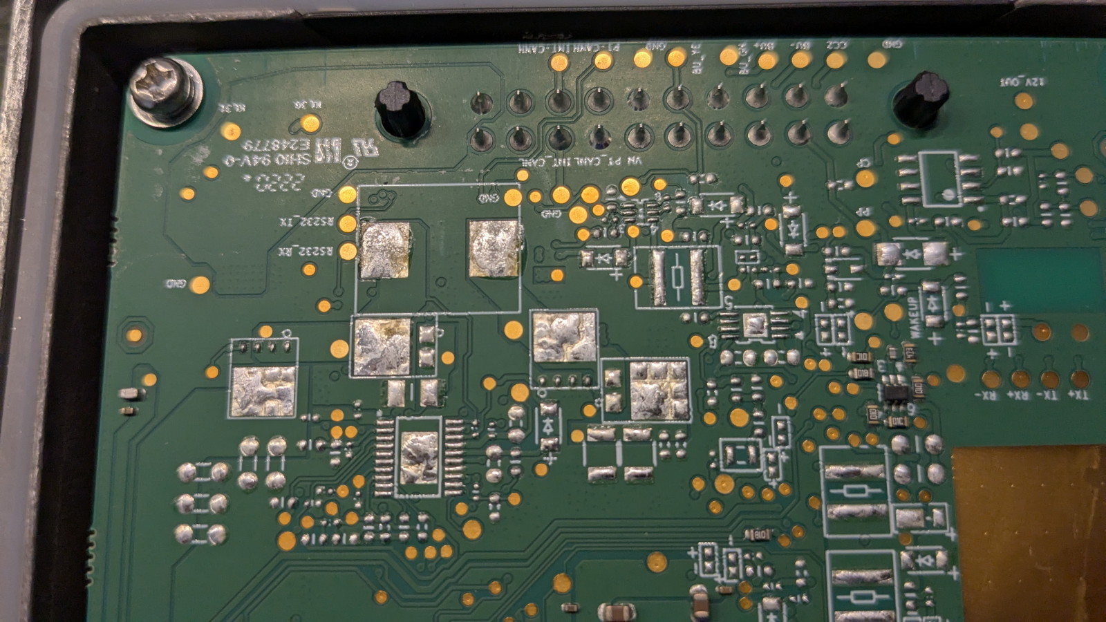

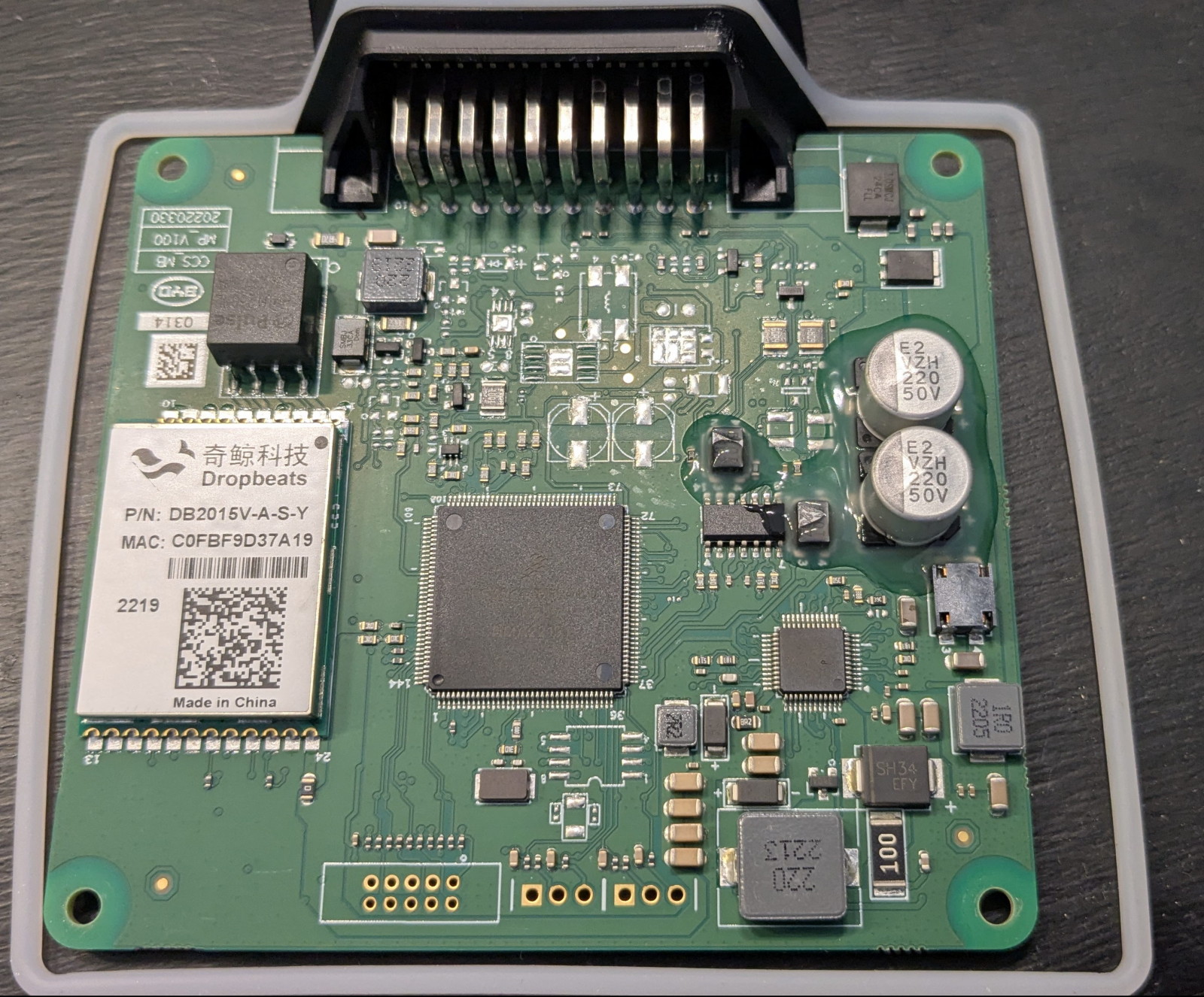

Inside, the PCB is very well labelled with a lot of test points:
(The photos look better zoomed in, but unfortunately still slightly blurry.)
The canned module on top is a Dropbeats DB2015V-A-S-Y QCA7005 PLC interface module.
Poking around the Dropbeats (Chinese name 奇鲸科技) website reveals the BYD module is a version of their DB EVCC 500 module. There is a 10 page "External" datasheet on that page, including a pinout that matches the BYD wiring diagram (with mirrored pin numbers). However it looks like the BYD version has the extra features of the OEM product (like the second UDS CAN port) unpopulated on the PCB.
The main microcontroller is an NXP FS32K148HRVLQ in LQFP144 package. Seems like a non-advertised variant of their S32K1 line. Cortex-M4F based microcontrollers with lots of automotive-focused peripherals.

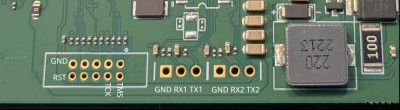

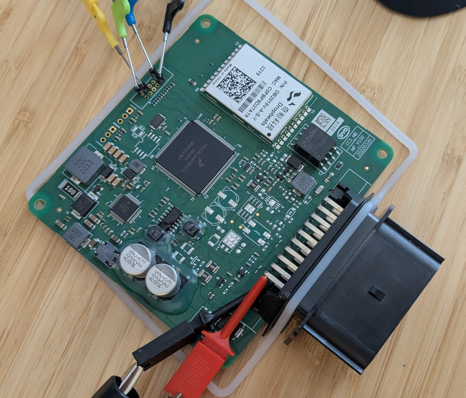

I tried connecting to these pin headers on the board (as labelled on the bottom test points):
Both UARTs are 115200bps with 3.3V levels. First one:
EVCC Bootloader, designed by Drop-beats. Version number: 1.0.1.
udsPef = 0x00.
UDS started.
UART1 console initialized!
eMobility_EVCC by Drop-beats. BSP Version number: 2.0.4.
The last build time: Mar 12 2024, 10:18:20
EEESize = 0x00001000.
Current board ID = 12
[sbcMode, prevMode] = [2, 0].
SBC Initialization succeeded!
SBC Monitor task created.
Elocker not enabled!
CORE_CLK = 80000000 Hz !
eMobility_EVCC by Drop-beats. APP Version number: 3.0.11.  NvParam Ver: 2
Application build time: Mar 12 2024, 10:19:35
A password is required to enter DBSH !
Waiting for PLC network to be ready ...
PLC network is ready !
PLC test passed!
dbsh>

Second one:
DBev>
DBev>
DBev>
DBev>help
Invalid cmd
DBev>h
Invalid cmd
DBev>u
Invalid cmd
DBev>list
Invalid cmd
DBev>
DBev>␀DBev>
DBev>help
Invalid cmd
DBev>up
Invalid cmd
DBev>info
Invalid cmd
DBev>a
Invalid cmd
DBev>b
Invalid cmd
As you can see I didn't have much luck interacting with them (first one requires a password, second one I couldn't guess any valid commands.)
The 10 pin header appears to be a standard 2.0mm pitch ARM Cortex-M debug header. This allowed SWD debugging immediately(!), like most automotive OEM stuff debugging seems to be left enabled.
Using pyocd I was able to dump the flash without any trouble, seems like this part has 1.5MB flash. Strings in the binary suggest it's based on FreeRTOS, and is a special firmware build for BYD. (Amusingly, even though I couldn't find this chip variant on the NXP website it's listed in the CMSIS support pack so pyocd pack install S32K148HRxxxLQx worked and then:
$ pyocd cmd --target S32K148HRxxxLQx
Connected to S32K148HRxxxLQx [Running]: 00000080502032204a305030313030323131303197969903
pyocd> savemem 0x0 0x4000000 flash_dump.bin
Transfer failed: Memory transfer fault @ 0x00180000-0x00180fff
pyocd> savemem 0x0 0x00180000 flash_dump.bin
Saved 1572864 bytes to flash_dump.bin
pyocd> savemem 0x10000000 0x00180000 flexnvm_dump.bin
Transfer failed: Memory transfer fault @ 0x10070000-0x10070fff
pyocd> savemem 0x10000000 0x70000 flexnvm_dump.bin
Saved 458752 bytes to flexnvm_dump.bin
pyocd> savemem 0x1400_0800 128 cse_pram.bin
Saved 128 bytes to cse_pram.bin
pyocd> savemem 0x1400_1000 128 cse_pram2.bin
Transfer failed: Memory transfer fault @ 0x14001000-0x1400107f

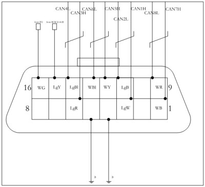

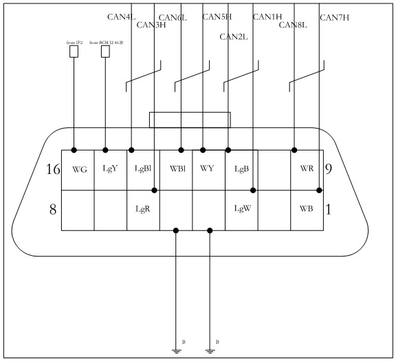

projectgus wrote: Sat Jan 04, 2025 6:44 am (The one thing we don't have yet is a CAN log, I think the only way to get one would be to probe the "Charging sub-network" while DC fast charging...)
I'd forgotten this CAN sub-network is also routed to non-standard pins on the OBD2 port, so this could be done from inside the cabin and without disrupting any wiring...
Marat
Posts: 29
Joined: Wed Nov 16, 2022 6:24 pm
Been thanked: 12 times
Re: BYD/Dropbeats CCS controller module
Post by Marat »
pin ?
projectgus
Posts: 74
Joined: Tue Dec 08, 2020 10:33 am
Location: Castlemaine, Australia
Has thanked: 39 times
Been thanked: 33 times
Post by projectgus »
Marat wrote: Sat Jan 04, 2025 9:01 ampin ?
According to the RHD wiring diagrams here, Charging sub-network CAN-H is OBD pin 9 (Pink) and CAN-L is OBD pin 10 (Violet). The same pink/violet colour scheme is used for multiple different CAN networks.
None of that matches the diagram you posted, though, so I'm not sure what to make of that.

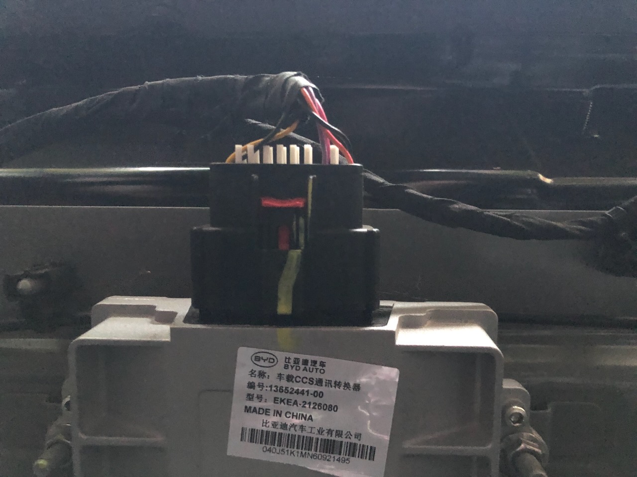

FYI, the MY24 converter has a slightly different part number: EKEA-2126080A. It also has two more pins connected -- pins 14 and 18. They match the CAN colouring convention of pink and violet, but that doesn't jive with the DB-EVCC-500 docs. See the (better) first pic below, compared with the second pic from a MY22 car.
Turk wrote: Thu Jan 16, 2025 11:51 pm The issue is with the Resistor hanging off the PP pin to 5v.
It looks like the converter's PP pin is unused in either version.
