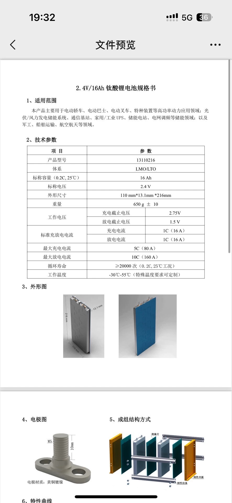

3. 8kWh LTO battery pack, to be tied directly into the Gs450h inverter HV bus as usual. The brand of cells is "TianKang" which I am importing from China with purportedly 93% SoH - the seller says they came out of an electric train which is pretty awesome.

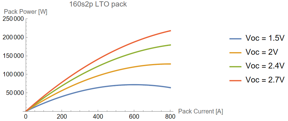

3. The concept of an unkillable chemistry appealed to me very much - immortal battery pack. Furthermore, in the GT86 chassis it seems impossible to fit a very large amount of battery easily. If the capacity is limited, C-rate must be high enough to support the 200kW Gs450h. I weighed up my options, and LTO seemed to be the safest, most impressive cycle life option. Cons are that they have poor energy density, but the main design criteria I am aiming for is power instead of range. So this isnt a huge problem, at 25C, 8kWh is enough. Which is about 143kg, 70L.

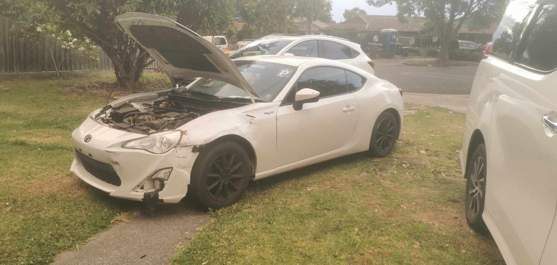

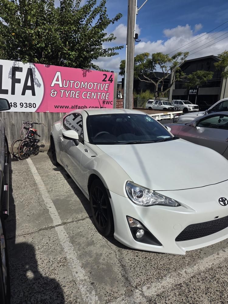

1. So, the project is finally kicking off because I have finally pulled the trigger and bought the car I wish to convert. It's my first car :) It is written off though, and needs some repairs before it can be registered again. Once the conversion is done another certification will be needed before it becomes road legal with the EV modifications. This paper-work seem scary.

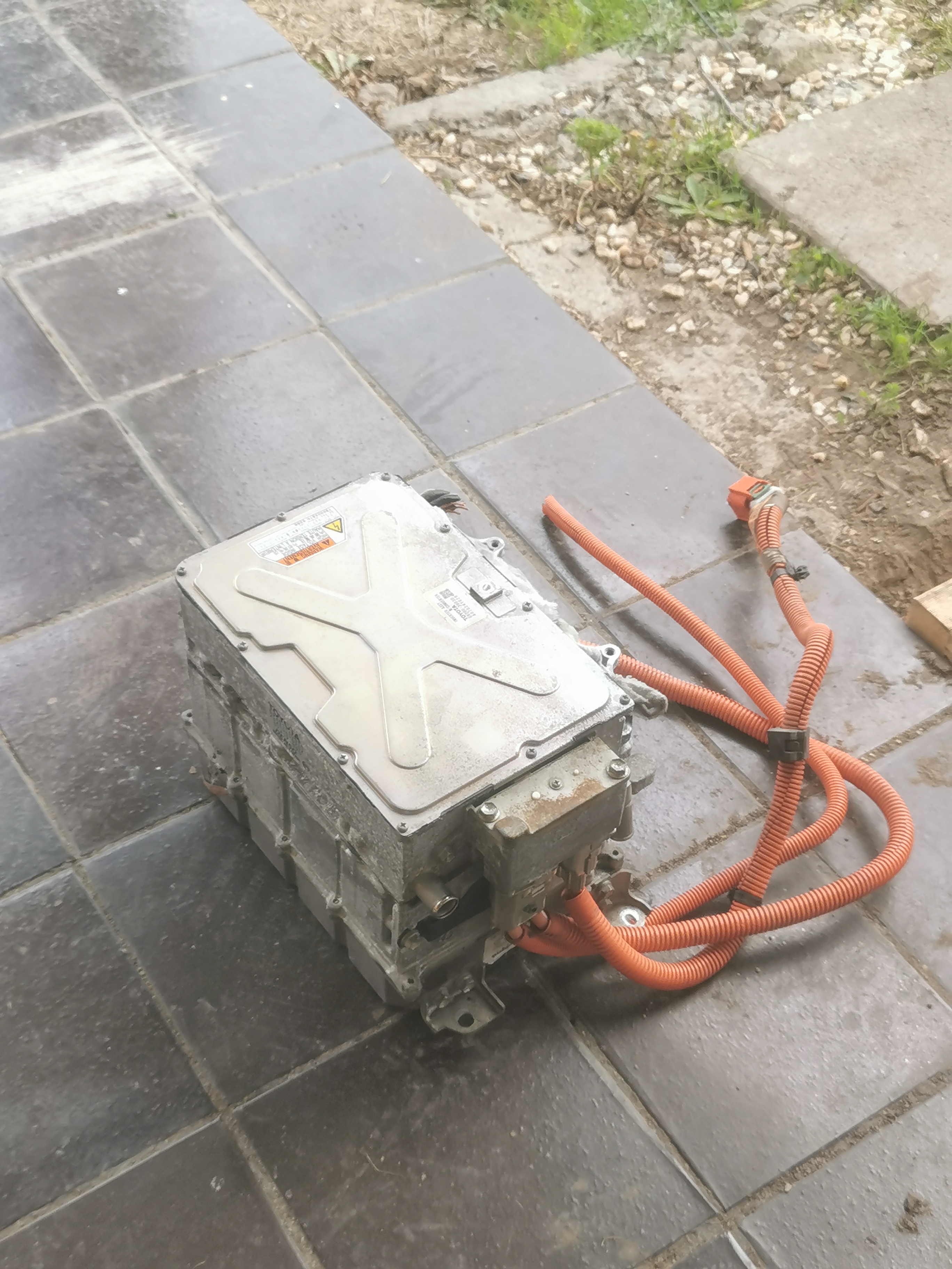

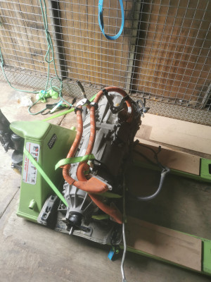

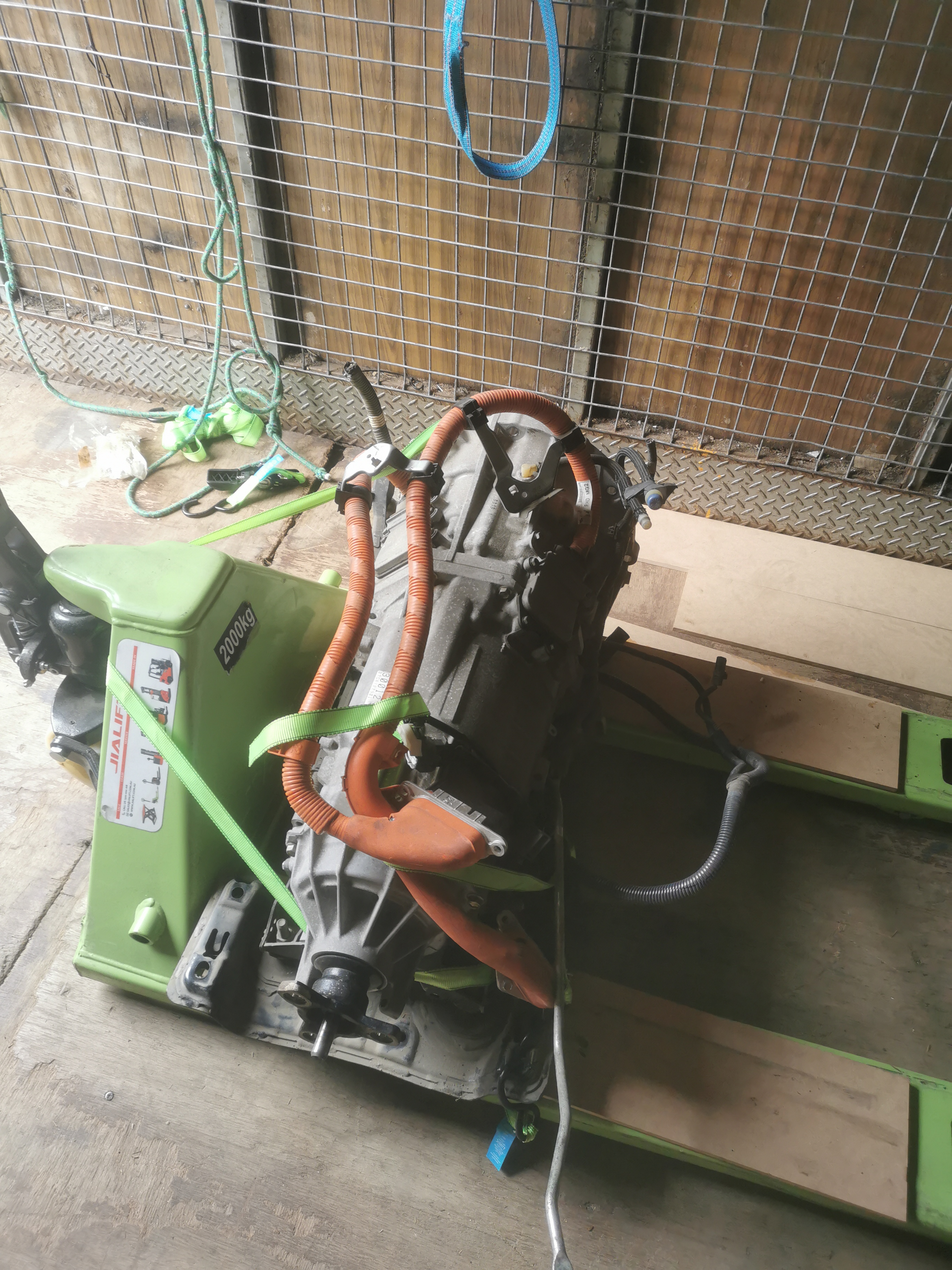

2. About July 2024 I sourced a Gs450h tranny and inverter from a nice bloke who is a retired panel beater. He was stripping the car for parts and got it for $1500AUD which seemed very good.

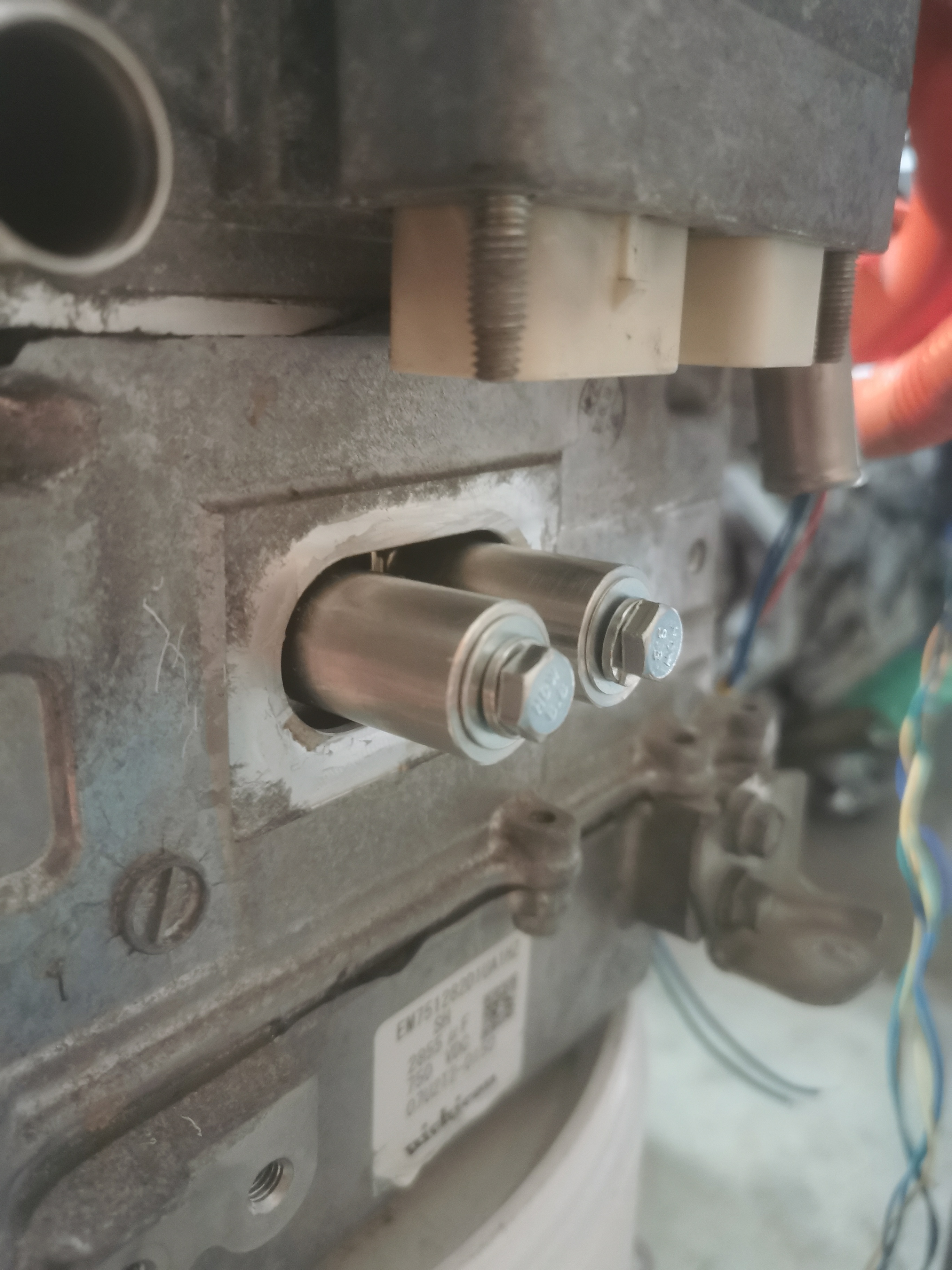

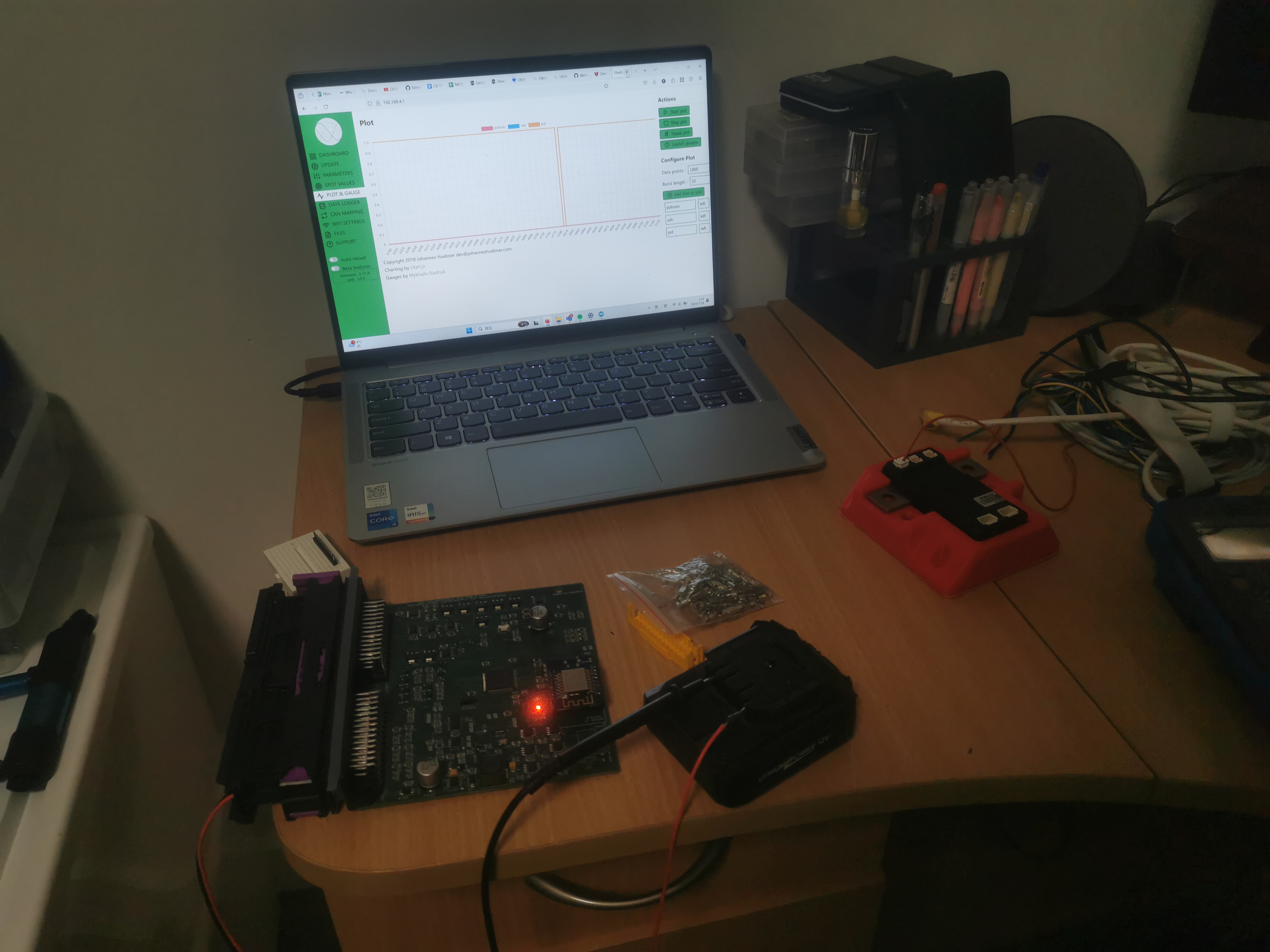

4. I assembled my own zombieverter, with board from JLC and some missing chips from digikey. It has been programmed and hooked up to the inverter. After a bit of troubleshooting (it was surprisingly very well behaved), the Gs450h is now spinning! The project is practically done then... right? whats an EV but a big box built around an electric motor.

An idea for the future with this project (and potentially any Gs450h project, though it makes most sense for my choice of chemistry) is to make use of the boost converter in the Gs450h inverter as a "range-extender". I can make use of a more energy dense chemistry that doesn't necessarily support the same power density as the LTO pack. And recharge the LTO pack at up to 30kW which is plenty for any legal cruising speed. The big challenge here is controlling the boost converter which afaik no one has figured out. Some others have been curious about this, I was heavily dissuaded when Johannes himself said something like "that will be hard, start with something simpler". I haven't been able to put down the idea entirely, so the system should now be modular and work as a 'bog standard gs450h conversion" with the LTO pack only, albeit with very poor range. With opportunity to increase that range.

I've finally gotten the car's title clear of the write-off status!
Necessary to get this done before doing any of the modifications, its much easier to verify the safety and completeness of repairs when the car is still stock. The process was very very arduous and involved a heap of faffing about getting the right paperwork for only very minor damage. This is probably a very niche comment that is relevant to no one on this forum but DO NOT go for the VIV here in Victoria unless you have something real sentimental. But anyways, the repairs are all done!
I was hoping to get started on the EV conversion sooner rather than later but this whole VIV ordeal took much longer than expected, and I had planned to go on a semester exchange program in the coming months so the conversion is going to have to wait till early next year probably :(

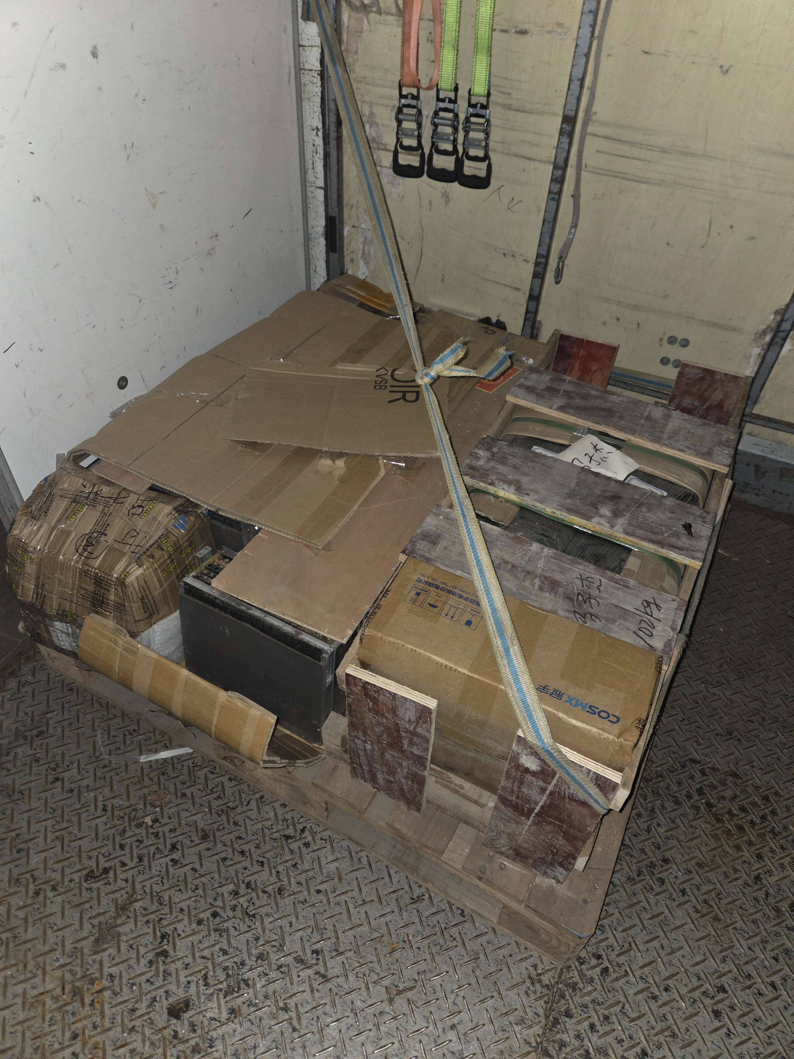

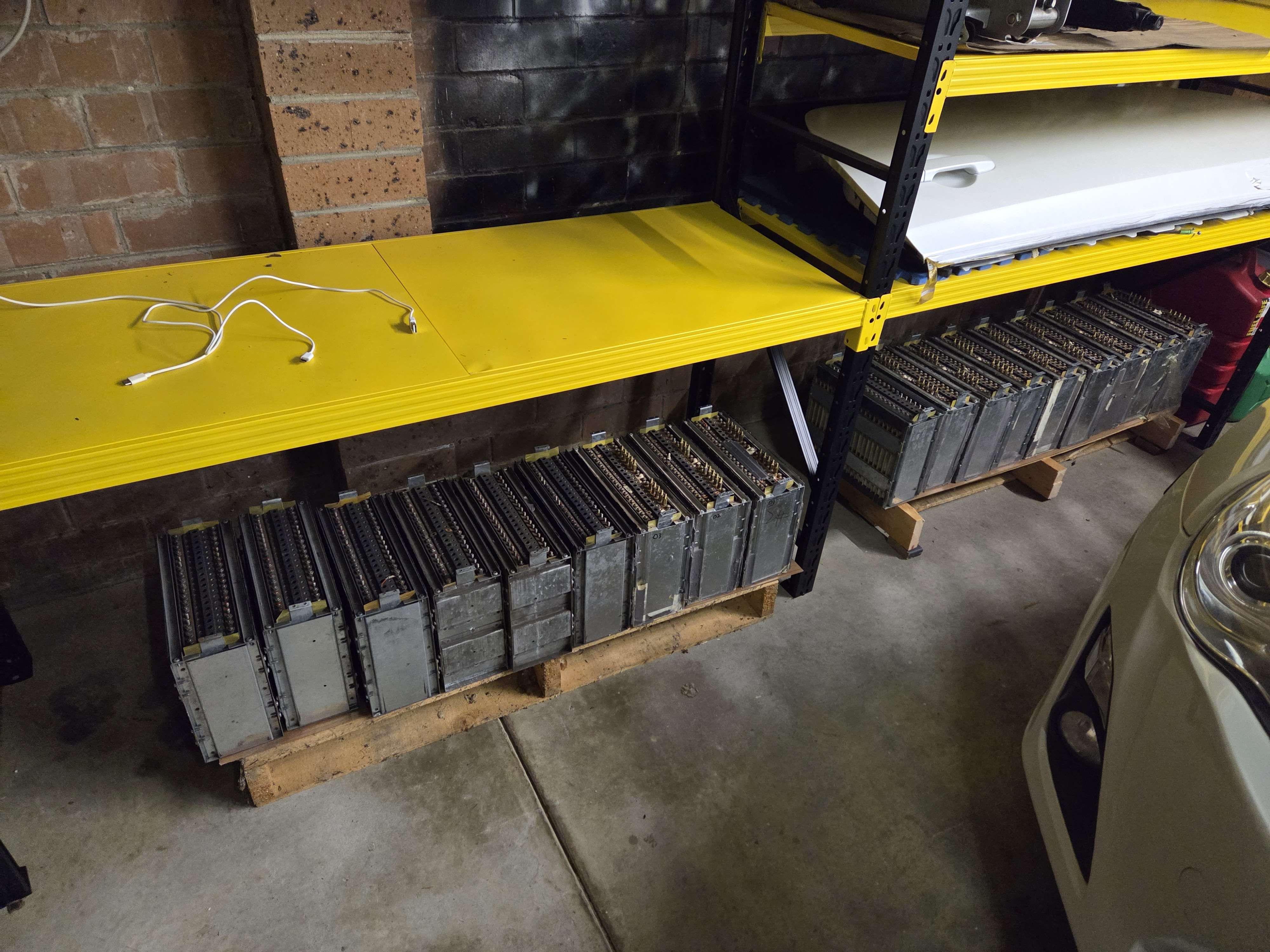

Another milestone! And the last few days have been a bit of a roller coaster. The LTO batteries have arrived
[batteries in their natural habitat (a pallet)]

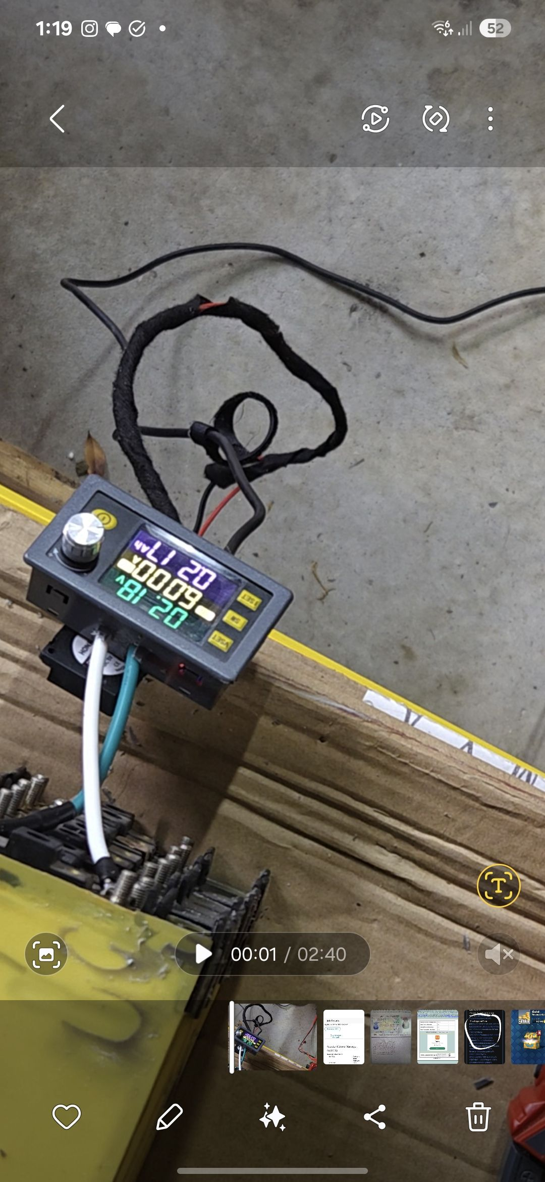

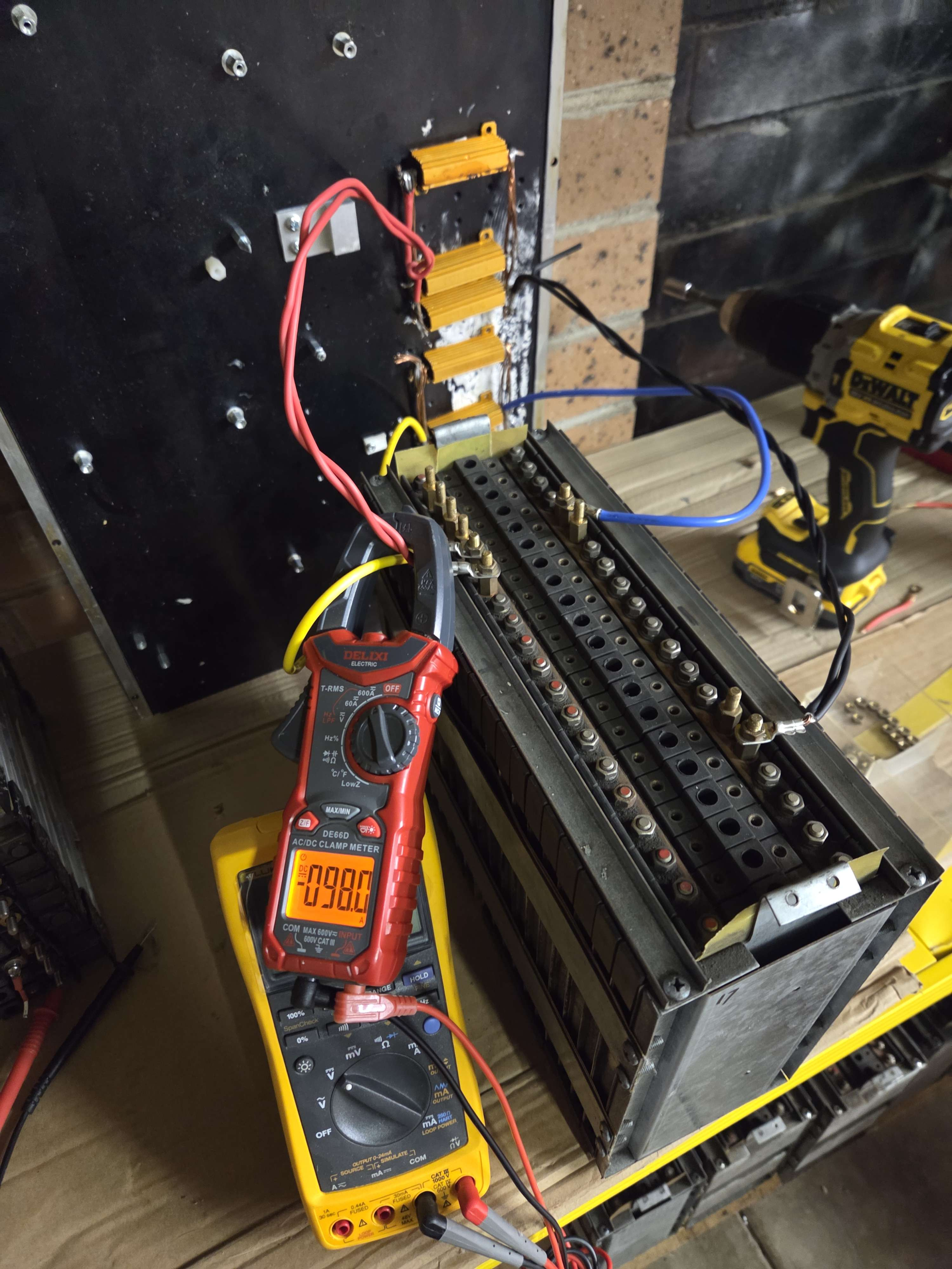

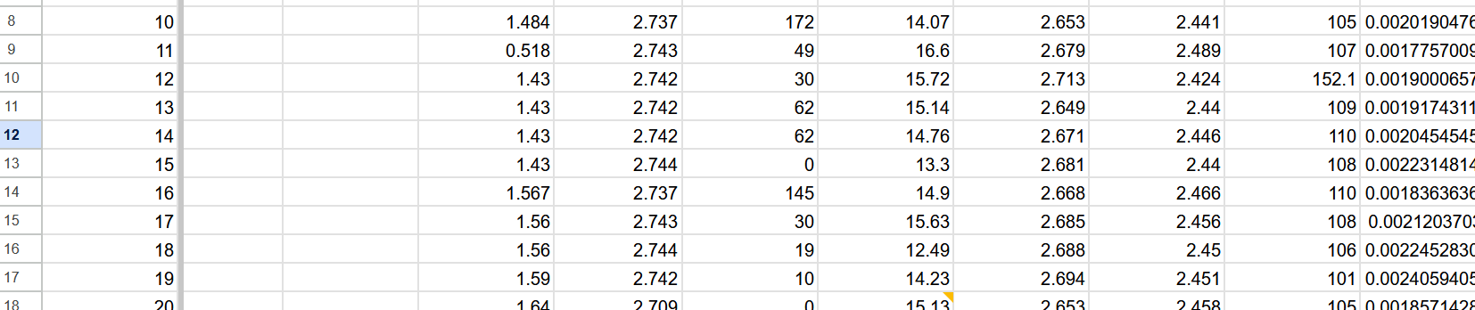

and I've started doing capacity test at the cell level. The cells are testing well-ish, at around 2mOhm, 15Ah. I have a total of 360 cells. The algorithm is basically just
1. discharge pack to 0V
2. disassemble pack
3. charge each cell to 2.75V using trusty aliexpress dc psu, about 2 hours in CC phase @ 6A (hardware limited), then 3 hrs CV phase.
4. test for IR by discharging over 6x 0.1R 50W resistor in parallel and observing voltage drop & current.
They come in modules of 2s10p, and I've only tested 2 modules worth so far, so it is still to be seen if ALL of these cells are in workable condition. I initially had a scare, since the seller sent me a small bundle of 5 cells as a free gift and I tested those ones first... and they tested HORRIBLY - like 4mOhm per cell bad. The rest of the cells in the modules seem to be alright, phew. But not confidence inspiring.

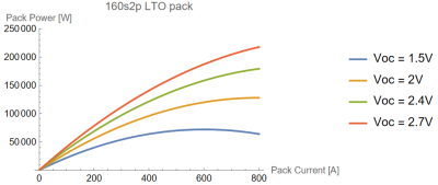

If these cells in the modules are fairly consistent, I'm planning to build a 160s2p pack out of them. The IR is higher than the advertised 1.1mOhm :( so 140kW at the battery is looking like the limit. Still quite speedy for a 200kg pack though.
