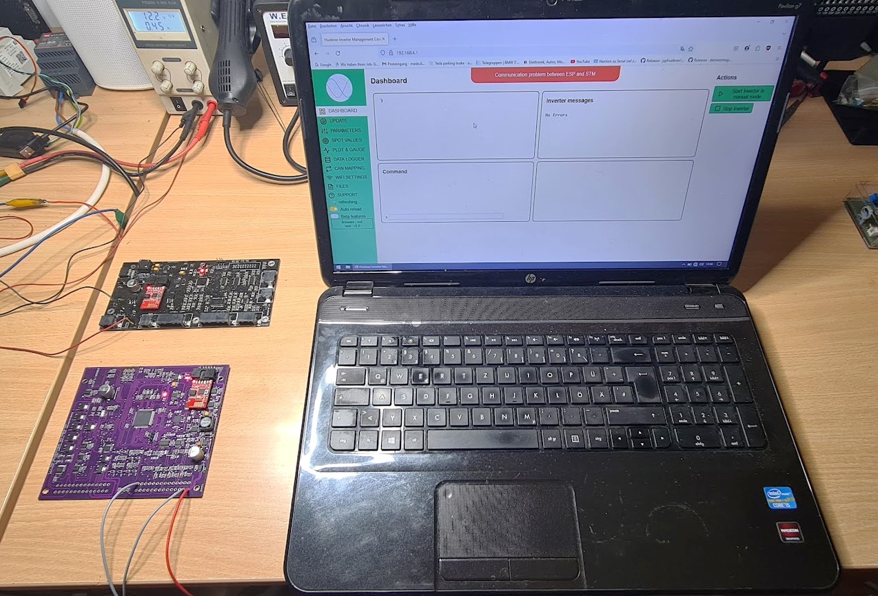

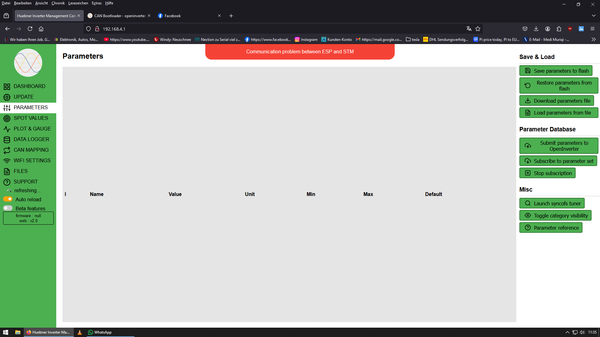

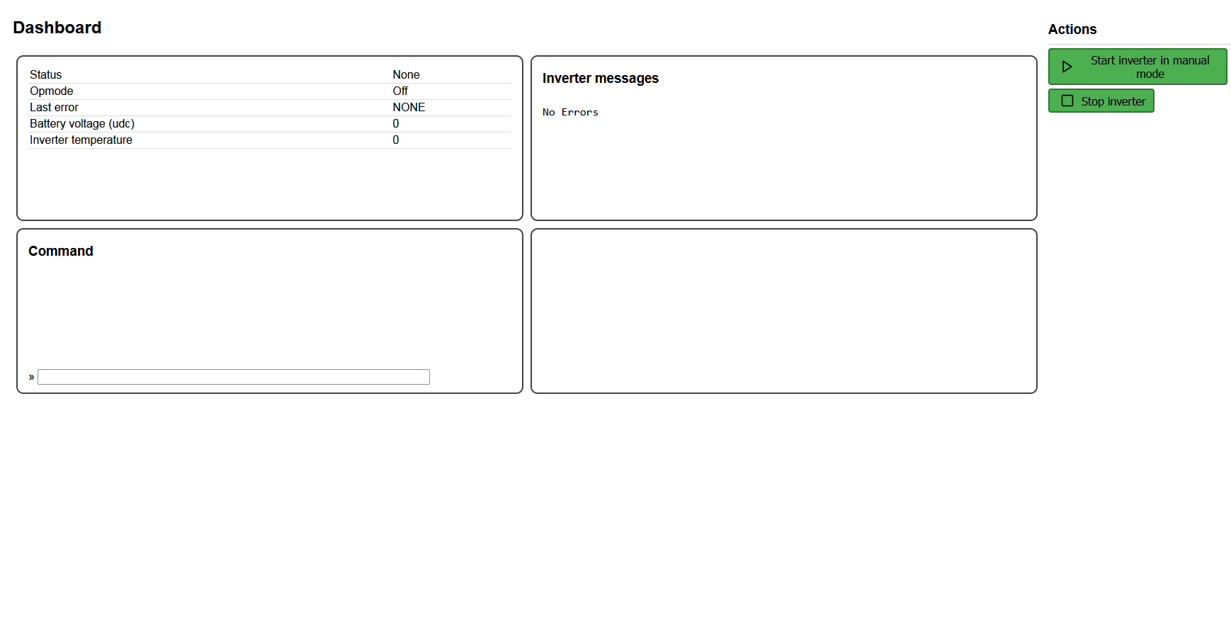

Does anyone know why I can't get a stable wifi connection? Sometimes I see data, sometimes I get the error message "Communication problem between ESP and STM"
I have already tested both modules, Olimex and Wemos D1, both have the same reaction

It means the UART communication between ESP and STM32 has issues. E.g. bad connection, out of sync baud rate etc.
The latter can be improved by running the latest firmware that you find on github. I'm assuming ESP8266 https://github.com/jsphuebner/esp8266-web-interface

I may be wrong, but my understanding was that this error message may be misleading. Because it not only pops up if there is a communication issue between the wifi module and the STM32, but also if there is a communication issue between the laptop and the wifi module. If this is true, I could imagine the following root causes:
- Wifi connection bad (due to shielding or/and distance)
- ESP resets due to bad power supply
To narrow-down such issues, I'm dreaming of some more debug information which could be observed in the web interface, like up-time, communication counters for RX and TX on serial line and CAN, number of TCP packets received and transmitted, ...

I would prefer a wired environment with the appropriate software, wifi would always be second priority because it is susceptible to interference, that's how I did it in the smart home, everything wired, only where there is no possibility
I swapped the modules around and it is always the VCU that sporadically establishes a connection

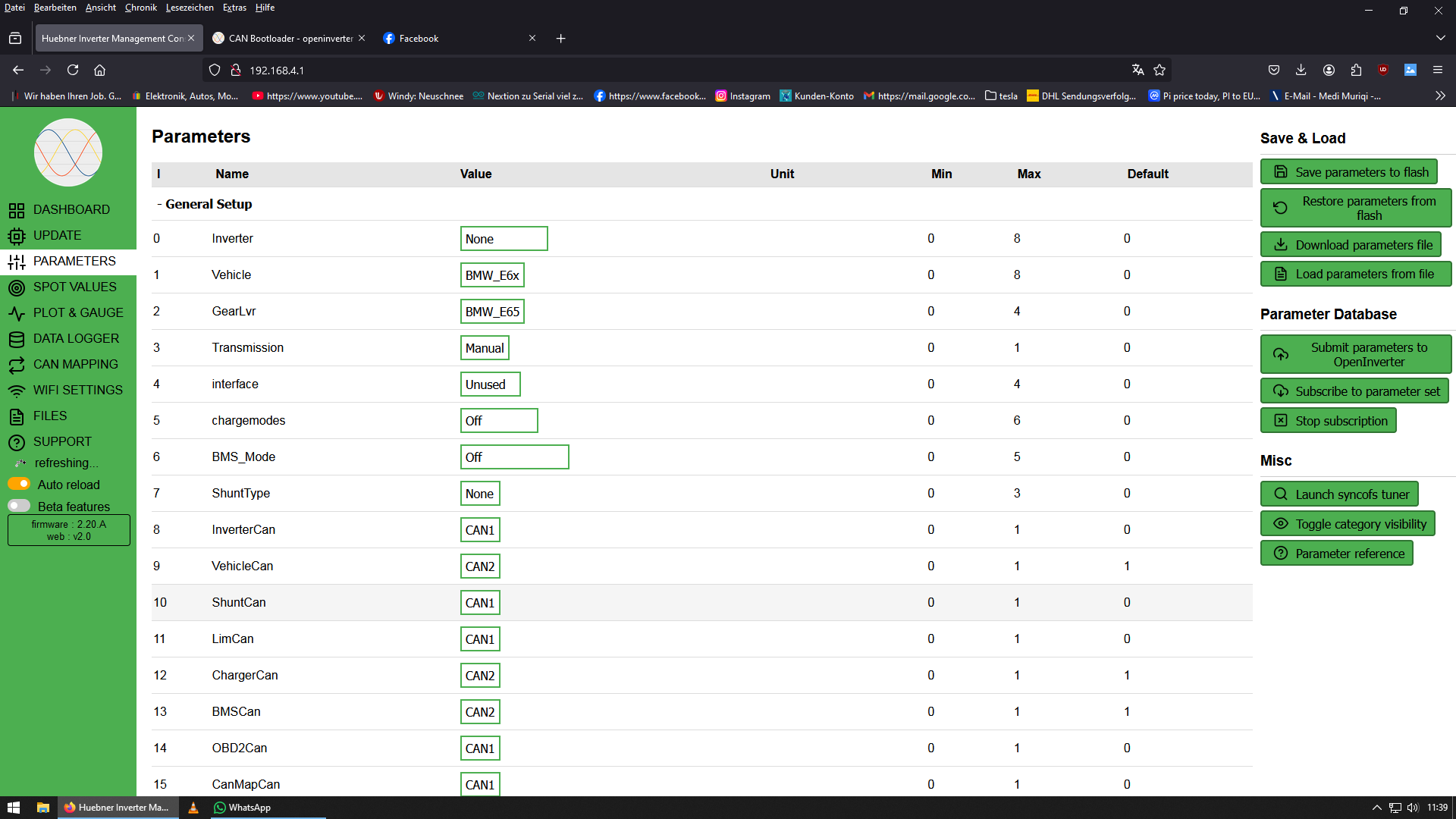

After I switched to the older version of the web interface firmware, everything works as before, the olimex is really rubbish, I have now switched to Wemos, I think the web interface 2.0 is not yet fully developed, at least on the vcu, even with the Wemos I keep having connection problems, my favorite remains a USB connection, which unfortunately does not exist

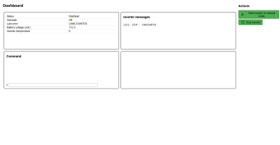

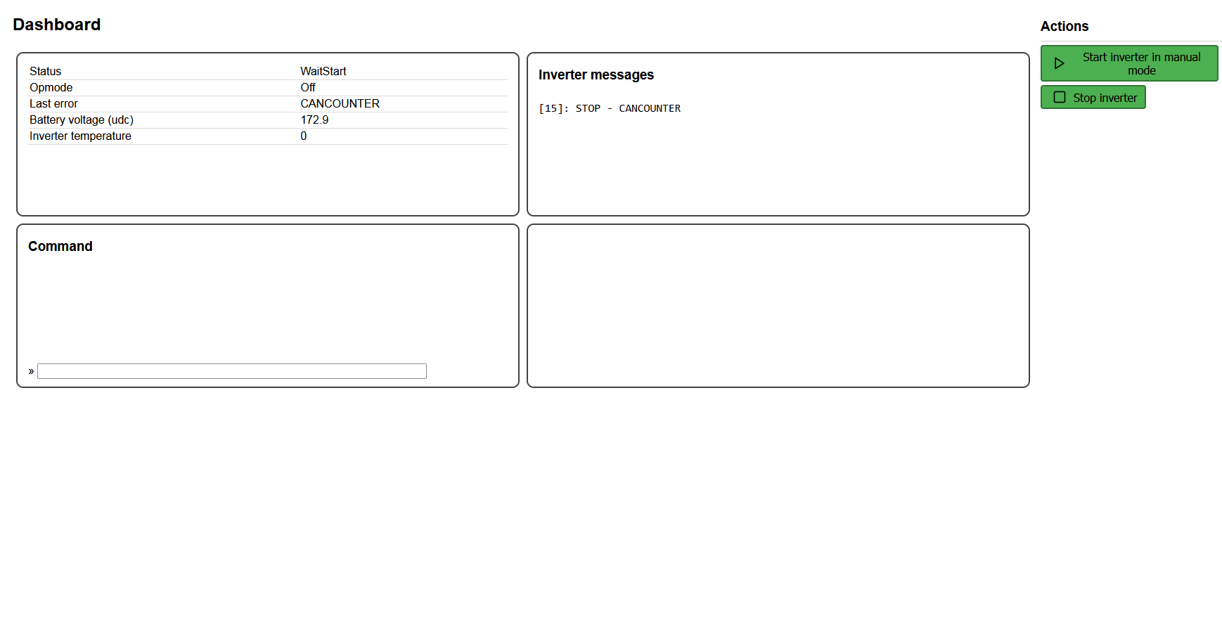

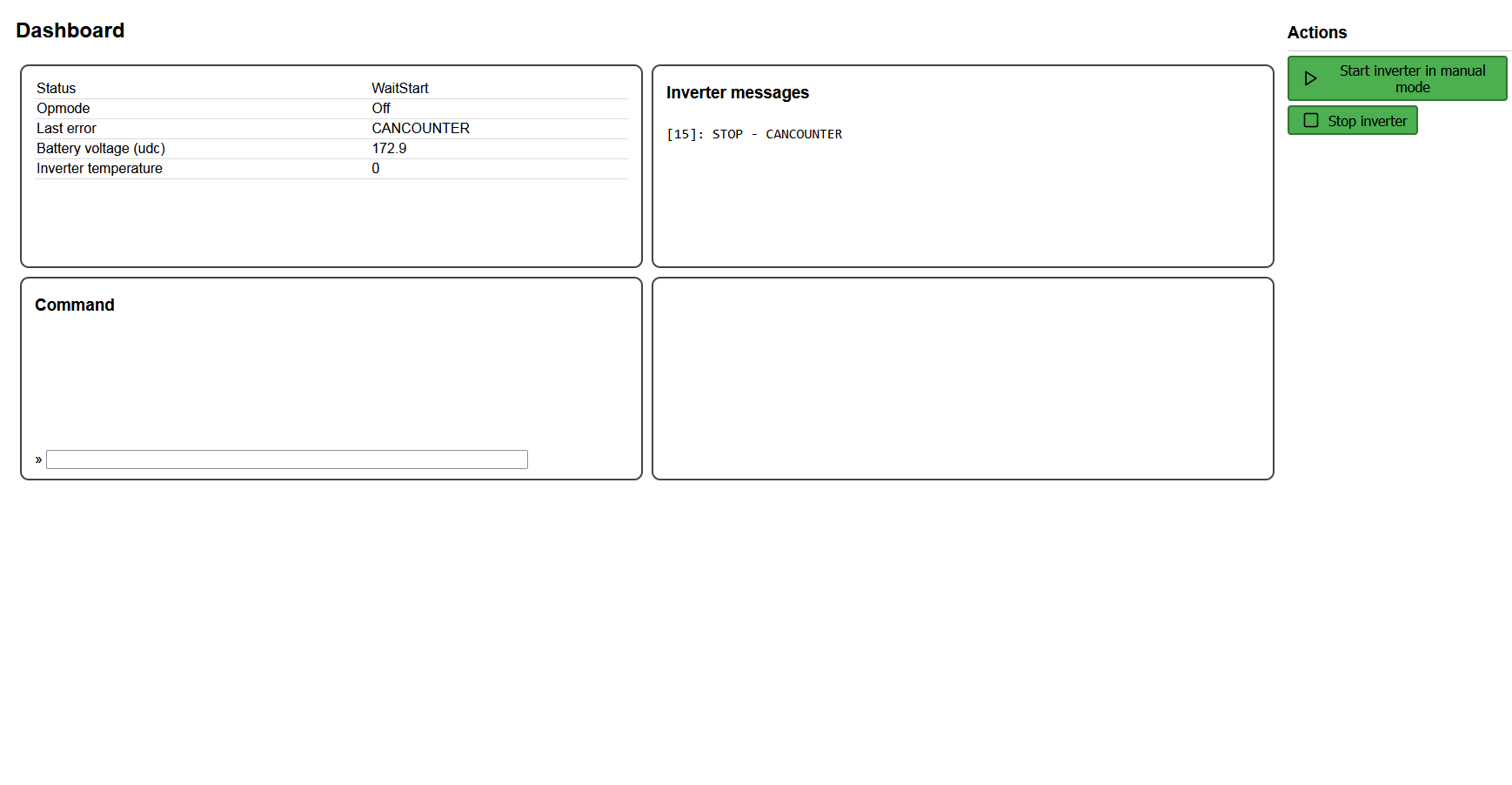

Now I have switched everything to wemos with the latest firmware and logged into the home network, everything works fine, except for a few short connection losses
on the VCU on the LDU everything is OK, except for the error message cancounter, unfortunately I don't know what the reason is at the moment
I also inserted the can id's from 400-430 in the inverter as described, but nothing comes through on the VCU
