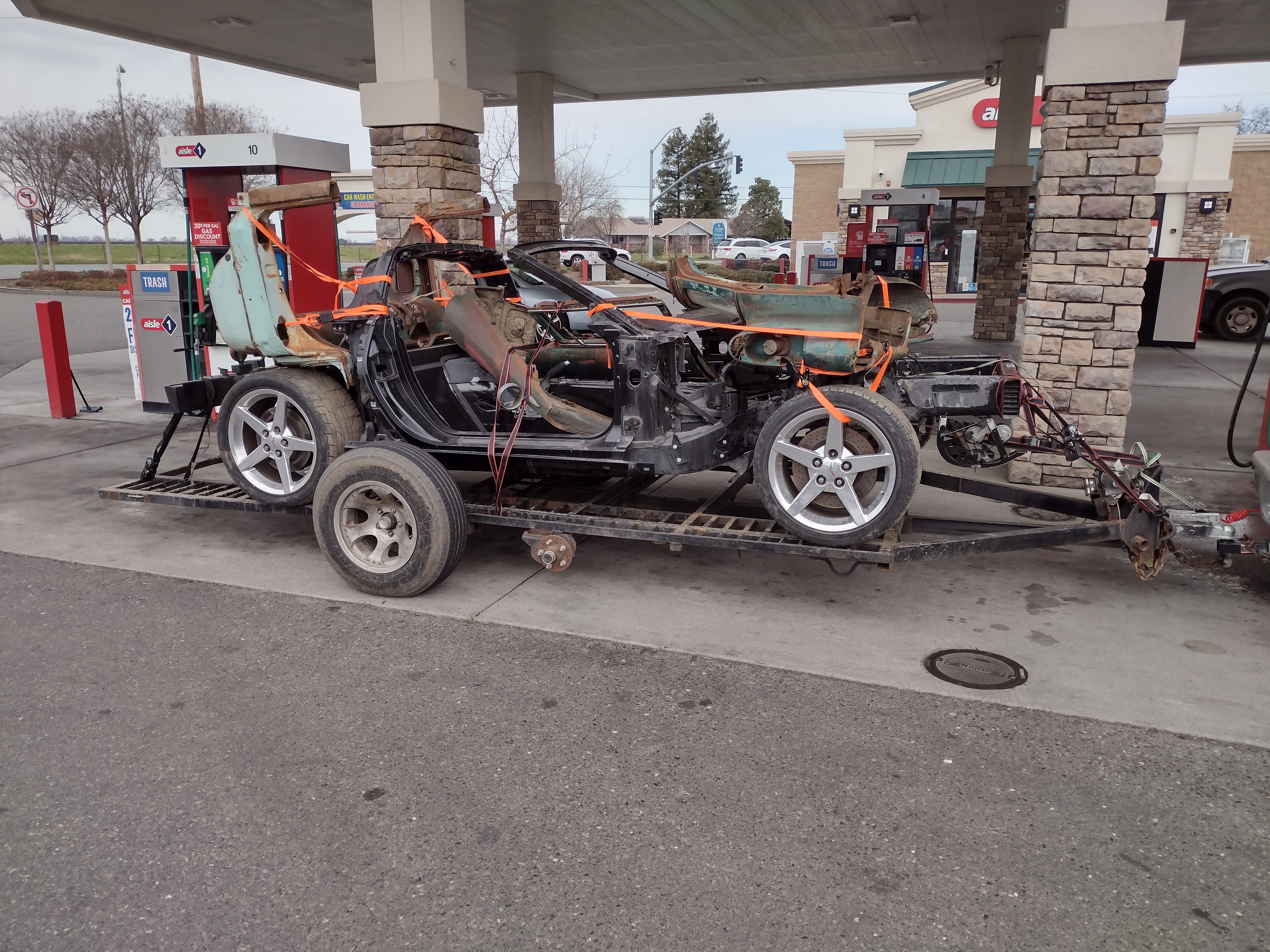

I acquired a 2008 Corvette C6 rolling chassis, could not resist at the price point of $500.

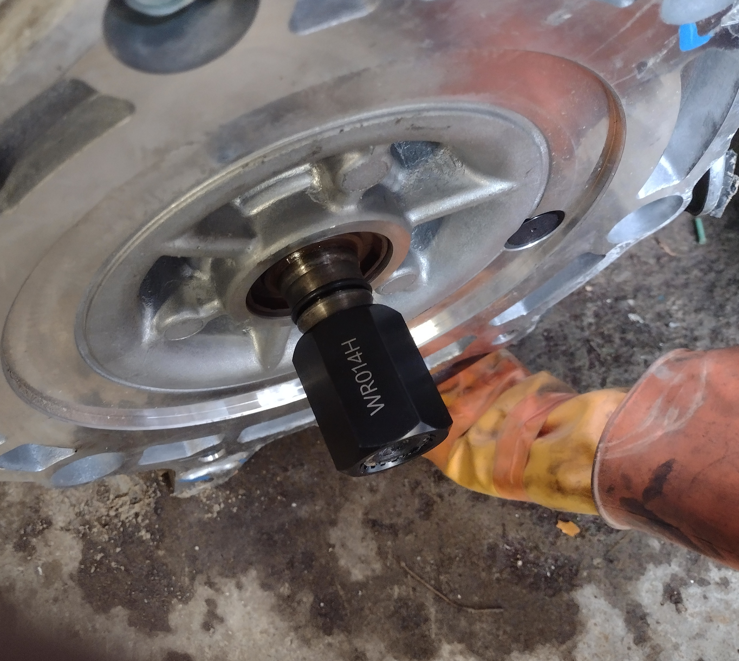

The one thing many might be interested in is a coupler for the Leaf motors. I confirmed that a "shaft holding tool" for a Yamaha jetski using a 22mm-20spline coupler and it fits perfectly to the leaf shaft. Part number is WR014H, amazon sell them $15 (but don't buy from amazon, boycott them..)
I bought a couple from a watersports outfit,
https://www.atlanticjetsports.com/produ ... 6307&_ss=r
I have heard 2 things:
-the fit is actually pretty loose
-the material is quite cheap and will strip very quickly
I have dedicated leaf couplers, made from 4140 steel, with a very tight fit.. as there is nothing available other than the original input shaft
