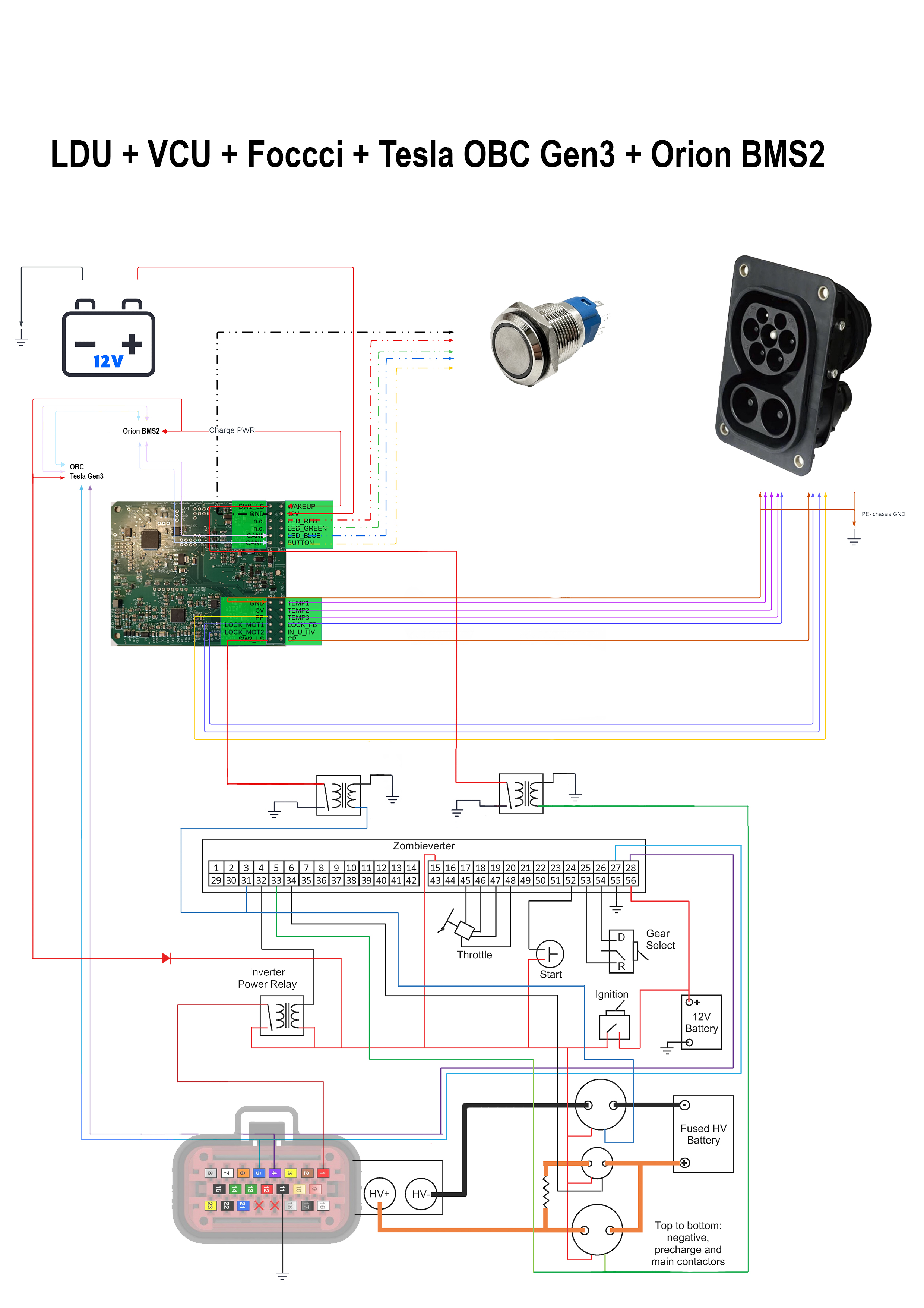

will this work with foccci, LDU, VCU, OBC and BMS ?

would this setup work as shown in the diagram ??
I left out the isa shunt, since the BMS has its own

This configuration will not work out of the box, the ISA shunt is required to complete precharging. It's used to measure the DC bus voltage.
There are ways around this if you're more technically capable.

There is confusion with the contactor control of the Foccci.
What I see in the picture:
- The Foccci contactor pins are wired to relay contacts to ground, which are controlled by the main contactor. This is a mistake.
- There are no CCS contactors. This is a mistake.
What we need:
- Two CCS contactors, which connect the DC pins of the CCS socket to the battery (no matter on which side of the main contactors. Maybe directly on the battery, so that the inverter can sleep during charging. Or maybe better on the inverter side, because the main contactors are the "safety feature" to completely separate the battery.)
- Connect the contactor outputs of Foccci to control the contactors. Yes, these are outputs of Foccci, not inputs.
Attention: Depending on the Foccci version, the contactor outputs are low-side switches (means, the contactor coil needs to be between the 12V rail and the output, or they are high-side-switches, means that the contactor coil needs to be connected between the Foccci output and ground.
Edit: Just checked the wiki, https://openinverter.org/wiki/Foccci , it seems quite clear (for the writer
) how the contactor outputs work. Maybe someone else could add a formulation that is more clear.

it would be good if you could get it right so that all components, i.e. DC and AC charging, work together in conjunction with VCU and LDU

It is your project. Not mine or anyone elses.
You need to wire things and configure things to work for your application.

I think it's not just my project, some people have probably installed identical components and want it to work like that

Then show us how you wired it now.
You also have not mentioned how the Tesla charger is currently controller. I cannot see you project so you must show us.

At the moment it is wired in a classic and minimalist way, the obc gen2, and in order to charge it, the key always has to be in the ignition position so that the main relays are closed. At the moment it works because the car is in the garage at home, but what if you want to go to the charging station while you are on the go?
Since I still have a Gen3 lying around here, I would do the whole thing properly and take out the rear HVJB

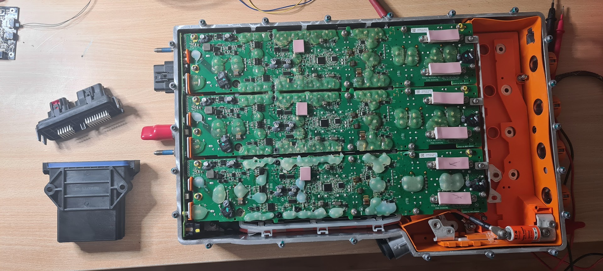

Which version of the Tesla control board do you have?
There needs to be mods to the Tesla Charger control software to allow propper operation without being connected to Control Pilot and Proximity. Also the required changes in ZombieVerter for this. Note that if you have an STM32 control board there also is a crap load of CAN ids on the bus because of having only one CAN, so it will be required to most likely be on its own CAN bus as it will conflict with other ids. This might not be possible with the "standard" Foccci implementation in the current ZombieVerter firmware.
What else is on your CAN bus?
I have done this in a past project with the Tesla Charger, but a very very old board that was running my own firmware (I wrote the original firmware to control the Tesla Chargers).
All of these interactions is what makes projects like these overly complicated thus only really approach able at a case by case basis by the individual doing the project.

What board is in you OBC.
Gen3 tesla charger requires a separate controller, this runs same firmware as the Gen2 charger boards.
https://openinverter.org/wiki/Tesla_Mod ... N3_Charger
https://www.evbmw.com/index.php/evbmw-w ... controller
This is the same issue as with the Gen2 tesla charger firmware as of now, it needs the Control Pilot and Proximity to work. Also the latest firmware version written by Johannes is not compatible with the ZombieVerter for some reason, the CAN messages have changed.

the board is version 5aB3, is there something newer, it's really hard to find
yes I know, I have everything ready here, just the circuit board has to arrive

You are showing everything but the board in the picture...
Still does not change the fact alot of coding changes and testing is required.
