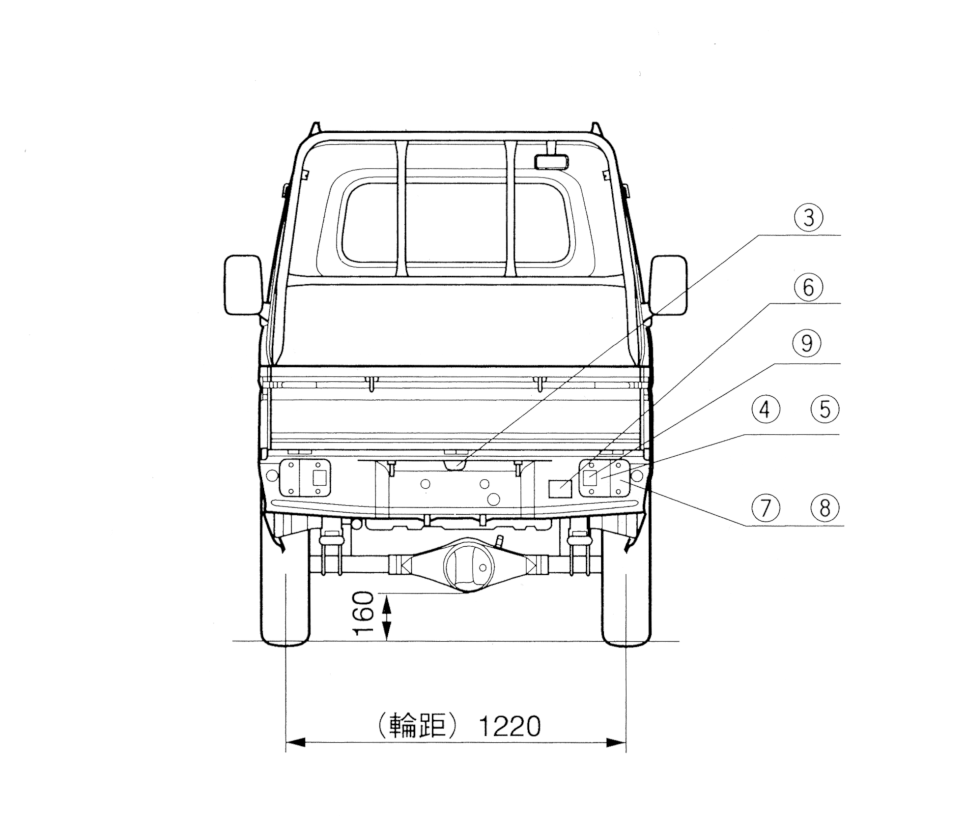

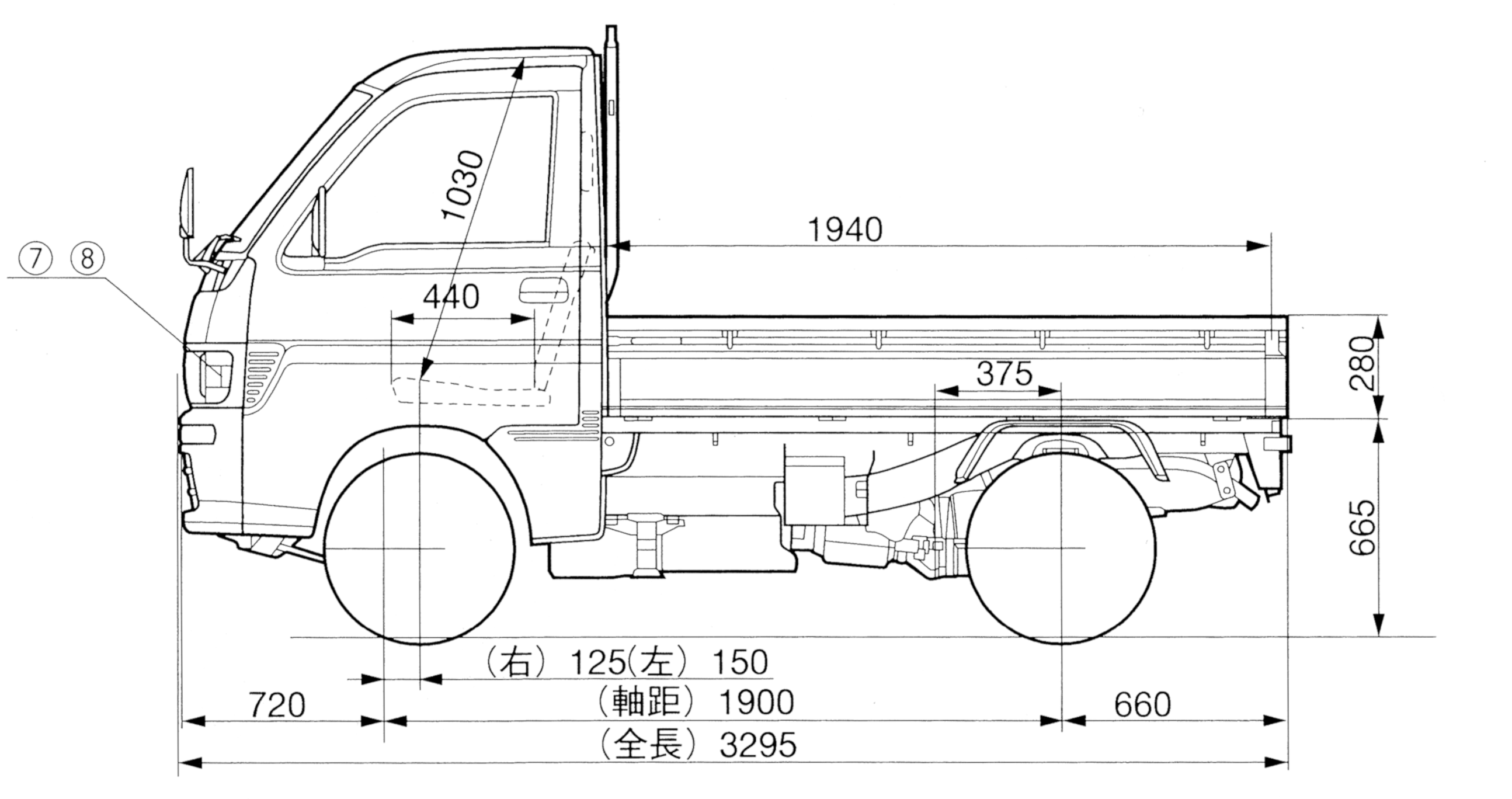

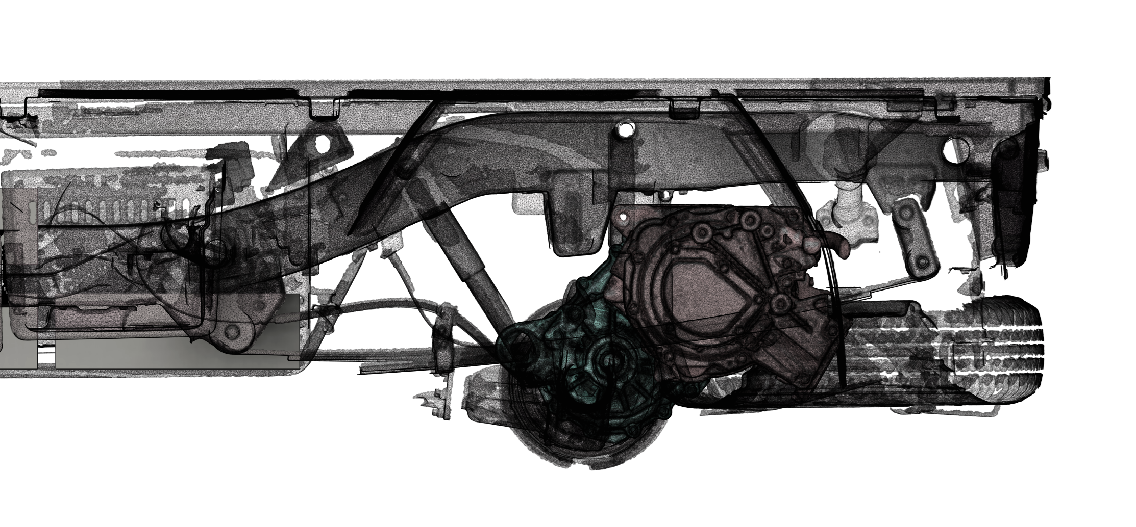

To give a good idea of the space requirements, here are the general dimensions:

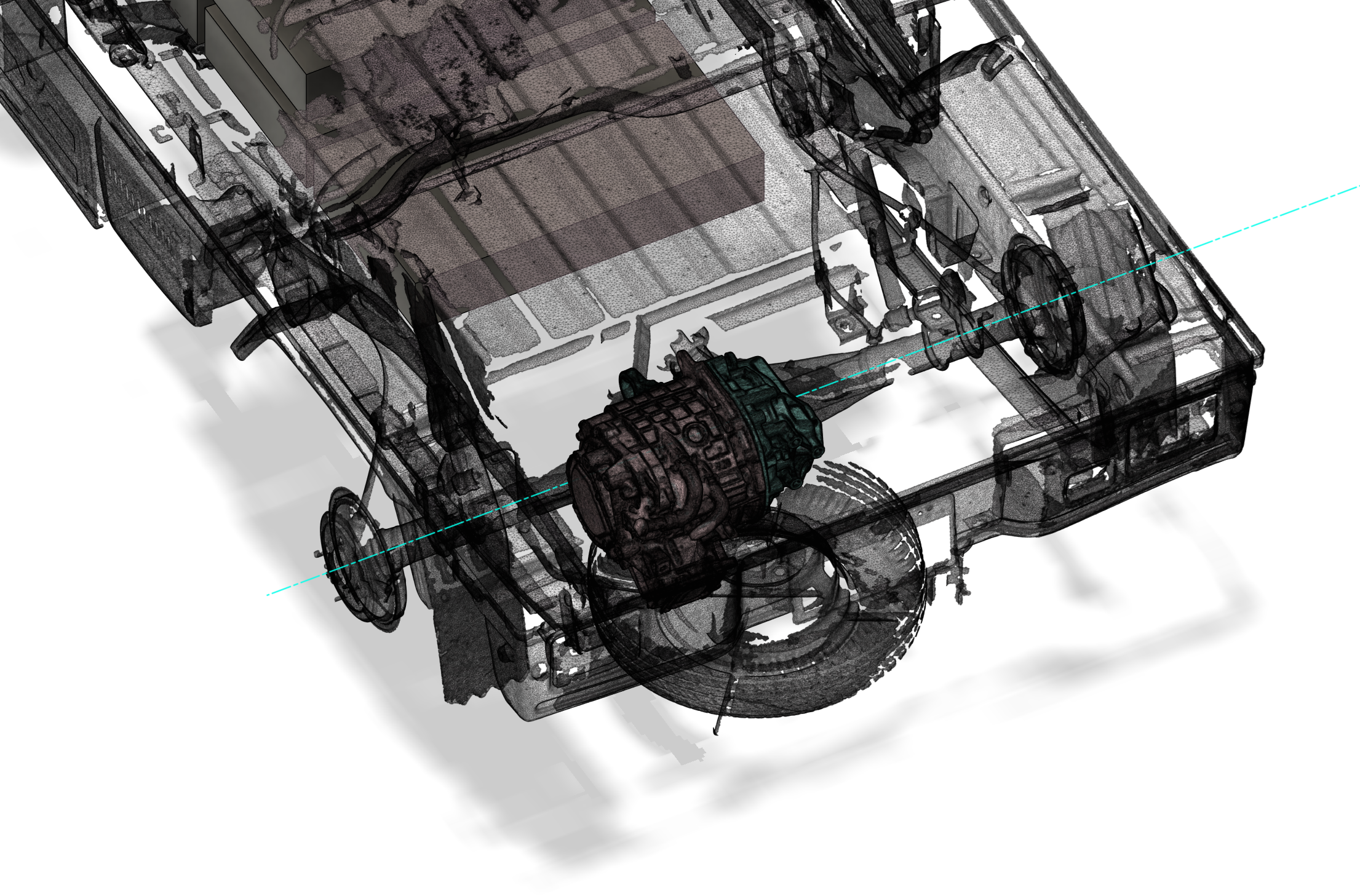

I know that converting RWD vehicles with solid axles can be a challenge, and this one is more so than usual.
I looked into chopping the solid axle and adding a second set of bearings to hold a custom stub shaft, but the CV axles would have been absurdly short.

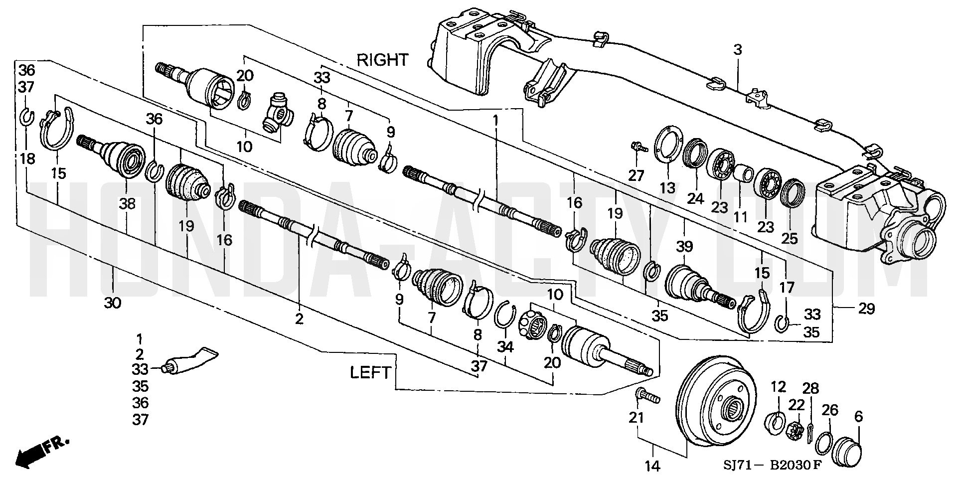

A custom De Dion axle would work, but few available off-the-shelf parts would be helpful. The stock wheels are 12" and take 180 mm drums with a 4 x 110 pattern, plus a 67 mm centring spigot. Some ATVs use 4 x 110, but their brakes are all too big or are motorcycle brakes. VW parts are common, but again the brake discs are enormous and the pattern is wrong.
Happily for me, the Honda Acty has a De Dion axle from factory:
The big compromise is that the Acty has a 4 x 100 pattern rather than 4 x 110, so I would have to use an adapter or have different wheels front and rear. All kei trucks of this vintage have pretty similar 12" steel wheels, so I think I can live with that to get me on the road. In a pinch there are actually dual-pattern wheels sold in Japan that I could use.
I still need to get measurements on the Acty axle (I assume the spring width is 'close enough', but I haven't been able to find out online), so this may end up not being a viable solution after all. If not, I do have measurements of the existing brake drum and splines and could make/hire a custom axle if I were really determined.

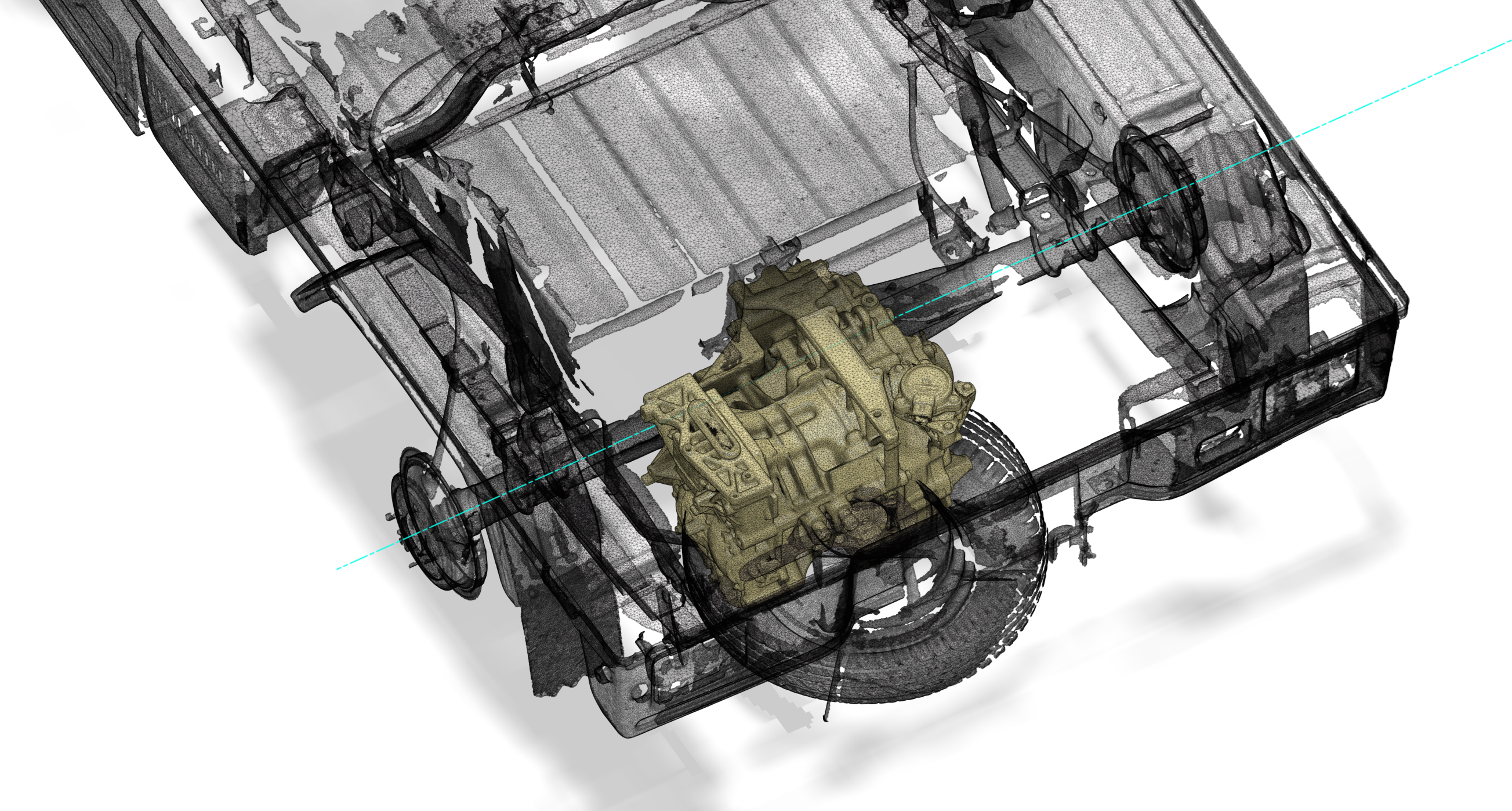

The Acty has the rear wheels a lot closer to the end of the bed than this truck, so I think I can flip the axle and put the drive unit behind the wheels where the spare tire and fuel tank used to be. A Leaf drive unit seems to fit nicely and leave space to the side where the charger and other electrical boxes can go (I haven't found a way to save the spare tire; please ignore it):

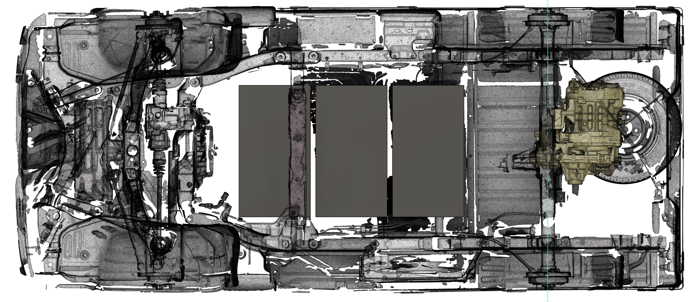

For context, here are 5 Mercedes EQS modules as a battery pack (I think daveturpin here is using them):

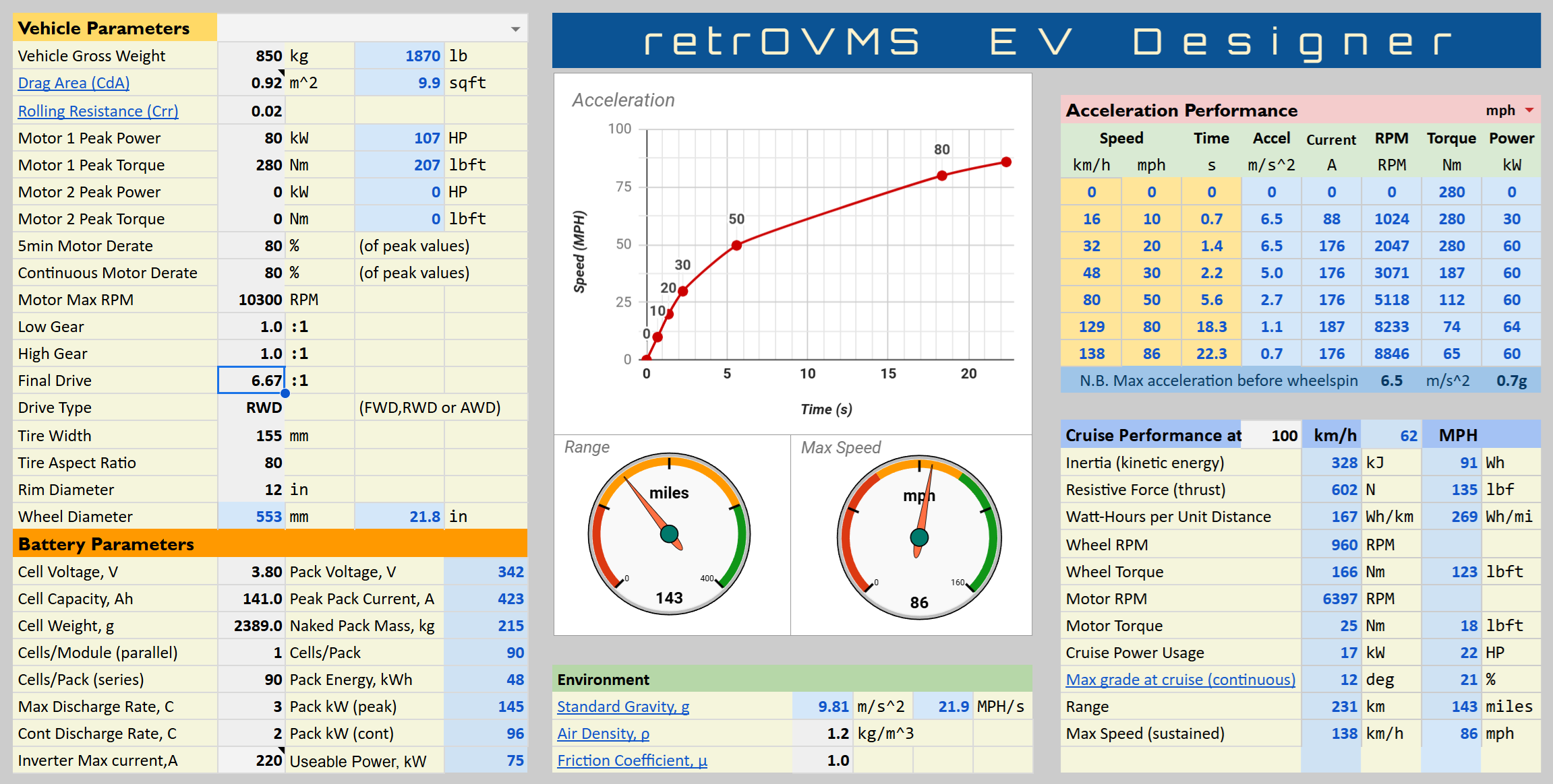

I've been using the 'EVDesigner' spreadsheet that was shared on here a while back (thank you to jetpax). Here is what it thinks of the Leaf motor with direct drive (ratio 8.193):
And with the stock rear end through a driveshaft:
If anything, the latter gets a higher top end speed for a tiny acceleration penalty. The challenge would be weight and packaging, as well as the custom driveshaft. This truck actually has selectable 4WD, so I will eventually need to have room for a front motor as well unless I want to reuse the stock transfer case somehow. All of that takes up my limited battery space.
I'm very open to other small drive unit alternatives. The Toyota MGR is still in the running for the future front 4WD motor. I looked into some of the other Toyota E-Four motors and the Nissan Sakura MM48 drive unit, but they all seemed to have issues with voltage, size, cooling, or in the case of the latter, an integrated inverter that isn't hacked.

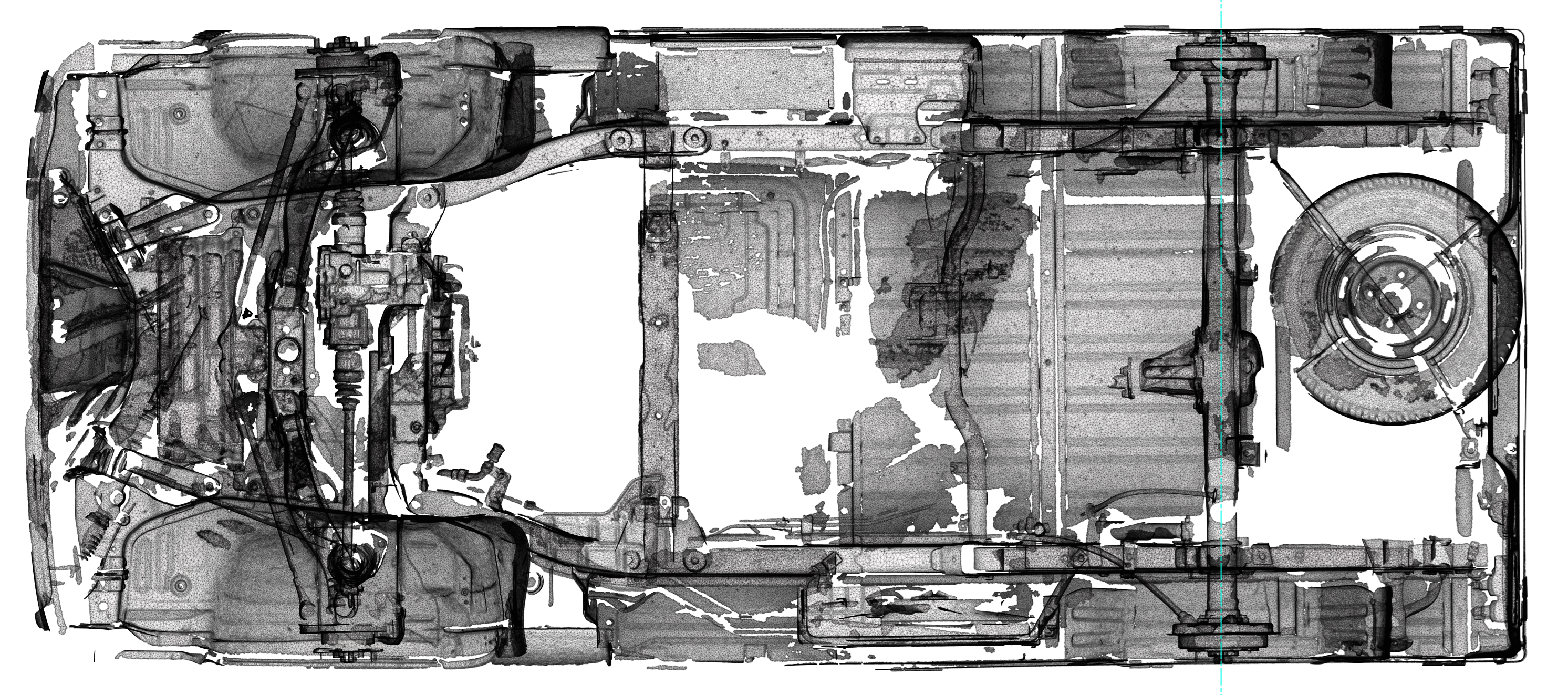

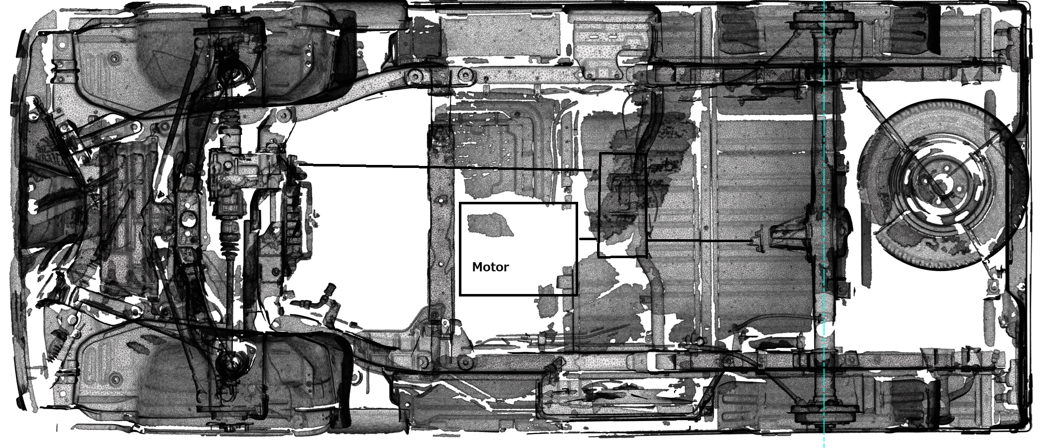

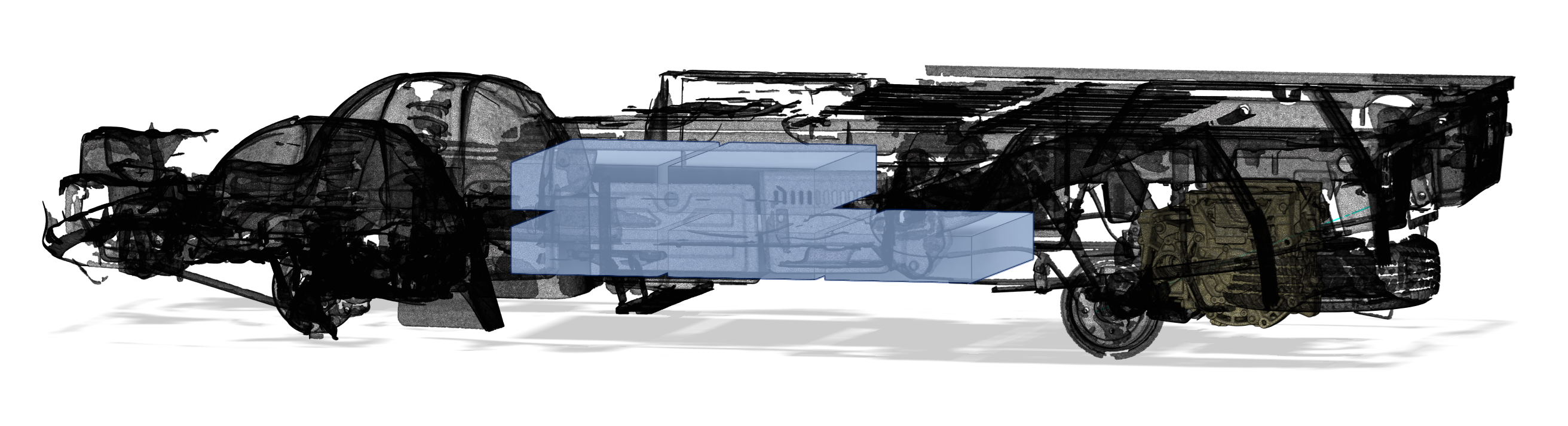

bexander wrote: Sat Jan 25, 2025 2:44 am The outlander rear motor is alot smaler than the leaf and would still provide more torque than stock motor/gearbox (59*2,8). Connect it directly to transfere case an retain hi/low gear. How much room for batteries would there be left then?
It should be technically possible, but it does look a little tight. The transfer is a 1:1 chain drive unit. Apologies for the poor diagram, but the underbody scan took 18 hours to process and I did it after deleting the ICE drivetrain from the point cloud!
