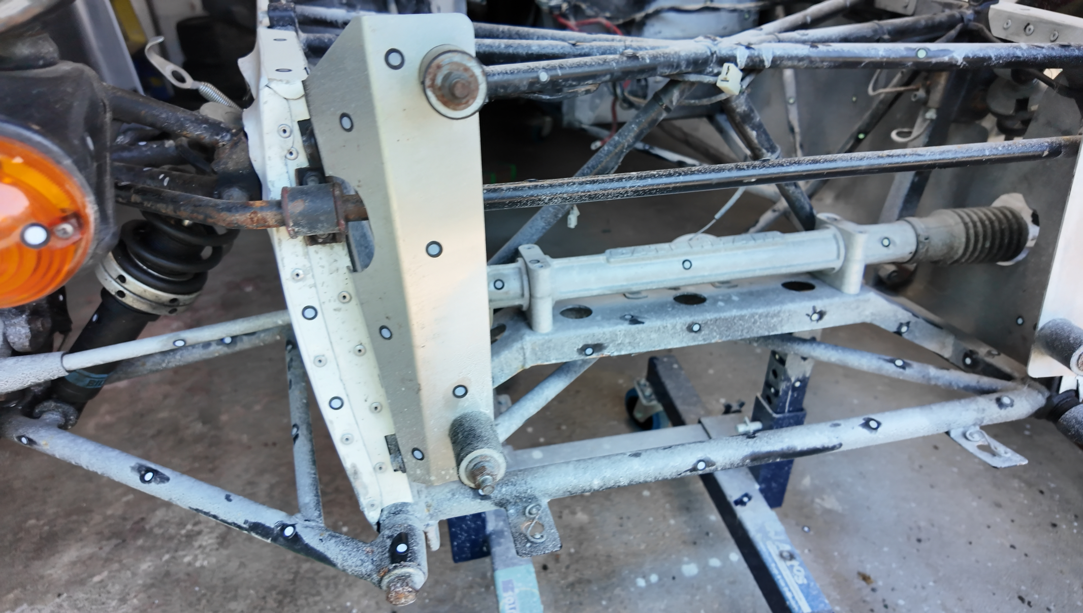

I’m converting a 2012 Caterham Seven to be an EV.
The project car was bought in 2022 as an unregistered ex-drift car - used for drift experiences and training people to drift. The car was in good mechanical shape but the bodywork had seen better days. This particular car was a 1.6L Ford Sigma based “SV” version of a Seven. The SV mean “Series Five” which is a 100mm wider than what most people would consider a standard, or S3 chassis’ed Seven. The extra width was a purchase requirement to give me more room for batteries.
I’m a semi-retired electronics and software engineer. Graduated in electronics and silicon design in 1989 and have run (by myself and with others) a succession of electronics and software product companies, some of which were listed on the London Stock Exchange (though that seems like a long time ago now!
So, the first task I had was to get the car road registered in the UK. The theory being that it would be easier to get DVLA re-registration from a road legal ICE car rather than going straight to an EV conversion first and then having to get a road registration essentially “as new” as an EV. We’ll have to see if that works out.
So the car was made road legal in early 2023 (after a bit of back and forth with DVLA, of course) at which point I stripped the engine and gearbox out and sold them. The car was then 3D scanned and I started to work out what would fit.
Since then I’ve been looking at conversion options. The “volume” available in a Seven is extremely restricted and I decided I probably couldn’t take a pre-owned second hand drive unit and fit it in my car.

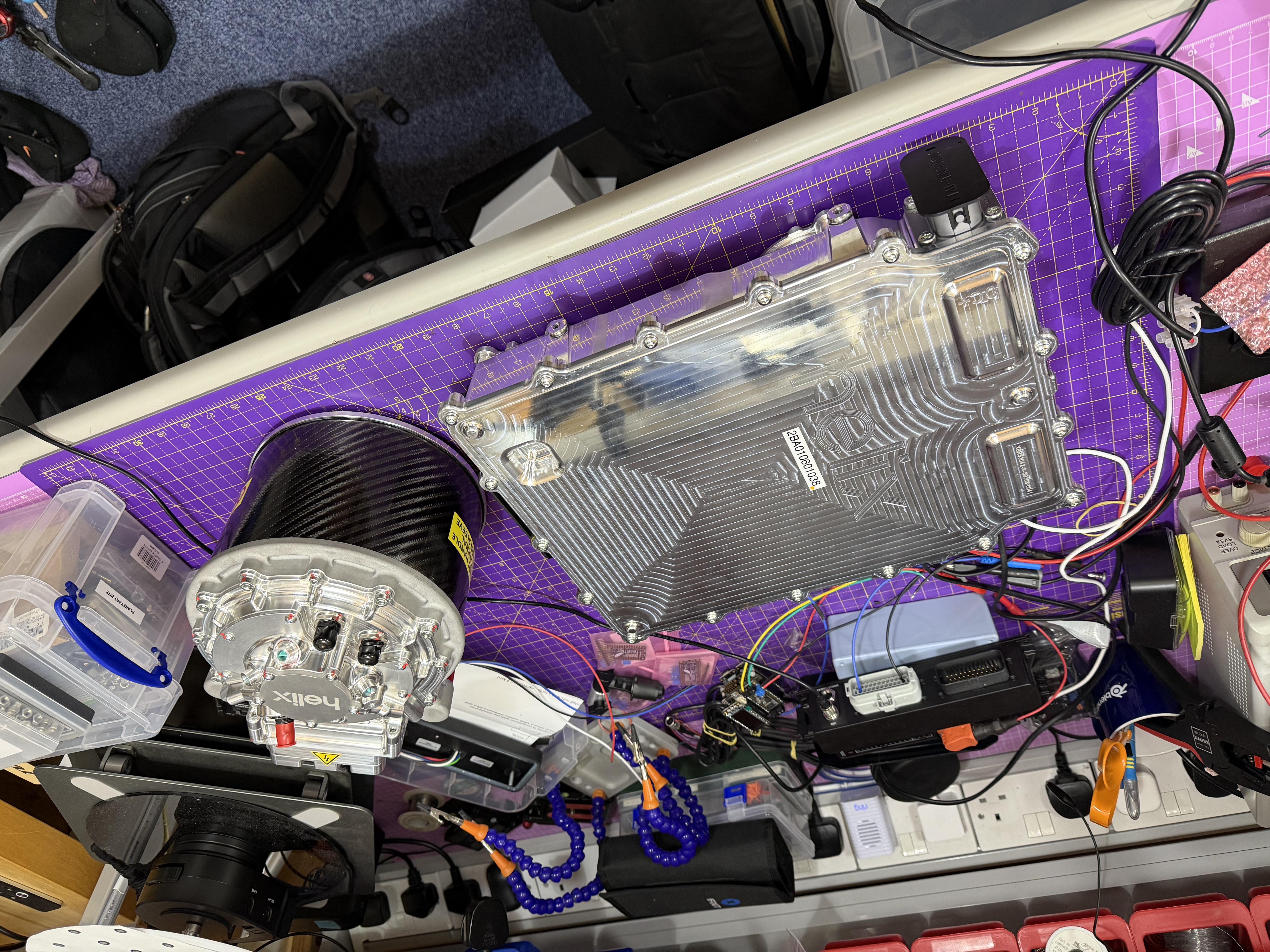

I’ve looked at a number of motor/inverter options and spent about a year working with a local motor supplier. But in the end it didn’t work out with them. They wanted too much money to integrate a motor and inverter together and so I started looking elsewhere about a year ago.
Since then I’ve landed on Helix as a motor/inverter provider and I hope to take delivery of both in a few weeks.

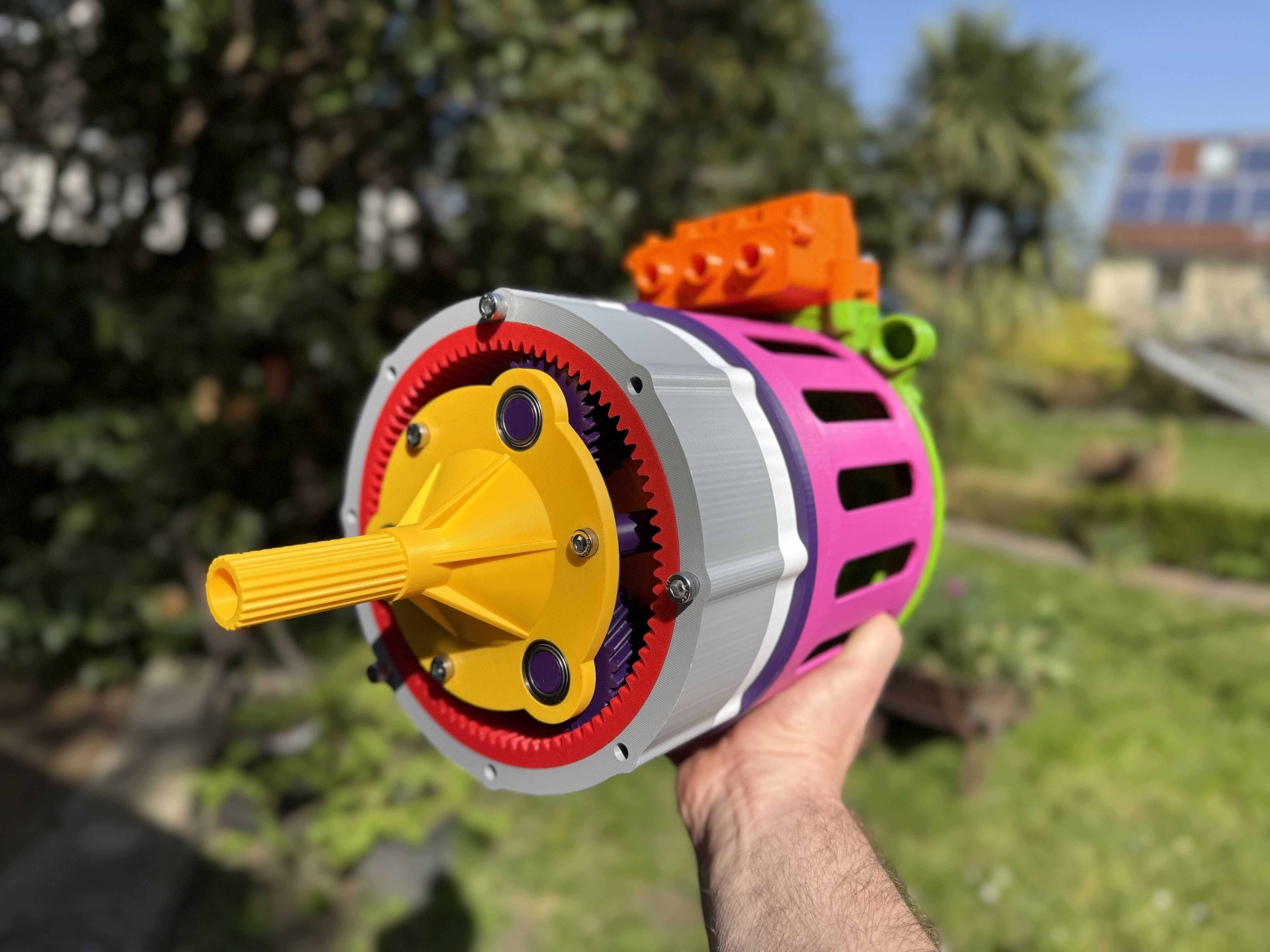

The other key part of my project is the sports car bit. I want it to eventually have the same sort of performance as a Caterham (my other Caterham is a 420 version - 210bhp and 200Nm, 0-62mph in about 3.8s, that I built in 2017). So I need about 150kW of motor and enough battery to feed it. That has led me to an architecture that’s probably a bit different (though probably not so much on these forums
The Helix motor is very compact, at 200mm diameter, and will fit in the transmission tunnel where the gearbox would normally fit. This also gives me more battery space in the front of the vehicle. I’ll also have a couple of modules in the rear where the fuel tank used to sit.
