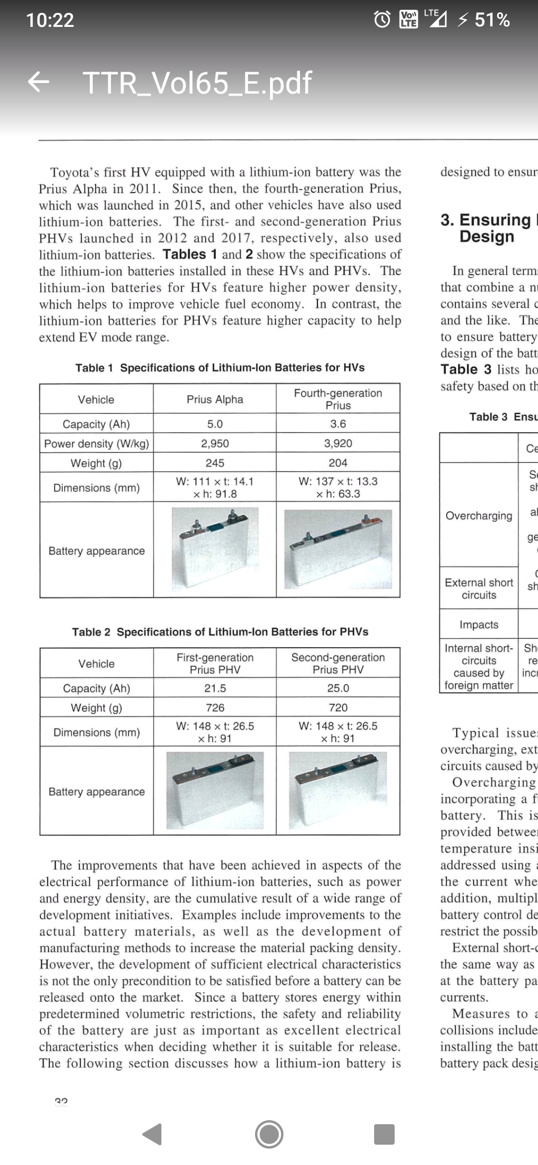

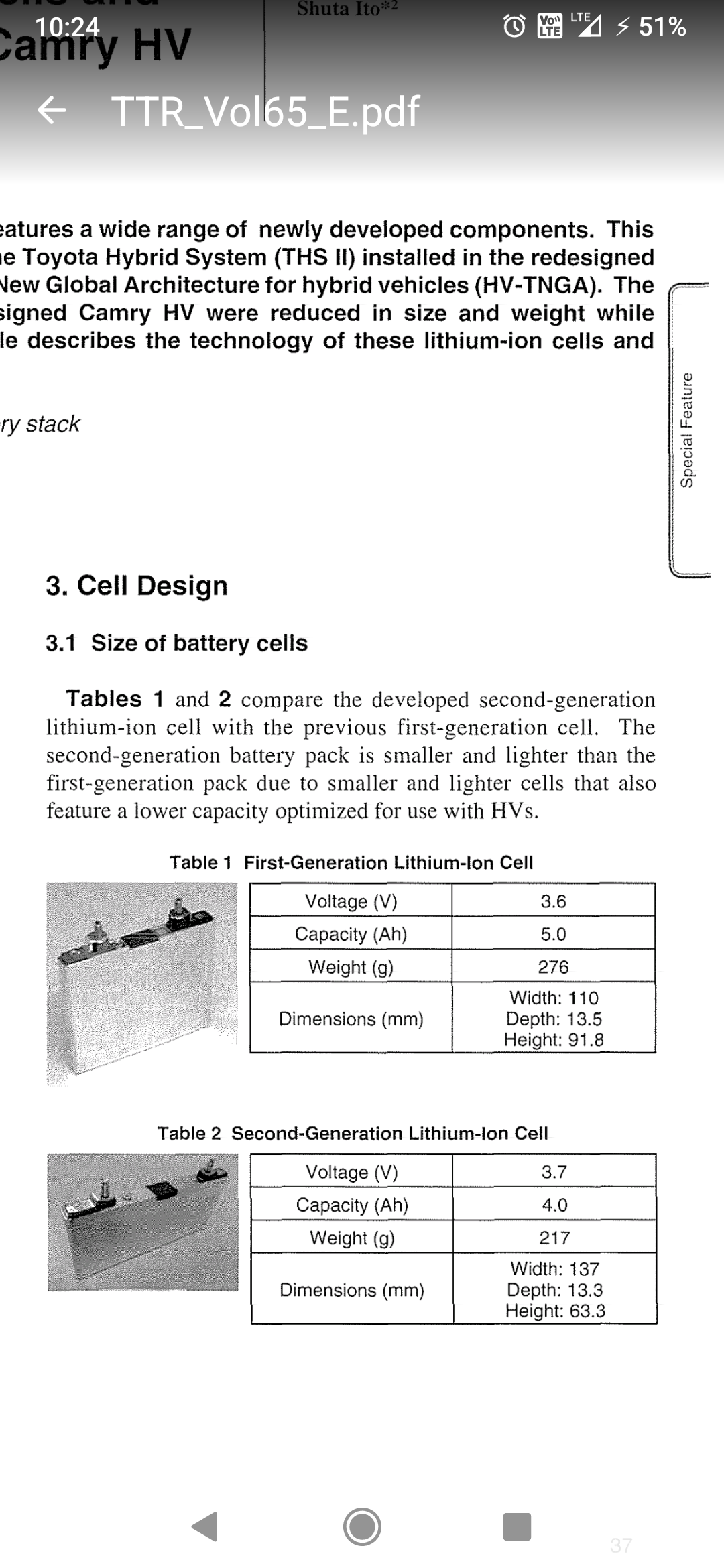

Re: Data on Toyota lithium batteries
I have found Toyota technical review vol. 65. Great read about many new technologies they are working on.
It looks like they have two cells of the same dimensions but different ah rating and weight. 3,6/4ah and 204/217g. First one for the Prius and second one for Camry.

As I was searching for the exact dimensions of the cells used in a Toyota Prius plug in of 2012, I came along this tread.
Apperantly some call it the "PHEV2 standard", but that might just be made up by a Chinese battery producer.
The measurements of 148 x 26,5 x 91 as mentioned in the Totyota Technical Review 65 differ a bit from the 148 x 27 x 105 as mentioned in Toyota's dismanteling guide.
http://brulsturm.nl:7777/open/cell_dimension.png
Has anybody here actually worked with those cells and knows the exacxt dimensions and is the position of the terminals is also standardized?
The goal is (of course) to replace the cells and increase the capacity and the EV-range aswell as better "hybrid-behaviour" by lower internal resistance.
