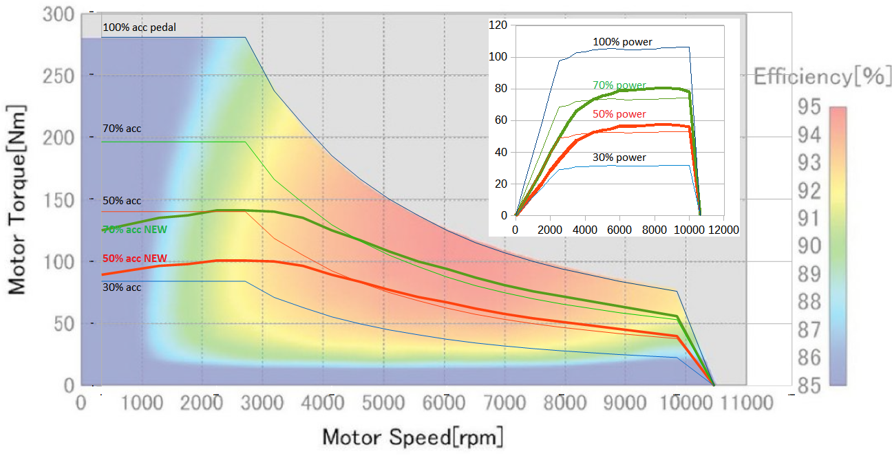

Can someone tell me how efficient regen is on leaf 2 engine and inverter ?
Ex if i spin the leaf with a known power let's say 40 kw and how many kw will i get back in regen?

40Kw will certainly push your 1t car to 100km/h and then some. At that speed you can get 30kW back downhill easily... however not for long. At that power you will drain speed too fast and power will drop as well. It all depends on how you can sustain your speed under regen.
I think you can get maybe 30% return in city stopngo and maybe 25% in the hills outside the city. Just dont forget you need power to climb the hill as well.

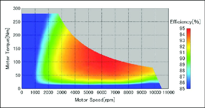

I want too use one leaf engine to build a dc generator and that seems too have been done but what i dont find is how efficient leaf engine is when regen! In normal motor operation at 2000rpm th seams to be around 94%

I don't know of any difference between negative and positive torque. So if you found it to be 94% efficient driving in that operating point it will also be 94% efficient regenning

You still didnt said what voltage you intend to run the motor at. It depends a lot. 2000rpm input will require some kind of pulley system to increase motor RPM for better efficiency. I think at 2000 motor rpm you would get at best 90% with less torque. At 4000 motor rpm you would get 95% and 200Nm torque available. You can calculate power input mechanicaly...
I would imagine regen quadrant would behave the same...

I have to live whit then 90% efficiency then, i want direkt drive pulley system is never a good idea you nead extra shafts extra berings and i think that will decrease the efficiency more then 5 % and give more maintenance and initial work!
