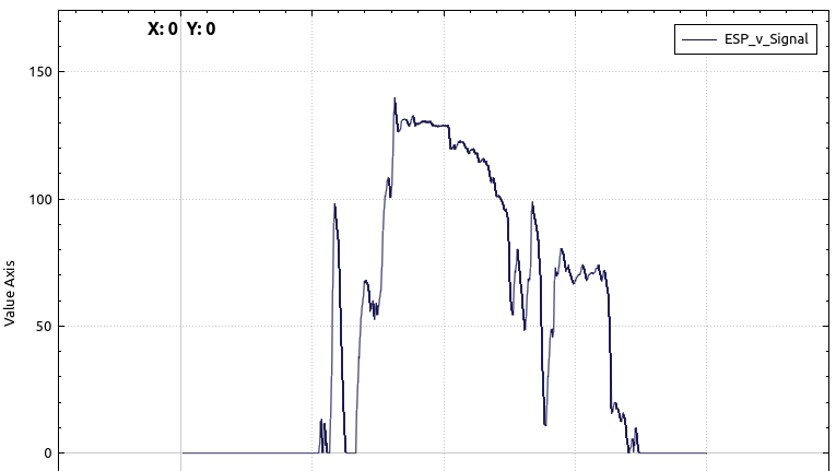

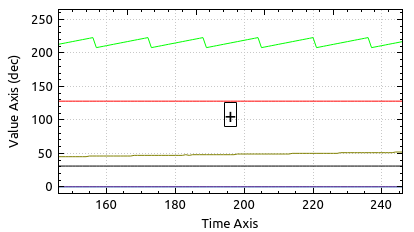

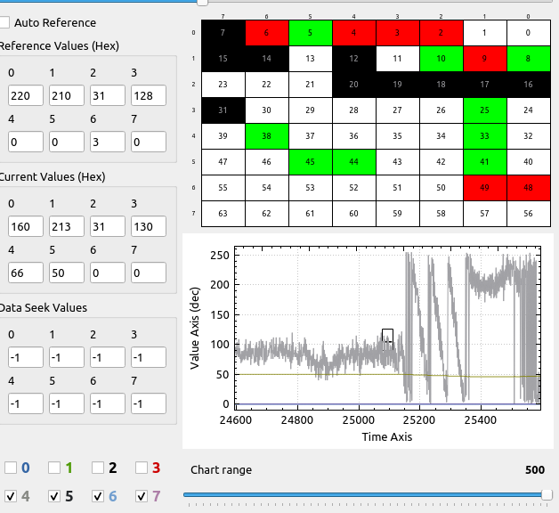

So I've had a little more time to mess with this.
I'm flying by the seat of my pants as I go here so may be making hard work of what you all would find pretty easy but playing the filtered CAN log back at the rack for 0FD EPS_21 I get assist and speed values showing on ODIS.
I played a log whilst taking a bunch of photos and then laid it out in a graph, removing outlier values of assist (likelihood due to extra torque from steering) and the averageing the results I've got an idea of the levels of assist at different speeds... Following on from this, looking at EPS_21 I can see byte 2 starts at 211 and counts up to 223, so I guess that's a counter then that can be seen in green on this flow graph and the DBC ..
The ESP V Signal is noted in "KiloMeterPerHour" so thats likely my speed, starts at byte 5 (bit 32) and is 16 bits long if I am interpreting the DBC correctly...
But I'm uncertain how the data is then cofigured to the speed shown below.. from the raw data flow graph...

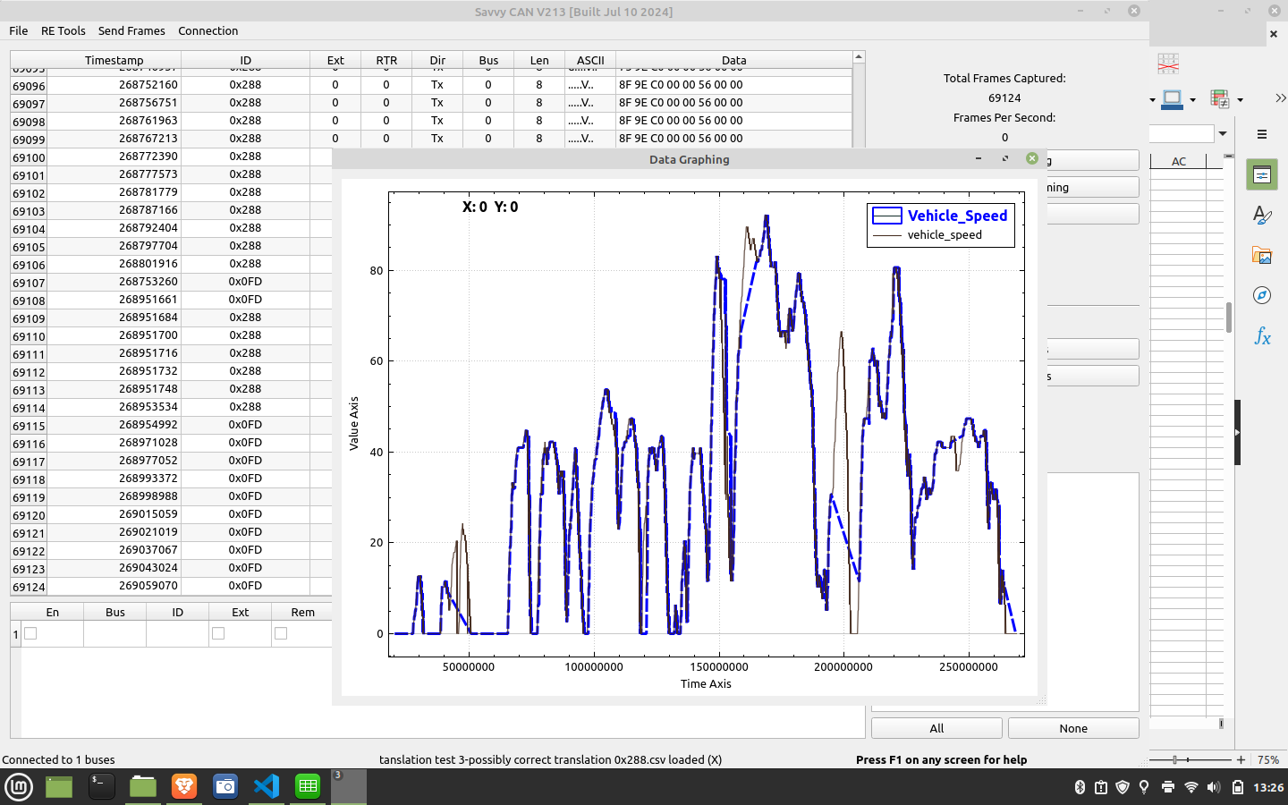

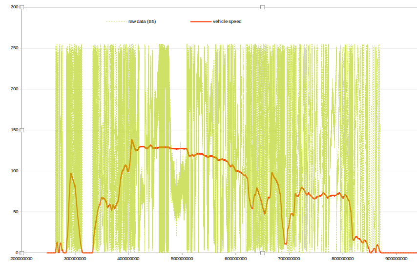

OK, so the vehicle speed is made up from byte 5 and byte 6 and is calculated by (b5 + b6*253)*0.01.

ok, after a lot of faffing I've managed to get the code to generate the CRC correctly.
I dont have access to my van or Can logs of my van moving at the moment but this translator appears to work to translate VW speed signals transmitted on 0x288 to MQB ESP 21 0x0FD and correctly calculate the checksum. It should run on an ESP32 with a second can interface added. I'll verify tomorrow. If there are any sense checks and/or safety checks I should implement also I'd be interested to know.

if (id == 0x288) {
// Extract engine speed from D4 (byte index 3)
uint8_t src_byte3 = data[3];
float speed_kph = (float)src_byte3 * 1.28f;
uint16_t speed_eps = (uint16_t)roundf(speed_kph * 100.0f);

fprintf(out, "%.6f,000000FD,false,Tx,0,8,"
"%02X,%02X,%02X,%02X,%02X,%02X,%02X,%02X\n",
timestamp,
frame[0], frame[1], frame[2], frame[3],
frame[4], frame[5], frame[6], frame[7]);
// Increment counter (0-15 wraparound)
(*counter)++;
if (*counter > 0x0F) *counter = 0x00;
