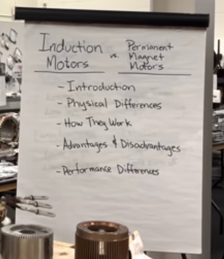

Outline

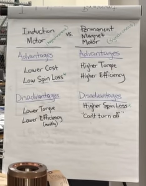

Advantages & Disadvantages
Induction Motors (have no natural magnets, rely on electricity to create a temporary magnetic field)
AdvantagesDisadvantages
  • Lower Cost
  • Lower Torque
  • Low Spin Loss
  • Lower Efficiency
Permanent Magnet Motors
  • Higher Torque
  • Higher Spin Loss
  • Higher Efficiency
  • "Can't Turn Off"

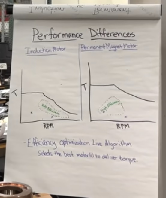

Performance Differences
