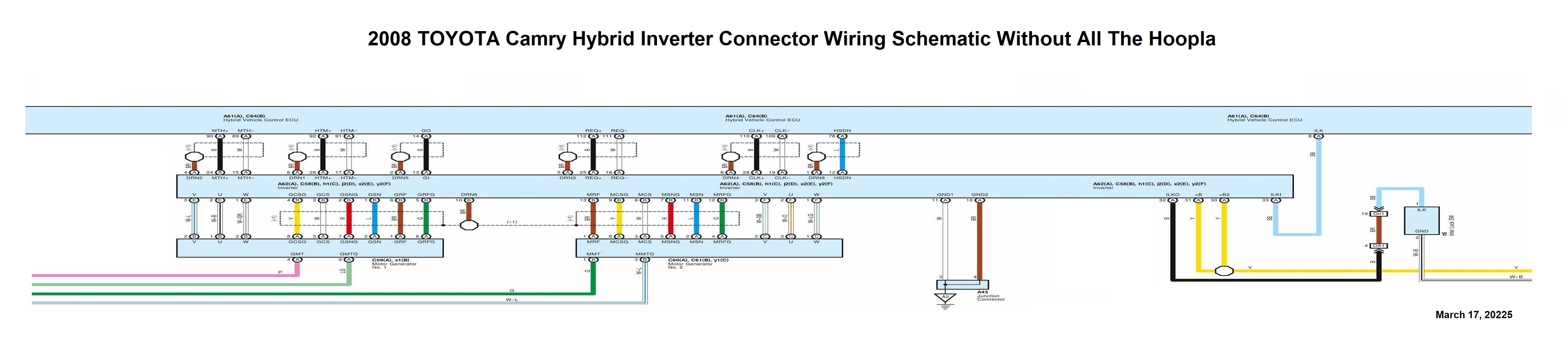

WIRING SCHEMATIC (Source: AllData.com paid subscription but happy to share the info)
2008 TOYOTA Camry Hybrid Inverter Connector Wiring Schematic Without All The Hoopla

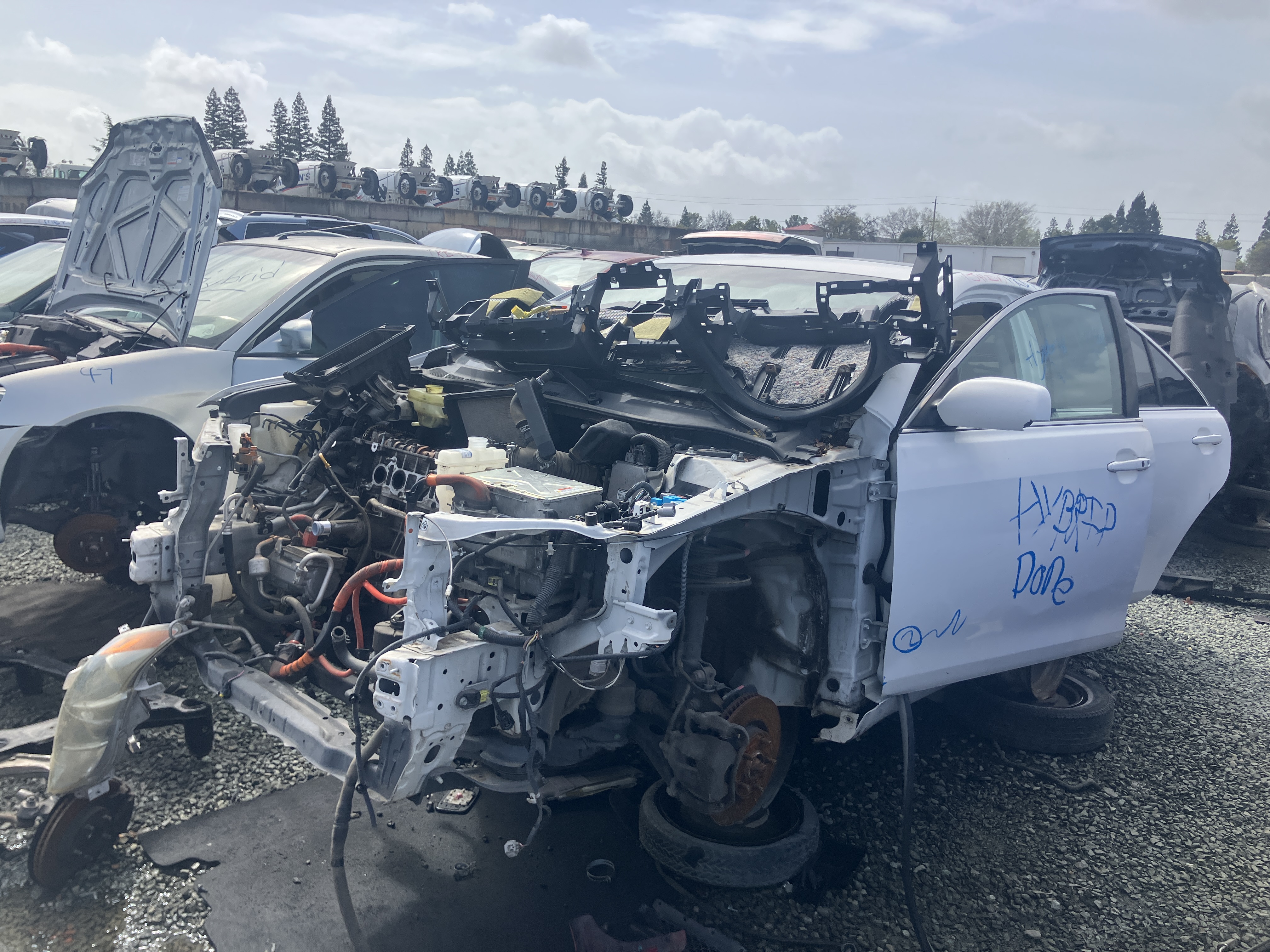

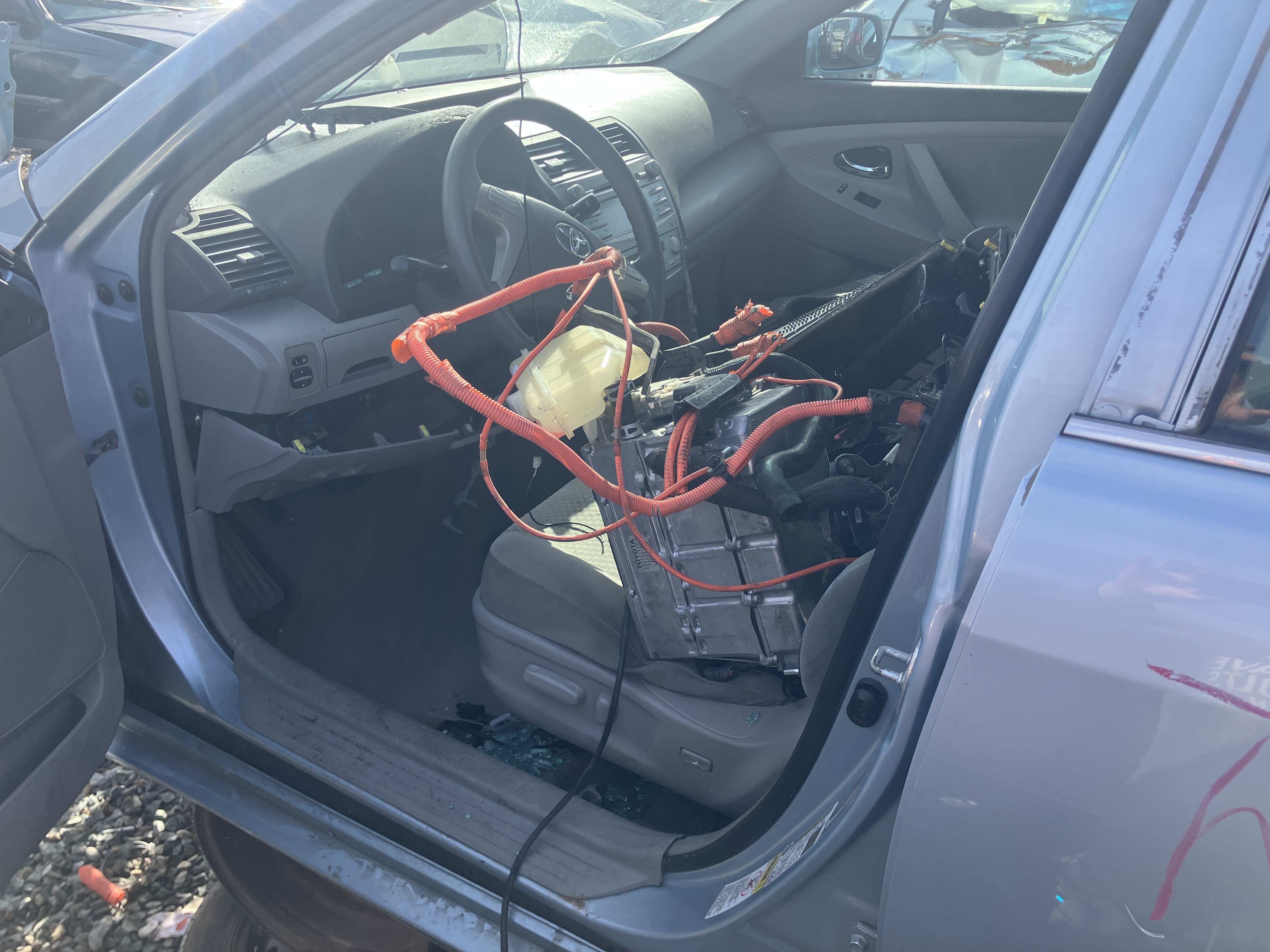

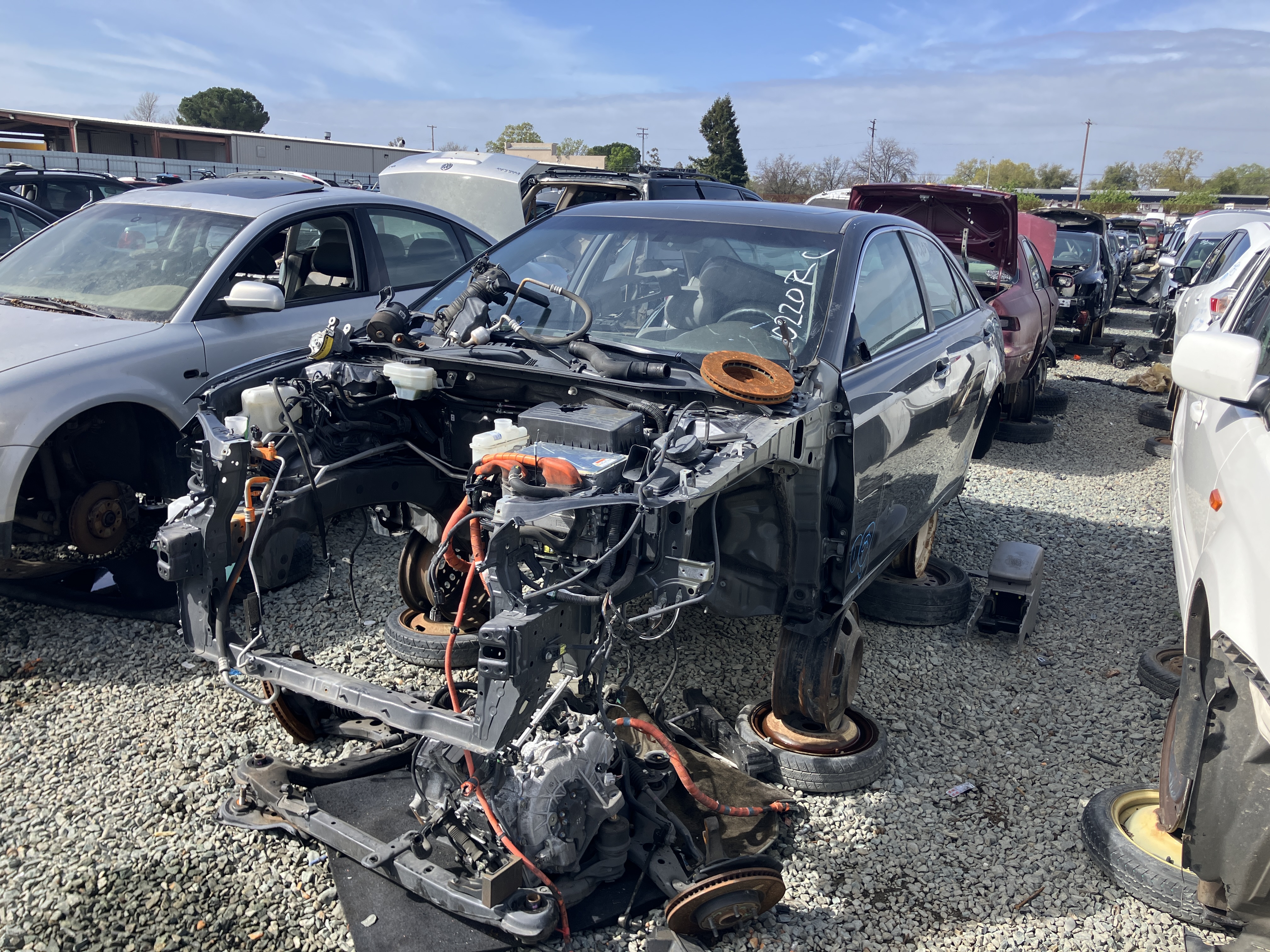

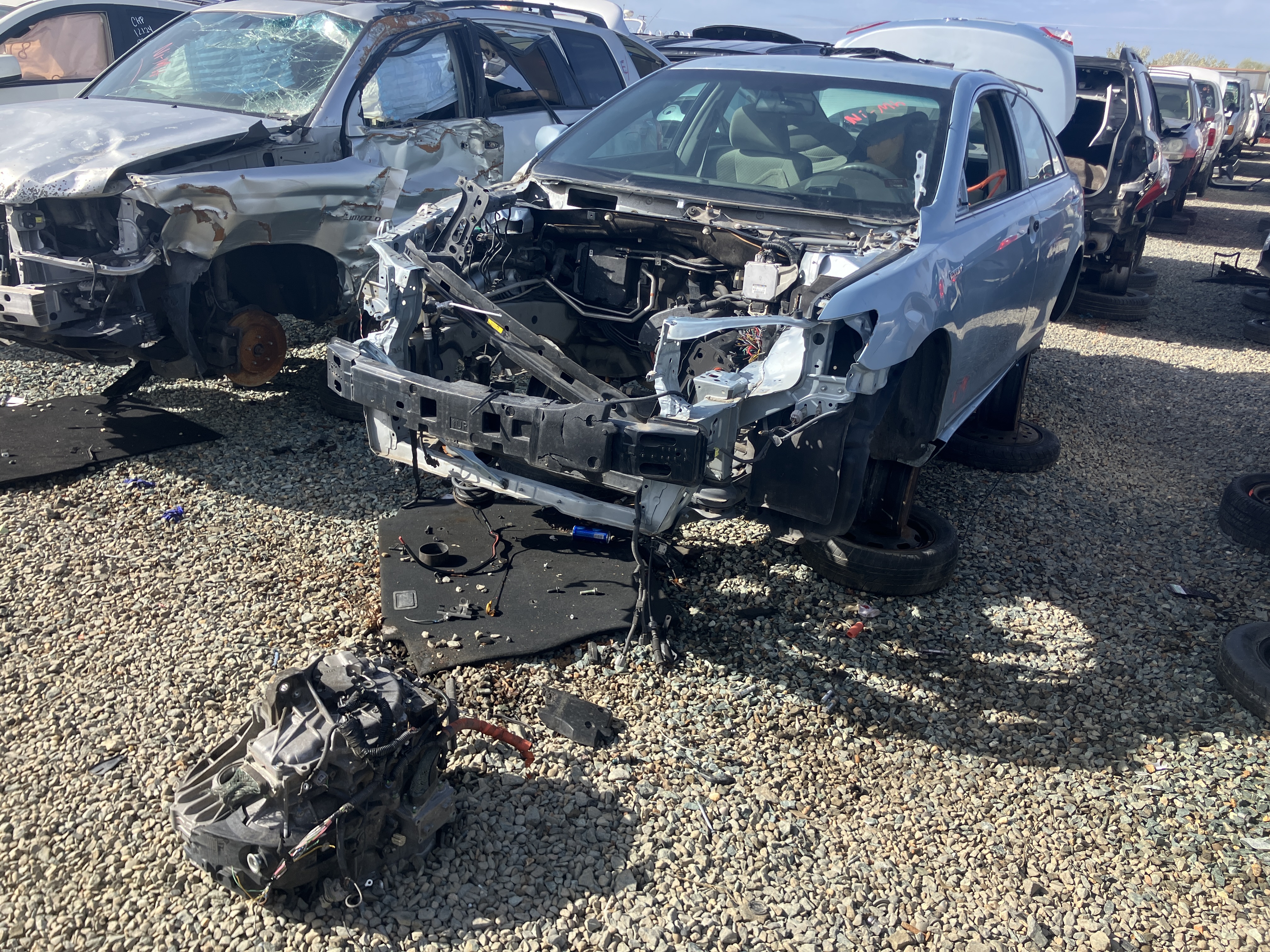

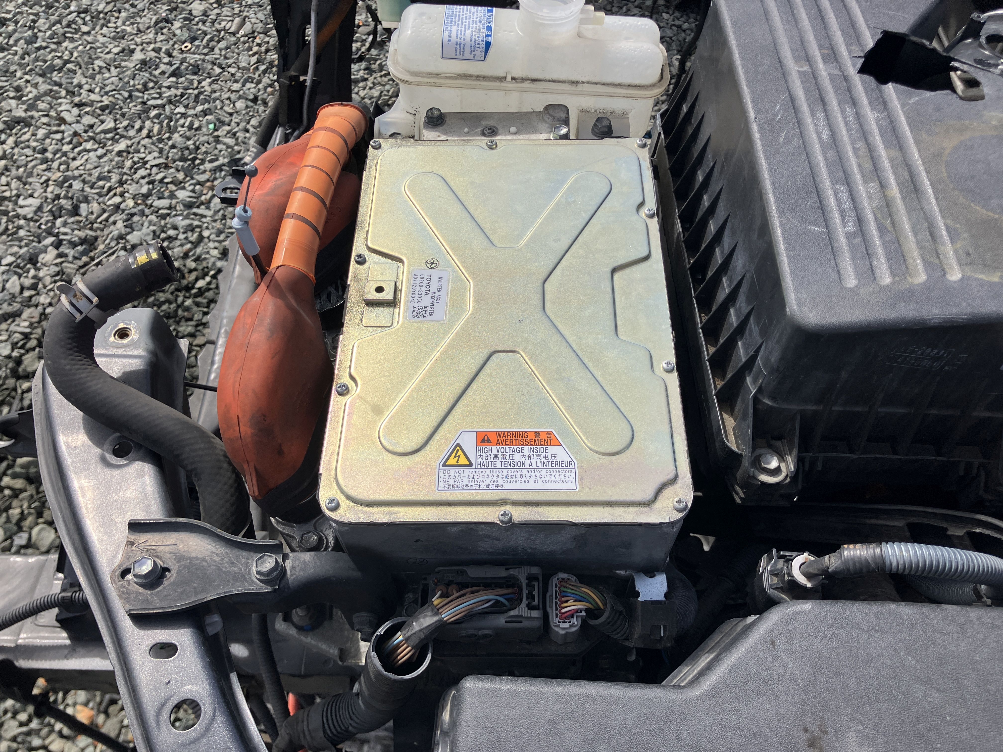

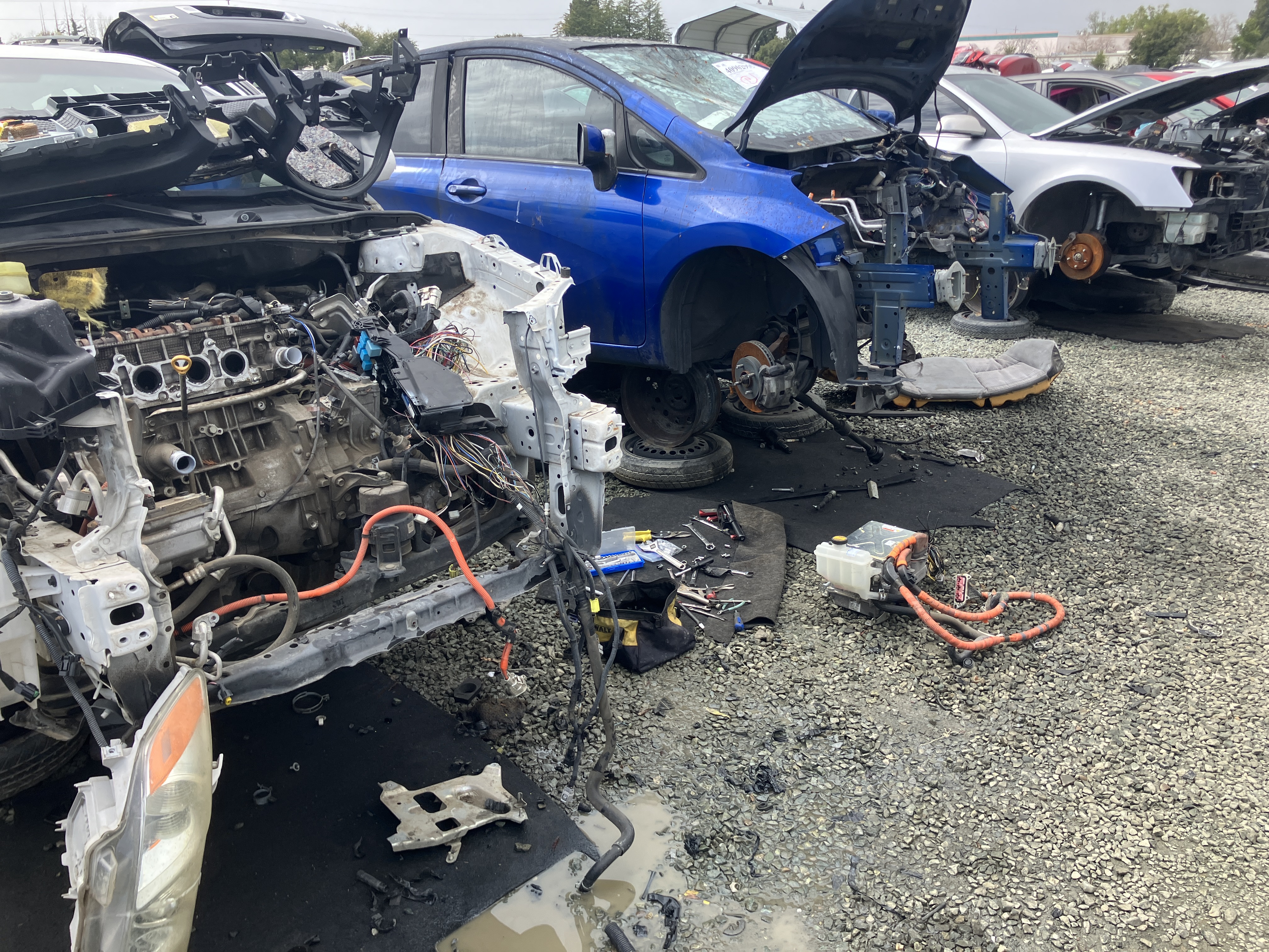

PICK-n-PULL
here's how they look in the wild

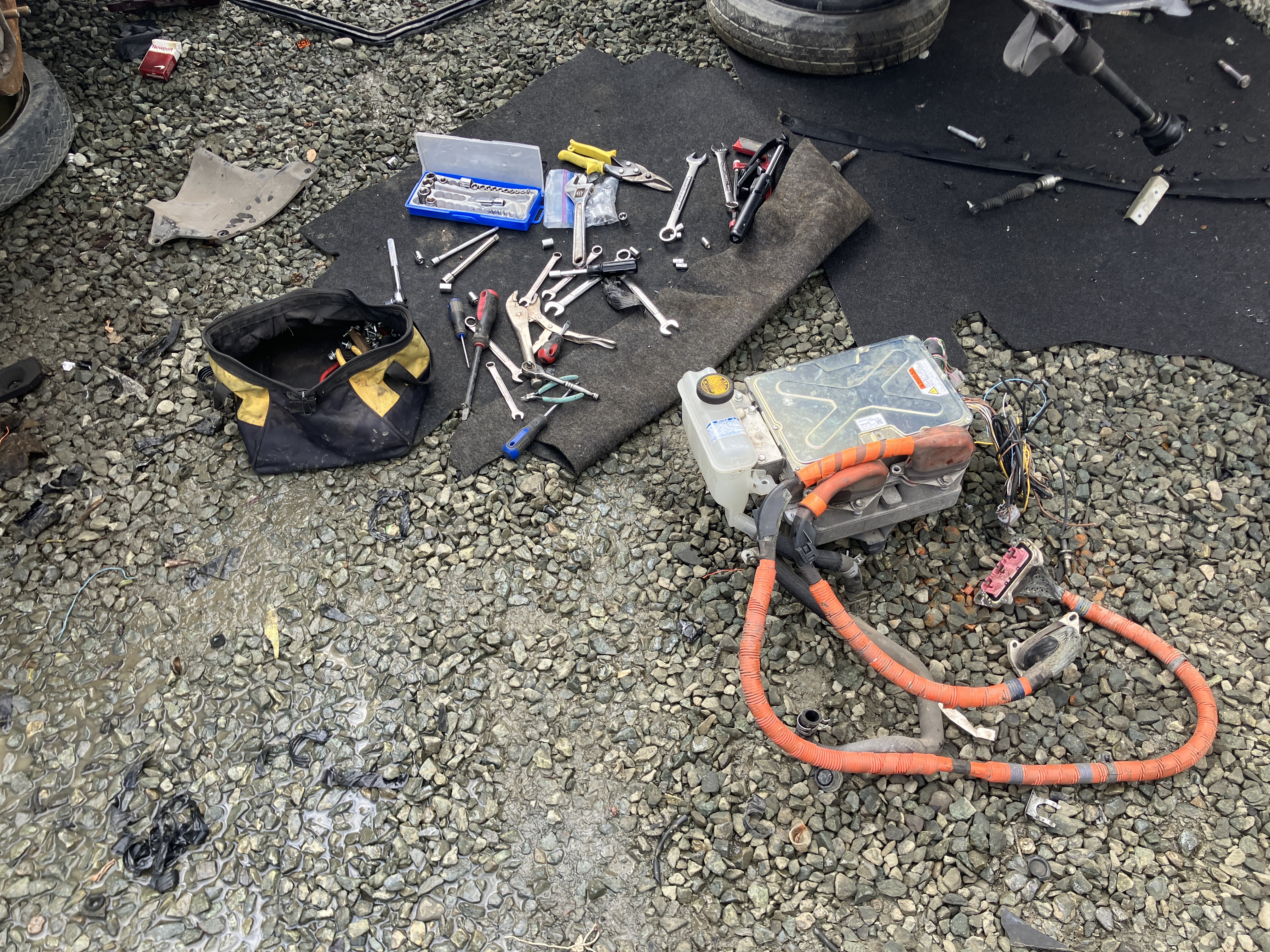

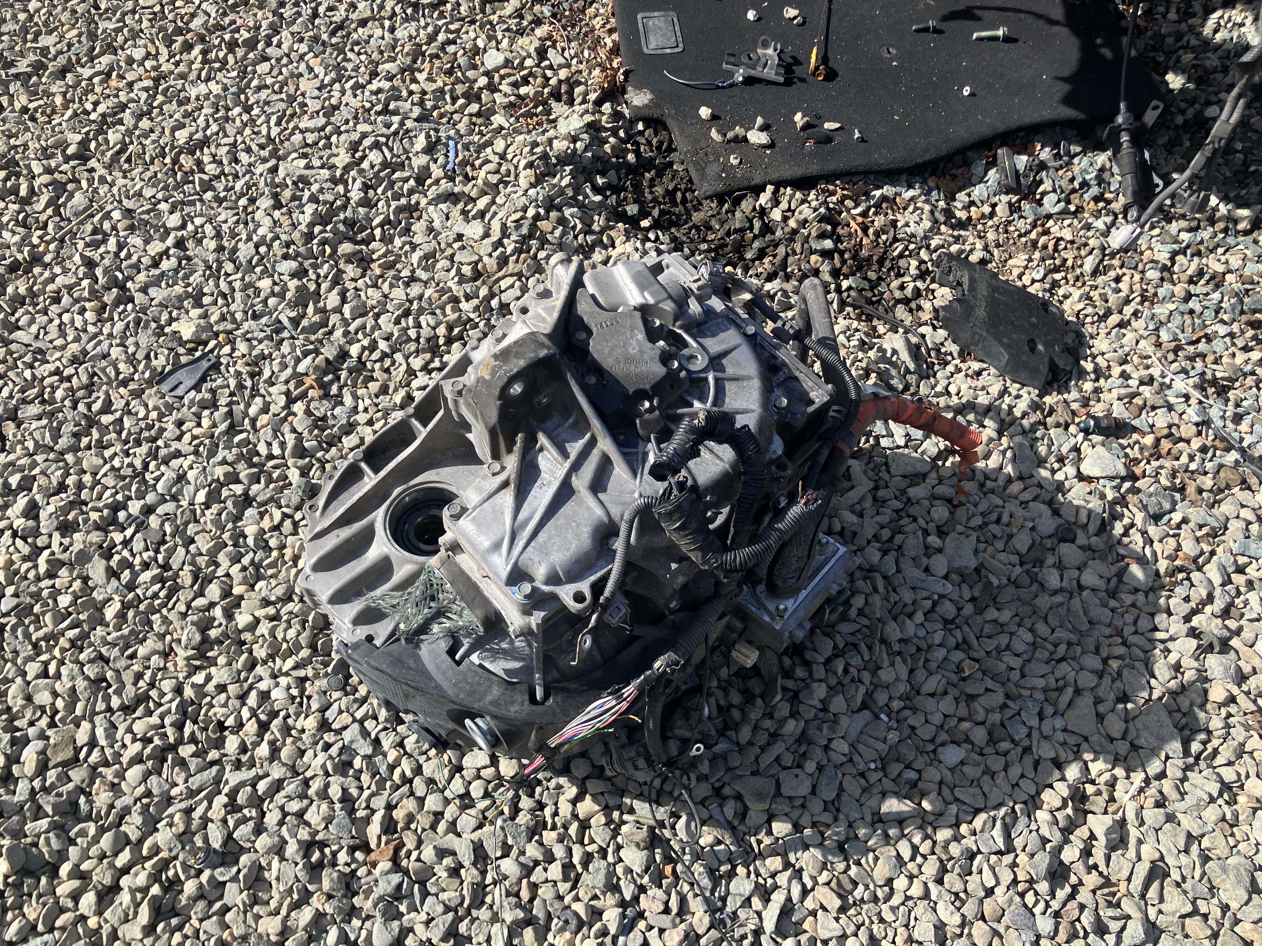

Re: I just bought a 6th Gen Toyota Camry Hybrid Inverter - Now What
Post by Gregski »
some time later.jpg (9.72 KiB) Viewed 7375 times

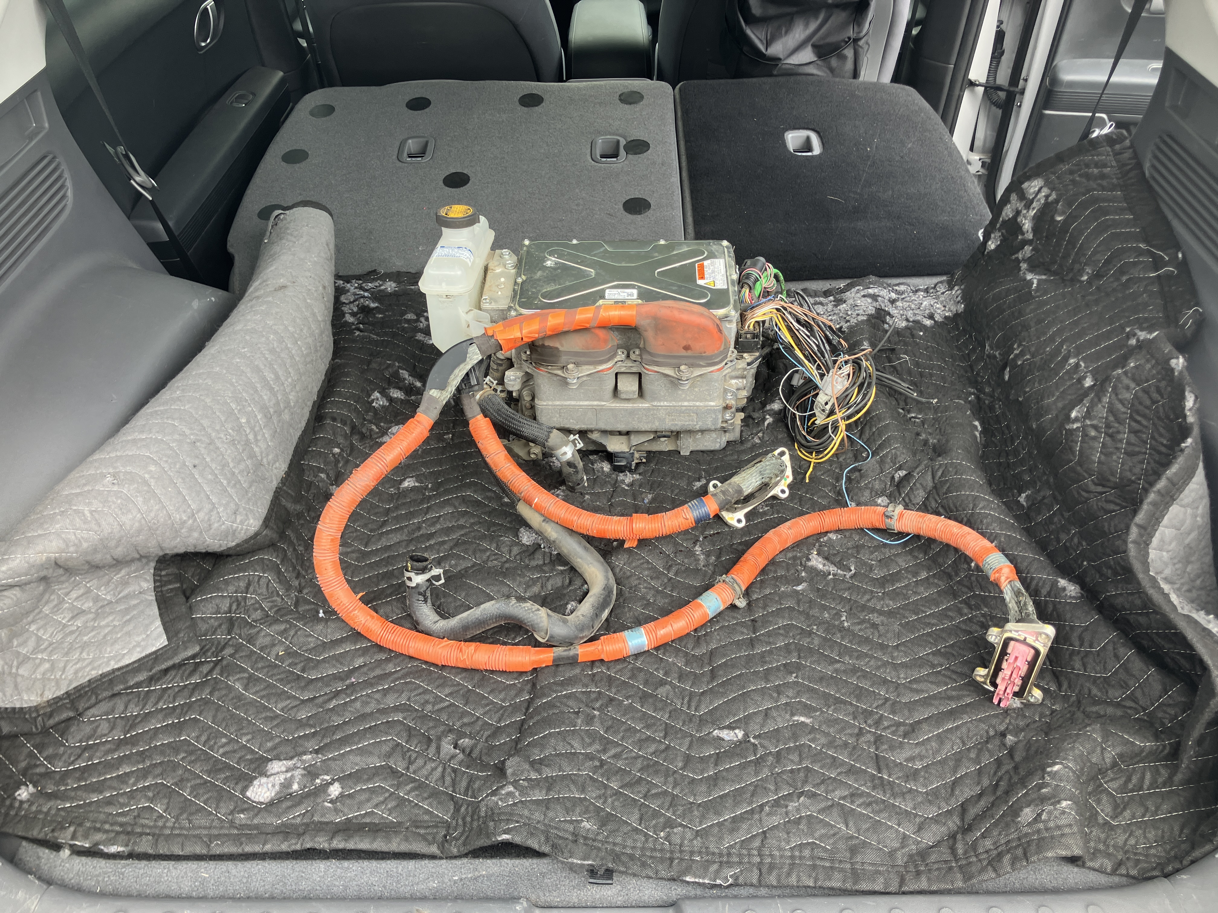

two hours and $85 dollars later...

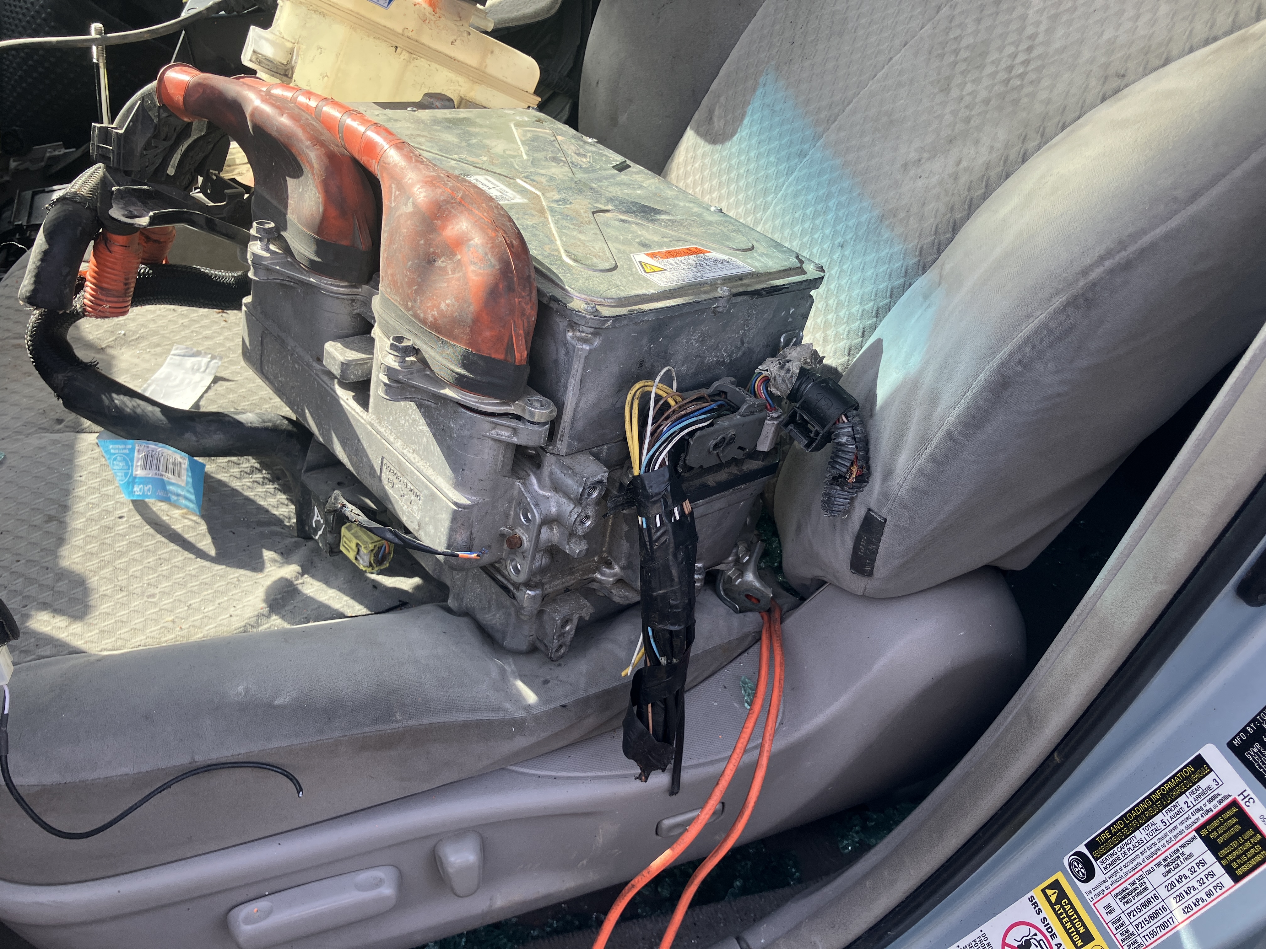

Gregski
Posts: 3164
Has thanked: 633 times
Been thanked: 1610 times

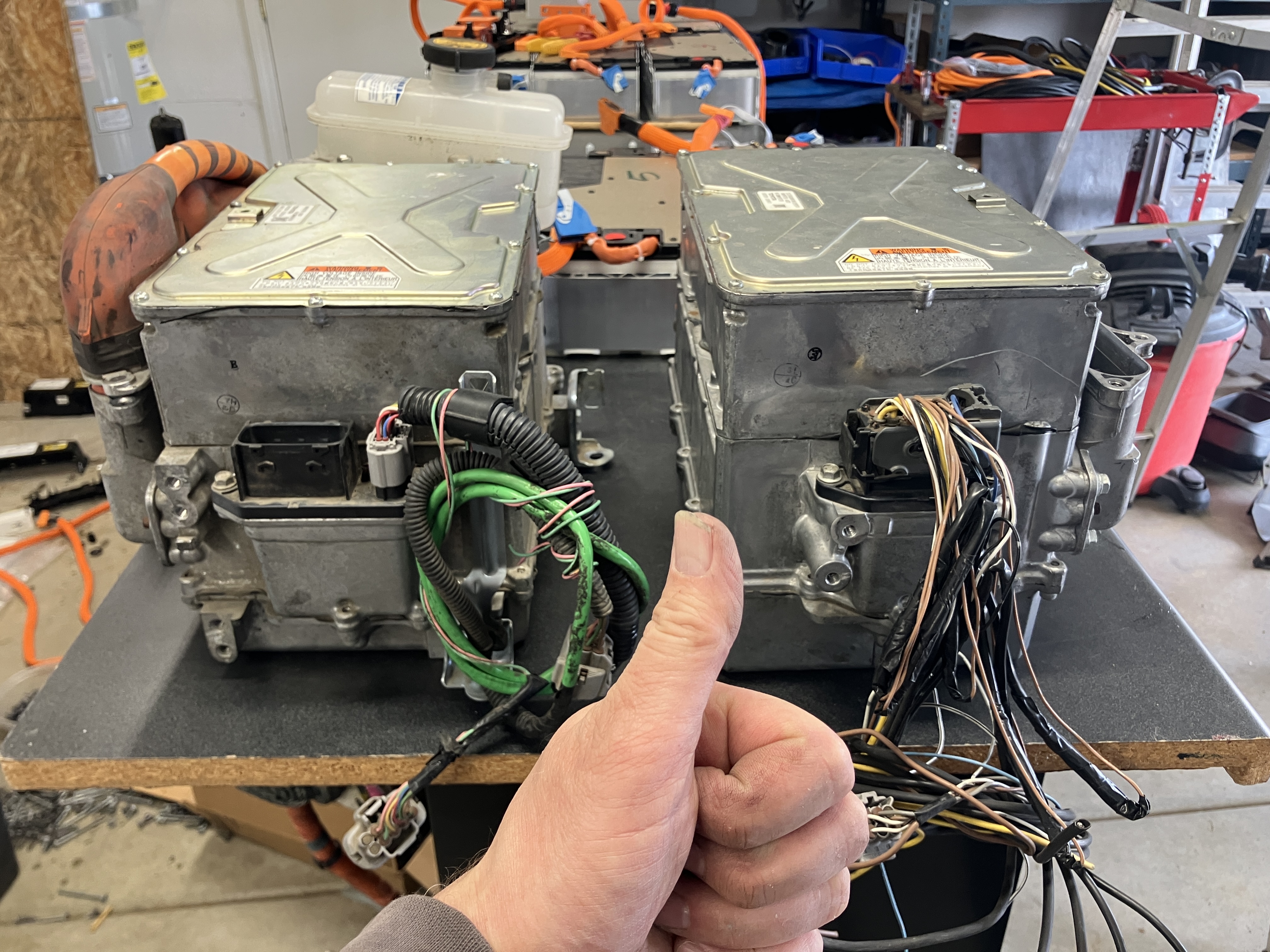

Post by Gregski »

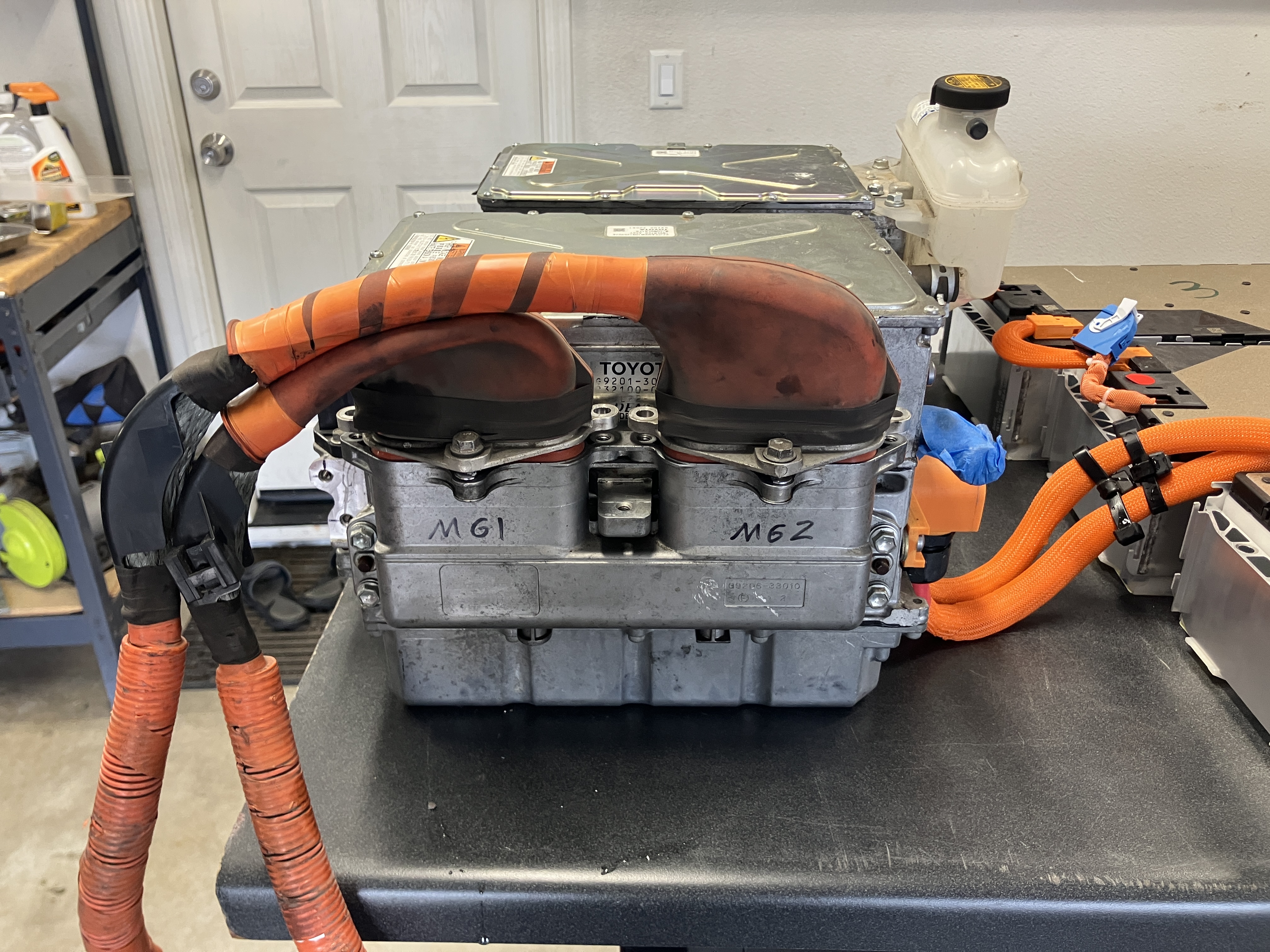

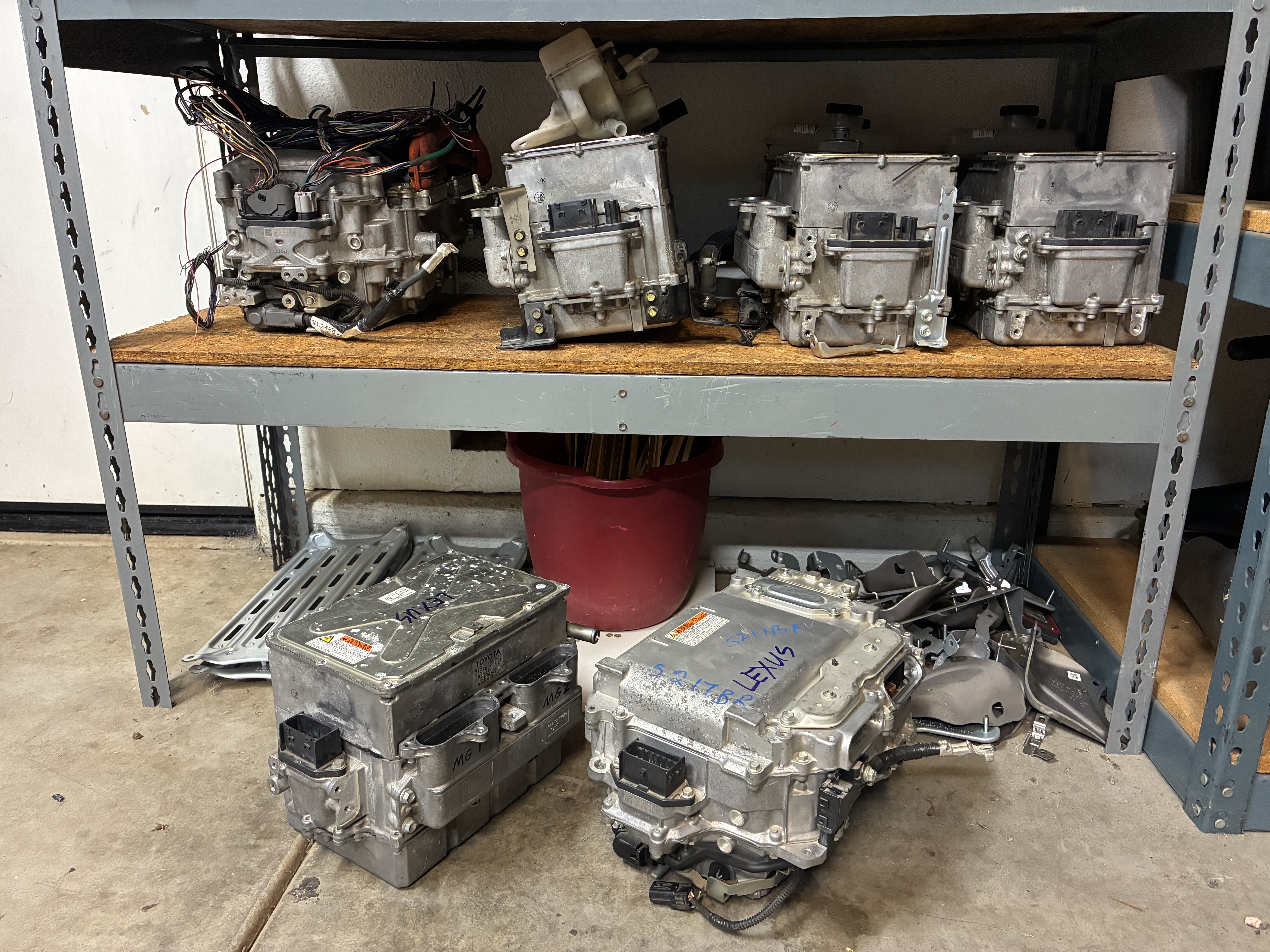

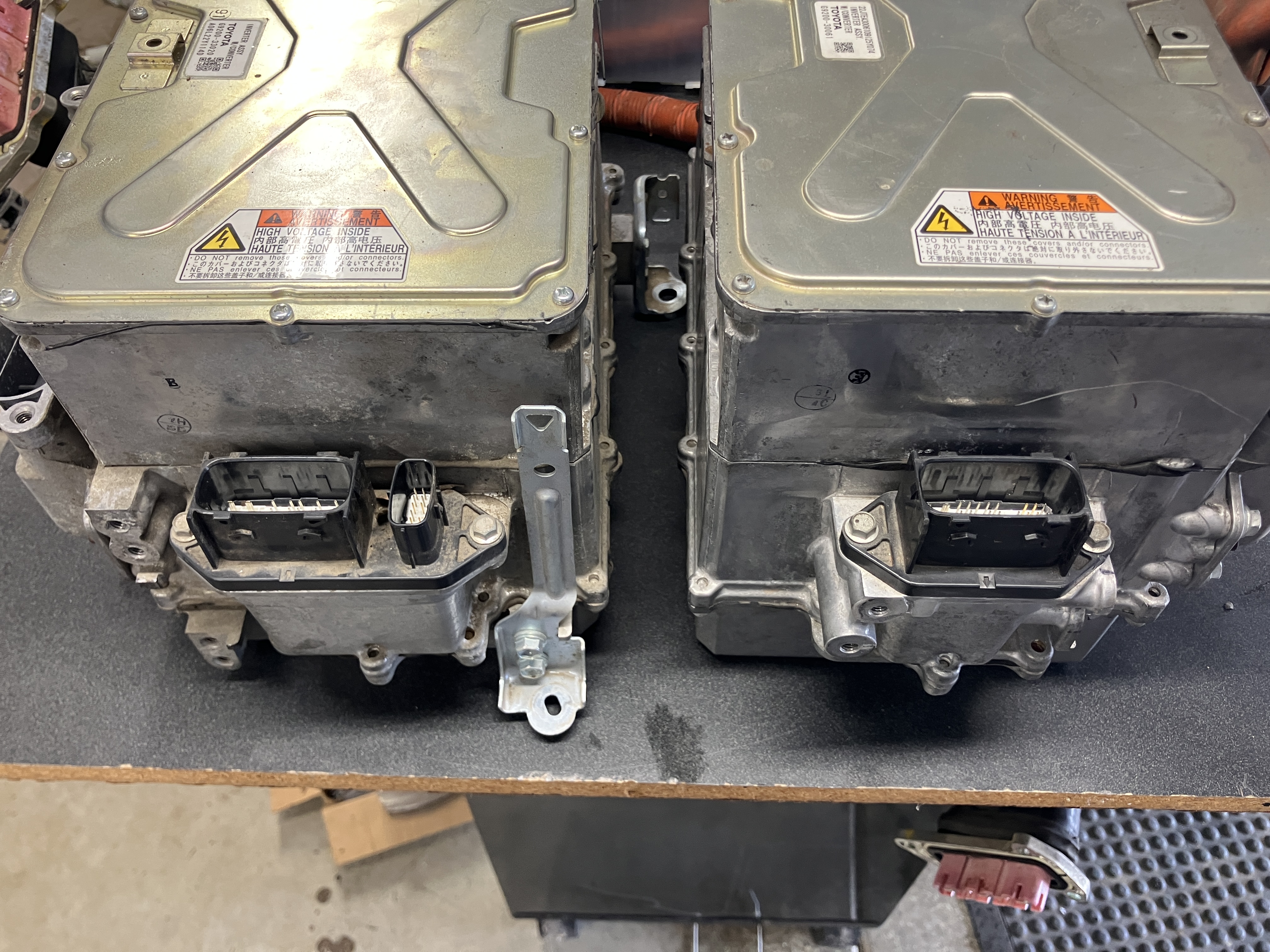

although the pin out is different the Camry Hybrid inverter wire harness plugs right in to the Lexus GS450h inverter
even the Camry HV motor cables plug right in to the GS450h inverter

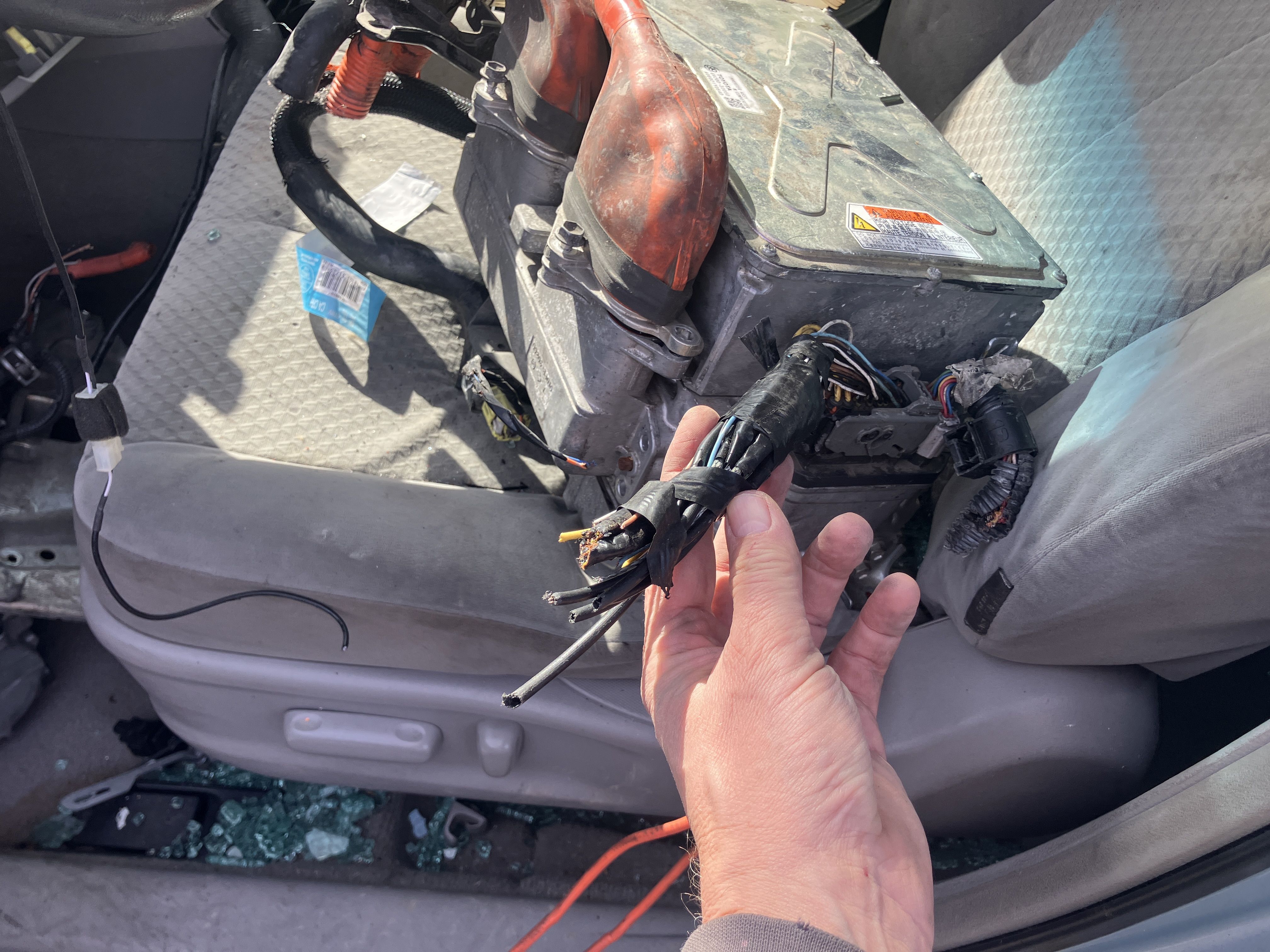

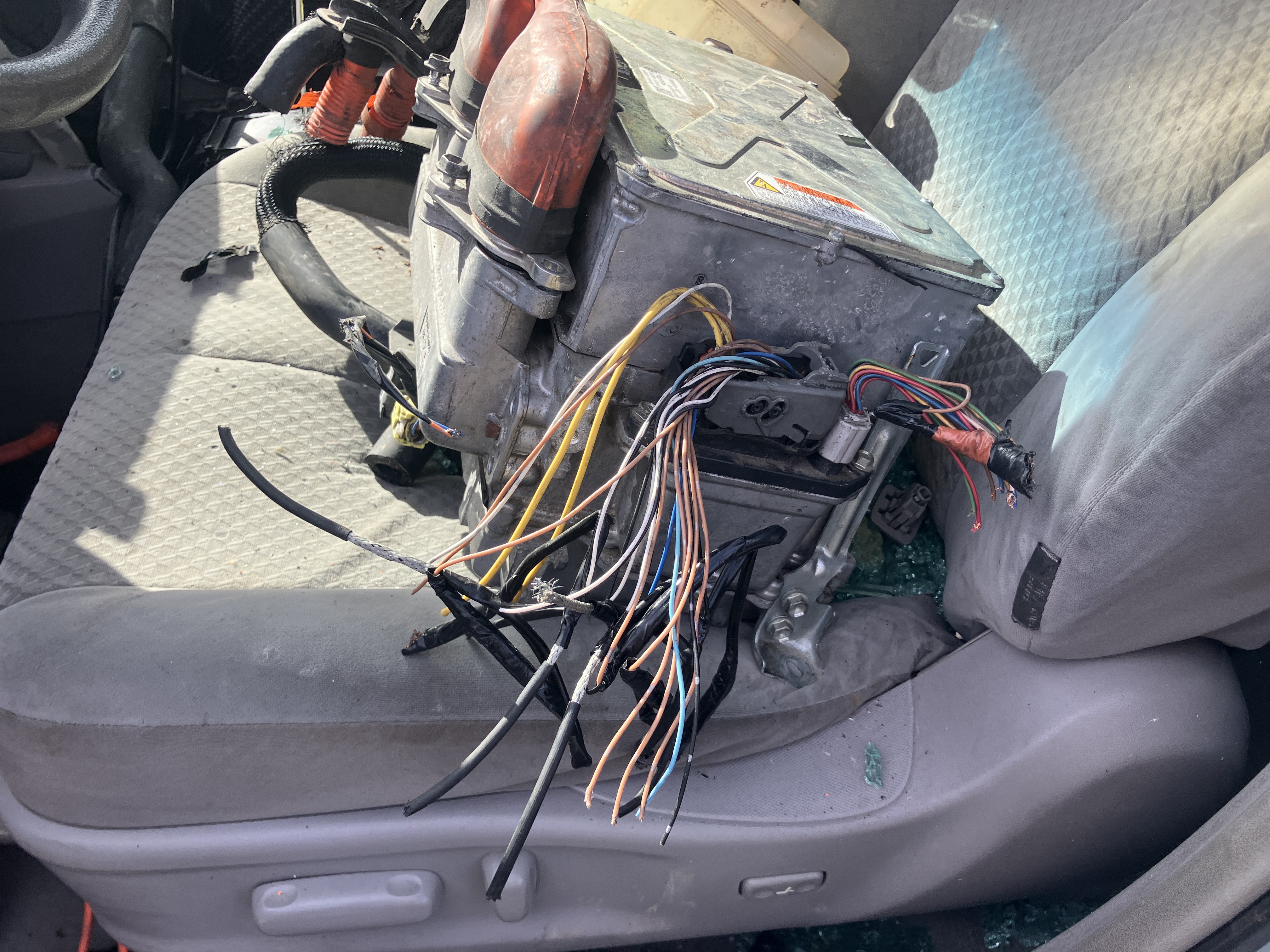

the struggle is real...
Gregski
Posts: 3164
Post by Gregski »

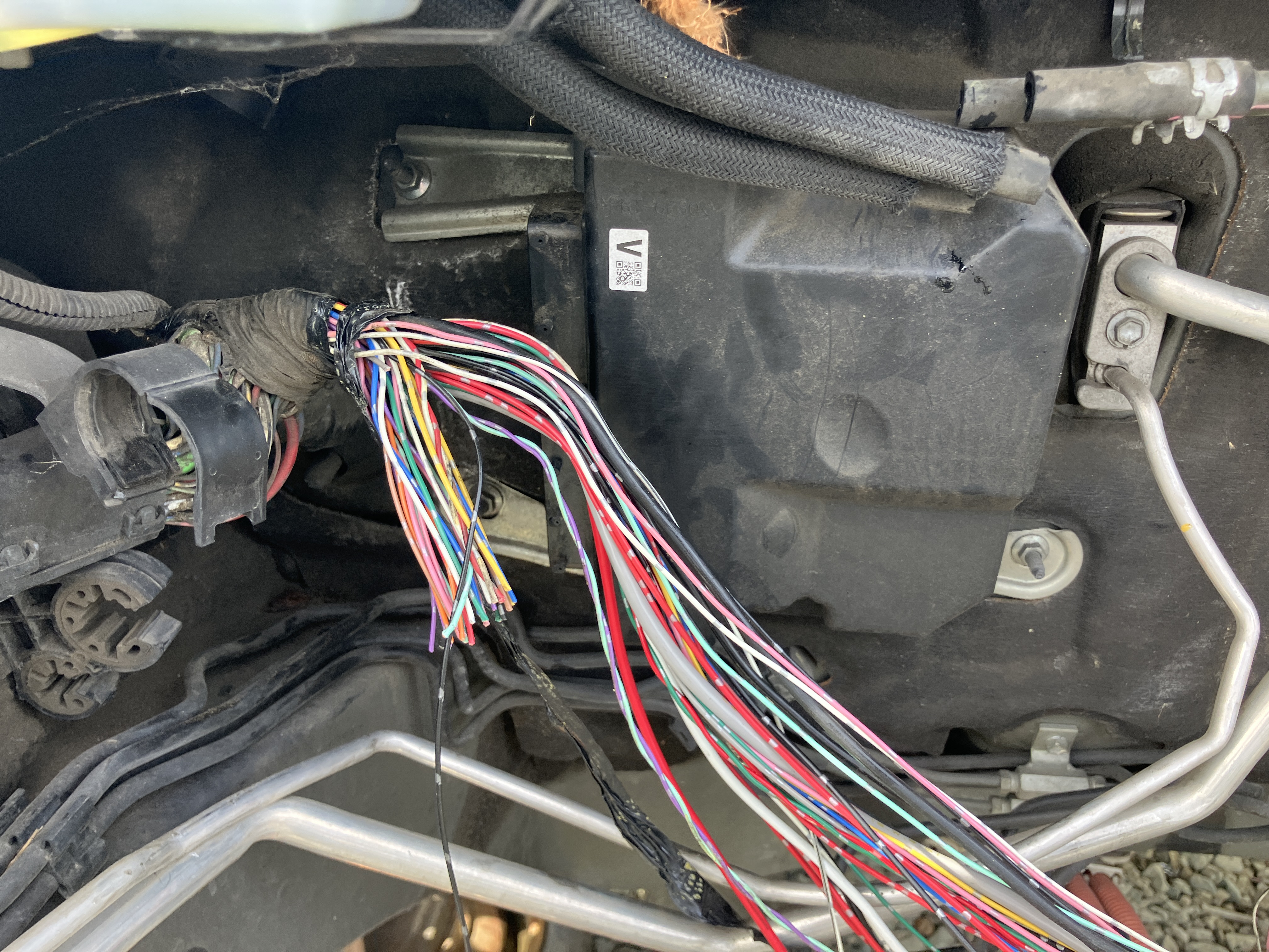

when the Junkyardigans cut the inverter plug pig tail too short
you can tell we are dealing with professionals here
is this what they mean when they say [ahem] left hand drive?
FYI - I still bought it just to see what they would charge me for it. It ended up being $6.00 bucks and some change, but you have to pay $3.00 admission fee to get in to pull your own parts. I will be happy to pass these connectors/harnesses to you at my cost plus shipping, PM me to make arrangements.

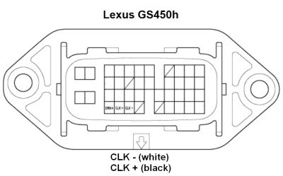

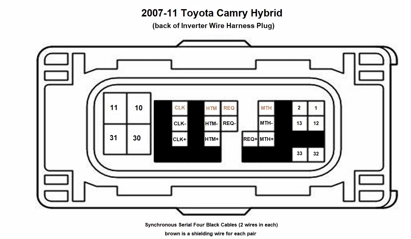

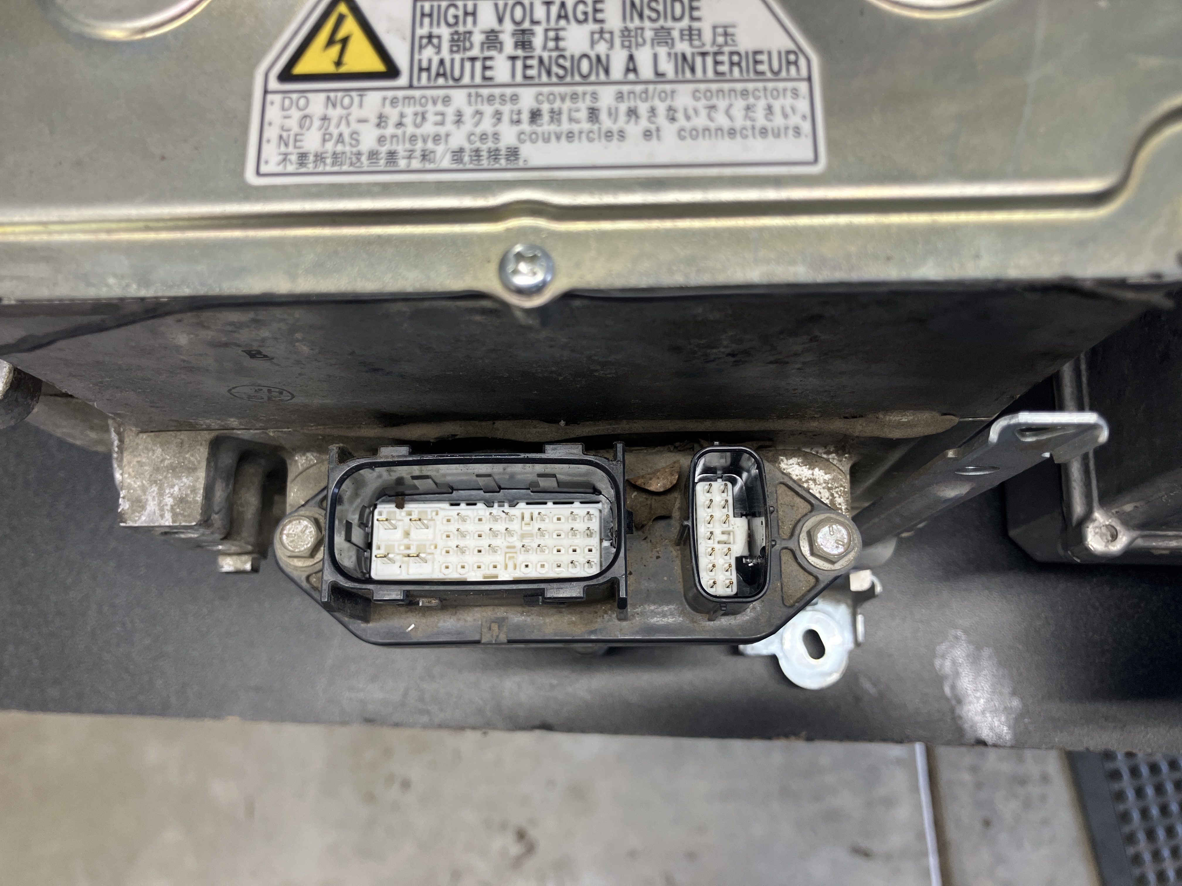

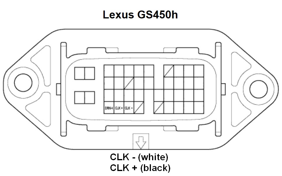

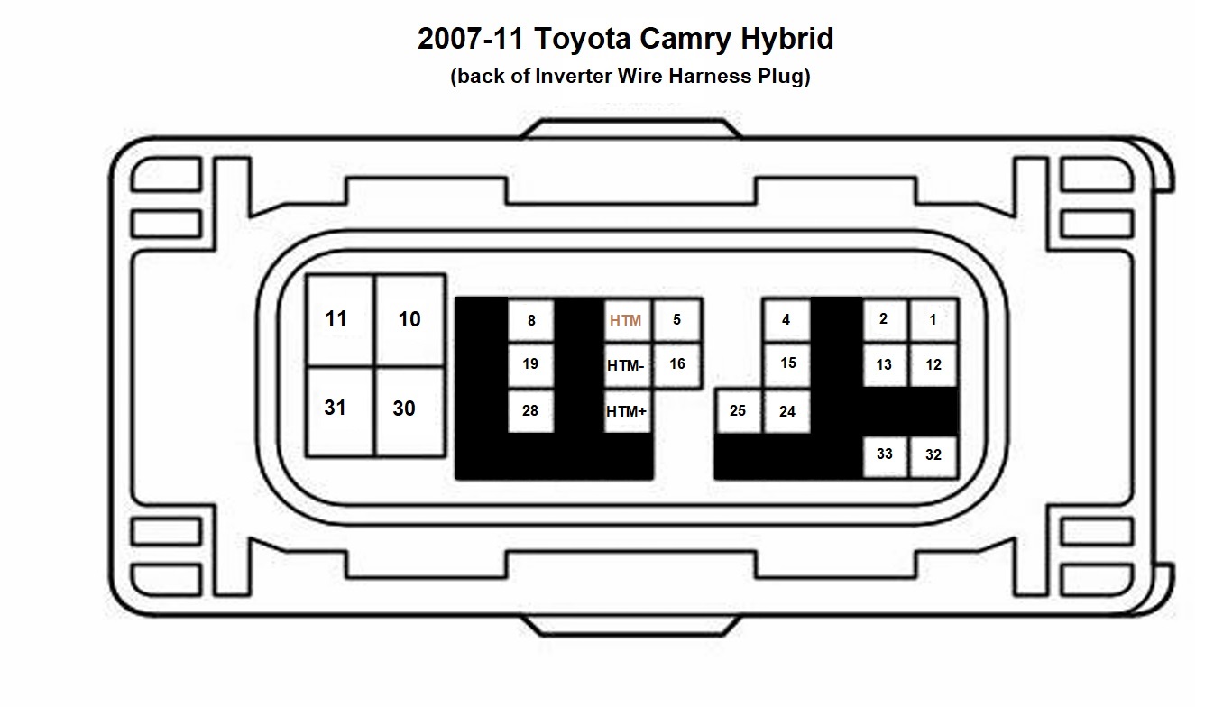

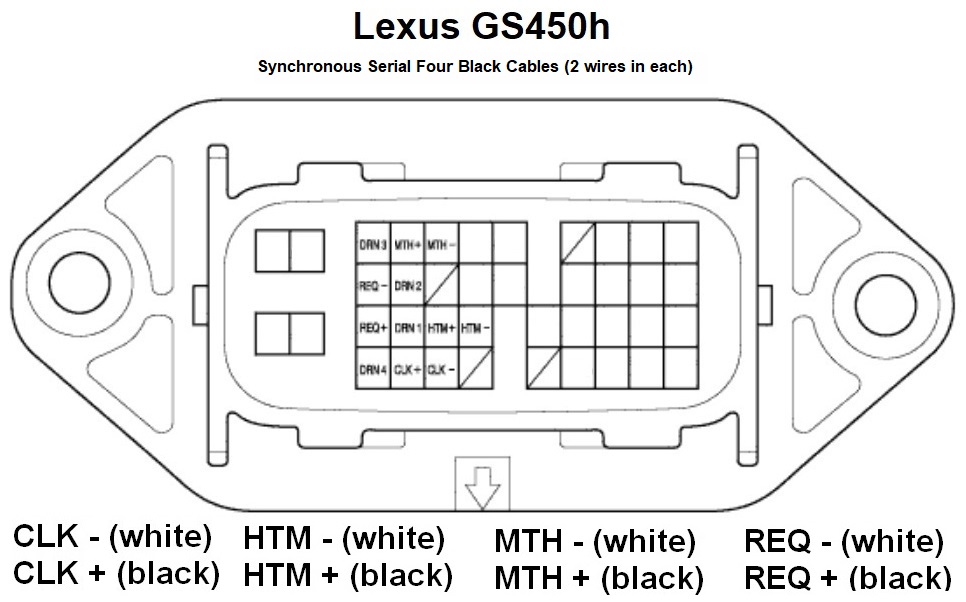

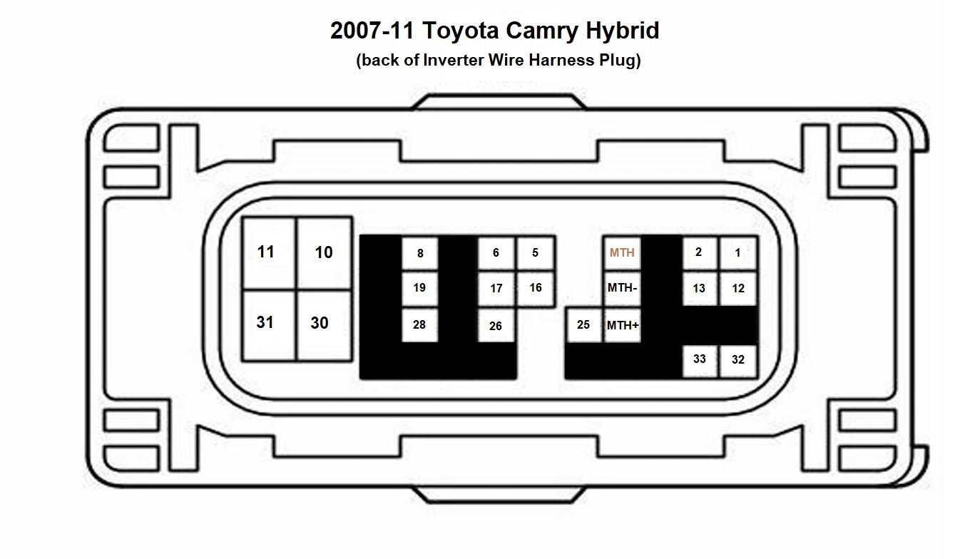

so although the Camry plug fits perfectly into the Lexus inverter the wires are pinned differently, let's start out by comparing just the four Synchronous Serial black cables with two wire pairs each (a black and a white wire)
ToyotaLexus
Gregski
Posts: 3164
Post by Gregski »

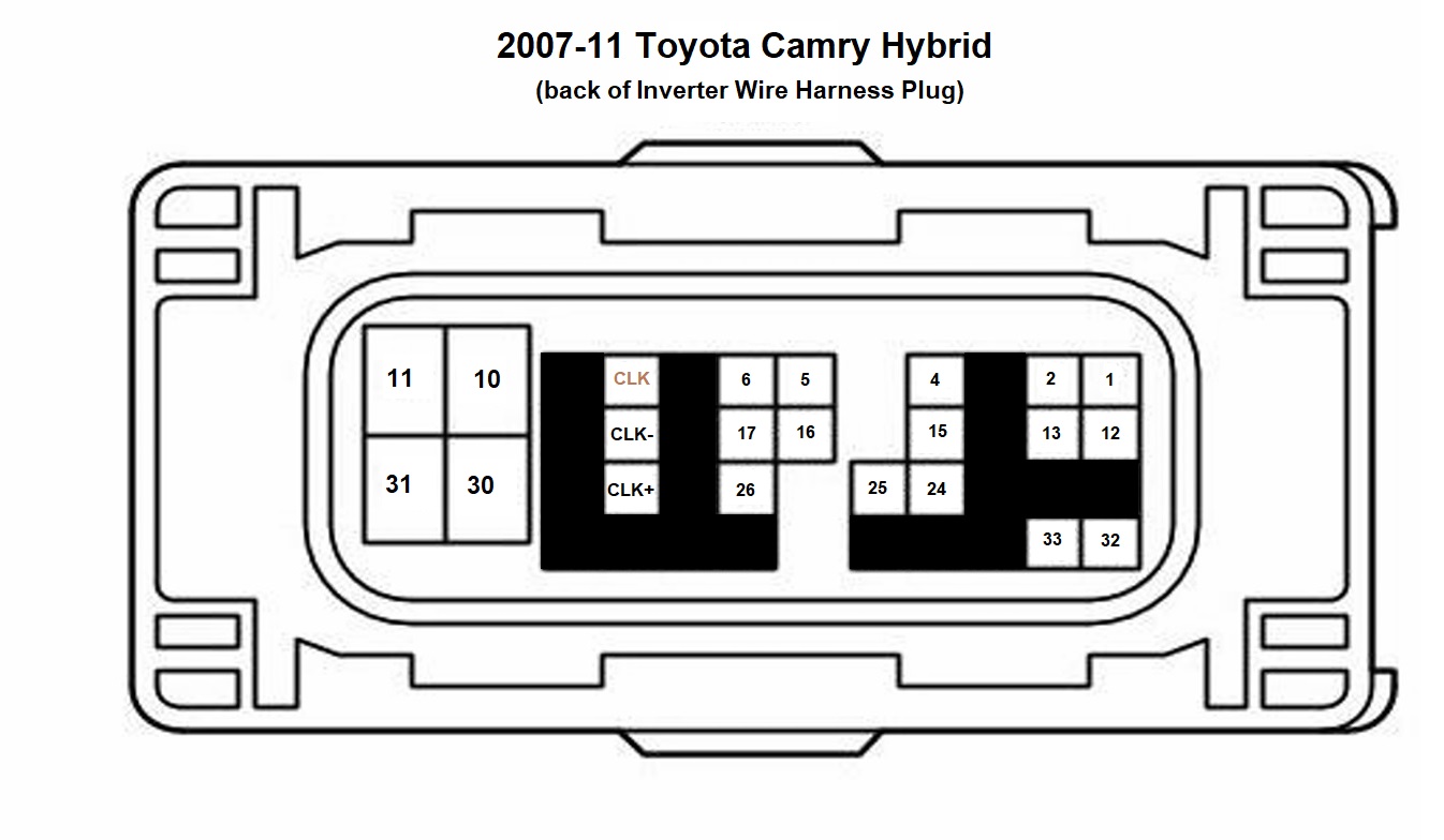

alright let's move them over one pair at a time so the 500KHz Clock line aka CLK wires first
CLK- white wire
CLK+ black wire
CLK this is a ground wire for the cable wire shielding mesh thingie, these wires are erronously cut too short at the junkyards by unknowing personnel
please consult Toyota Inverter Connectors and Pinouts for the proper pinout technique
ToyotaLexus

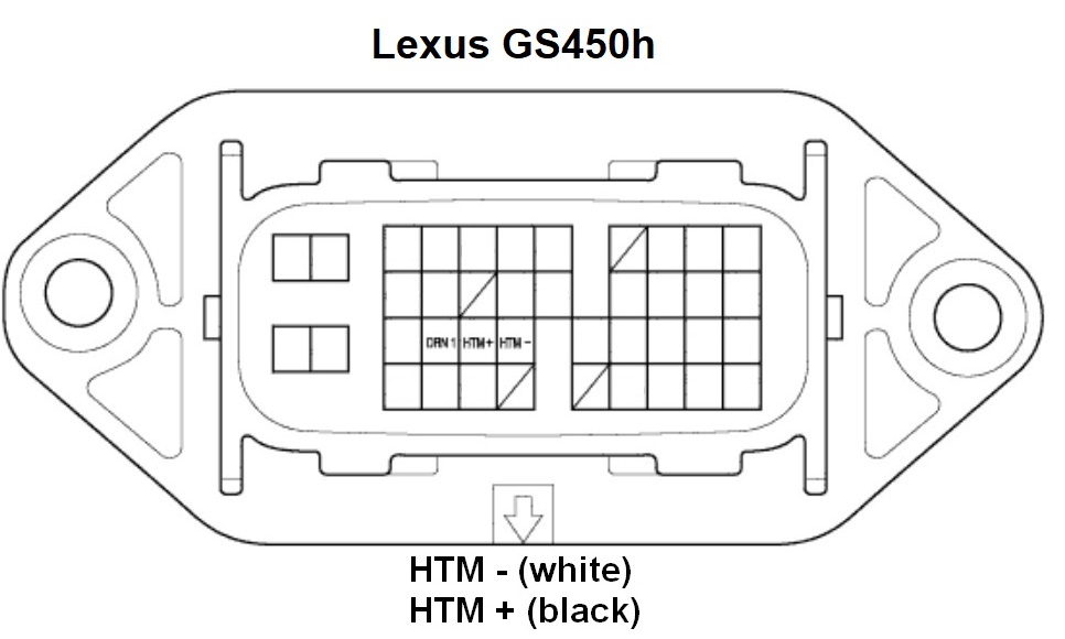

alright let's move them over one pair at a time so the the data frame from the hybrid controller to the inverter HTM wires next
HTM- white wire
HTM+ black wire
HTM this is a ground wire for the cable wire shielding mesh thingie, these wires are erronously cut too short at the junkyards by unknowing personnel
ToyotaLexus

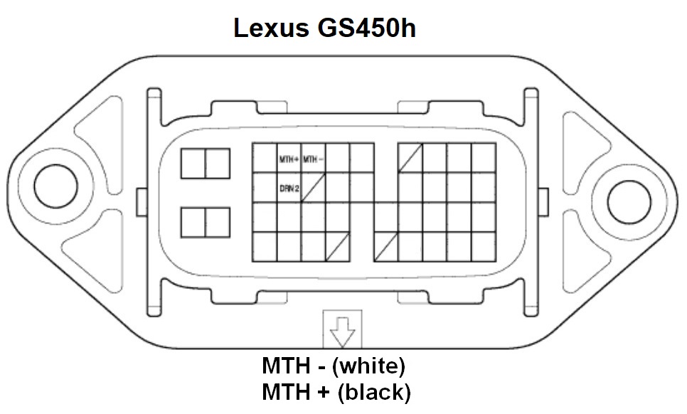

alright let's move them over one pair at a time so the data frame from the inverter to the hybrid controller MTH wires next
MTH- white wire
MTH+ black wire
MTH this is a ground wire for the cable wire shielding mesh thingie, these wires are erronously cut too short at the junkyards by unknowing personnel
ToyotaLexus

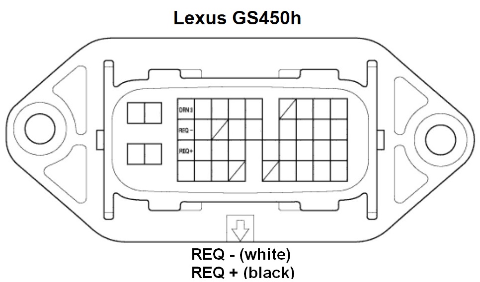

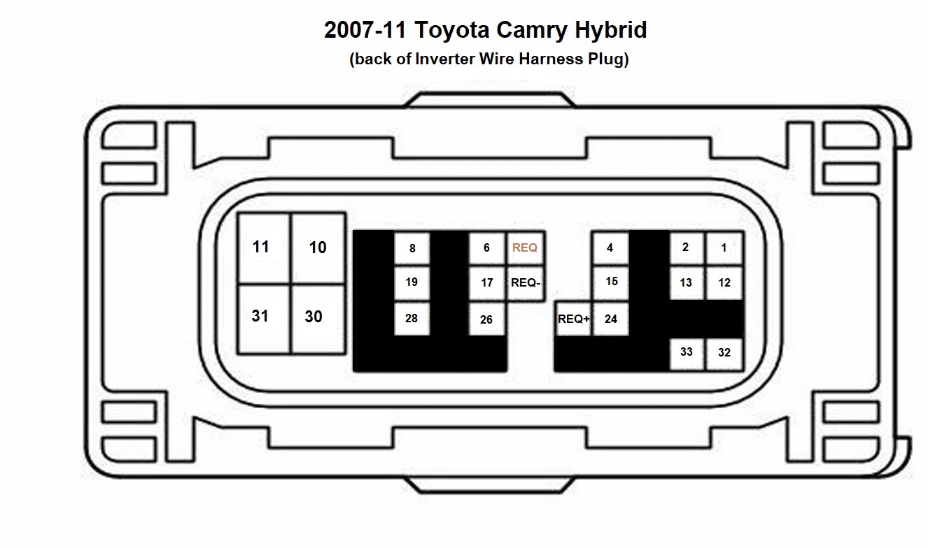

alright let's move them over one pair at a time so the request line from the hybrid controller to the inverter REQ wires last
REQ- white wire
REQ+ black wire
REQ this is a ground wire for the cable wire shielding mesh thingie, these wires are erronously cut too short at the junkyards by unknowing personnel
ToyotaLexus
Gregski

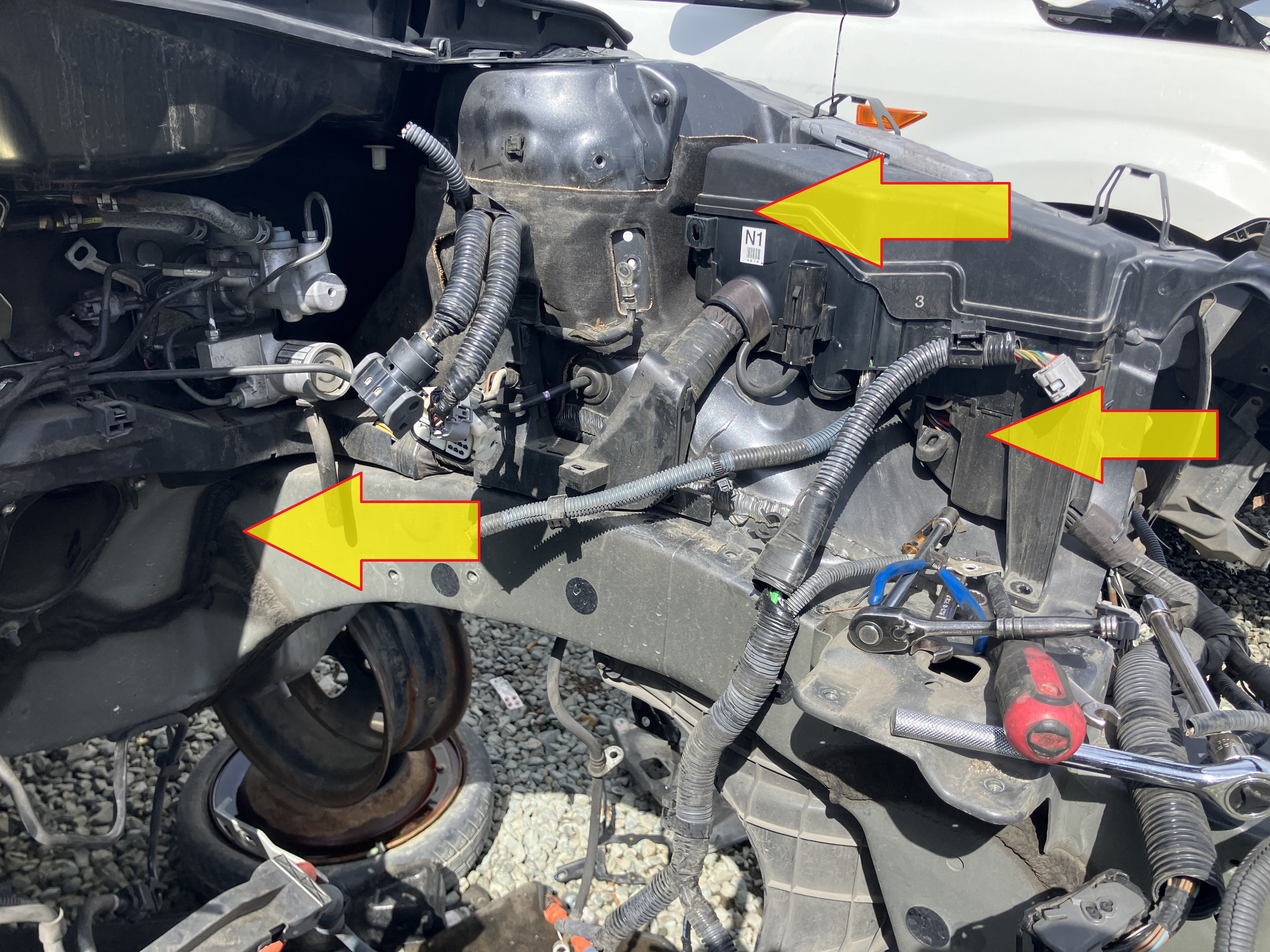

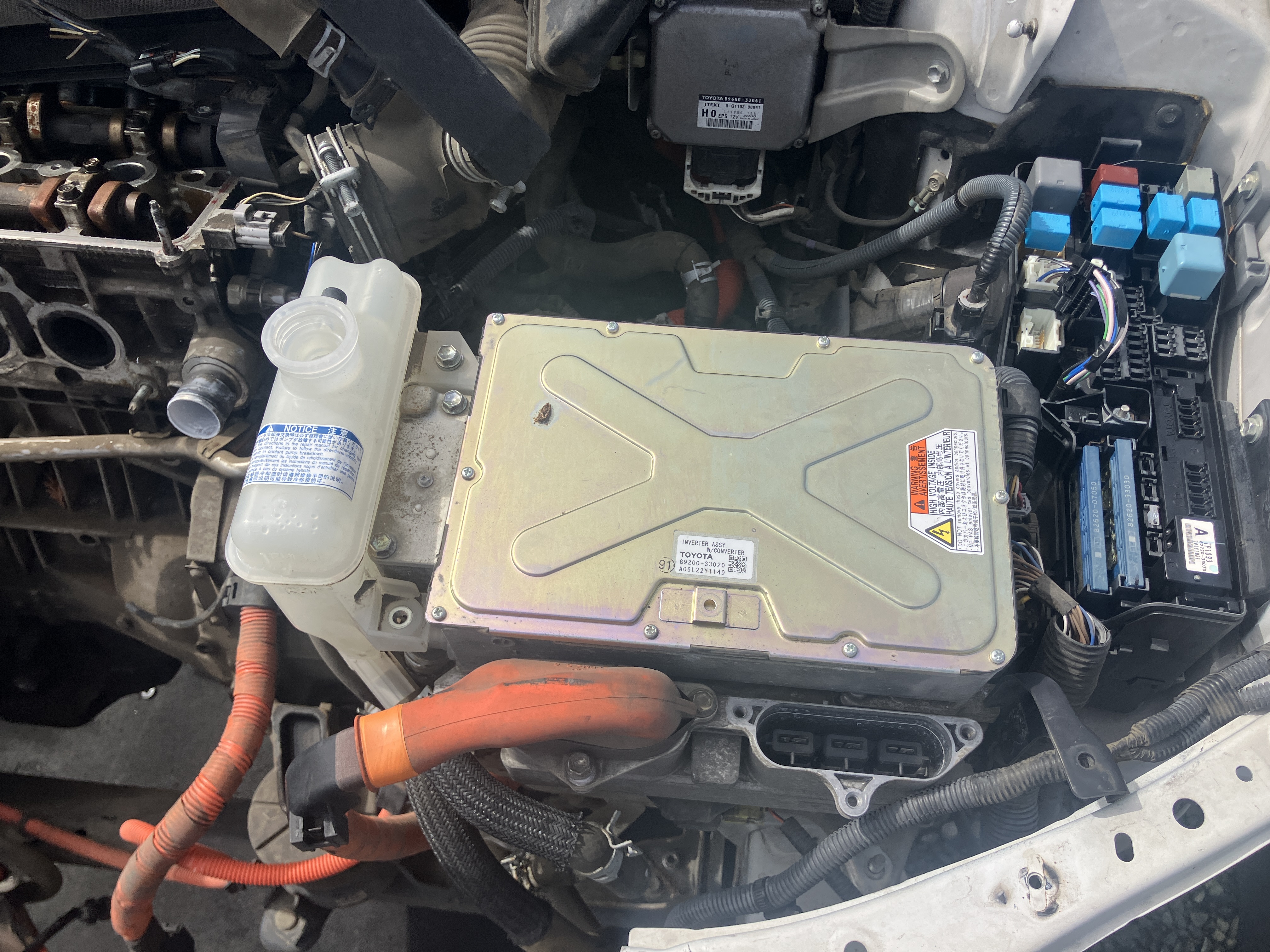

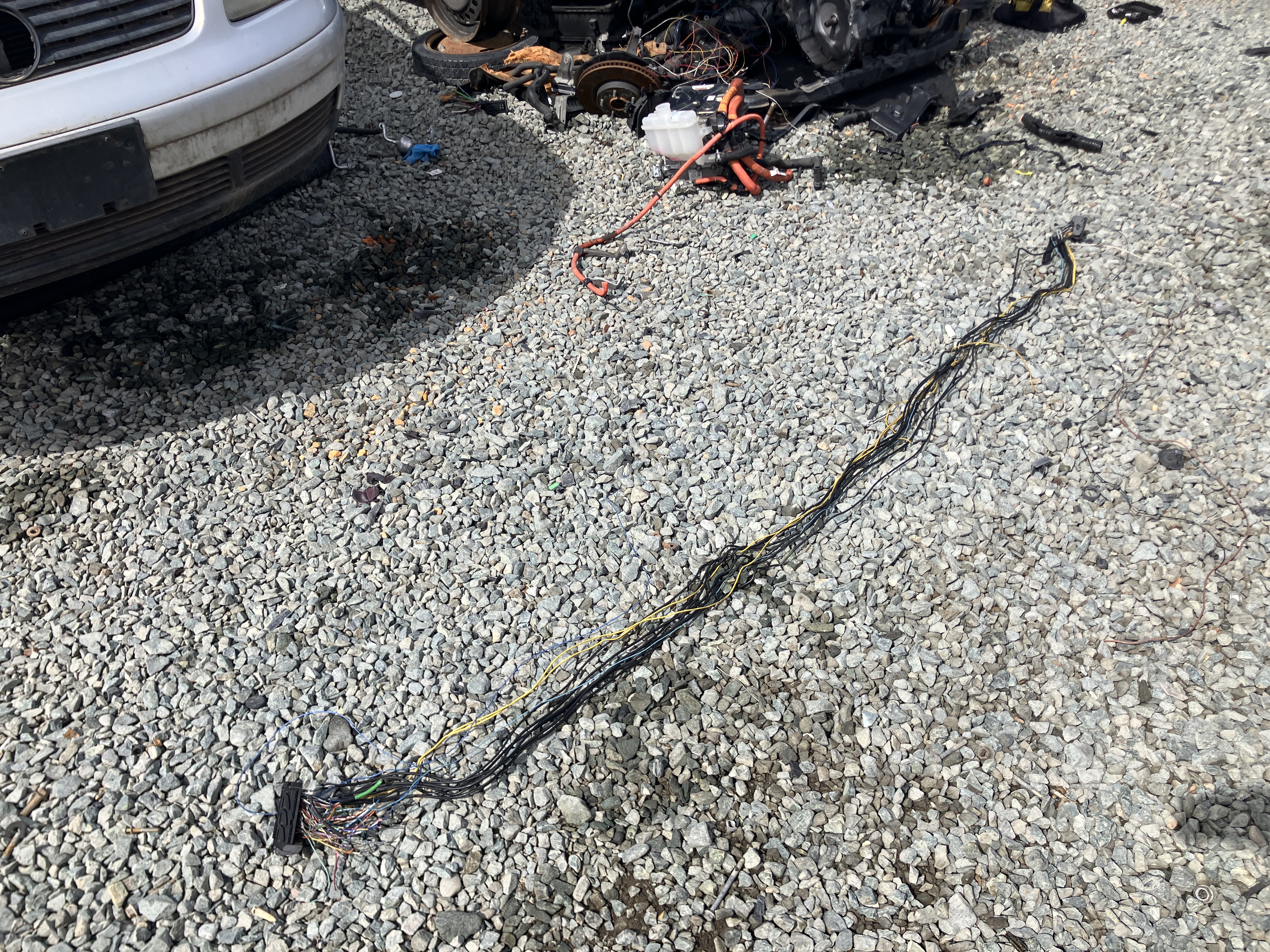

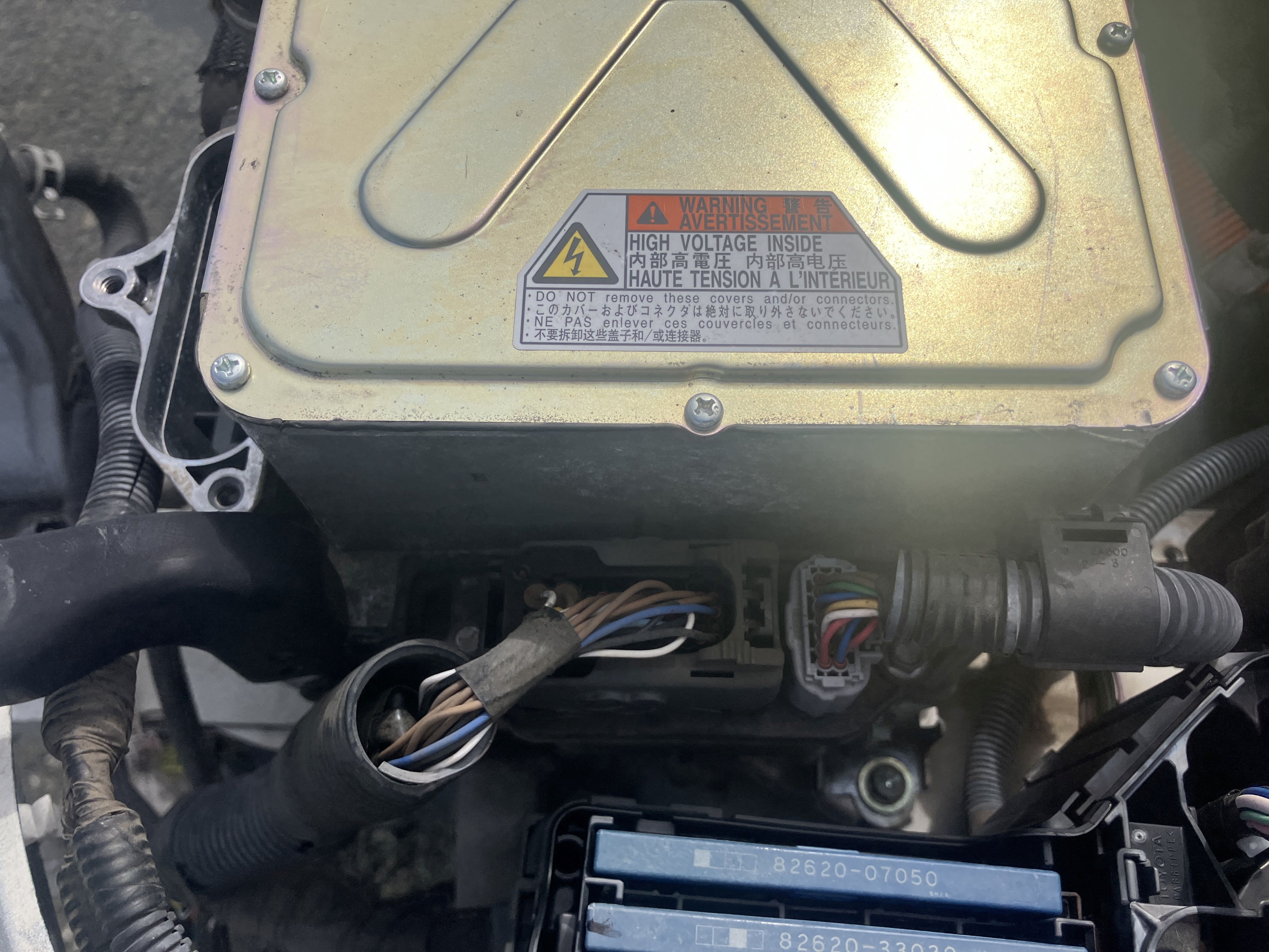

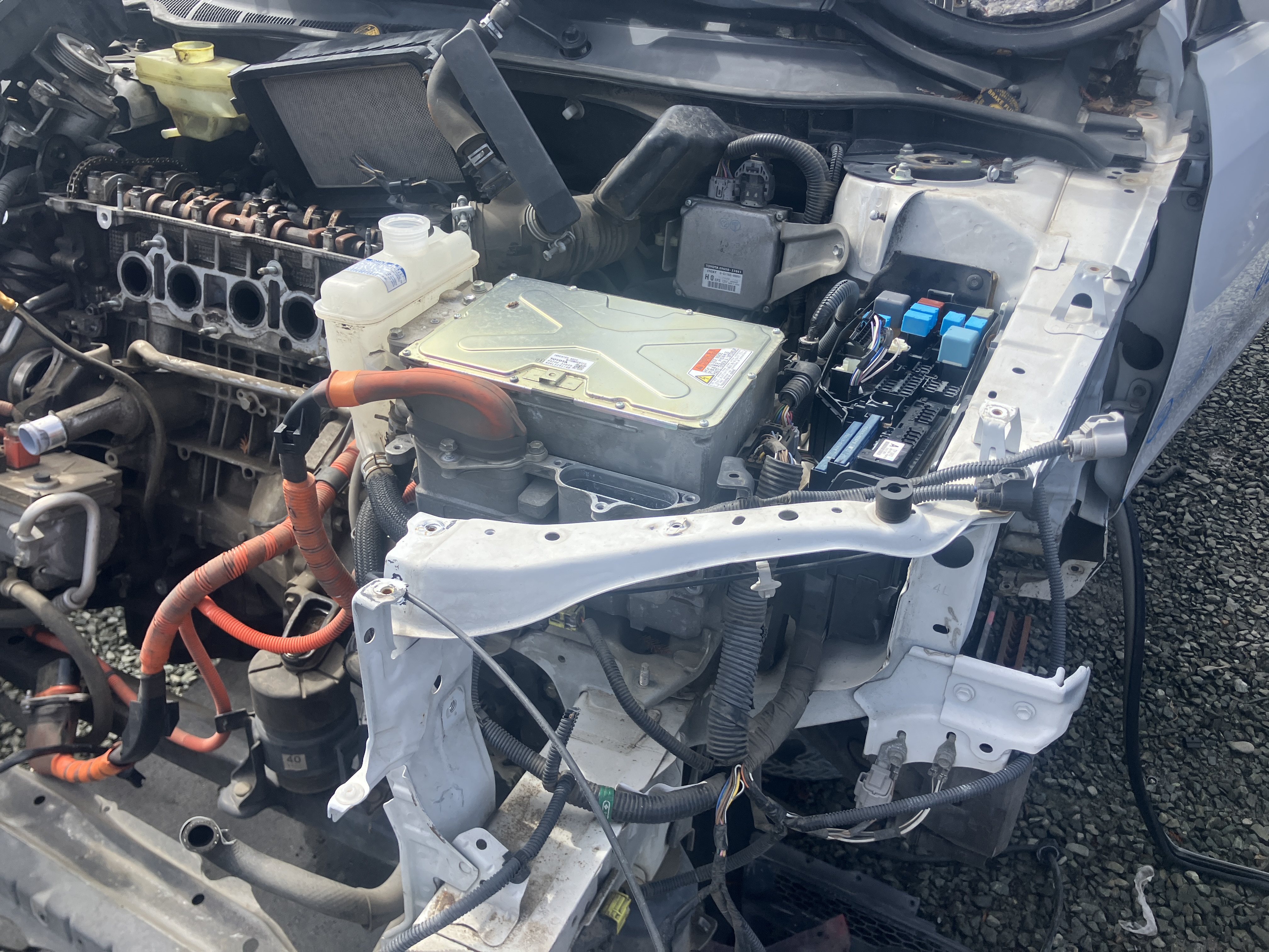

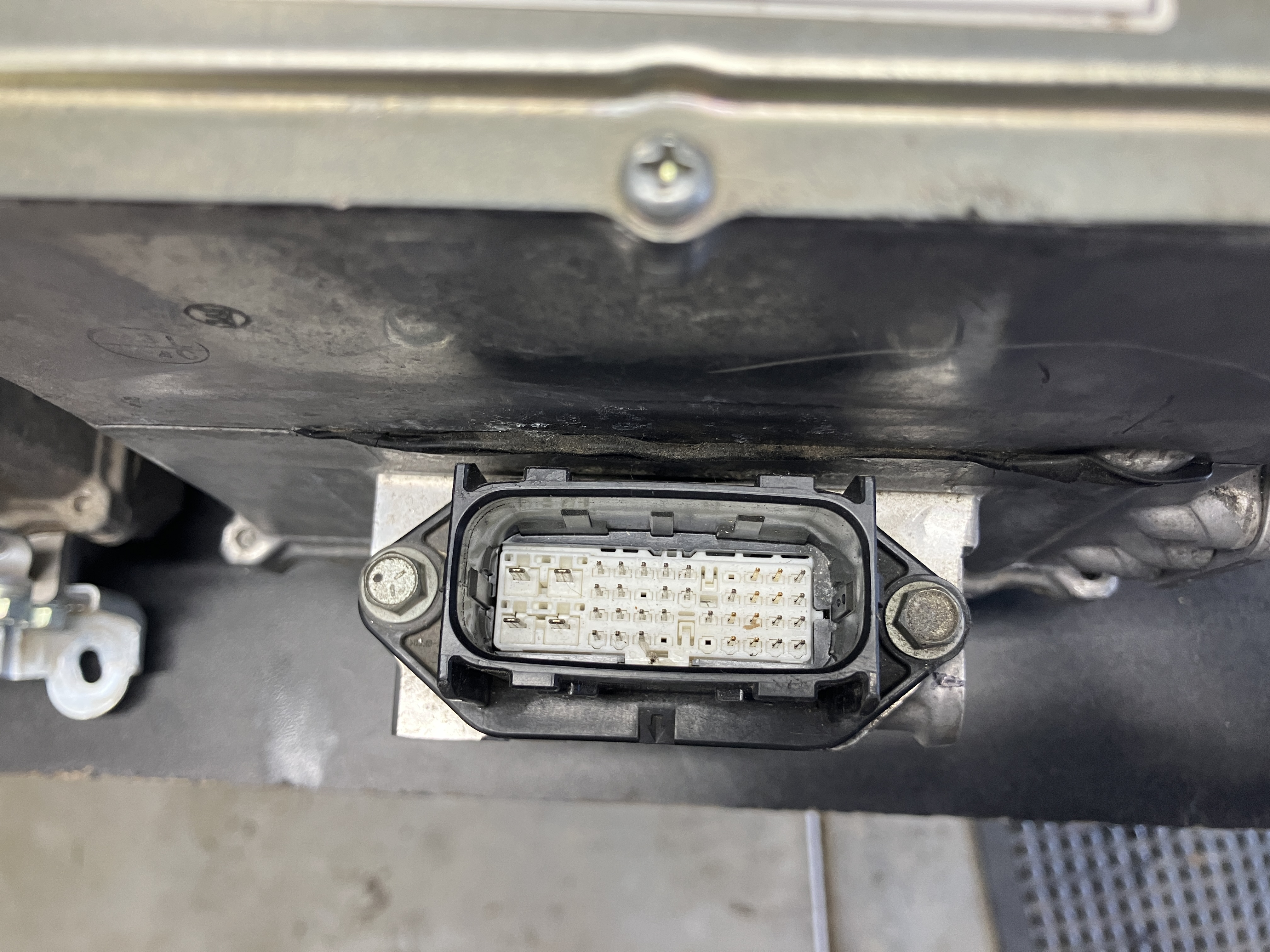

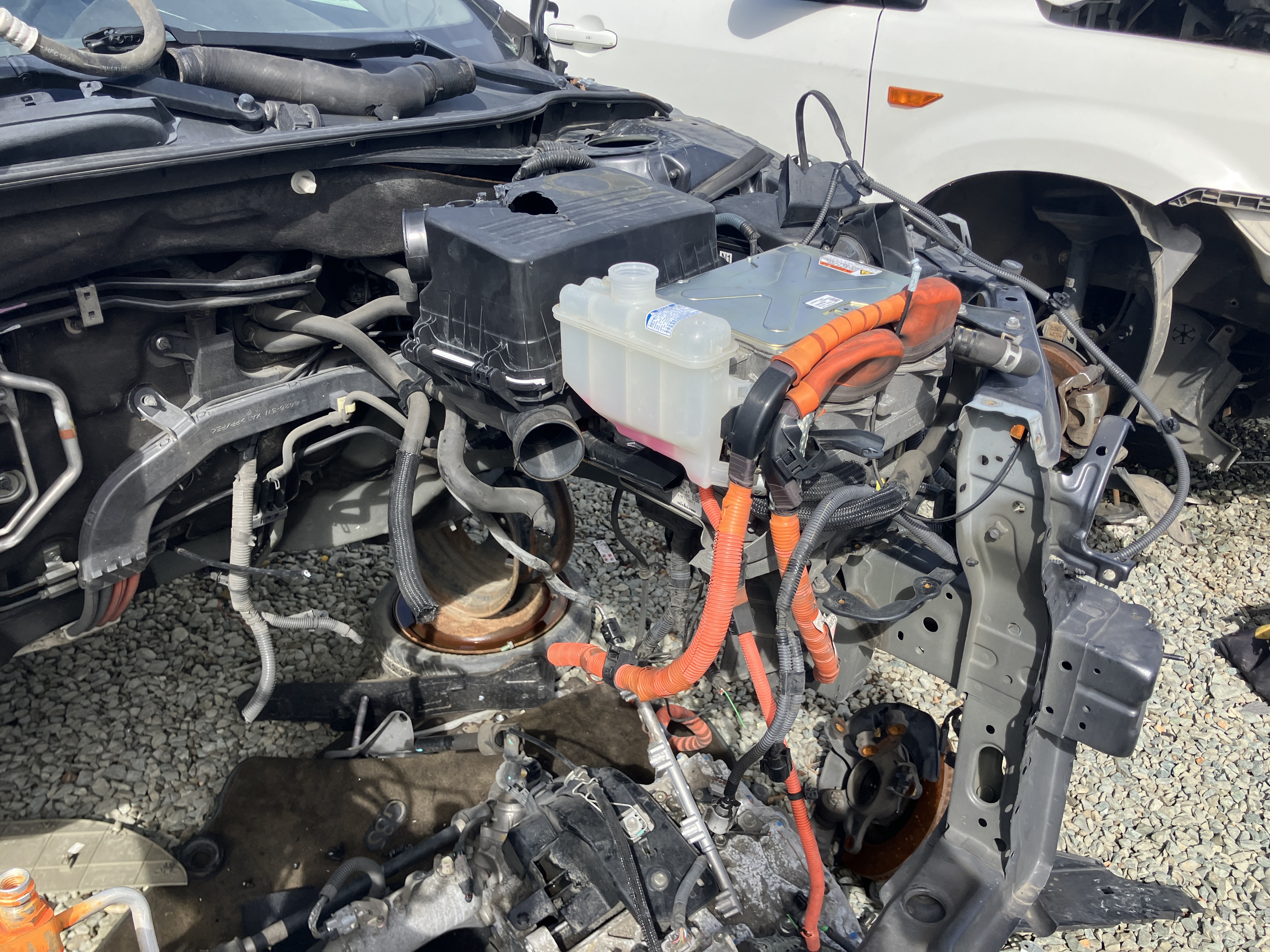

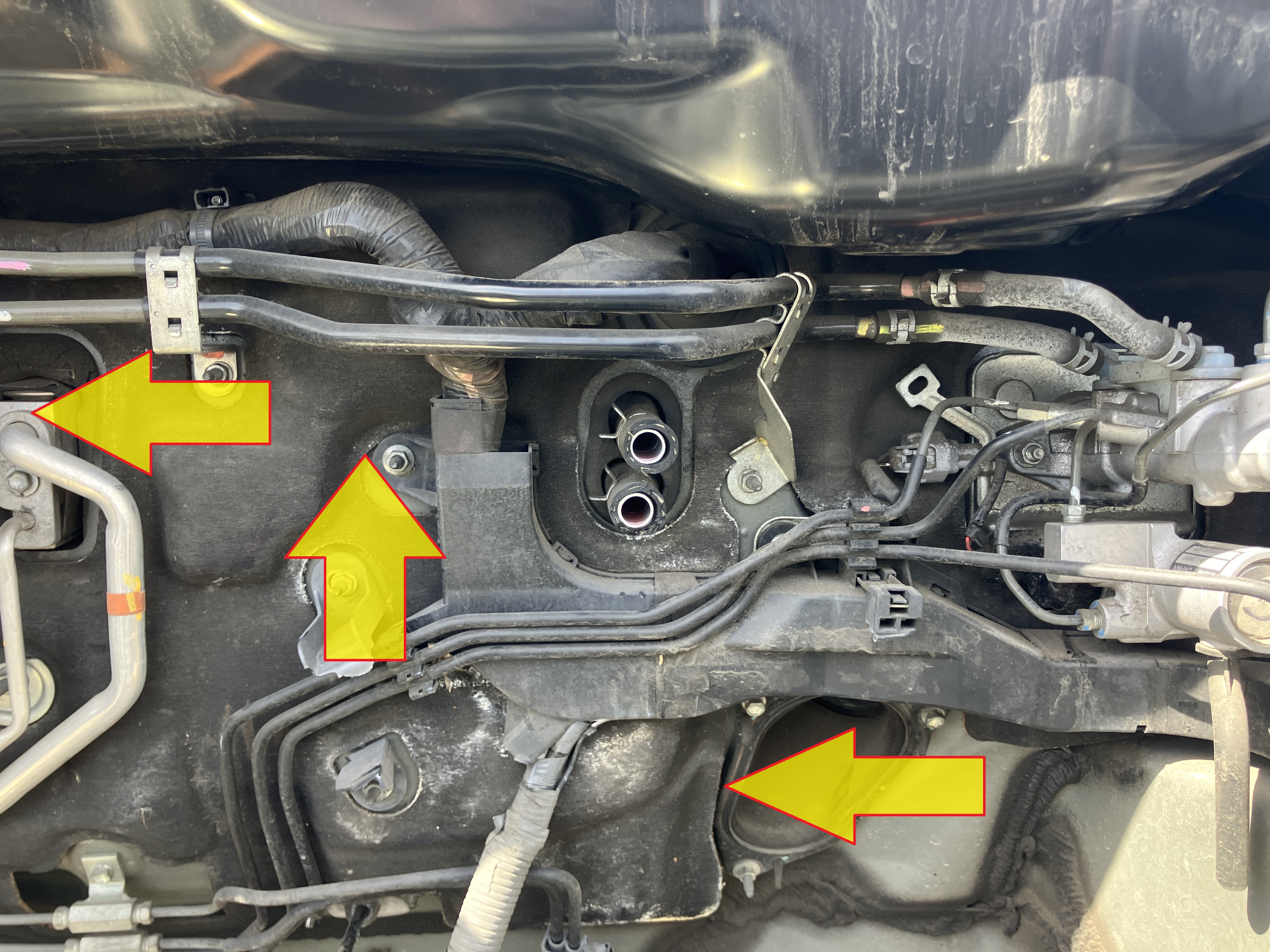

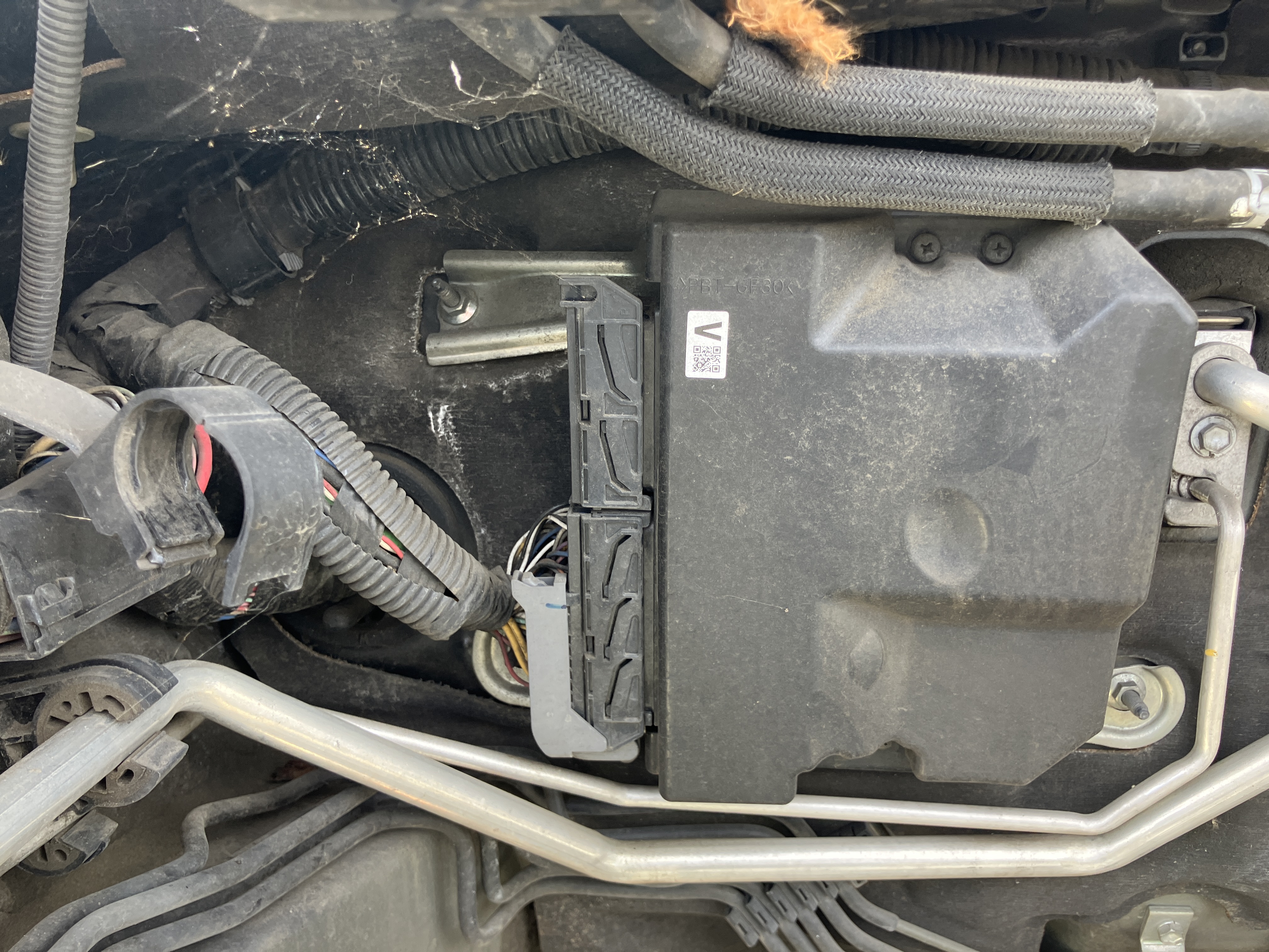

How I pulled a full length 6th Generation (2007-11) Toyota Camry inverter plug and synchronous cables wire harness (full home run from inverter to the Hybrid Vehicle ECU)
TOOLS
  • a pair of very sharp dykes aka wire snips
  • a very sharp box cutter (to cut electrical tape length wise with the wire harness grain)
  • 10mm deep socket (to remove fuse block from inner fender)
  • 100mm open end wrench (to remove brake line fittings to free up wire harness)
  • a flat screw driver
  • another pair of very sharp dykes aka wire snips, lol

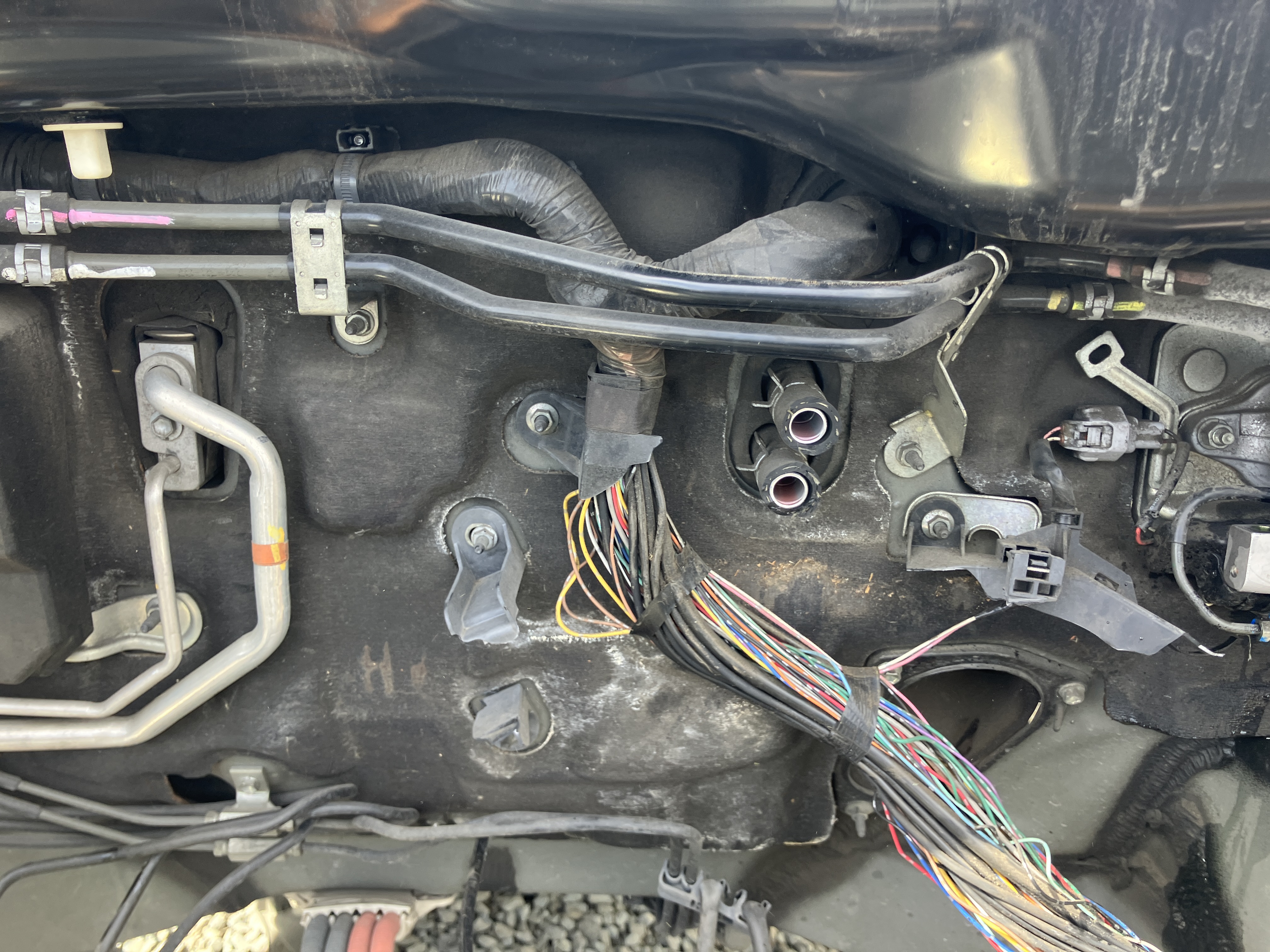

Top Tip: find a vehicle at the junkyard with it's engine and transaxle already removed (hopefully with a grenade like so)

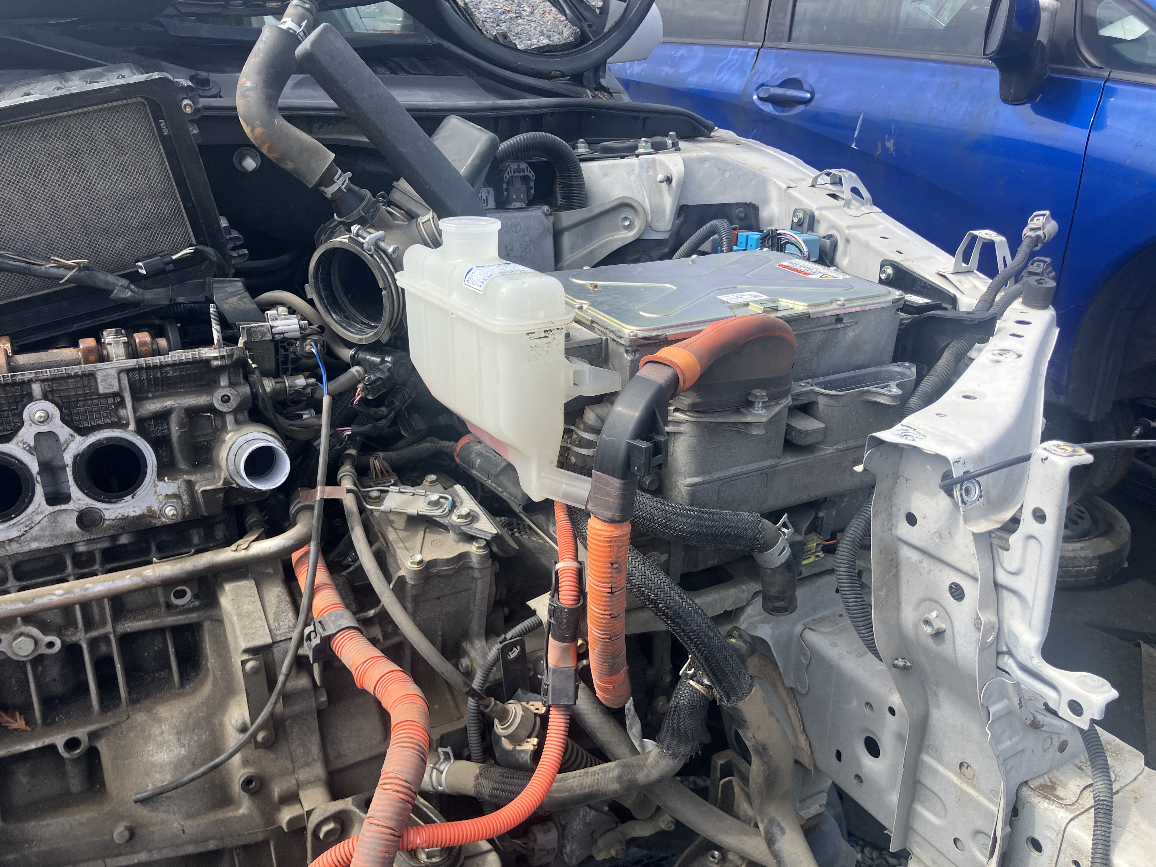

When standing facing the vehicle the inverter lives in the South East quadrant of the engine compartment aka the front corner just behind the headlight on the US driver side.

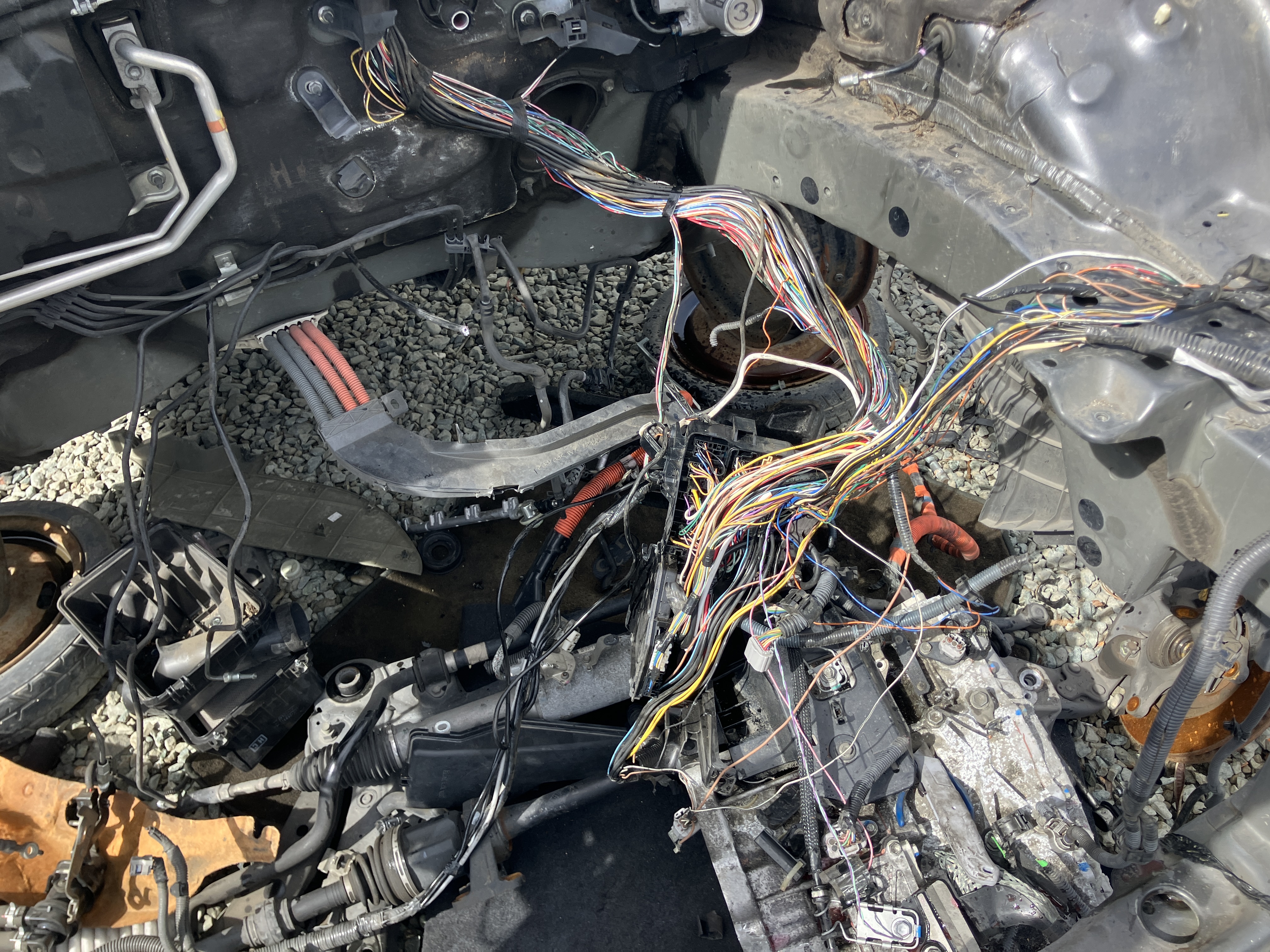

It is wise to first check if the inverter plug is:
  • Present
  • Uncut

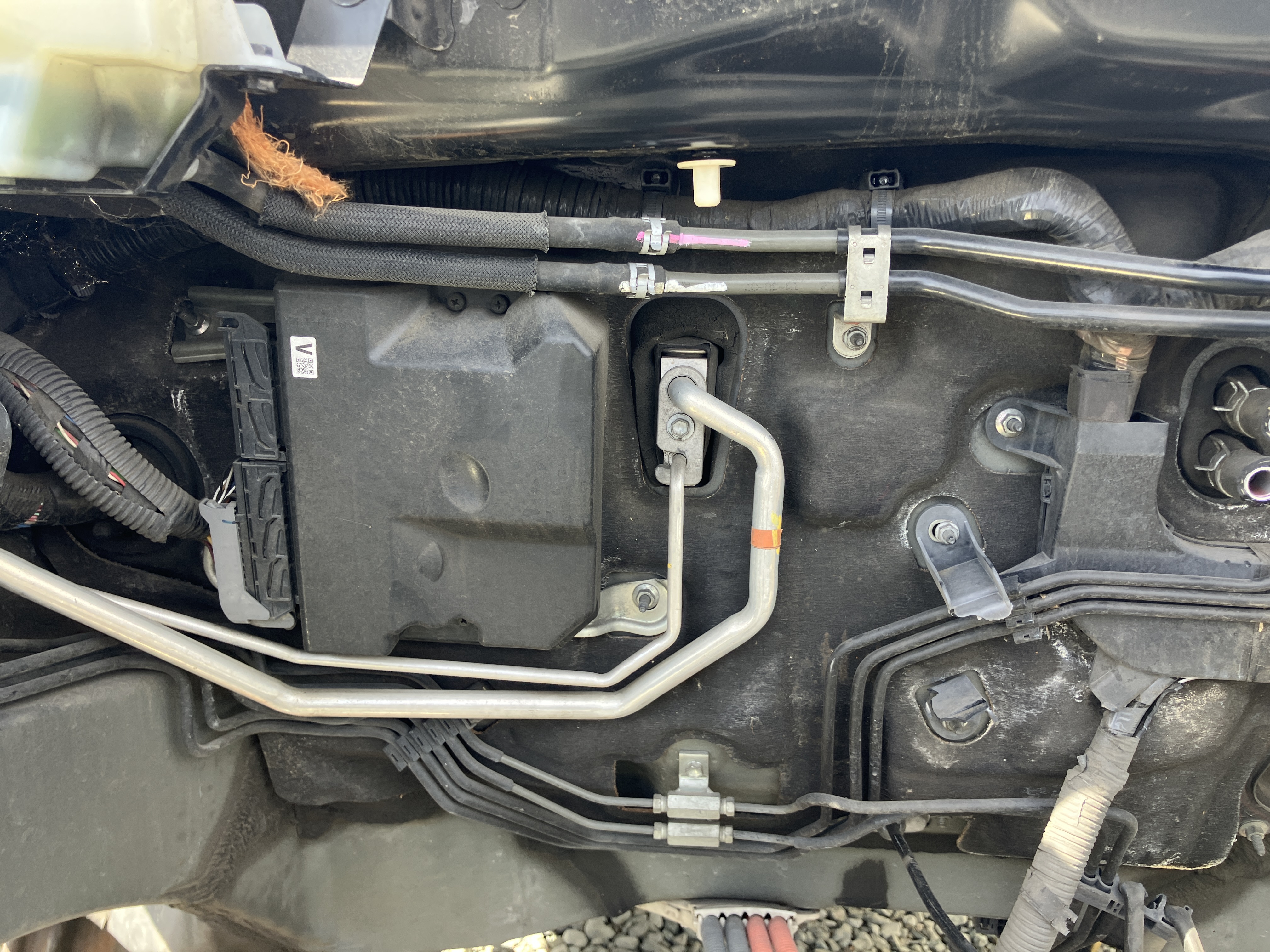

the inverter plug harness traverses behind the bulky black plastic fuse box housing (held to the driver side inner fender with 3 bolts) before re emerging in the corner below the Medusa like master brake cylinder
it then makes it's way all the way across the firewall from the US driver side to the furthest North West corner of the firewall

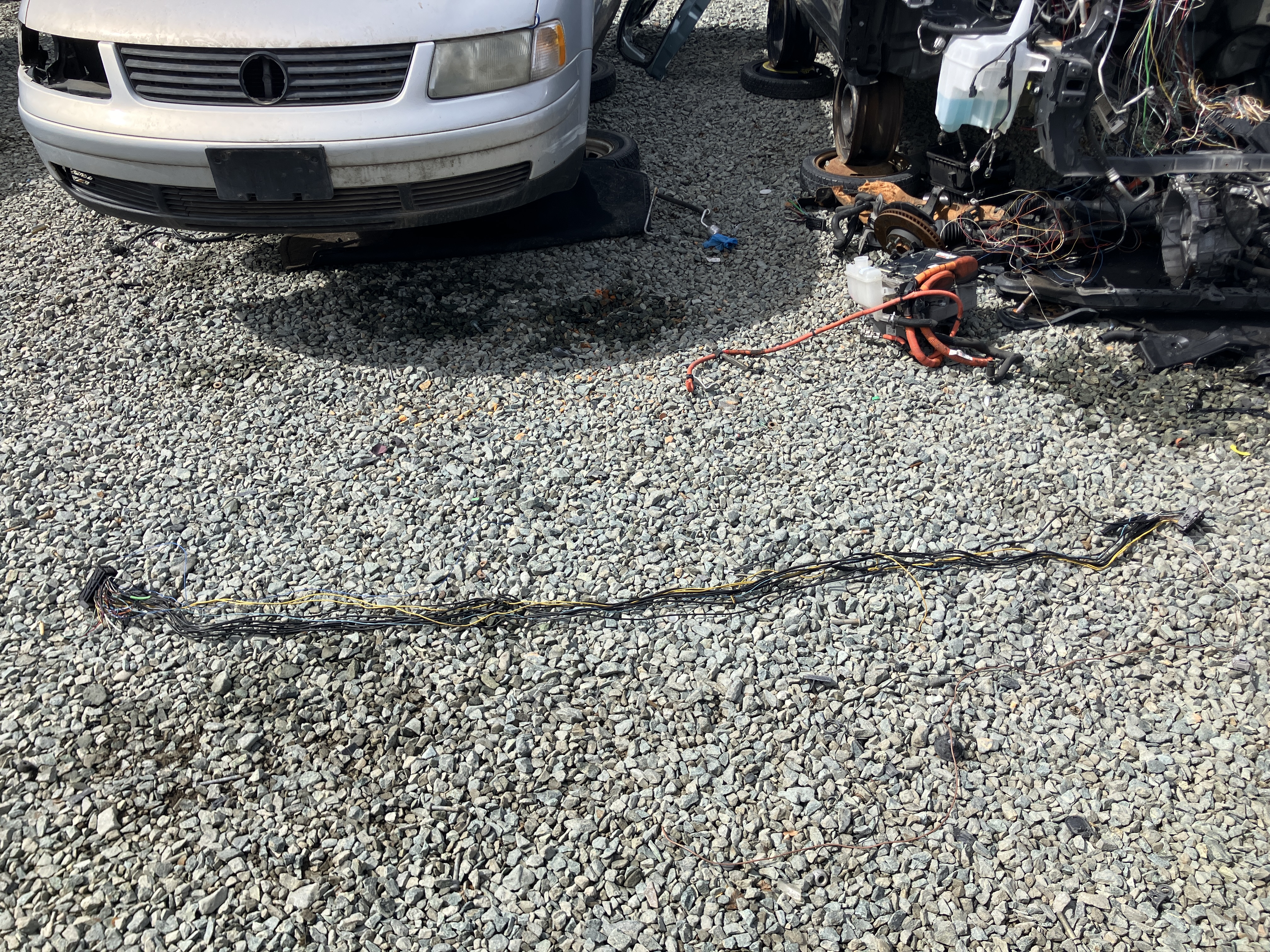

where it plugs in to the Hybrid Vehicle ECU)
There is no need to keep this large black rectangular plug with that gray lift handle that goes into this Hybrid Vehicle ECU, what you are really after is the four black synchronous cables, comprised of two wires each, a thin black wire and and a thin white wire, so just snip them here, they will later plug right in to the ZombieVerter VCU

having half filled the Swear jar, you will be rewarded with something that looks like this
[Note To Self: measure the darn thing]
