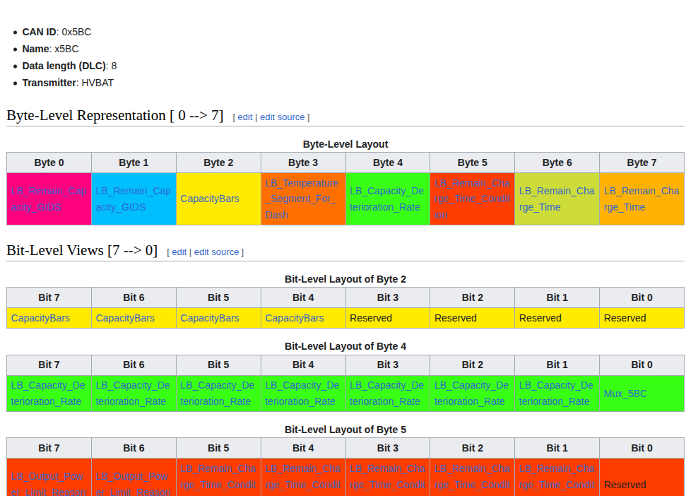

Okay, so aside of templating the creation of page for car components, I have taken a parallel approach of reading from a DBC file to generate wiki pages, and using Dala's Leaf DBCs as my input test files. Again, the intent is to present the work of reversers as human-processable information, as well as tackling the problem of which components generates and consumes which CAN ID, and which car components can possibly have conflicts if they share the same canbus.
The DBC contains the information of which device generates the CAN message and this is how (not sure how automatic at this stage, though) one could link a CAN message to a component, itself part of car.
so far, the python script read the DBC and generates the wiki pages. To make things clear, I do not have the competence to write that myself in a reasonable amount of time, so I am leveraging chatgpt to write the code for me, then I tweak it.
An example of such wiki page for CANID 0x5BC where I manually added the categories: Nissan, BMS, Battery, CAN
To make it visually more readable, I played with defining colored cells for every byte, but for that it requires a modification on the Mediawiki:Common.css file to work, for which I do not have the rights. the content should be
so, when applied, it should look like this
the name of the page is not easily changeable in Mediawiki, so the choice is crucial. My example is wrong already, as any other component which would define the same message name would be duplicating the name. It is also possible the same CANID from a given vendor has different content based on hardware of firmware revision. (I think I have seen that on the different CAN messages from Kia Soul vs Niro) - so page naming is not set yet, suggestions welcome. so far I am thinking of
in our case
In my mediawiki testbed using Semantic for Mediawiki, I have group car model (ie Nissan Leaf AZE0) as part of a bigger category (Nissan Motor Group), because cars may be sold with different names/brand depending the regions, and Nissan and Renault are sharing parts. so it is remotely possible to find nissan branded parts in an electric renault (this is pure speculation).

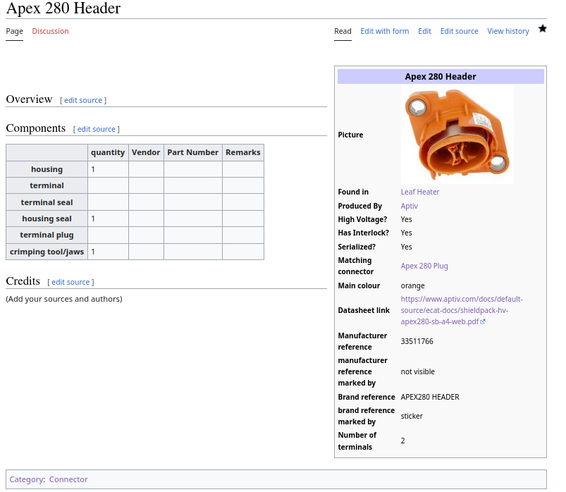

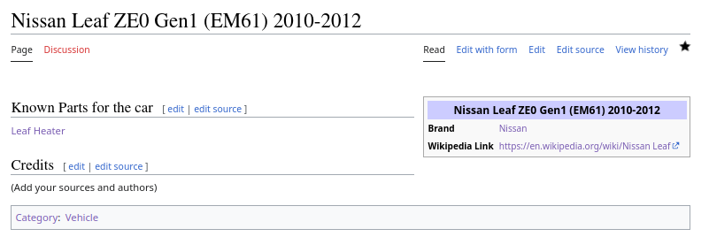

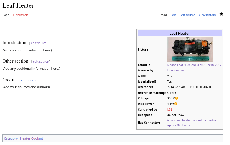

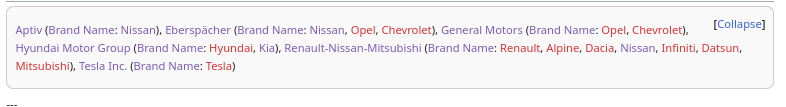

going back to the SMW organization. After having created manufacturing groups (and associated/connected brands)
Still need to refine the model to avoid pitfalls...
I can then create a specific car. the car template contains a dynamic query asking which components is part of this car. Here it shows the coolant heater as I have created it. So, no need to update the car page, it will update itself.
Looking at the car heater I create it with a template and tell which car it is part of (this is how the car page knows about it) and give a picture, the details, and also which physical connector is using it
it means each physical connector is also defined - once - and then can be referred to by the different components using it. For connectors, a "mating connector" is defined as well. See example of how it could look like below

yeah. Wouldn't mind trying again but the installation process is somewhat intransparent. You invoke some package manager and it does things. So rather reluctant to try this on the production wiki. Currently don't have the resources to set up a second one
- marcexec
- Posts: 185
- Location: Dublin, Ireland
- Has thanked: 777 times
- Been thanked: 74 times
Re: creating a can id list !?
Is there any external tool that could create those to copy and paste in? As we gain more knowledge the entries could be edited as needed.
