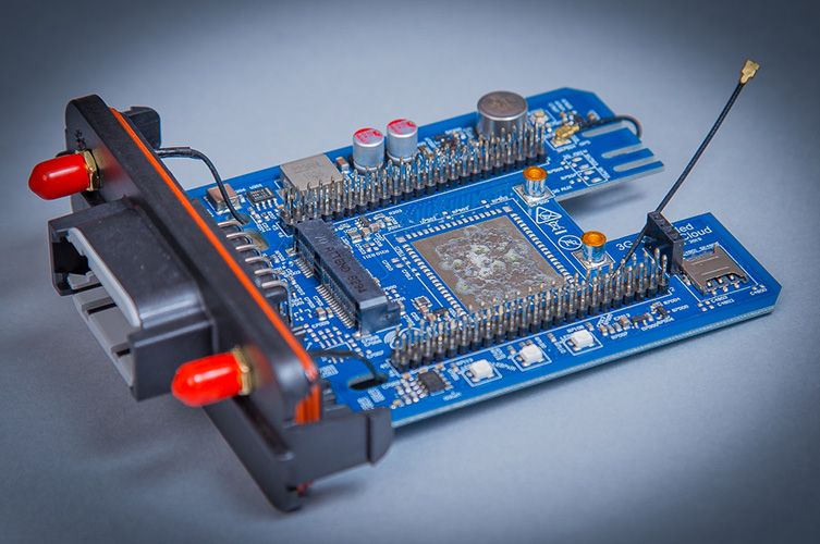

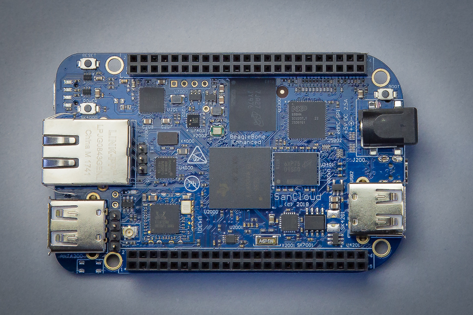

It might be worth chatting to Zero EV in the UK. They have developed a range of instrument displays that are truly stunning.
Re: Custom LCD gauge cluster
Couldn't find anything on their website. Is this prototype stuff?
- tmotion
- Posts: 55
- Joined: Fri Sep 27, 2019 7:16 pm
- Location: Rijswijk, The Netherlands
- Has thanked: 3 times
- Been thanked: 5 times
It is included in their tesla motor kit (but probably sell them seperatly as well). They even have round displays which fit nicely in an old instrument cluster.

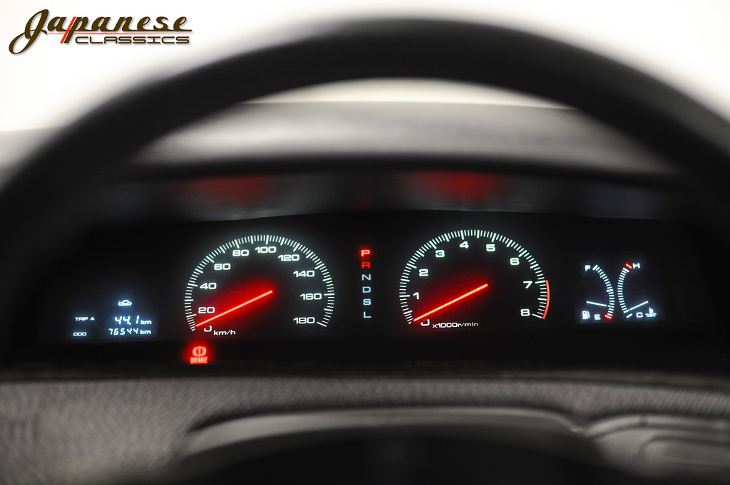

The modern dynamically generated full-motion video type of displays require some pretty hefty hardware and software to function. This is beyond my ability at this stage so I am working out a solution using Arduino and Nextion displays.
I am recreating the original gauges in the car I am converting but obviously some of the original features are no longer relevant. I don't need a "fuel level" indicator obviously, but I do need battery state of charge.
Because I'm not actually in the midst of the conversion process yet, I'm having trouble guessing the sort of info you need when driving an EV.
Below is a list of the things on the original gauge which I can change if I want as it's all graphics based now, but I want to make it Period Correct. As in, what would Mazda have put on the dashboard of an EV if they made one in the early 90's? Around this time digital dashboards were all the rage with Japanese, European and American cars.
Speedo gauge - backlit display with an illuminated analogue needle
Tachometer - backlit display with an illuminated analogue needle
Left Vacuum Fluorescent Display -
- Telephone (no service)
- Air con temperature
- AC auto, full
- Rear defog
- Fresh or recirculating air
- Trip A / Trip B counter
- Odometer
Right VFD -
- Cruise control active
- Fuel level
- Coolant temperature
Turn signals
Warning light strip -
- ABS
- Alternator fault / low charge
- parking brake
- catalytic converter overheat
- low oil
- High beams active
- auto transmission HOLD
- auto transmission POWER
- seatbelt
- door ajar
- rear fog light
- low wiper washer fluid
- radiator (low level or high temp, not sure)
So I'm thinking the Speedo will be the same, though with Cruise control set point indicator.
The tacho doesn't really make any sense so will be changing that to show power consumption/regen level
The fuel gauge will be the same but graphics changed to electrical rather than petrol.
Is the temp gauge useful anymore? Is the EV motor temp something to keep an eye on?
The car phone stuff won't be functional anymore.
My car wasn't fitted with ABS so that light isn't needed but if I monitored individual wheel speed I could implement launch control...
Alternator fail isn't relevant.
I'll keep the parking brake.
Cat temp and engine oil not needed.
High beams on needed.
HOLD and POWER could be repurposed for EV power driving modes?
Seatbelt, door open, fog light and washer fluid will be kept.
Radiator probably not important, but EV's do have a liquid coolant system.
I guess there would be some sort or "WARNING: charger connected" type light.
Key security functions and lights?
So what else would a EV driver in the 1990's need to know?

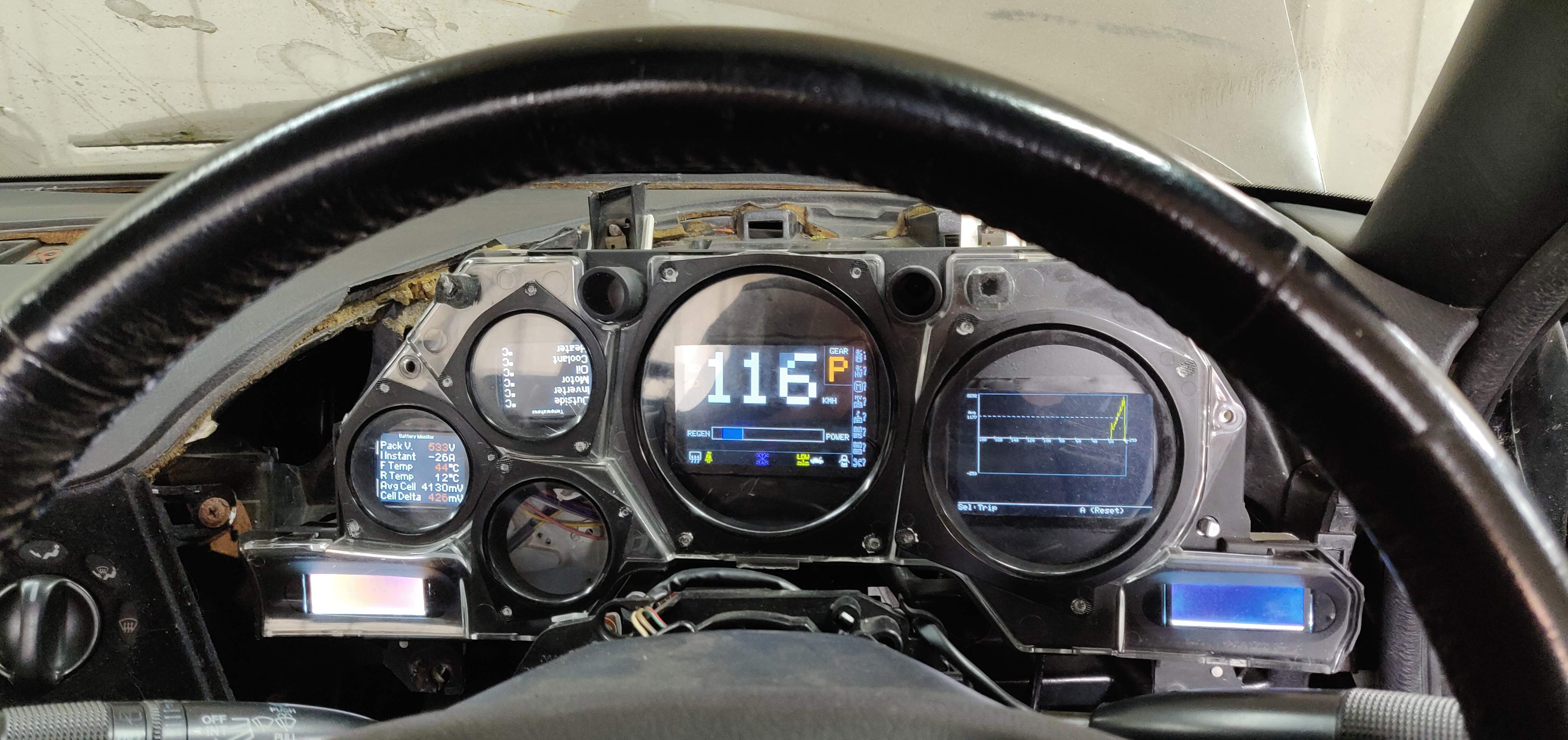

I don't remember what car it was that you were using (Eunos Cosmo, I think?), but for my FD RX7 build, I replaced each of the gauges with a regular small TFT that fits in the circular openings. They all communicate over SPI from a Teensy 3.2, so I do have bandwidth limitations, which can be worked around.
The result is 7 TFT panels in the original cluster, it works quite well, but due to the different size openings, many different products were utilised, each with different controllers, which makes for quite the programming exercise!
I've attached a photo during some of the early assembly, it's progressed quite a bit since then.
Total cost was around £80, including Teensy, displays, PCB fabrication and components. I was able to sell the original tachometer unit from the original cluster for more than that!
I have opto-isolated inputs from all the old car signals (from the old dash warning lights, etc), and CAN for communication with my BMS, PCM, and other controllers. It also gives me the ability to add features the car originally didn't have, such as door ajar warnings, immobiliser integration, etc. Most of the relevant buttons and controls from the original car feed into this.
If you design something similar, I suggest doing the same. Being able to bring car controls into CAN is generally quite useful, and the instrument cluster unit is a good place to do this, as it's well situated and already receives many of these signals in that location.
Even though this cluster isn't finished yet, I'm already looking into a newer version using circular panels. This version with the smaller rectangular panels is just go get the project going. Unfortunately, due to the shape of the cluster (it is concave), a single panel is not an option. Most circular panels only offer a MIPI-DSI interface, so that's a new thing for me to look into!

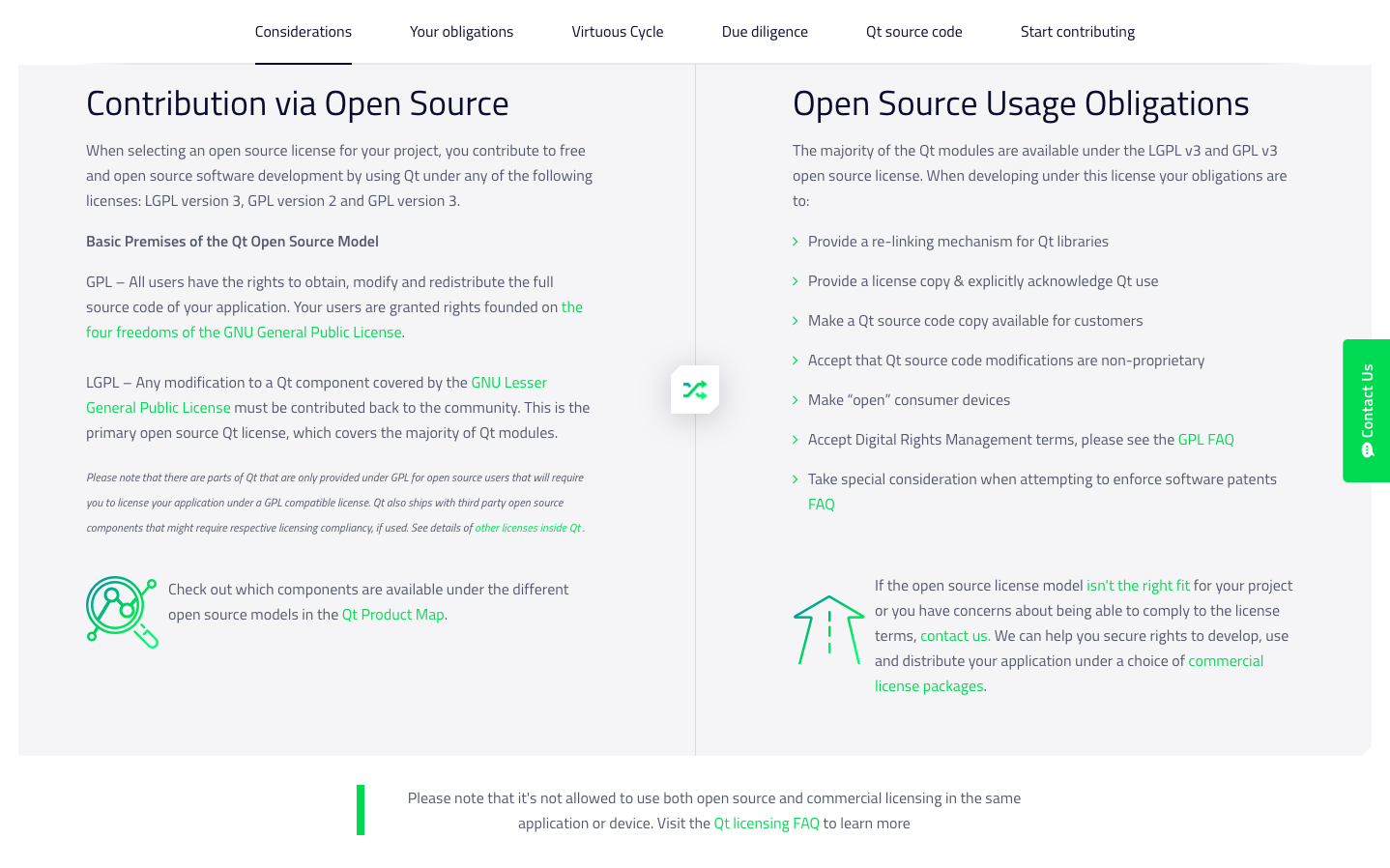

Edit: To answer one of your questions from before, the software he is using is Qt Creator. Hardware unknown.
One thing you will struggle with hardware wise is getting the "instant on" using controllers such as the Raspberry Pi. You'd need to have it powered up at all times and have a "sleep mode".
Tesla use nVIDIA Tegra boards for their instrument cluster and "main screen" (I forget it's name), but details on these nVIDIA products are restricted.
For a project like yours, I'd look at something like the STM32F7, and use its DSI output to drive your TFT via HDMI. See here:
This may be of use: https://resources.qt.io/videos/qtdesign ... al-partone

Original looks like this - - and I am replicating the style

The bandwidth is limited by the SPI bus, yes. I update all of the screens once per second (except the centre screen which I do at 10Hz), but only update values which have changed, and only draw values which have changed, so for example, if my speed changes from 31 to 32kph, I only write the 2. I also instantly update relevant screens if inputs change (warning lights, etc), again only updating the areas of the screen which changes.
For general driving, for the most part, the screens will barely update at all. Temperatures, battery voltage and level, etc, will only change every so often.
I can get approx 30fps from refreshing one small screen constantly, so you can imagine my limitation here!
I have an array of optoisolators, outputting to a MCP23017. Some of these were configured for low side switching, some for high side, I made an educated guess of how many I need of each. This gives me 16 inputs, which was enough. I have I2C broken out on a header to allow an expansion board if needed (I won't).
I just check every input periodically, and write the MCP's pin states to relevant variables. These are used by the program (mostly to draw warning icons), and I can also write them to a CAN frame if I need to (I do this with things such as the parking brake, heater controls, etc).
I also read in 12V battery voltage and interior light brightness directly to the Teensy with an analog input. Yes the display brightness automatically scales with the dash dimmer switch, and I can override this if I choose
Temperatures, battery voltages, speeds, gear selection, etc come in via CAN from other modules, and again I often just decode and display them. I have the ability to set low/high limits for warnings, etc, and I have a piezo buzzer mounted to the board for warning sounds.
I have a graph on the right screen which is a rolling display of previous Wh/km or whatever I choose. It's meant to mimic the ones that Tesla uses. It's all hand-written, and doesn't look all that fancy. Having the graph "scroll" as new data comes in, while keeping bandwidth low, was an interesting challenge.
The board also has an RTC with backup battery (as you know, the FD doesn't have a clock!), and space to add a bluetooth module.
I found that the SAM3X8E chip shares the serial buffer for its UARTs, this means sending diagnostic info over serial can interrupt communication with the GS450h inverter, so instead I send it to the instrument panel over CAN and then spit it out via Bluetooth as a raw data stream. I wrote a windows application to translate this into usable diagnostic info, which mimics Toyotas Techstream software

It is QT and I downloaded and messed around with it a bit. The 1 useful thing I need is the Adobe Photoshop Bridge plugin. It allows you to take your graphic design elements into the QT Creator environment as layered and pre arranged QML files. Unfortunately this plugin is only available to registered users. Registration is about $700 month. Pretty disappointing because the QT stuff looks really powerful and they want people to use it freely. I don't get it.
I have heard this is the only real solution. Have your dash sleeping. Or look for a door open signal and boot up with the screen off and hopefully be ready by the time the key is presented...
I know you can get optimizations from "bare metal" programming and hardcore kernel optimization but that's all Greek to me!
Yeah, I got all excited when I looked at QT and STM32 controllers driving TFT displays. Super slick. But that Photoshop bridge plugin thing is a big hurdle. And I still don't fully understand how you get your QT stuff onto the board you have chosen. It's like everyone assumes you just know already?xp677 wrote: ↑Tue Apr 28, 2020 9:59 pm For a project like yours, I'd look at something like the STM32F7, and use its DSI output to drive your TFT via HDMI. See here:

The optoisolator is to accept any 12v signal from the car. The advantage to the optoisolator is that to whatever is producing the signal, the opto appears as an LED. No need to mess around with potential dividers and worry about current sourcing by the microcontroller.
For signals which switch to ground (door open, etc), some of these still have 12v pullups (eg the door open button is connected to 12v through the interior lamp!) So I still use optoisolators for these. Google "arduino optoisolator 12v" and there will be loads of example circuits. I use the ACPL-247-500E quad optoisolators, because they are cheap and have low current thresholds. I put a 1200 ohm resistor in series for 12V and they work fine. I probably should have used a 1k or slightly smaller resistor.
I do a combination of all 3. For my icons, I hand draw these in Excel and then use an excel macro to output a binary array. For icons which have symmetry, I only draw one half, and then my icon drawing function can look at the size of the array, and if it's only half an image, it will draw a flipped version next to it, examples are high beam (needs top half only), parking brake warning (needs left half only), and sidelights (needs 1/4 only).
For text, I am currently using the fonts which are built into the LCD controllers. I could define my own ACSII fonts, and probably will, but not yet. I've actually gown quite attached to the huge pixelated 5x7 fonts.
I have an Rx7 and Efini watermark logo, for these I converted some picture I found on Google into monochrome bitmaps, then converted this into an array as above. However, due to limitations in the flash memory on my chosen microcontroller, I had to compress these. Not knowing much about monochrome image compression, I wrote my own compression algorithm which basically counts how many black pixels there are, then how many white, etc. These counts are stored in an array which looks something like {50,102,3020,10,200}, I then just output the number of pixels in each cell, advancing the X position as I go, then flip the colour, then continue. I have the image width set, so I reset my coordinates and Y++ after each line.
