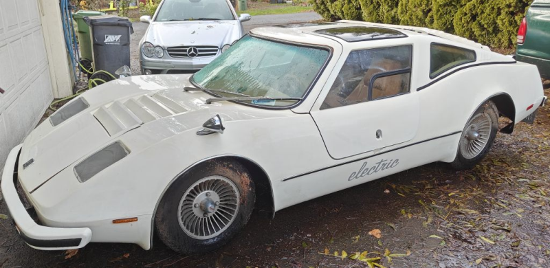

This is supposed to be the shortest path to me actually driving and enjoying an EV. I took a photo of it in my garage, and noticed... it was a picture of 4 unfinished EV projects of the last 10 years. Not very flattering.
Condition so far:
- its 16x 6v lead acid batteries have been dead for 20 years.
- Looks like the previous owner owned it since 1996, but last plated and registered it in 2003.
- The DC motor and, I dunno, the clutch (?) has been removed, it's present, but not installed.
- The parking brake was partially seizes, has loosened up a bit.
- There is a fantastically /r/casette-futurism programmer or something attached to a cable.
- Driver's door doesn't appear to lock.
I had two nightmares getting it home, so, just having it safe in my garage and letting my heart rate recover is my plan for now.

First steps...

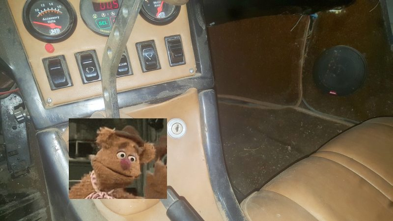

- Vacuumed it up and wiped it down. Inventoried all the loose bits inside.
- Driver's carpeting is gone. Passenger's carpeting looked perfect, but had zero integrity, disappeared into dust anywhere I touched it with the vacuum. Presumably the backing is gone. It's very 70s, poofy brown, like someone skinned Fozzy. Not quite shag, but not like proper automotive carpet. I wonder how I'll replace.
- I don't know what that key does. I don't have a key that matches it. It's not the ignition, door, or either of the rear releases.
- I gave it a new 12v battery to see what happens. The center gauge is active no matter what, I think it's main battery indicator. Voltmeter works.
- 5 switches across the dash.
- Popup headlight switch does nothing I can tell, as the popup headlights are just shielded now.
- Headlight/bright switch works. Headlights are blue, brights are white.
- Hazard lights don't seem to work, maybe 1 of the lights total, makes weird noises, weak pulses, etc.

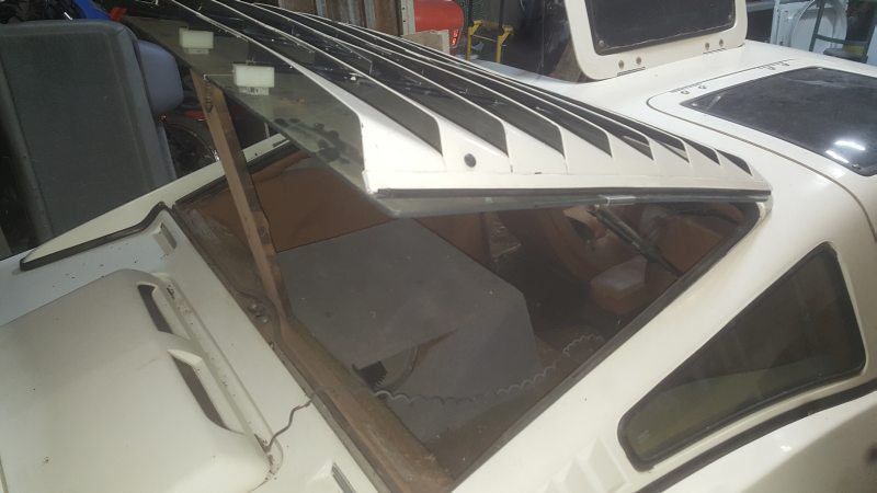

- Wipers. Umm.. the wiper blades overextend the windshield both top and bottom by 2". And the motors are so weak they don't move without help.
- Heater switch. My car did not follow directions. The original owner specified not installing console ventilation or heaters. But a fan does turn on for 2 defrosting vents.

- The previous owner installed rear louvers, like I'm driving my Trans Am to a Whitesnake concert. They prevent the hatch from opening very far:

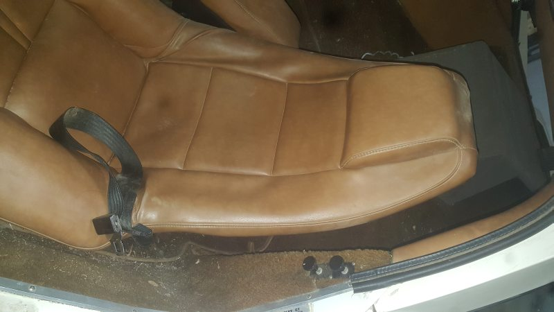

- There's room for a back seat, the VW Beetle it's built on had them, but there are no seats. Maybe too short. Tons of inaccessible space behind the seats. So the previous owner put a bitchin' sub and amp back there. Shocks won't hold the door open, so stick is used.

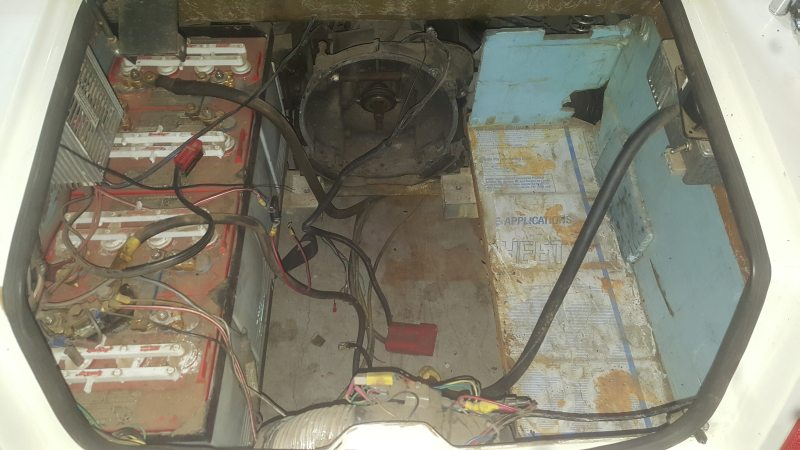

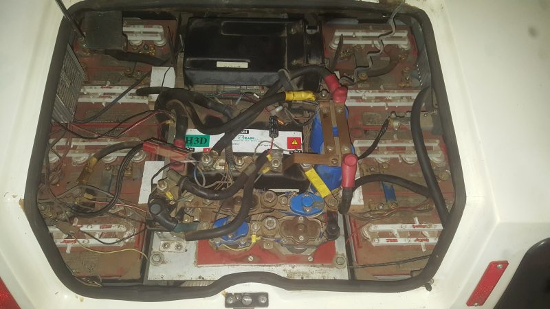

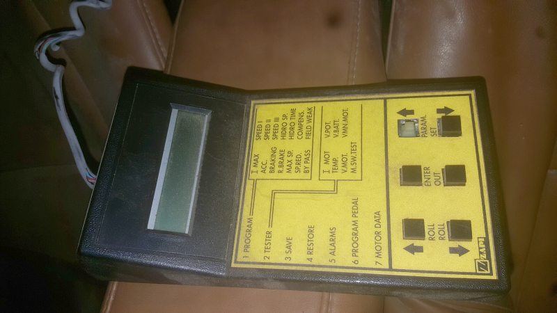

- Got the trunk/engine compartment open. Inside is an Italian ZAPI speed controller. Apparently, the kit was sold with an EV1 controller, documented, then the documentation regularly refers to how it doesn't have this controller, it uses a different one more suited to passenger car operation. Not sure which this one had originally, but the second owner replaced it in 1995 with the ZAPI, which was I guess an 800 amp controller? More on that later, it blew up constantly, like, weekly, and to get service on it the previous owner hand-wrote and mailed letters to Italy to try to get it resolved. It's still what's in there.
- The ZAPI has a fantastic 1980s remote... programmer? Look at this time capsule. OpenInverter ESP8266 interface eat your heart out. It's permanently attached, the wires get pinched by the trunk seam, the hatch seam, and then a long coiled phone cord-like girls chewing gum loudly and drowning in hairspray would twirl around their fingers. Why does it have a 15 foot long cord? Are you supposed to operate this while driving?:

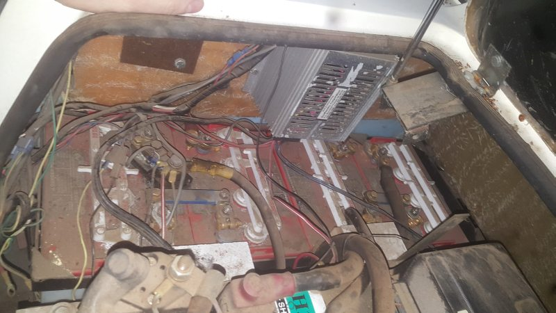

- It has a DC-DC converter from TODD ENGINEERING SALES INC, no specs or model name. I emailed them (maybe them, who knows if it's still the same company). That's the thing on upper right:

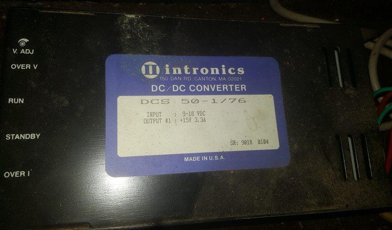

- Speaking of DC-DC converters, it has another one... in the passenger footwell. 9-18vdc input... 15v 3.3a output. Huh? A DC-DC converter to... very slightly increase the voltage to 15v? Why? Maybe for the stereo? I'm so confused:

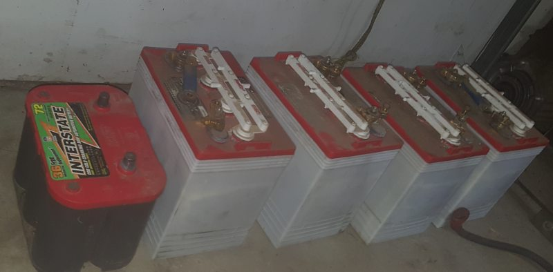

- Stay on target. I disassemble a few wires unscrewed some impossible-to reach bolts a 1/6th turn at a time, removed the battery holddown clamp, and took out one of 4 battery banks:

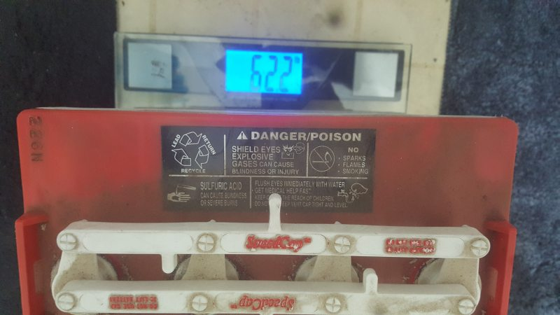

- I'm leaning way into the trunk to grab them, and, wondering why I'm so weak I can barely lift a car battery with my fingers. It's not a normal sized car battery. They're tall:
- AND HEAVY. 62.2 lbs?:
There's 16 of them total in the car. THERE IS 1000 POUNDS OF GODDAMN BATTERY IN HERE!
I took out that one side only, and the car was noticeably tilted to the driver's side. I measured the wheelwells. The right side is 1.5" higher than the left, after 250lbs of battery got taken out.
Y'know, in most EVs, battery space and weight is a serious consideration. On the GTE, Jesus, I don't think I could even add 1000 lbs back in. Lots of extra room in the "trunk", but, the worst possible weight distribution. All the batteries are behind the rear wheels, or in front of the front ones. Meanwhile a non-existant and inaccessible back "seat" (not a seat) and luggage rack area.
Oh, and, the previous owner bought and installed 8v batteries for 128v nominal, versus the stock 16x 6v batteries for 96v operation.
