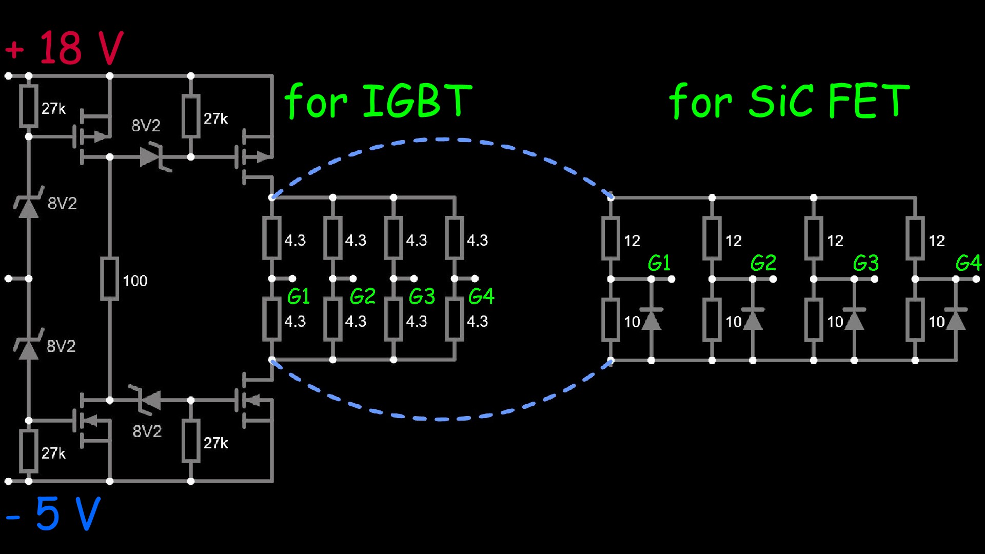

What I can say for now is, that the gate resistors are smaller in value. For IGBT it's 4,3 ohms and for SiC it's 12 ohms because IGBT gate charge is A LOT more than SiC FET. Typical x3 for similar devices.
And gate voltages are -5V and +18V for the IGBTs. Here i think it's the same as SiC.

I've made a little "schematic" to compare the gate drive stage between IGBT in front drive unit and SiC FET in rear drive unit. Left side with the transistor stage is both the same. Midpoint between the two 8V2 zeners goes to gate drive IC output. After that IGBT has 4,3 ohms gate resistance to low and high side of the driver stage. SiC FET has 12 ohms to high side, 10 ohms to low side and a diode in parallel. Seems to be a classic silicon rectifier, ultra fast type. Maybe to prevent SiC-gate from negative overshoots, larger than -5V plus forward voltage of the diode.
