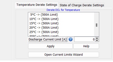

I'm looking for some advice on the current limits that I should put in the Orion BMS for the Cobra I have built. It's Tesla LDU, 12 Tesla 5.3KW Modules (300V), Openinverter logic board.
At the moment if it is accelerated very hard uphill the Orion BMS is logging a P0A07 fault (Discharge Limit due to temperature) and power is cut completely. I haven't altered the temp limits (just pulled from entering the Tesla module profile. The temp limits are currently: -20=0, -15 = 100, -10 = 200, -5 = 300, 0 = 400, then 5 to 40 degrees is 500A, 45 = 250, 50 = 0. The car owner doesn't drive it anything as aggressively as I have and has never exceeded the 500A limit so the problem hasn't manifested before.
I'm wondering whether I can safely increase this 500A limit. I have 600A fuse in the battery box but had thought that I could probably safely exceed that for short periods.

johu wrote: Wed Apr 30, 2025 5:30 am?
Hi Johu,
Sorry, I'm maybe not being clear. In the Orion BMS in Discharge Limits, there is a dialogue box for temperature derate settings. See pic attached.
I didn't enter these settings, I assume they are pulled in when I told the BMS I was using Tesla Model S 5.3KW modules.
So my question really is, what should the a reasonably safe discharge limit be for my setup and how should they be affected by temp? I think Tesla say that the modules are good for 1500a for short bursts, I've seen 750a in other searches. My setup described has 600a fuse, 12 x 5.3 Tesla modules, LDU.

It's not that I'm exceeding a temperature it is that I'm exceeding the current limit at any given temperature on that temperature derating setting.
Hypothetically if I set maximum discharge limit to 750a, I'd then also set the derating to 750a between 5 and 40 degrees?
Does 750 sound reasonable for model s module?
Cheers
