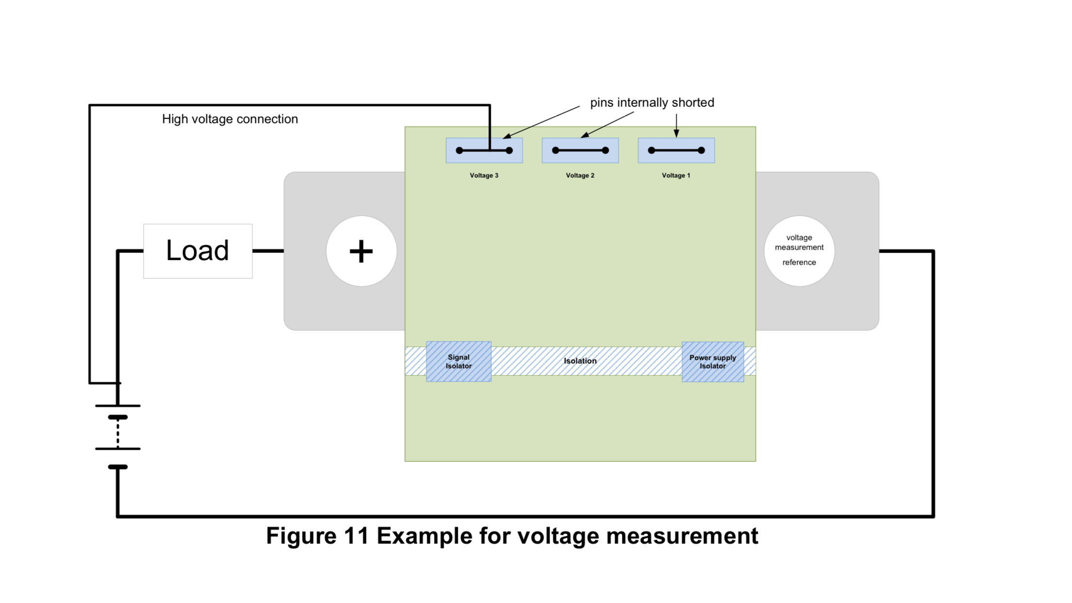

Posted: Sat Jun 06, 2020 3:22 pm
by james@N52E01
Just a quickie, My IVT-S just arrived and I’ve rigged it up to DM’s Leaf VCU board running V1.5 firmware.
The board communicates with the ISA Shunt through the ISA.h file. The only version I could find of this file is from EVTV But it had some issues with it:
http://media3.ev-tv.me/ISA.zip
I tried editing the file by replacing “ISA2.h“ with “ISA.h“ Within the code but I might be using the wrong file.
Does anyone have a correct version of ISA.h to work with the IVT-S shunt please?
Re: Isabellenhütte IVT-S shunts available
Posted: Sat Jun 06, 2020 3:37 pm
by Kevin Sharpe
james@N52E01 wrote: Sat Jun 06, 2020 3:22 pm Does anyone have a correct version of ISA.h to work with the IVT-S shunt please?
Damien kindly sent me the following information recently... I haven't used this myself but suggest as a group of ISA shunt users you pick it up, run with it, and update the wiki :)
From the factory the isa shunt does not output many parameters and not in a format that is readable to the library. It defaults to big endian and the arduino is written in little endian. Fortunately, friend Jack at EVTV took care of that and installed a configuration option in the library. To use the shunt the following steps are required;
1) Load up the demo sketch on a due with a can transciever or any of the VCUs.
2) from the menu choose the initialise option.
3) Reboot and normal data should be pumped out.
ISA.zip
(8.55 MiB) Downloaded 1005 times
ISAScaleTest_dm2.ino.zip
(2.51 KiB) Downloaded 862 times
Posted: Sat Jun 06, 2020 4:06 pm
by Kevin Sharpe
james@N52E01 wrote: Sat Jun 06, 2020 3:22 pm Just a quickie, My IVT-S just arrived and I’ve rigged it up
Some comments on the photo;
(1) you have a red twisted pair cable going to the shunt voltage measurement pins. Can you confirm these wires are shorted together not from different voltages?
(2) It looks like you have a CAN termination resister installed. Is this on the two centre or two outer pins? It's not clear from the photo.
(3) Can you confirm you have the ISA Shunt without internal CAN termination? I don't know what part was supplied to you.
** recommend you test at low voltage and with current limiting resister to begin ;)
Posted: Sat Jun 06, 2020 4:30 pm
by james@N52E01
1) yes the voltage measurement wires are twisted just to keep them out of the way but they both go to the same point as per the wiring diagram.
I believe they are internally shorted so I’ve just used 2 for redundancy.
2) The 120R CAN Termination resistor is across pins b & c (the middle 2) which I believe are CANLo and CANHi according to the manual.
3) Yes this is a non-terminated CAN shunt. The model number on the shunt is IVT-S-1K-U3-CAN2-12/24.
The CAN2 means non-terminated according to the manual.
Good call on the current limiting resistor, I’ve gone for a 12v bulb.
