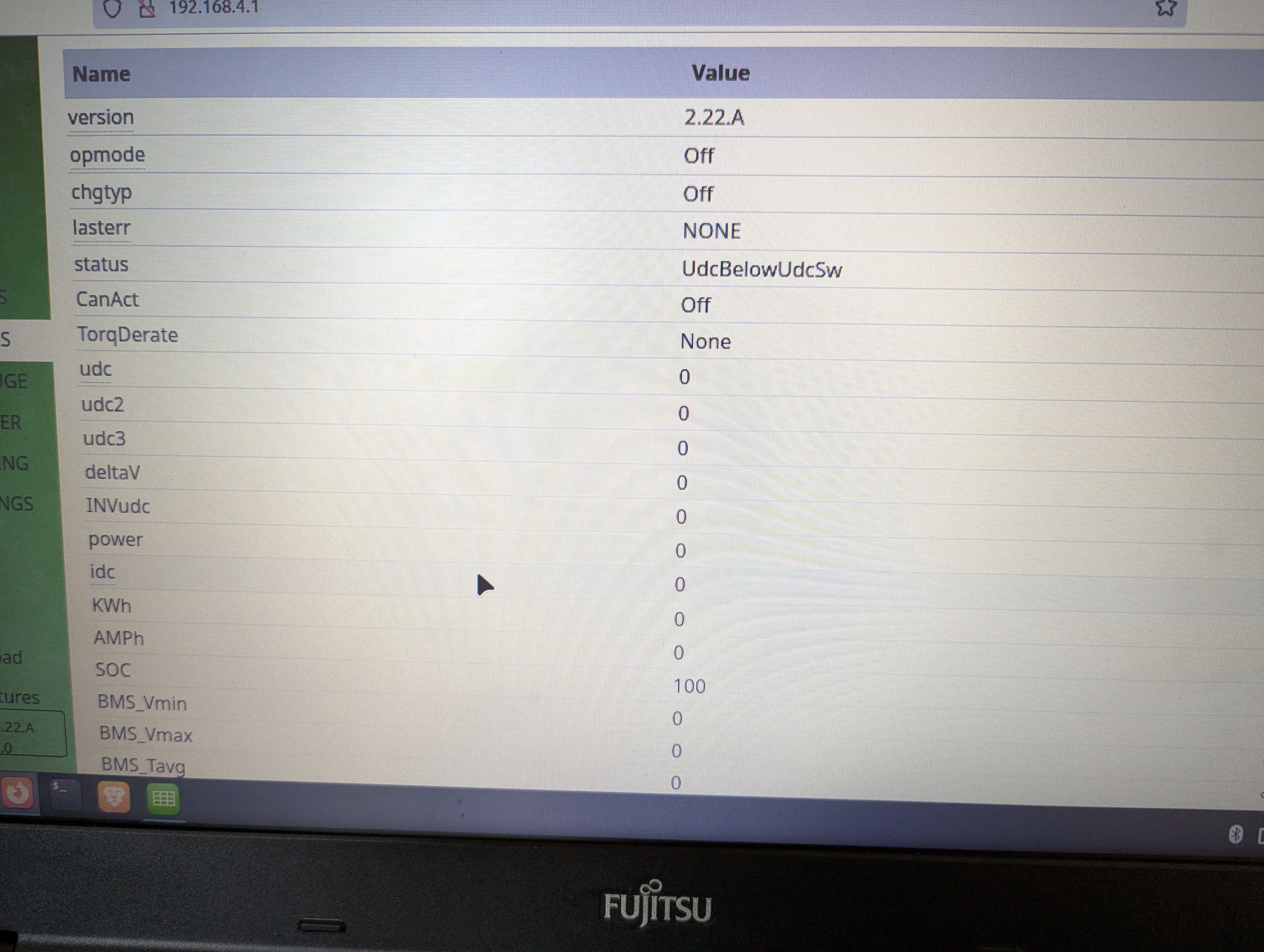

Firmware is 2.22a web 2.0, Damien only shipped it a couple of weeks ago.
There are no errors but also no voltage showing on UDC even though I had a 20V battery connected to the ISA which was working fine with the Leaf VCU.

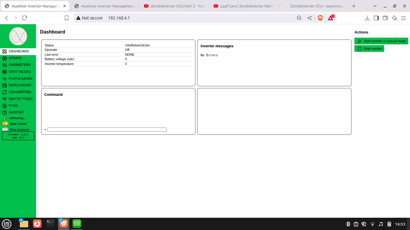

This screenshot was taken while the VCU was powered off but I don't think it has changed.
params.json
(2.14 KiB) Downloaded 104 times
I put a meter on the outputs but didn't get a GND on any of them.

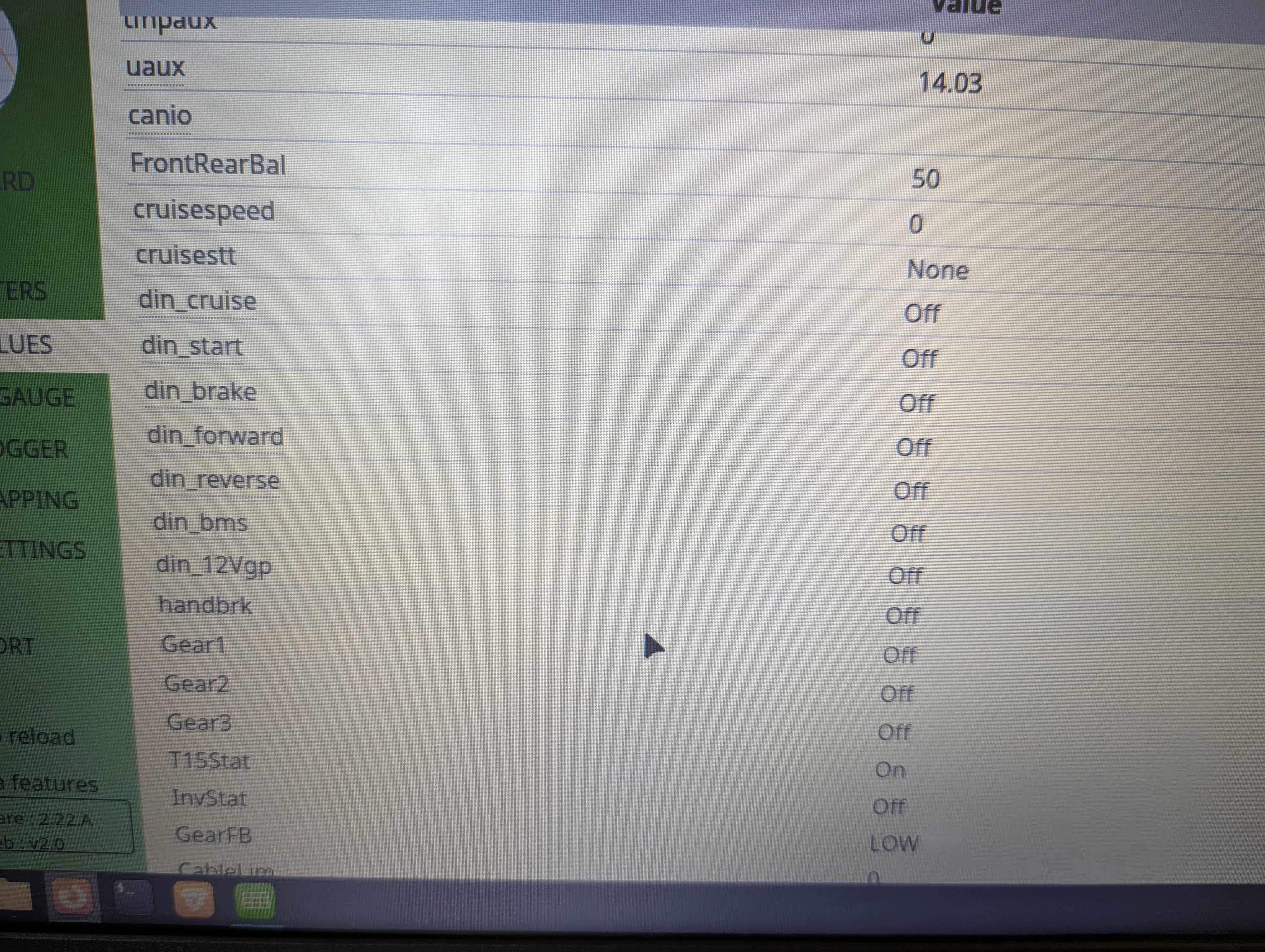

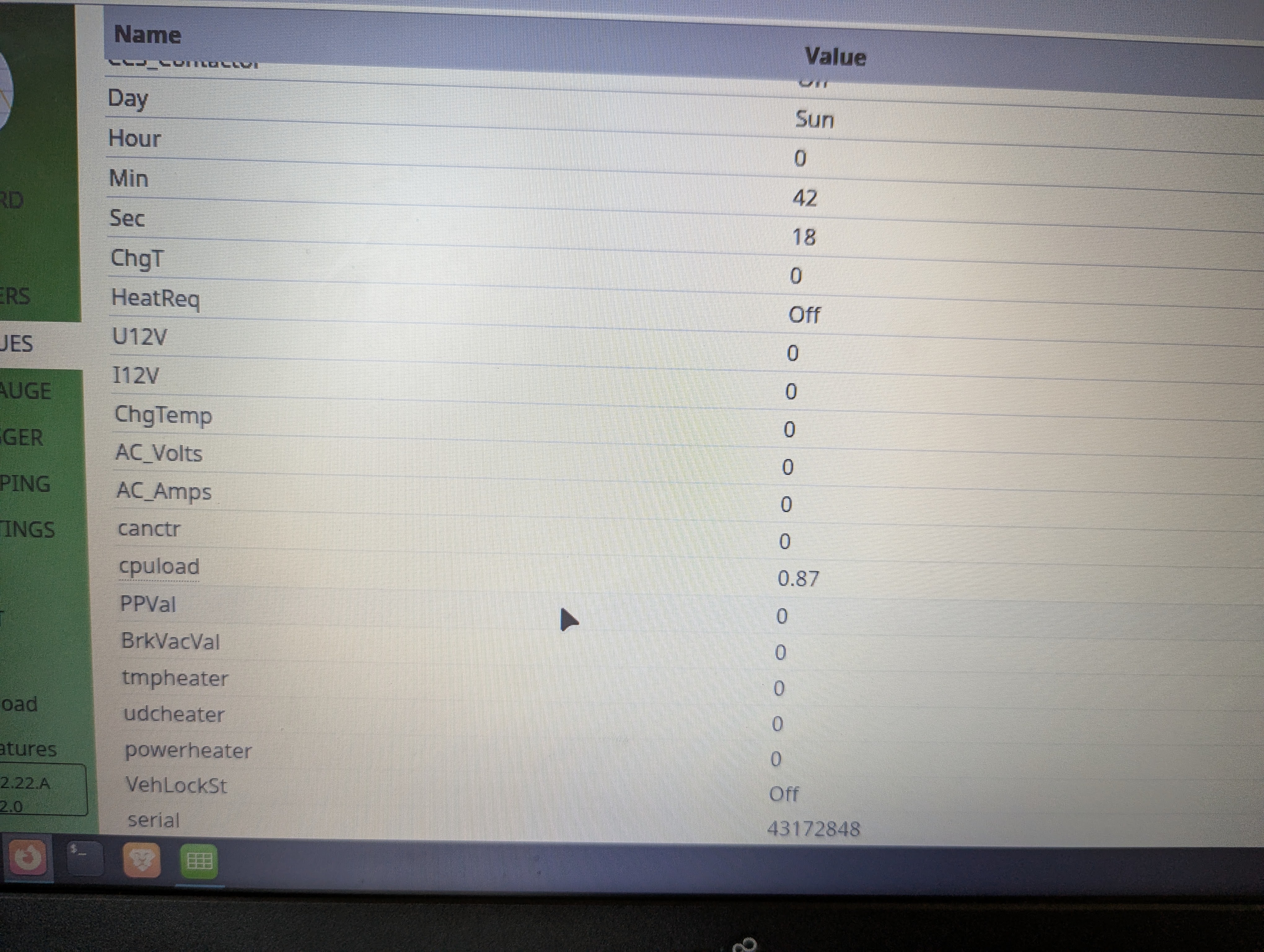

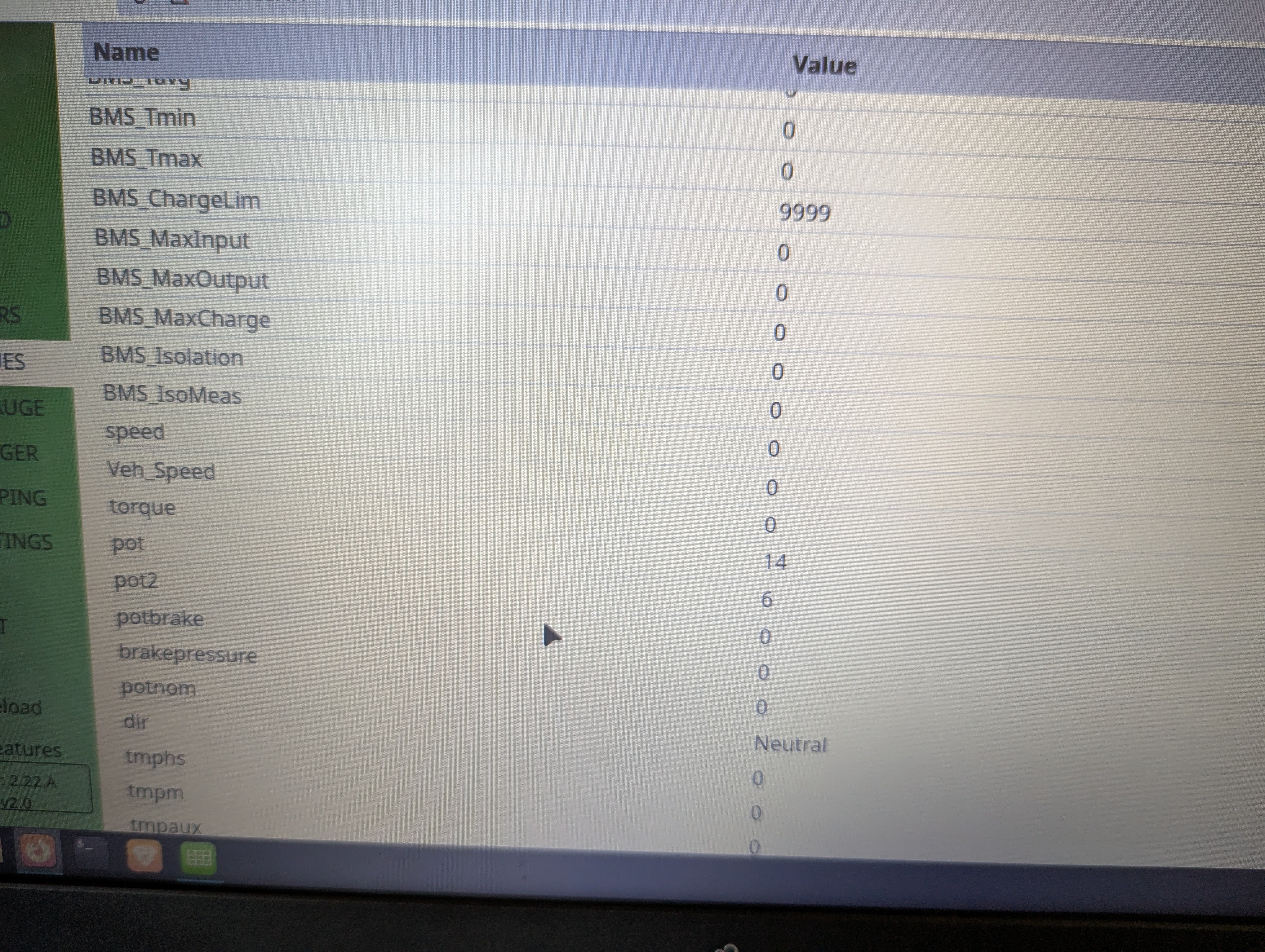

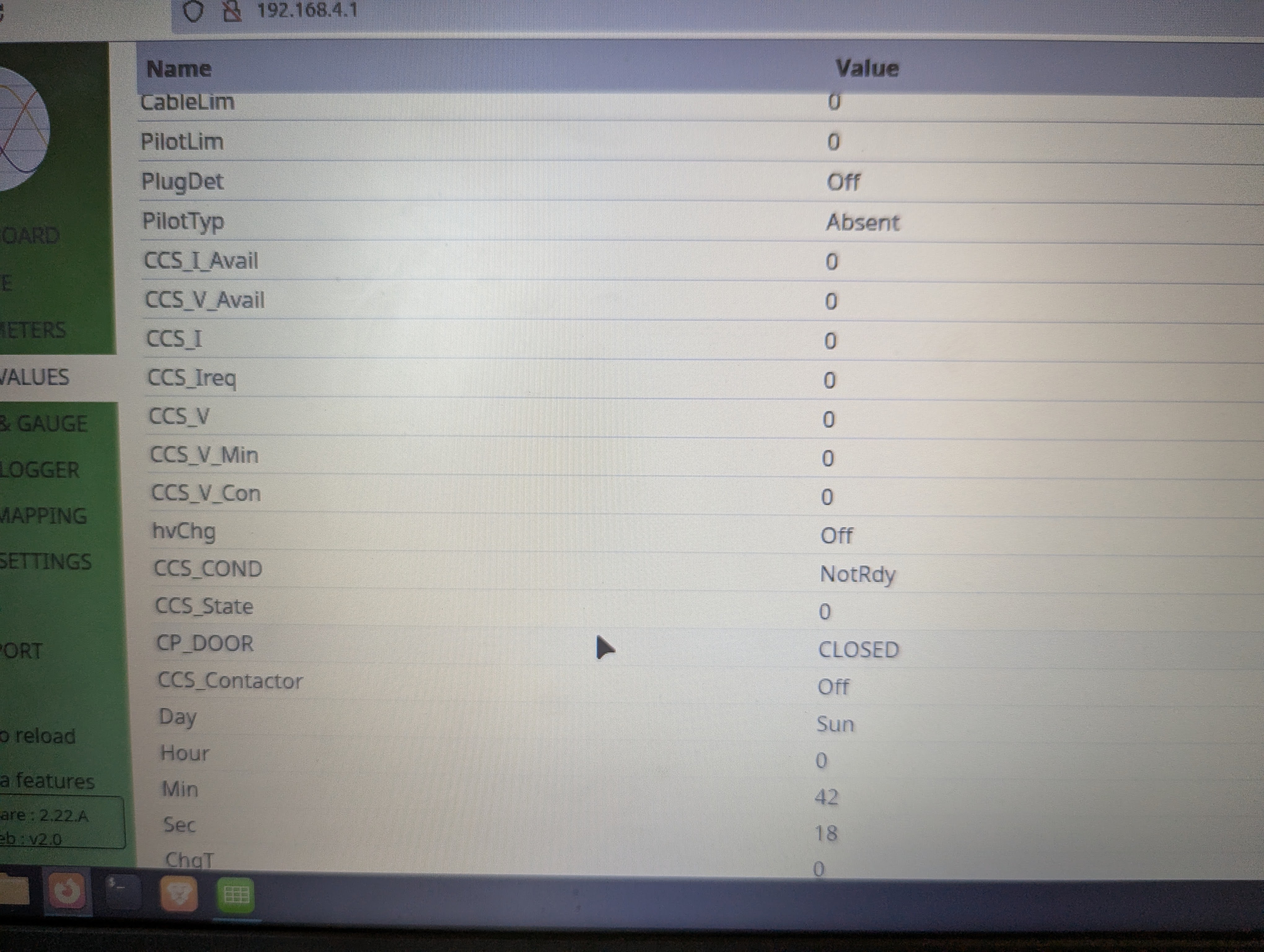

Re: New Zombie user not getting LS outputs.
Any errors in the spot values?
Please post all your spot values.
You double check all your inputs are showing up as they should?

No errors but I see T15 status changing as I flick the switch on and off
