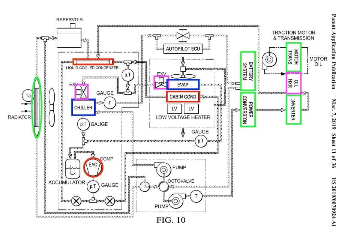

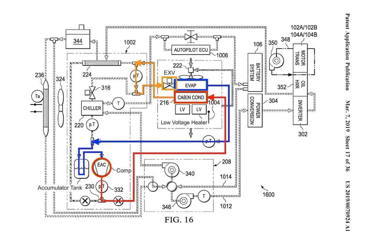

First, I will show the main operating modes of the system.
Component introduction
Compressor as a heater
Water cooled cooling
Ambient air source heating
Battery system drive train energy recovery
Posts: 2962
Has thanked: 328 times
Been thanked: 847 times
Re: Tesla Heat Pump System Hacking
Sure but that is the patent diagram.
This your source? https://aircondlounge.com/how-tesla-heat-pump-works/

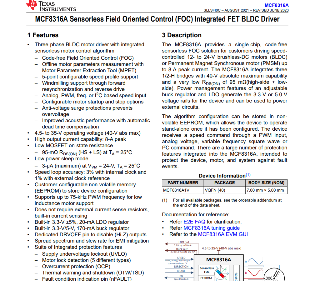

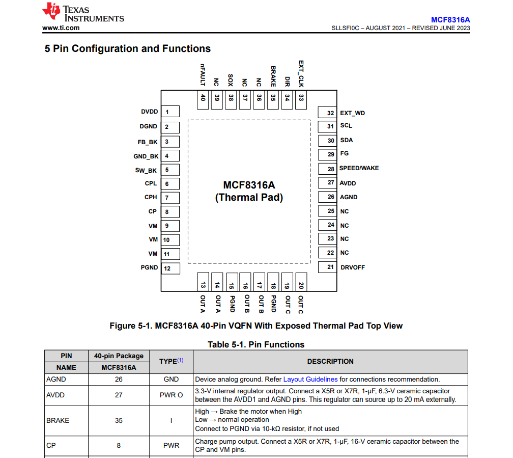

For water pumps, he uses bldc drivers with integrated FETs MCF8316 series with the peak current up to 8A, which seems insufficient if compared with what the professor claims (15A peak for each pump at max 6000 rpm)
Tesla uses drivers with external FETs, and apparently this is done for a reason. I know it's in the old VCFRONT from M3, but most likely they didn't change anything in further versions.
It's understand that a driver with integrated FETs looks more elegant and I like this solution more, but it's unknown how long they will handle the pumps.

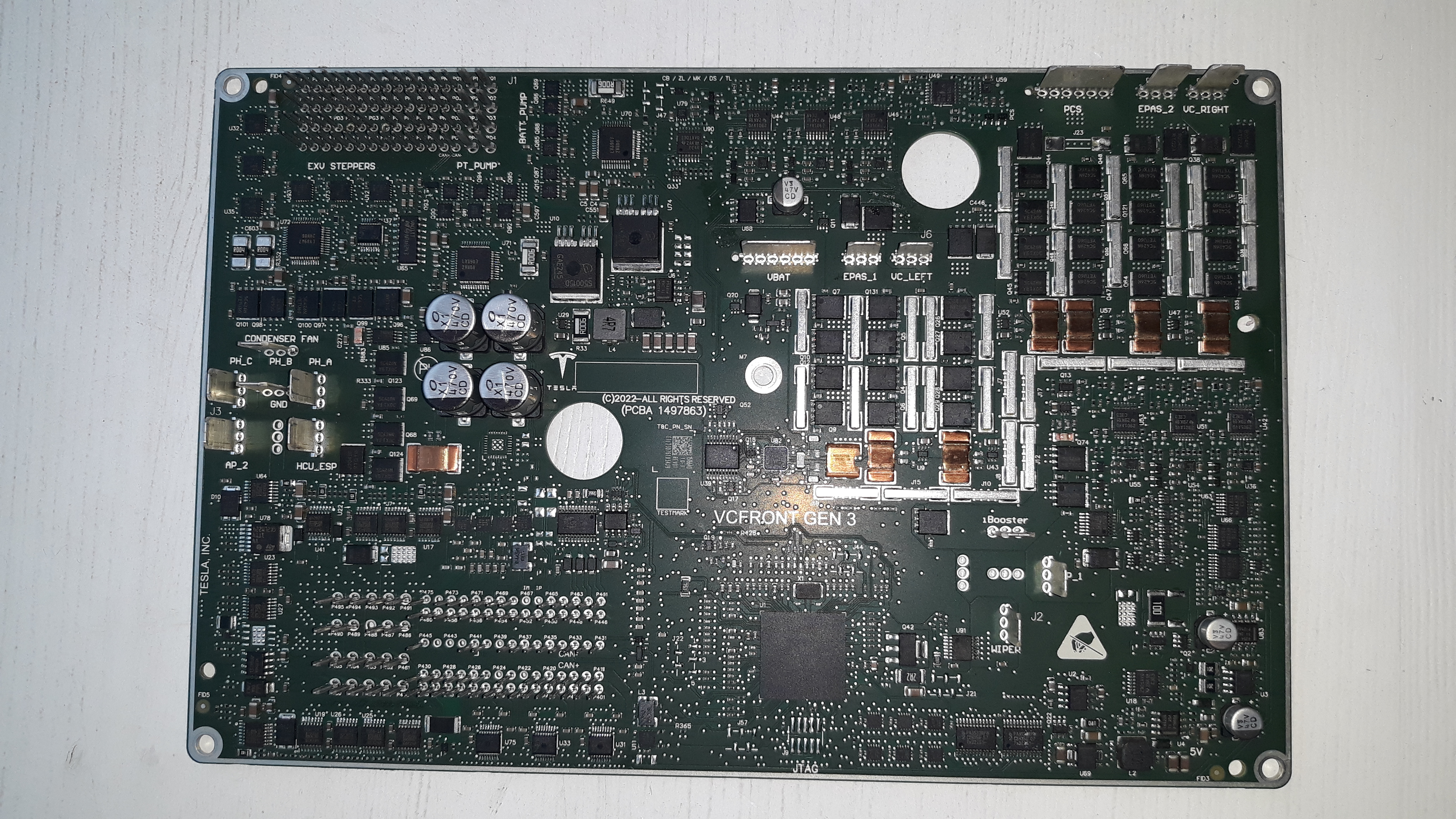

Most likely I'll have to buy VCFRONT from fresh M3/Y, tear down it and then reassemble on a custom circuit board taking only what is responsible for the heat pump controls 😁

You can always cobble together something like a VSEC or other hobby bldc controllers to run the pumps. Those TI chips do look mighty fancy though and would yield alot finer control.
Key thing to make sure in the repurposing is to ensure you do not end up with alot higher flow restrictions compared to a tesla setup. Also the radiator sizing will be key to this setup to be able to reject the heat from doing cabin AC.

What's the danger? Will it burst? By the way, I found almost brand new VCFRONT from 2023 MY for $100. Maybe I'll take a chance and buy it.

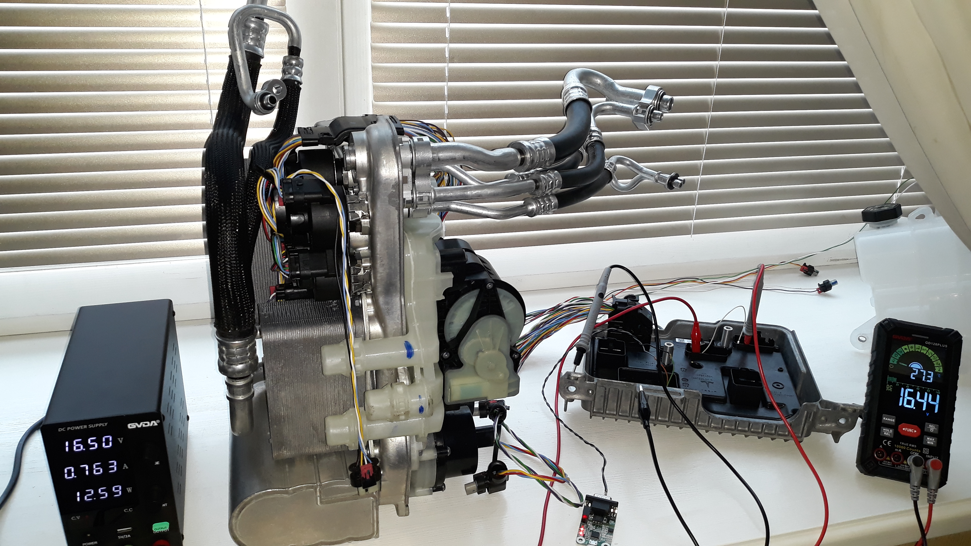

I think there is no point in making a custom controller when everything works on its own. But I'll play with the can for a while.
dimonlipko
Posts: 47
Joined: Thu Apr 02, 2020 9:28 pm
Location: Ukraine, Kiev
Has thanked: 7 times
Been thanked: 11 times
Re: Tesla M3/Y Heat Pump System Hacking
Post by dimonlipko »
Good progress! Write me in TG (@DimaLipko), I can't found you there, I can help you with CAN.

Tesla M3/Y VCFRONT gen3 pcb
