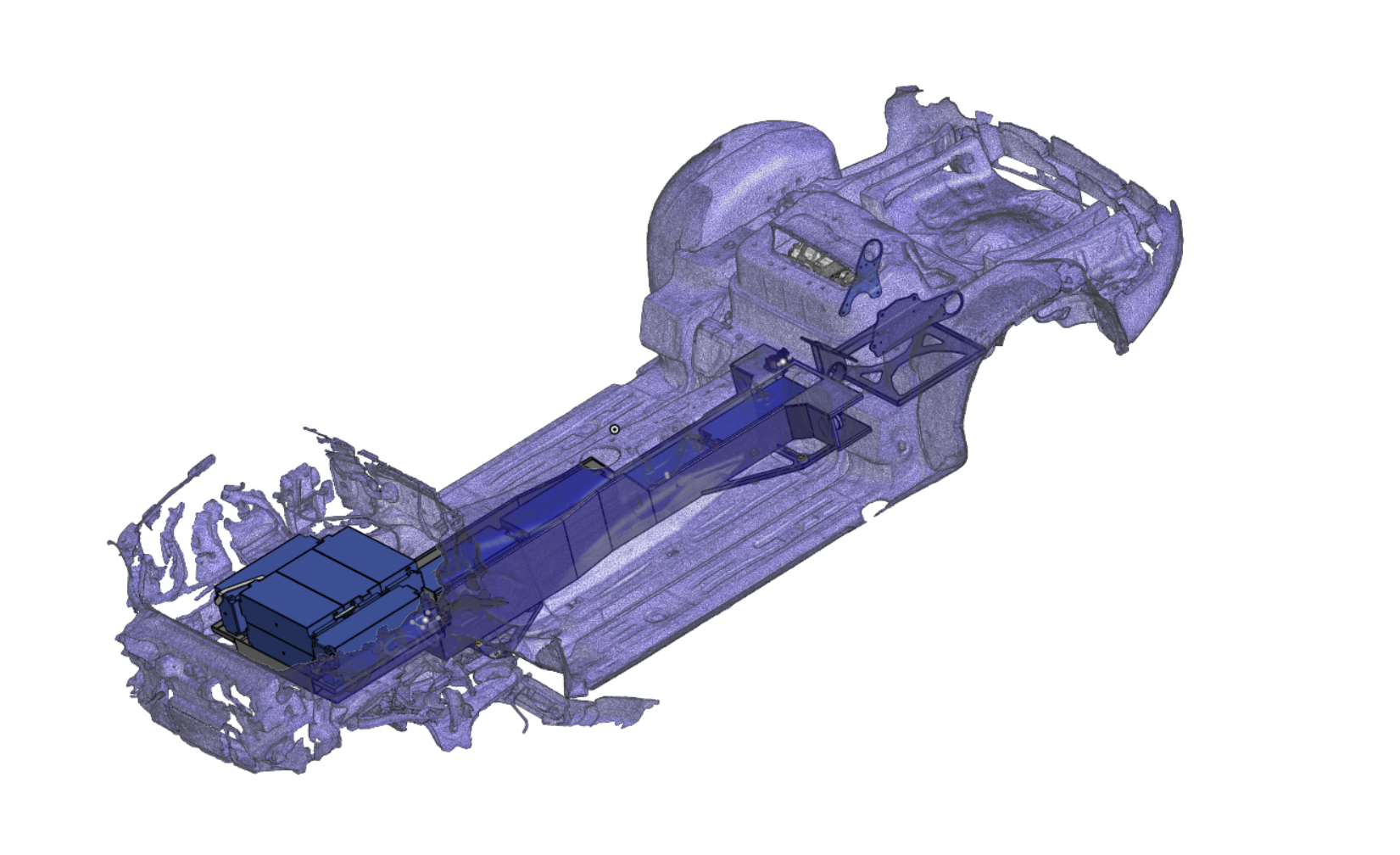

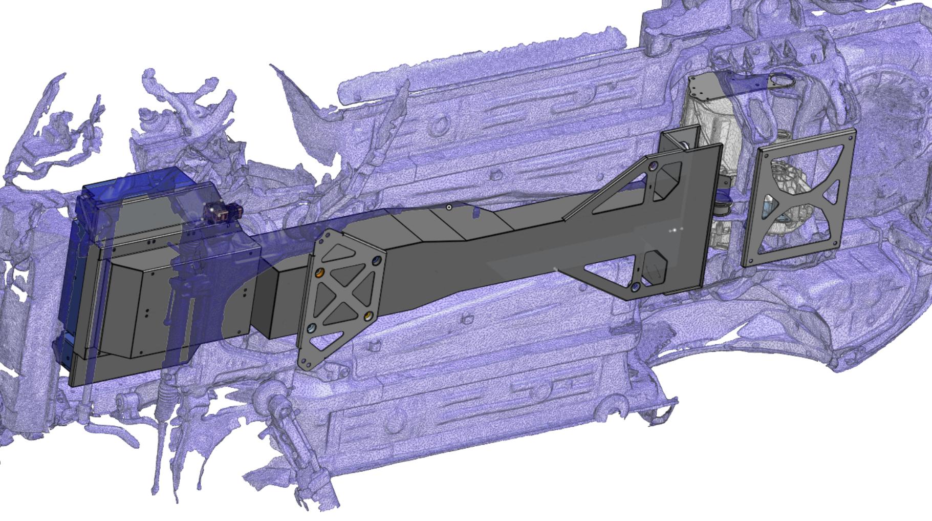

Been busy at work, but also spent a lot of time in CAD on the battery box designs. This is what I've come up with so far:
Most of the time has gone into making the pack as low and not-front heavy as possible.
They are two seperate boxes that will be connected with connectors. I'm now deciding where to put these and all the other components like contactors and relays. The front box will have a service disconnect at the front so I can have the positive and negative contactor in the rear near the motor. Controlling these with the OI drop in board seems to be the easiest, but I'm not sure how I would go about closing the contactors when I want to charge. If anyone wants to share how they have done this with their OI board I'm very interested :)

arber333 wrote: Sun Nov 09, 2025 3:28 pm Really impressive build!
When I was converting my Mazda MX-3 i came across some people trying to convert Miata MX-5. I think from Australia. We had a debate about Mazda using transmission as a carrying member against chassis twisting in the turns. That would explain the lightness of the chassis... They said if they removed transmission car would feel like it would fold on itself...
I guess I would recommend you setup your battery box in the tunnel to resist chassis warping as well. Just relaying info...
Yup you are right, its called the PPF, power plant frame. This basically makes the engine, transmission and differential one solid unit. However, the ends, the engine and diff, are mounted in rubbers, so it probably doesn't do much for chassis stiffness. It does resist twisting of the driveline under load to get a more responsive throttle feel. PPF delete kits do exist aswell for people that swap to different gearboxes or diffs. Atleast, that is what I make of it haha.
I am designing the box to add a lot of chassis stiffening though, like people do by adding reinforced frame rails and even butterfly braces. Most of it is based on my intuition though, not maths :lol:
