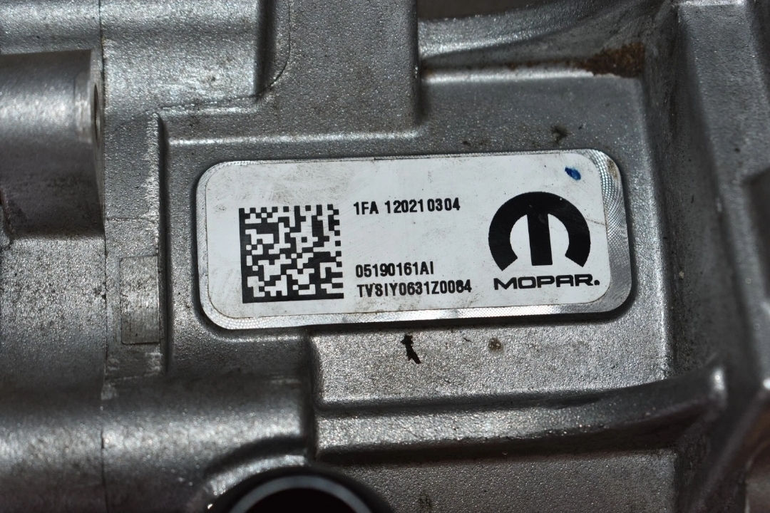

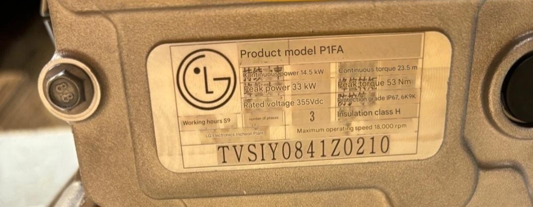

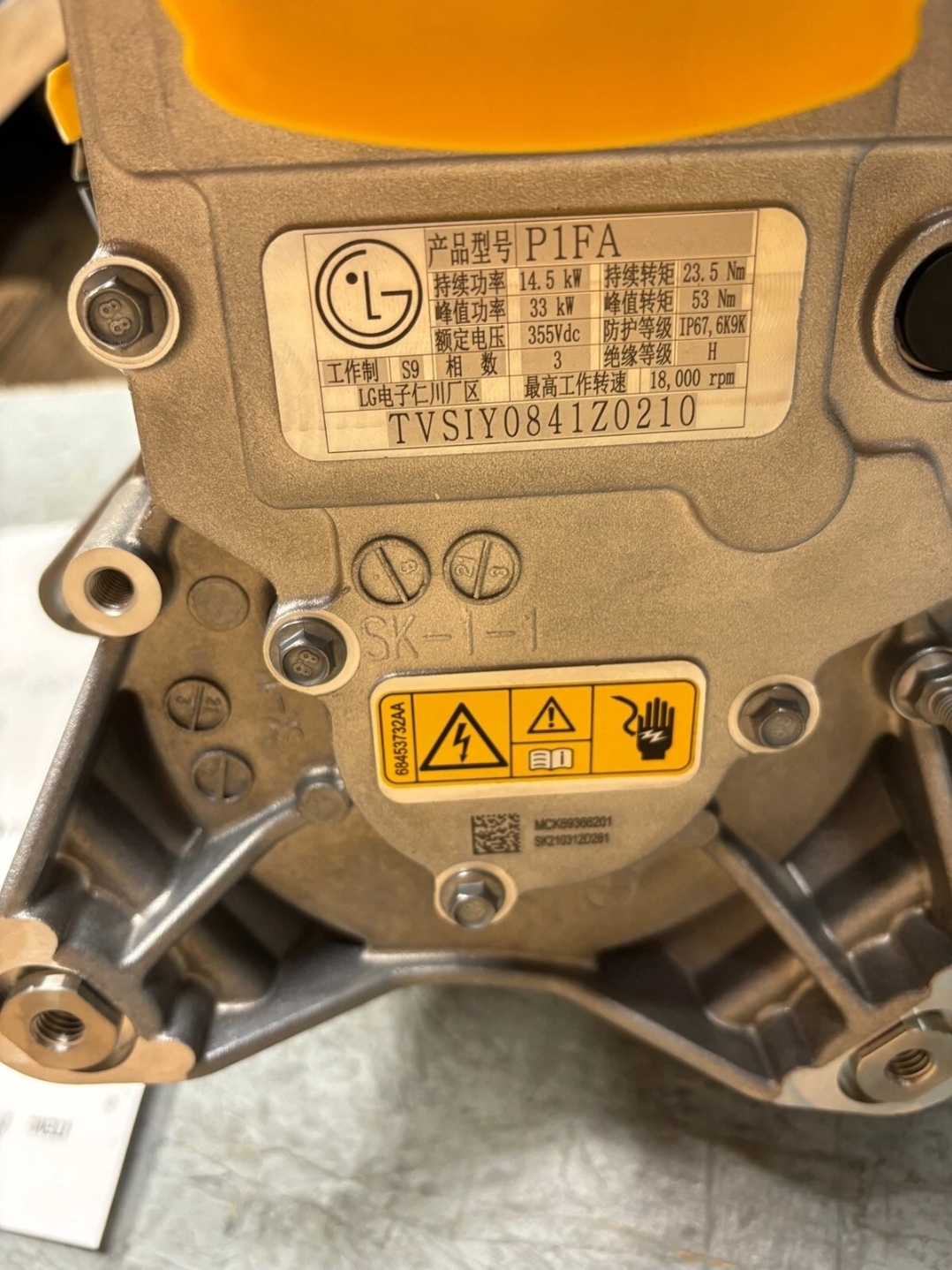

Did you find if they rated the power at the motor / generator shaft or at the geared down crankshaft? Marketing likes to play with numbers where they can.
Jacobsmess
- Posts: 871
- Location: Uk
- Has thanked: 545 times
- Been thanked: 153 times
Re: Testing Jeep Wrangler 4xe P1 Motor-Generator (LG HV “Alternator”) with OpenInverter

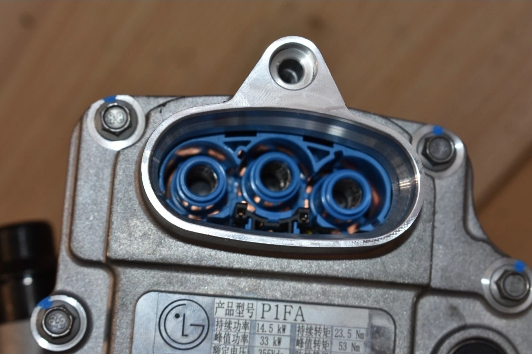

Power and torque are printed on the motor label in the images.
