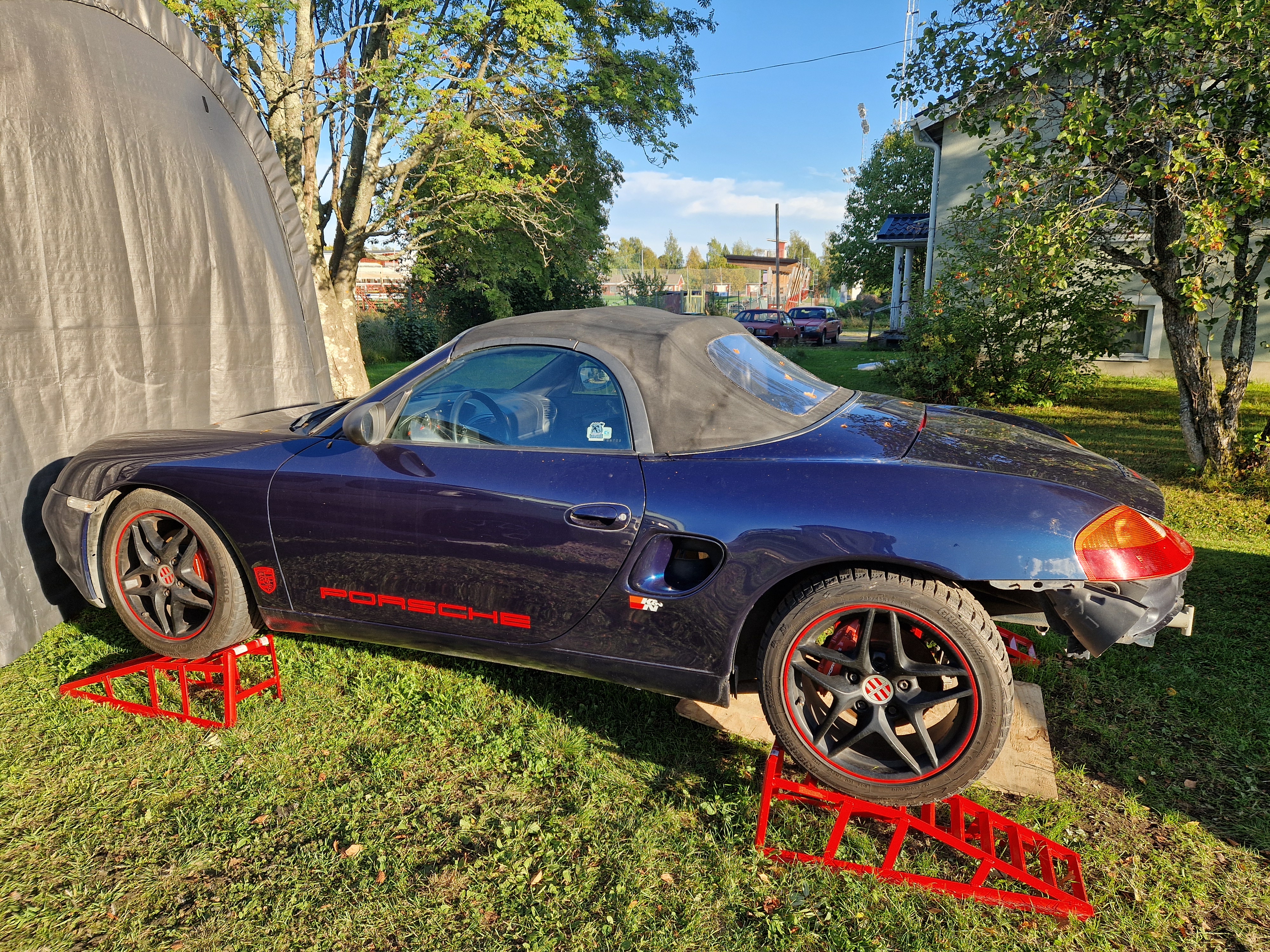

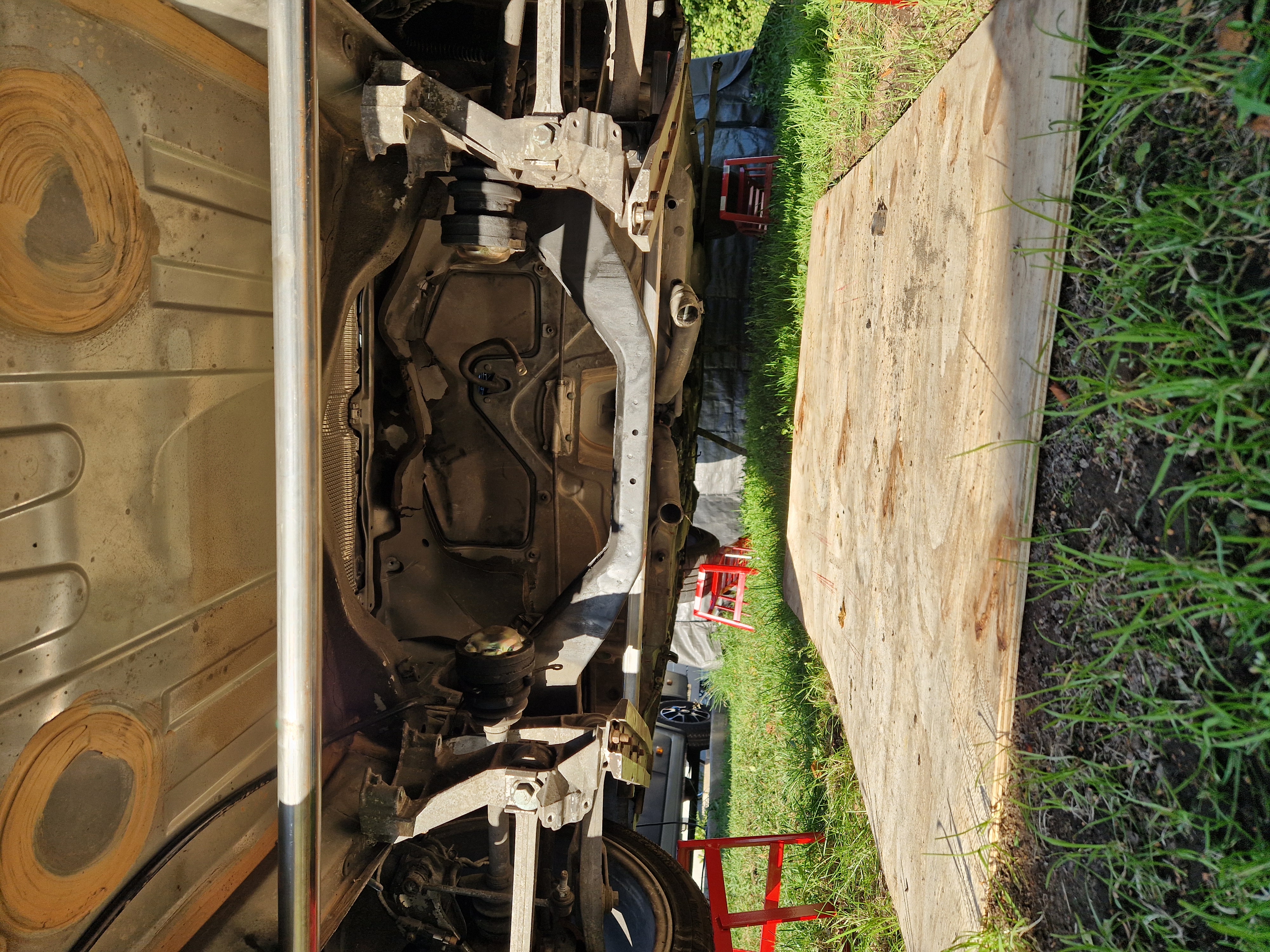

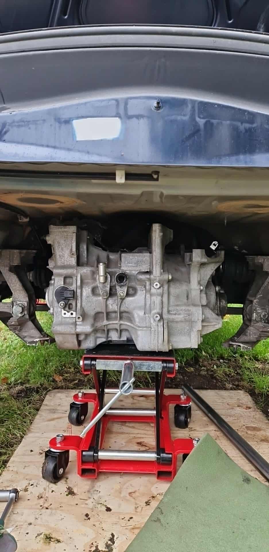

So Boxsters have been converted to electric by many people by now and most of them has gone with Tesla motor. I have chosen to go with a complete 160kW Leaf stack. Sure it does not have the power of a Tesla but it's still more than my car had with ice. Haven't got the battery yet but aiming for a 40kWh.
Have some more parts to remove before I mount the motor and all the other stuff

If anyone has files to 3D-print covers for gen 3 Leaf motor, inverter and pdm I'm interested as I have to split the units

Gen 3 motor is the same as the gen 2 i believe so you can probably find those. I think Brat has dome some as well as EVLandcruiser and some others were posted on the DIYElectriccar forum
