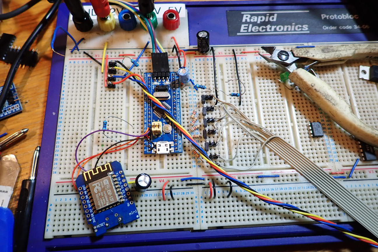

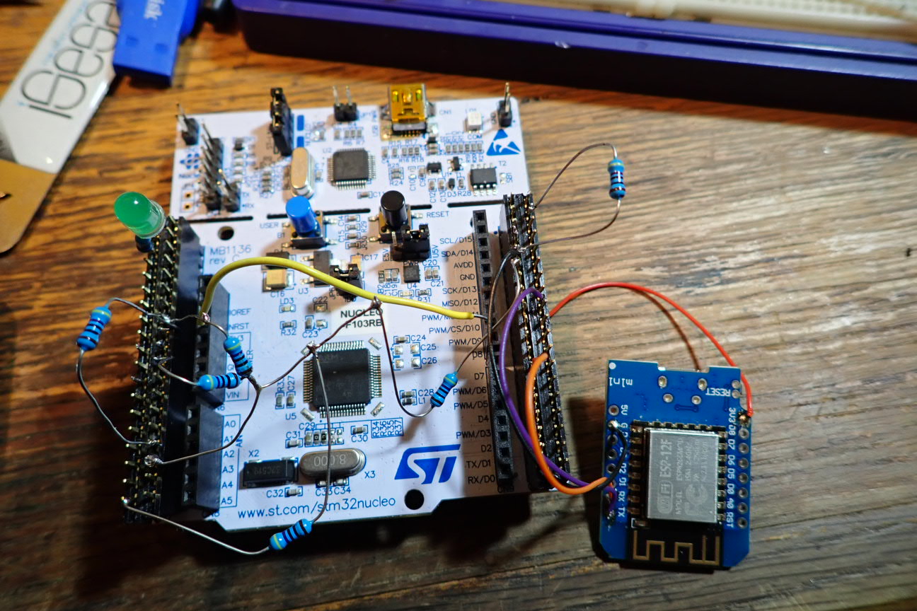

Not sure if I've missed a trick but I'm trying to get the code to run on a bare STM32 module.
I've tried both the Bluepill and an authentic STM32 Nucleo with the larger 64 pin chip.
Looking through the forums it would appear I only should only need to supply power to the STM32 module & ESP8266 + a direction signal and enter some custom commands to get PWM on the output.

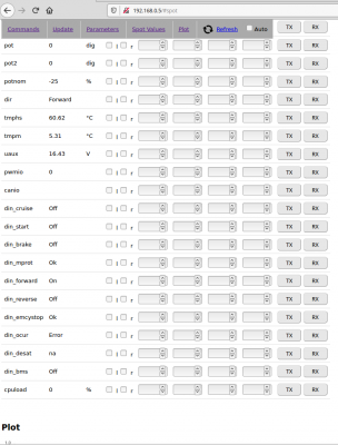

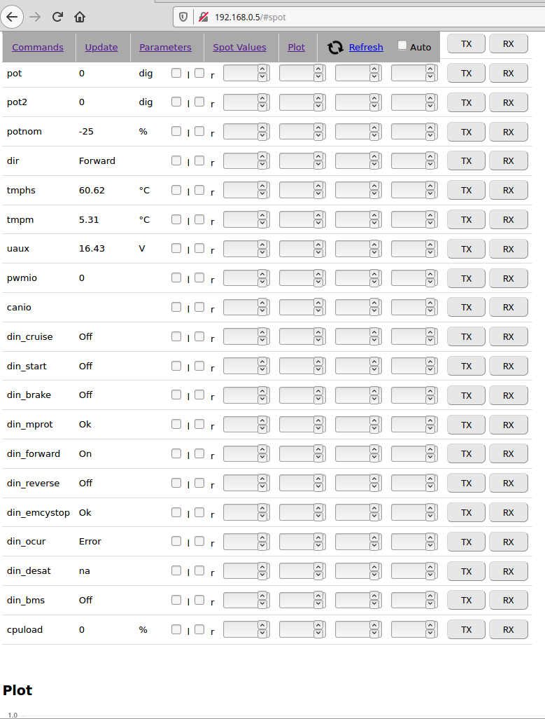

I can access the web console and view all the parameters on it.
The STM32 Nucleo is recognised as hwver Rev1
The bluepill is recognised as hwver Bluepill

But there's no output on any of the 6 PWM channels as a result.
I also looked into the Error Memory and seen a whole host of faults such as over current, over voltage, Precharge errors and more in it which is frustrating as others appear to have a open loop motor working with what looks like nothing more than a STM32 module connected to the inverter with some level shift logic.

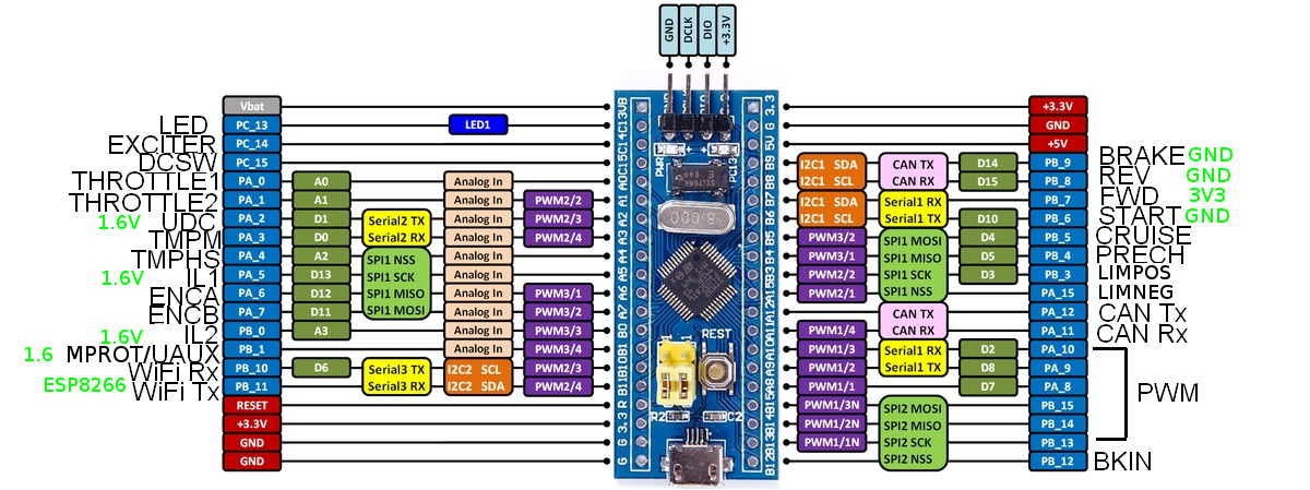

Precharge error trips when udc does not reach 'udcsw' within a certain amount of time. Type 'get udc' and set your udcsw to whatever that is. Overcurrent is coming from the lack of sensors. If you just want pwm I believe you can simply feed the current sensor inputs with 1.65v.
This wiki page should be helpful; it contains the schematics for the rev2 inverter kit, which ought to be similar wiring-wise.
https://openinverter.org/wiki/Schematic ... structions
Good luck!
EDIT Also you'll want a voltage sensor (or at least something to emulate it). A voltage divider should work to fool the stm32 for now. Wiki page has some info. For now you can set udcmax above whatever the stm32 thinks udc is. That should get rid of overvoltage.

Hi
You also need to apply +5V to the PB12 pin via a 10K resistor this is used to block the timer due to hardware protection

Thanks Isaac96 & yaroslav I got there in the end.
I was heading in the right direction but didn't quite make it. Another problem was caused by connecting the supply to the ESP8266 from the Bluepill 3V3 voltage regulator which resulted in high levels of noise on all the analogue inputs.
The biggest failure in my part was to assume things like direction input defaulted to OFF when unconnected. And of course I should have read much more more of the Schematics and Instructions and related error + parameter wiki pages before starting.
Eventually I had to spoof the following inputs and then tweek some of the gains and derating limits so the spoofed signals didn't halt the output before I got PWM output. It all looks so straightforward when watching Youtube.

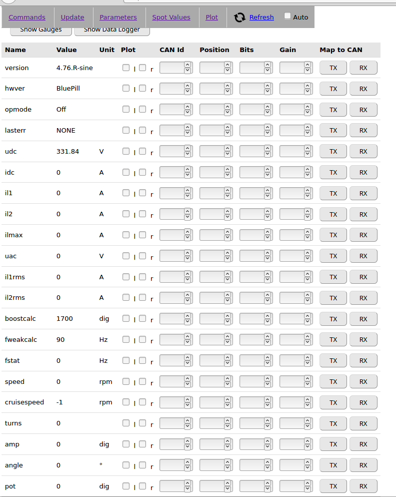

I'm now running the FOC software on a Bluepill and compared the parameters to the very similar ones arber333 posted in the Mitsubishi thread.
I've set Voltage and Current inputs to 1.6V to simulate inputs and checked the reading are around 0A and therefore derating values are not being exceeded.

Are you trying to run FOC software without current sensors?
Re: Problems running on a bare STM32
errr, yes.
Just to test, not as a final solution.
I'm guessing this might be a problem?
- Posts: 6742
- Has thanked: 380 times
- Been thanked: 1564 times
Yes current sensors are part of the control loop (as opposed to the _sine software). Nothing meaningful will happen without them.
